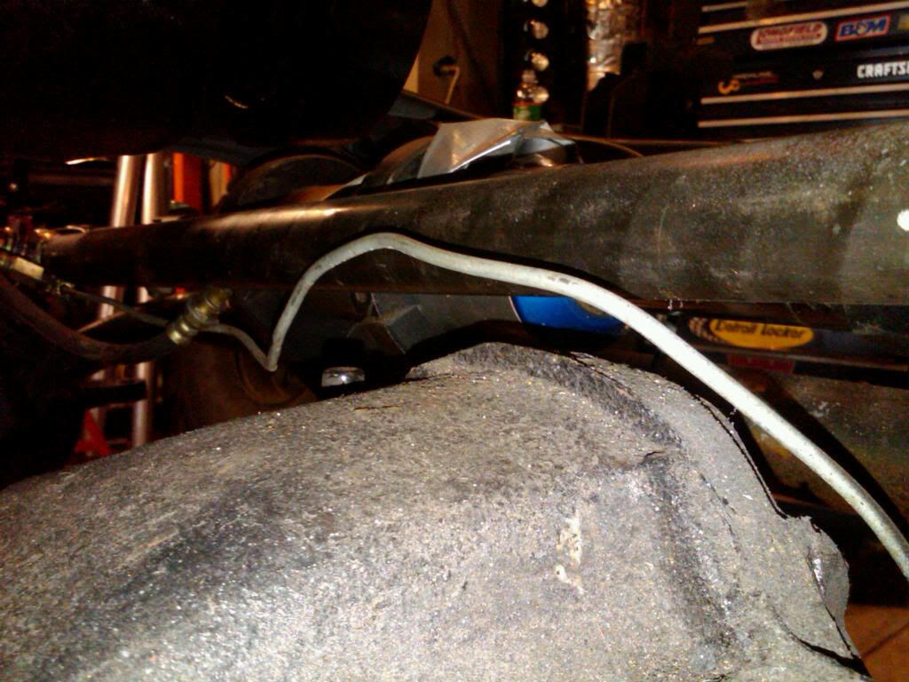

Panhard is TIGHT.

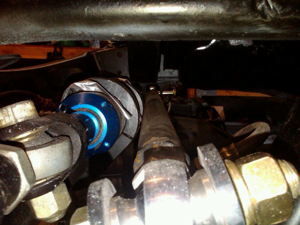

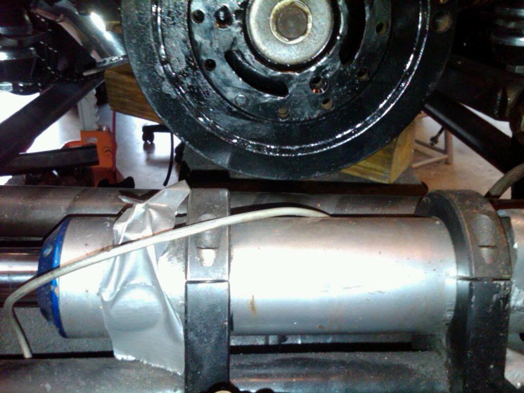

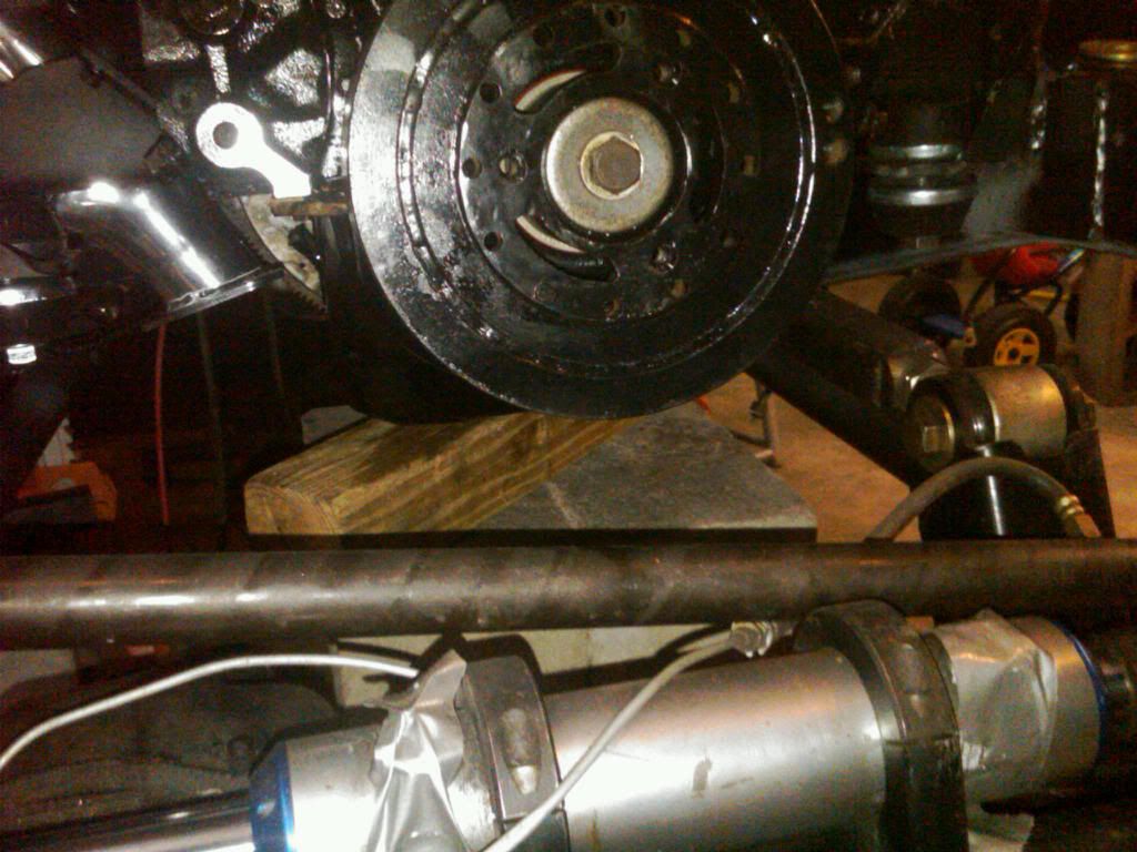

Ride Height:
Full bump... its about 4-5 up:

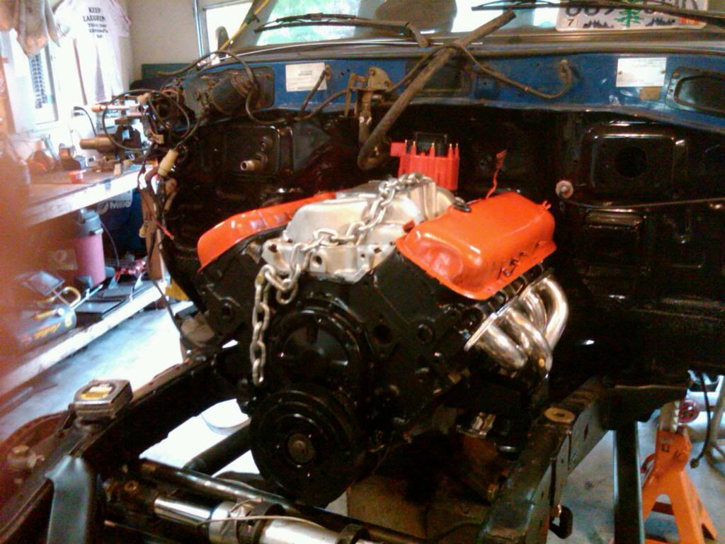

Painted the valve covers for giggles:

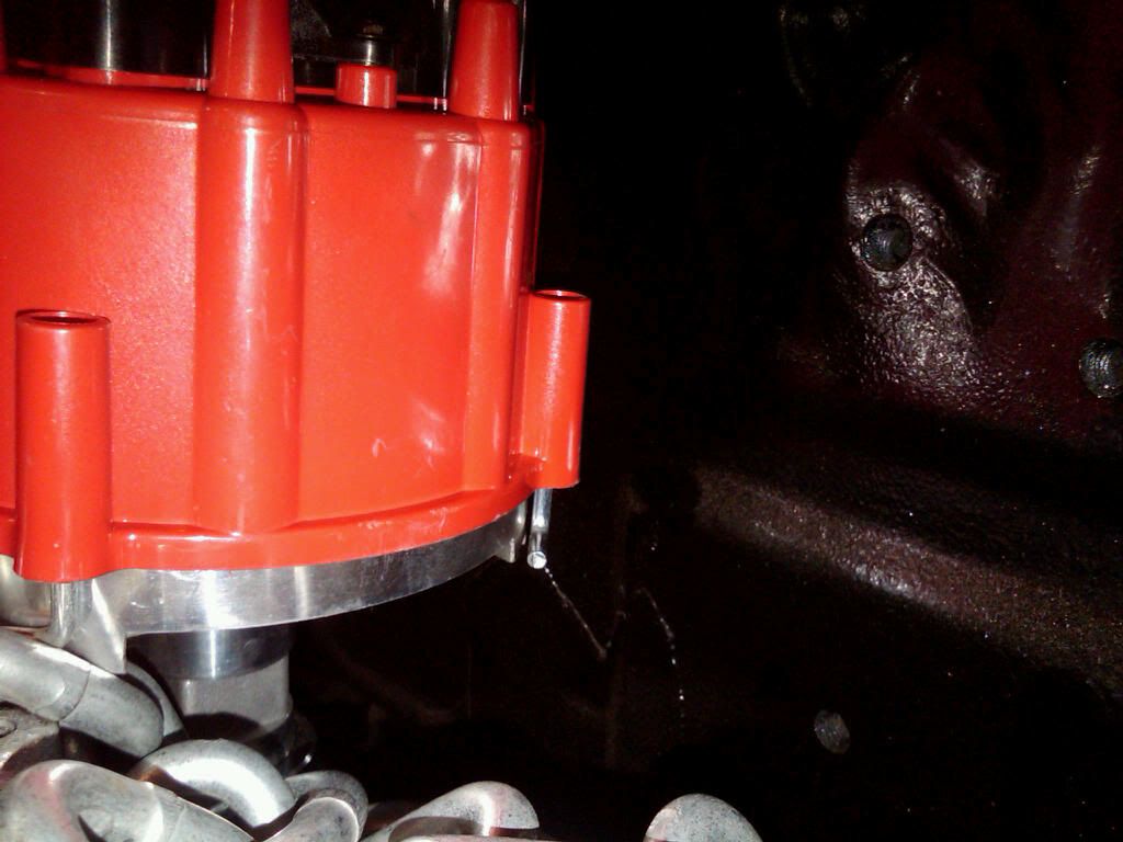

Distributor is tight...

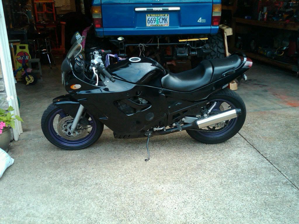

AND I've been working on the bike too... still gotta paint the wheels. Great bike for $500 even if it is a Kan-a-Tuna:
hey atleast you don't have a bandit...all the same weaknesses of the katana but ten times as hard to find parts for and more expensive and less desireable for resell...i'm currently rewiring my whole 96 bandit 600 with a katana harness and cdi and coils...

Thats about exactly the same height I mounted my motor, except that you mounted yours a lot farther back than I did. Did you have to do a lot to the firewall? I know on mine with the motor farther forward than that I didn't have to touch the firewall at all but it was a tight squeeze to get it to fit in.
yeah, I did some "clearance work" with a BFH. There is a couple more little spots than need some further "adjusting" but nothing earth shaking... I SHOULD have enough room for a mechanical fan but I havent got that far yet (currerntly building a play structure in the backyard) to be sure. Should be able to get back to the cruiser in the next week or so.
The more I ride the Katana the more I like it. Sure its not as fast as the "true sport bikes" but its more comfortable and its got plenty on the top to get your blood moving. Like I said... its a great bang for buck bike.
