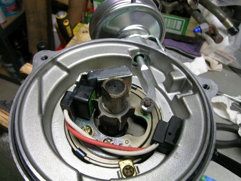

Dude, you may want to look over the desmog thread.
You have a major vacuum leak with that pcv T hooked into the dizzy cap like that.
That should be capped at the T.
You should pull intake vacuum for the dizzy cap before it passes the carb.
It may run a little better.
Just sayin.
Dude, you may want to look over the desmog thread. You have a major vacuum leak with that pcv T hooked into the dizzy cap like that. That should be capped at the T. You should pull intake vacuum for the dizzy cap before it passes the carb. It may run a little better. Just sayin.
Uhhh :D
You are definitely right now that I think about that. Crap.
At idle I have a perfect 21 on the vacuum gauge, but I have a rather loud air sucking sound inside the cab while running. Don't worry. I'll fix it soon. Weber has had it's run :)
I'm also pretty sure my vacuum advance is broken. It should hold vacuum with the engine off or on correct? I don't see how that would matter since it's a mechanical piece, but my searches were inconclusive. Can the diaphragms be replaced? Or is it the whole assembly on the distributor?
Uhhh :D
:hillbilly:
Yes, the sucking and probably slight wiff of engine oil when you turn it off is from that.
Yes, the diaphram should hold vacuum. When you apply vacuum it will pull the advancer rod and hold it.
Just go buy a new one at napa. I don't think the OEM advancer is available any more.
They aren't rebuildable, kinda sealed.
Or get a used one in classifieds.
One phillips JIS screw on the outside and the little C clip on the advancer is all it takes to remove it. It has an O ring where it slides in the housing that may take some wiggling to break free. When you put the new one in lube the O ring with a little silicone grease to seal it and make it slide in easier.
