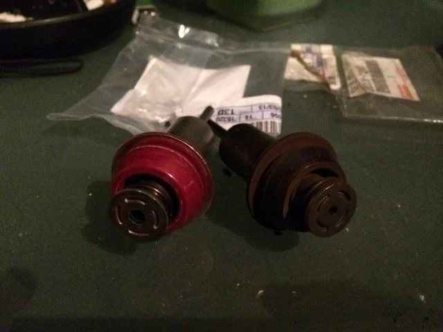

I put in a new advancer and signal generator.
My original looked like it was brought up from the Titanic wreckage.:hillbilly:

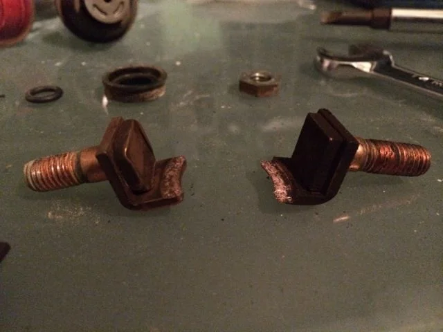

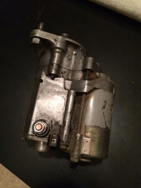

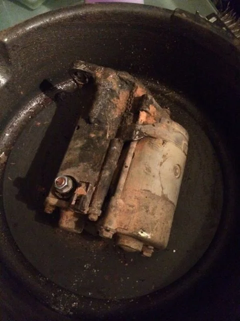

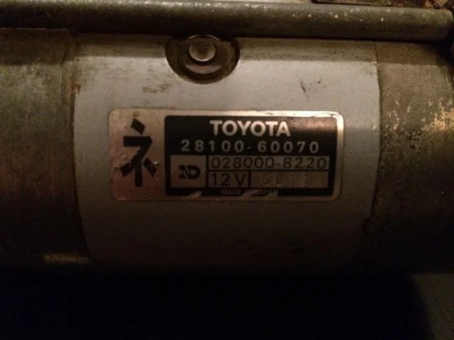

I did the starter rebuild back on December 29th. Two contact kits, and plunger. My contacts were worn out! One of them was worse than the other. Attaching some pics I took while rebuilding it. Before and after essentially. Starter works great now.

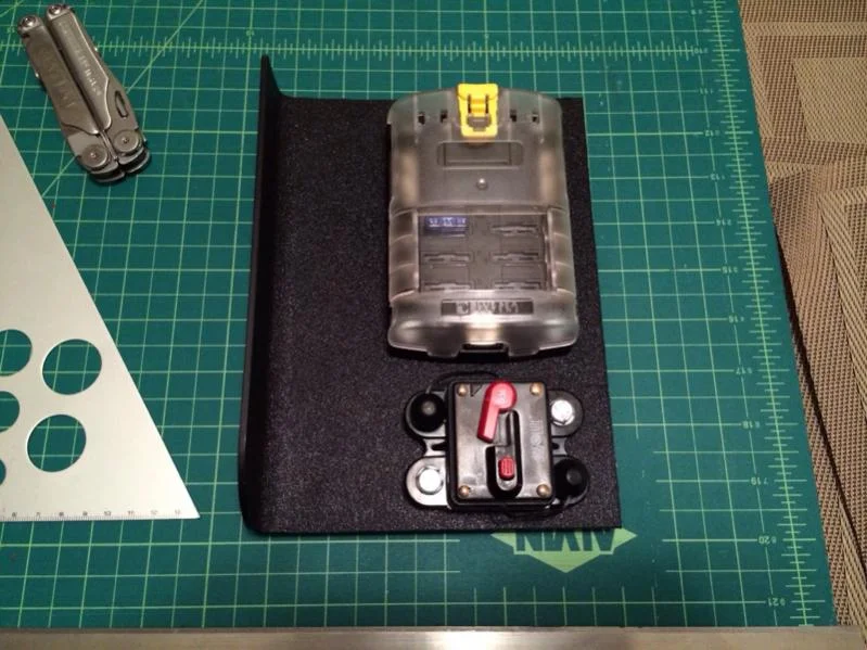

Also, I used 8 gauge wire to link my auxiliary panel and breaker together. You may have a better idea, but it worked just fine for me.

I've got some 6 gauge for power and 8 for ground. It's what I could find locally, and I'm sure will work fine. Sorry I'm just getting around to installing this breaker :D

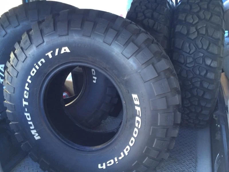

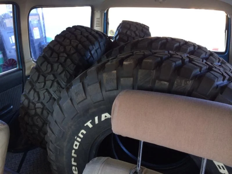

So I changed my oil today. DELO400LE. WIX 51515.
Then hopped on the road for an hour and got these bad boys. $500 for four. With 99% tread.
I'll get them mounted ASAP
Sweet! :bounce2: black wall or white letters out? The more I see white letters out on older rigs I like it, then look at mine and wonder...
White letters visible, it will look great!
