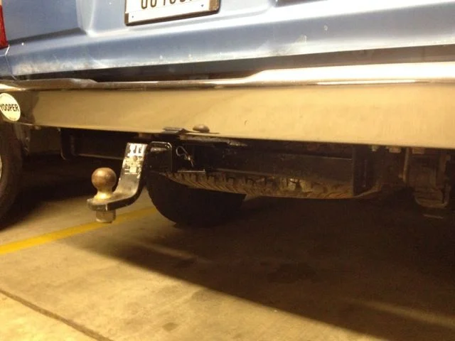

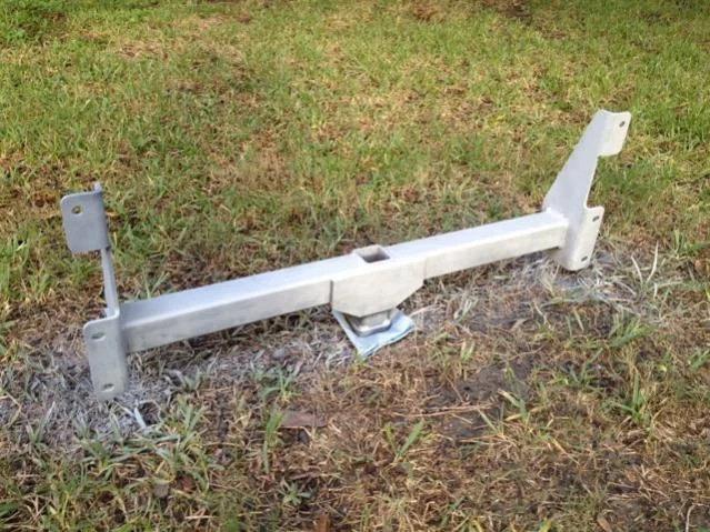

More progress. Got my Draw-Tite hitch painted and installed. Standard wiring put in (for a U-haul trailer, nothing fancy) I used "Rustoleum Professional" spray paint.
Thing was gross when I got it. First photo is after some wire brushing. Gave up on that and borrowed a friends house and grinder!
Second and third show primer and paint. Fourth is a shot while inside Master Hitch.
Fifth is my "Go ahead and tailgate me." We shall see how it works! haha
Take note this Draw-Tite hitch does allow room for a 33" spare in the factory spot. Wish I had a part number, but it was worn off!

And another thing I'm worried about. I had to remove both tow hooks. Front because of the ARB and rear from this hitch. What should I do? Any good solutions?
I am about to pull both my rear towhooks since they drag on everything from my departure angle. If you want to ditch the rear bumper try mounting the hook on the side of the frame. For the front, drill holes in the ARB and mount them there if you dont have issues doing that. I dont think there are too many other options for tow hooks with a draw tite. Shoot darrell a fb message and see if he put his hook is back on.
Not ditching the rear bumper. The hook may actually still fit in the original location, but I'll need a hole drilled through the hitch now. Shop was gonna charge me for that.... No thanks, so I just left it alone.
And the front. I definitely will not be drilling holes in my ARB. No where decent to mount it anyway.
An option for the rear is to get a 2" receiver shackle. Like THIS one. It's only money... haha
what i do is if i need to use a strap on the rear, i stick the loop of the strap in to the receiver and run the hitch pin threw the loop
I would be concerned with the pin strength laterally and the cotter pin if its sliding that way. I also have one of those shackle recievers and its well worth it. Just remeber that your draw tite more than likely has a strength lower than the vehicle weight under a shock load.
For the arb, idk what you can do since im assuming that the top bars cant take a recovery load. Really I think the best bet is to take some time to drill 2 holes for the hooks on top and go from there.
Funny... I solved this problem with that exact same shackle... :D
lol. I'll find one on Craigslist or something. Anything to save a buck!
I'm gonna avoid that, and putting a loop around a hitch ball. The guy at Master Hitch suggested that, and I immediately said I've seen pictures of those things embedded into vehicles from snapping off. He said that wouldn't happen :rolleyes:
Drilling anywhere on the bumper isn't gonna be strong enough. It's only plate. Have to get into the frame to do any good. I'll do some research on this...
Funny I believe I have the same hitch, I will have to go crawl under the truck later and see if the number is still on there. Got mine from a local club member for $50. I went with grade 8 bolts to mount the hitch and ended up just putting the tow hook on with just a single bolt. Not the best alternative but works for the moment but I like Darrell's solution with the tow hook on the hitch accessory.
