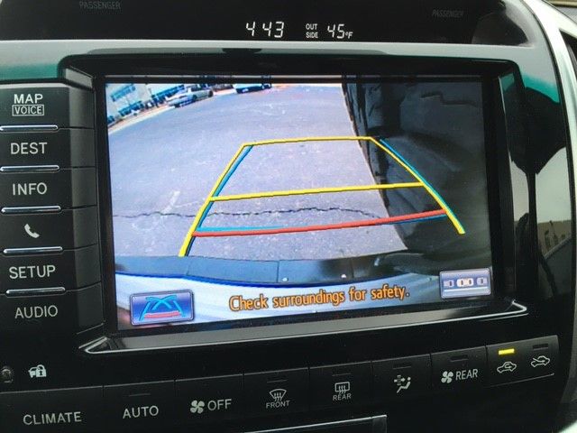

The spare tire cuts off a small portion of the rear view, I will take a picture. The camera was moved into the bull bar and there is no interference, but there is the Radar sensor for the assisted Cruise Control behind the Toyota logo. The Winch controller was moved due to that
here is the rear camera view after it was moved. I could always move it a bit to the drivers side to improve it. That is what I did on my 100
You may look into routing it to the center of your tire carrier - it's not difficult at all and the view is unobstructed.
Where it is will be better for connecting a trailer by myself. That is the best use for the rear camera from driving my 100, that and seeing the lines to back into a spot
Thanks for the suggestion though

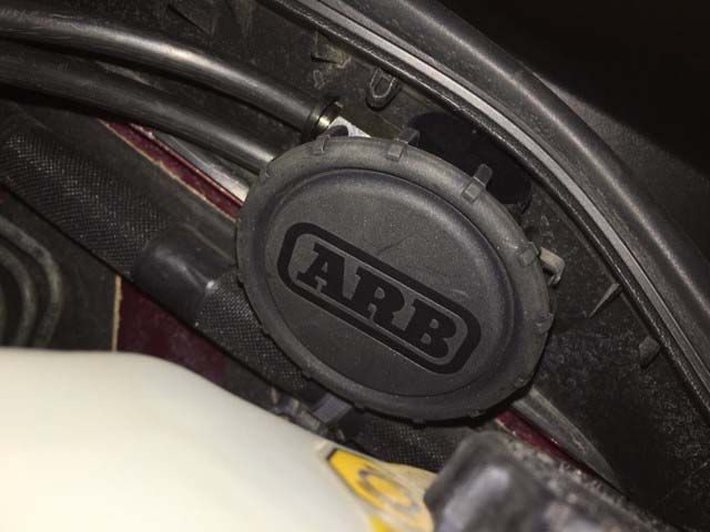

I almost forgot. The Diff Breather extensions
Thanks that's helpful. I would definitely need to look into relocating the camera further over, or higher up, or into the spare tire carrier... visibility is so limited when backing up the camera is extremely useful.

I noticed that the rear camera stock location is better when you only have one swingout. The relocation kit is a must when you have two and I don't. I moved it back and the view went from this
rear-view-jpg.1213353
to this

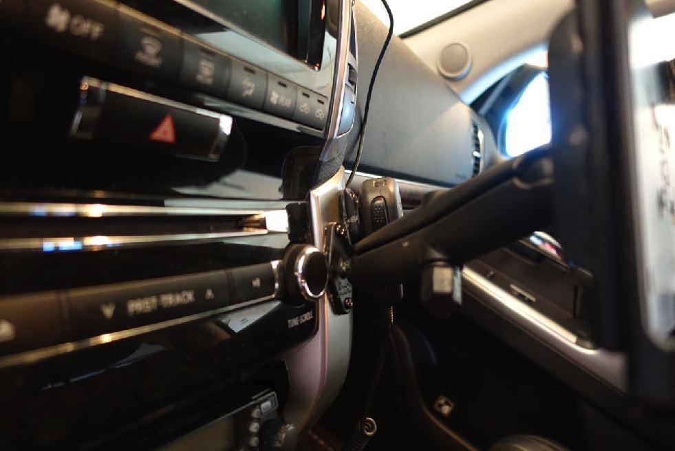

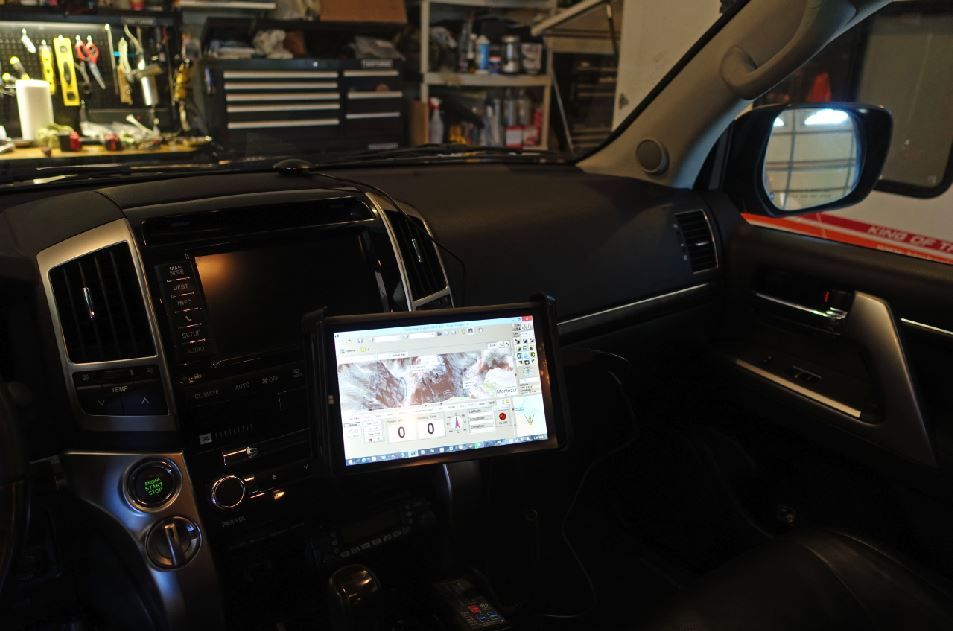

Getting ready for Cruise Moab and a season of wheeling. It is nice to have a GPS especially when you are leading the trail run so you don't take the wrong trail. I had bought a $100 windows tablet at Microcenter and a USB magnetic GPS I ran in both my 40 and 100, described in the highlighted link.

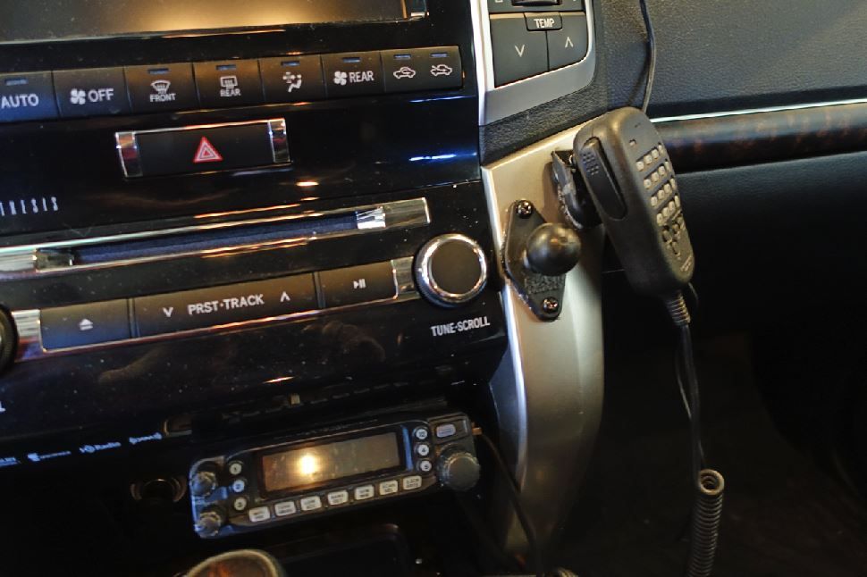

The question was where to add the mounting ball in the 200? I wanted to be able to shift, operate the Radios etc and have it as close to eye contact as possible. This setup allows me to adjust the position of the tablet in any direction and to get a mount for a phone if I want it.
Here is where I put the mounting ball
Putting the long arm and carrier for the tablet
Adding the tablet

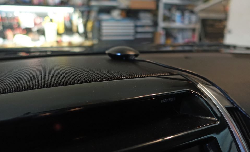

Then placing the GPS Puck on the metal dash speaker cover

Thanks. I know if I screw it up I can order the trim piece from Toyota. My previous trucks have been 7 years old with over 100K miles when I got them. I plan on owning this a lot longer than the 7 years I had the previous cruisers. I do want it customized to my needs. The Ball is a generic RAM Mount ball, I can put anything on it in the future if I go away from the tablet.
It is nice having something better than a phone to surf the internet when you are away from home. I would need to use the hot spot from my phone with this tablet. I remember a couple of years ago coming back from the Maze late with a broken truck in tow. We used the tablet ( a previous one) to find a place open that served dinner in Green River and a Hotel to stop for the night and figure out what to do next.
Adding the tablet
View attachment 1227778 View attachment 1227779

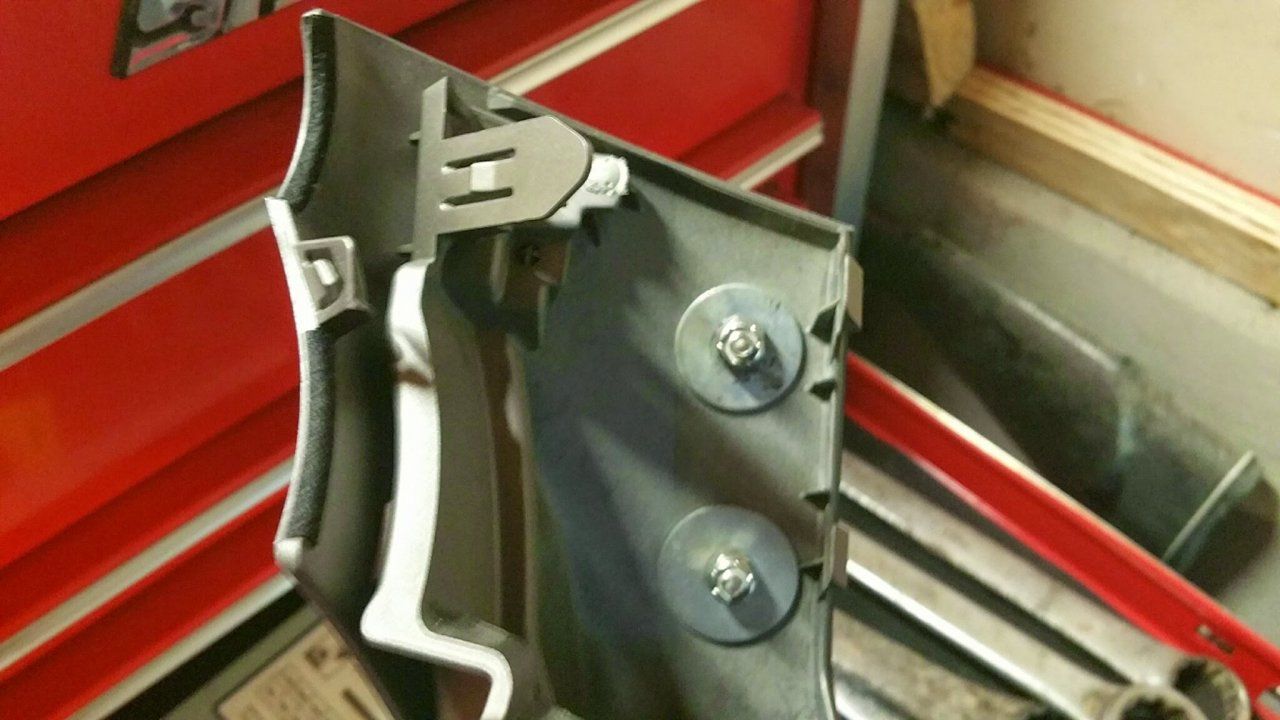

Nice. I've had mine mounted like that over a year now and no issues with the panel or mount coming loose. I added large fender washers for a little more support since I used it for my 8" and 10" tablets.

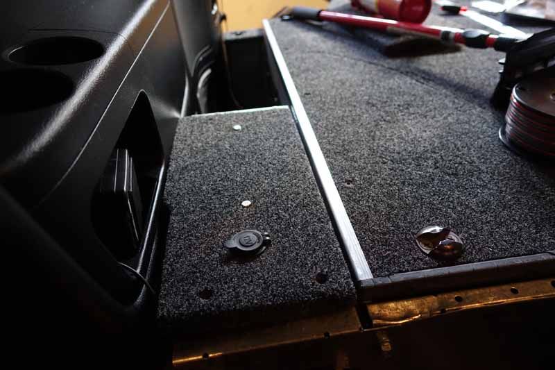

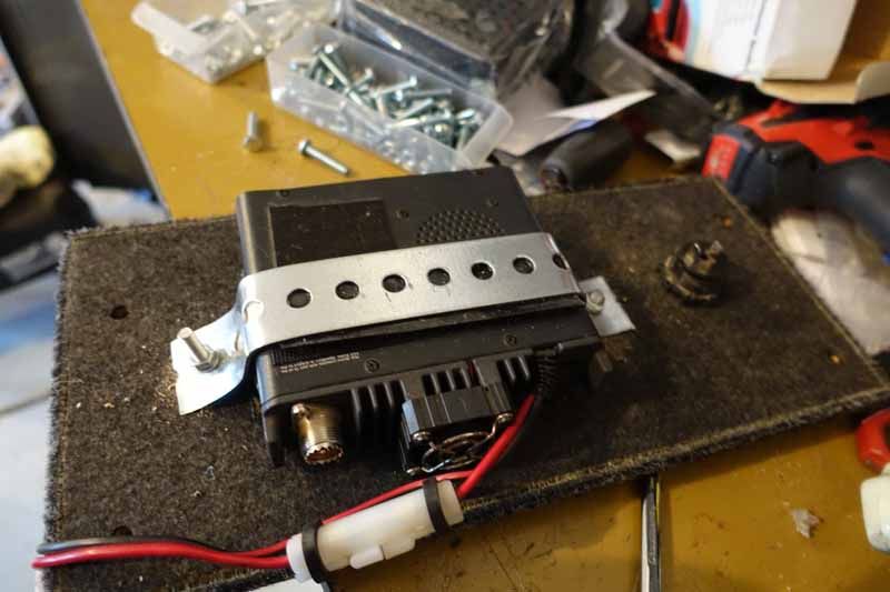

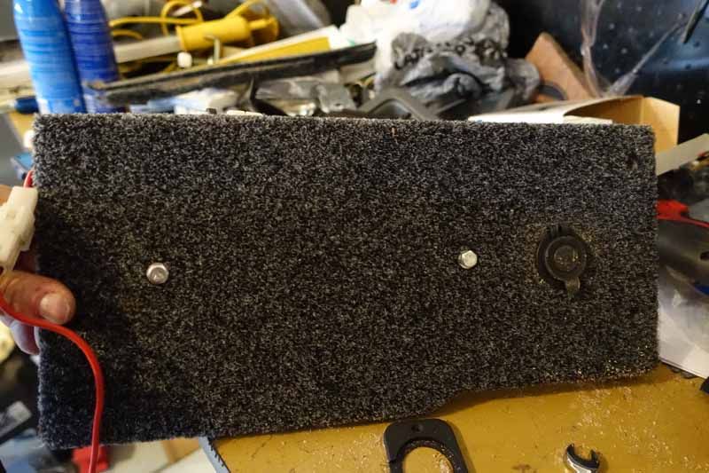

I put the Radio head unit under one of the Drawer Trim Kit panels along with the 12V outlet for the Fridge. Was amazing to me there wasn't a 12V outlet back there
View attachment 1192915 View attachment 1192916 View attachment 1192917
Next I will put in my brake controller and Dual Battery setup. I will have to see if Slee has the 2nd tray in stock and run up there this week.
