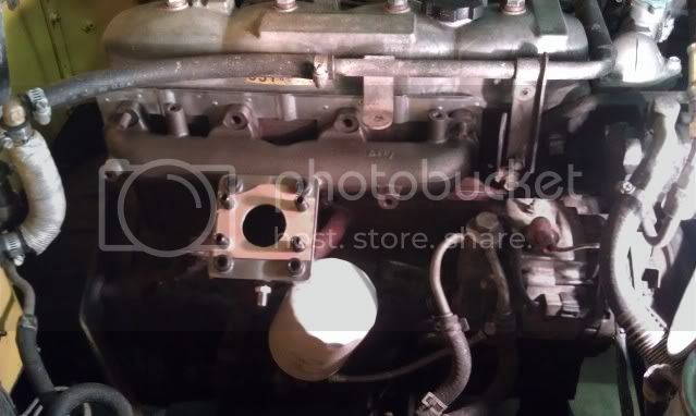

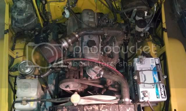

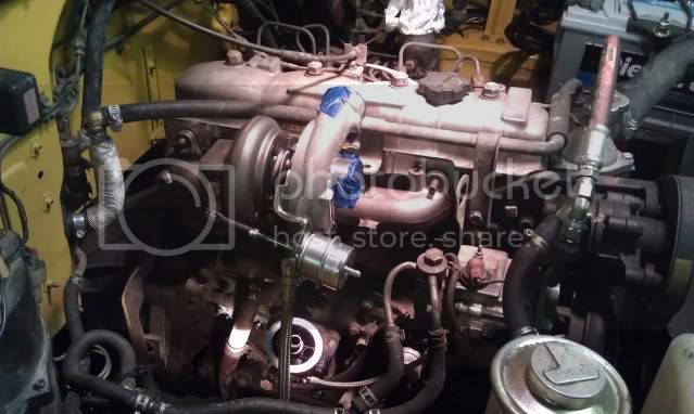

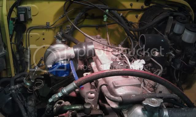

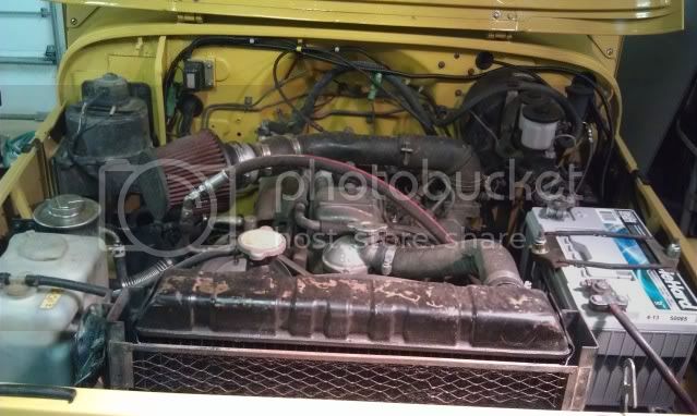

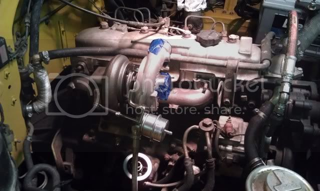

Started installing the d42 turbo kit this evening.

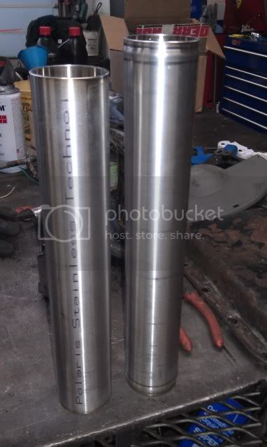

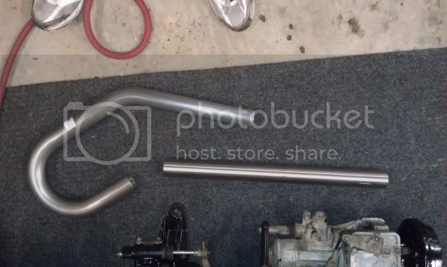

Stainless charge and intake piping I need to cut
This little guy is a booger to get to. Oil feed line.

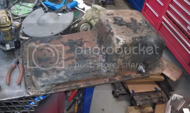

Thanks everyone i really enjoy working on this thing im in a frantic rush as always trying to get this thing done before the trip. im wondering if i should paint the oil pan or go ahead and have it powder coated while its off which would take a couple of extra days. If im going to powder coat the pan a part of me tells me to pull the push rod cover and powder coat it while its easily accessible. If it had any kind of leak it wouldnt be a question but its bone dry. Im surprised that this 3b has no oil pan gasket or pushrod cover gasket it is actually glued on im assuming this is because the donor was an 1985 model. I do like the idea that it doesnt have gasket to deteriorate.
as frantic as you are, who cares about powdercoating :meh:
black Krylon, good to go - your trip is more important than looks :cheers: :steer:

Powder coat it. You know you want to.

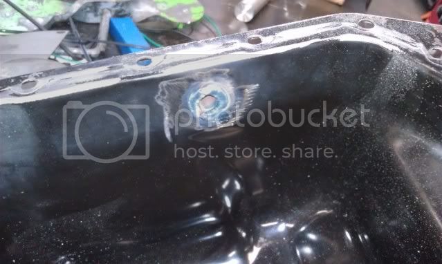

Got the charge pipe cut down at my friends shop he got his new roller out and rolled a couple of beads on for me. Also welded the oil return fitting into the pan.

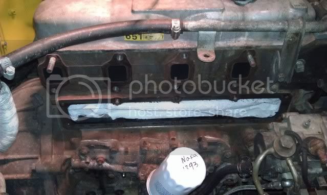

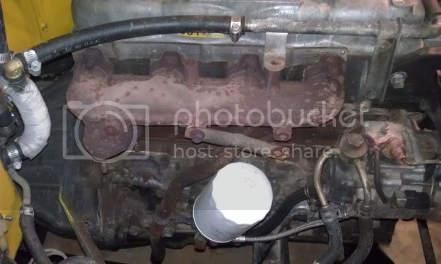

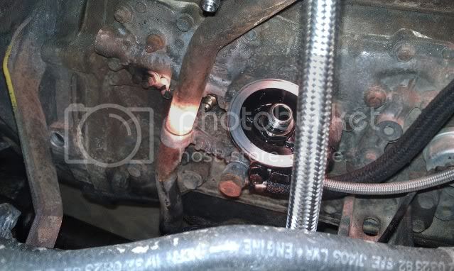

Went ahead and pulled the side cover so it can be powder coated. This picture shows the napa oil filter that is compatible with the 13bt manifold and upward facing oil filter housing. Thanks for the info Alberto.
Glad it worked out, Roma!!!

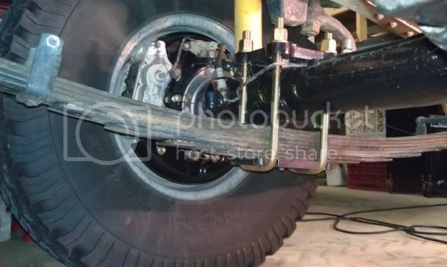

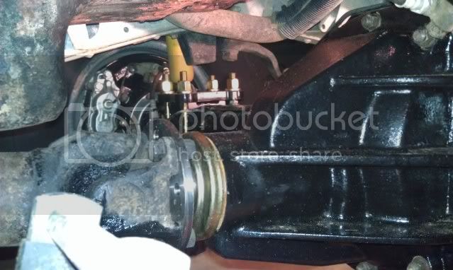

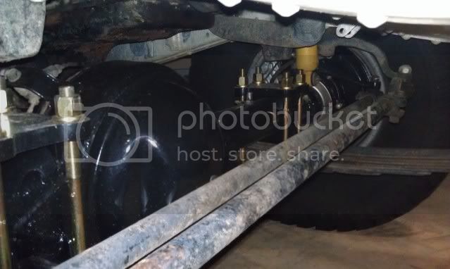

Realized I didn't have any pics of the finished front axle.

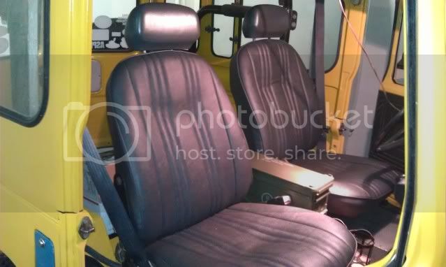

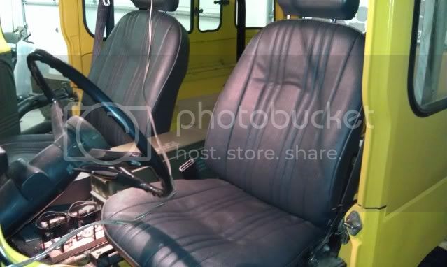

Got the seats reupholstered the other day. Very happy with them the guy charged me 500 bucks for both and its an automotive vinyl as opposed to the marine stuff which isn't as durable.

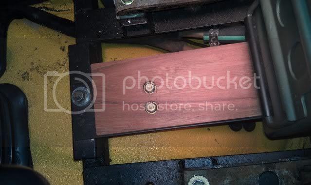

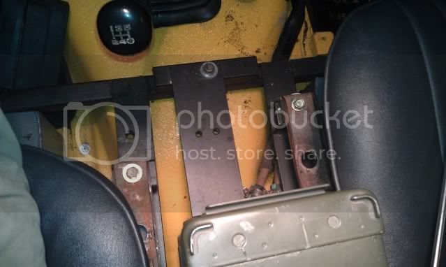

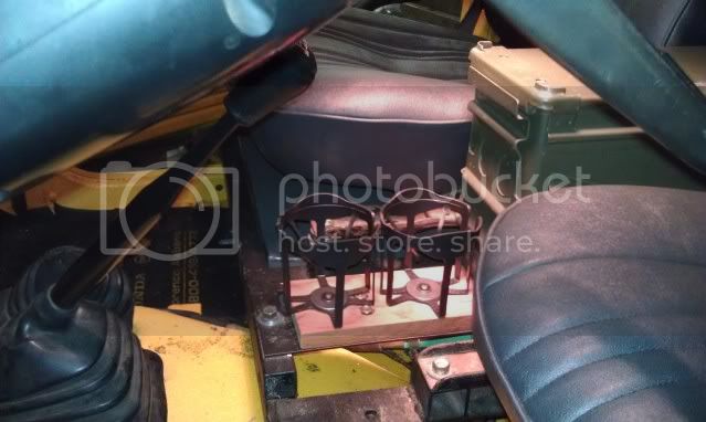

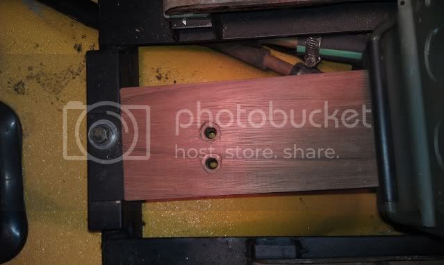

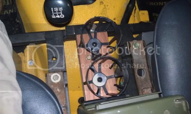

This thing desperately needed a cup holder so I went and bought a 4 pack of those plastic cup holders you hang off the window for a 1.99 at Walmart. I had allready welded captive nuts in my seat/console frame so I made this. Not pretty but it works and I like it.
I drilled and countersunk the mahogany, cut the hangers off the cup holders and screwed them down with stainless fender washers.

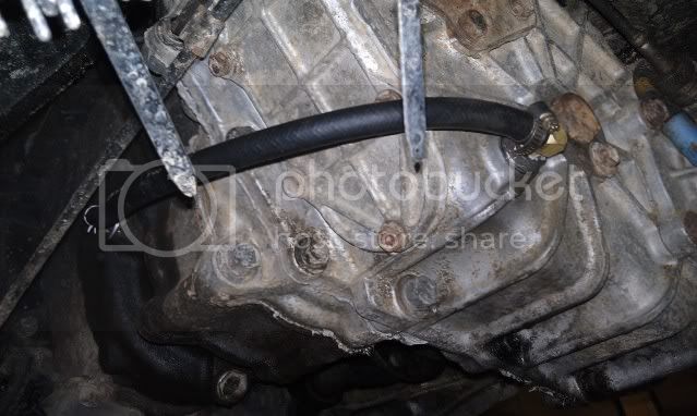

I have a pesky internal leak between my trans a transfer case in which the transfer case pushes fluid into the transmission. I ordered a nice bypass hose but unfortunately its not going to get here in time for my trip so I made this today to get me by.
