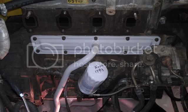

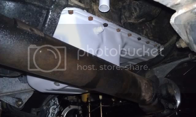

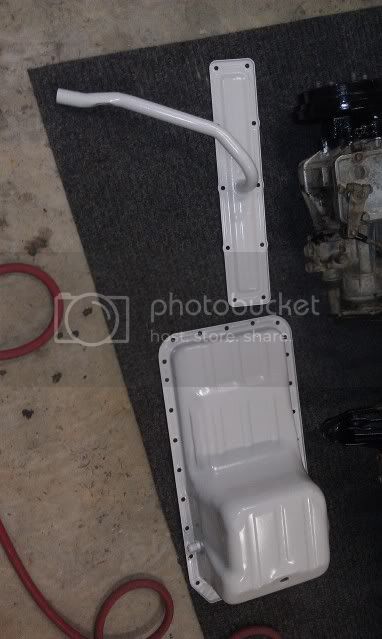

Got my oil pan and side cover back from powder coating and apparently the powder coater got the powder mixed up. Instead of a dark gray it came out a very light gray but since it didnt cost me anything anyway i think i can live with that :)

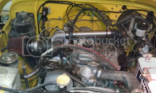

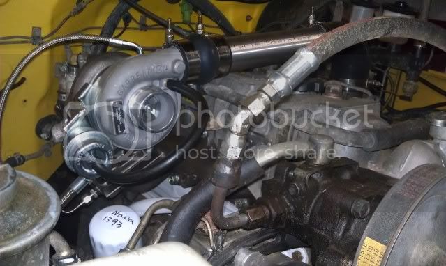

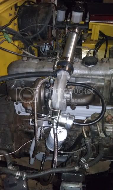

At this point its crunch time, wednesday 7pm i need to put the pan on, side cover install the turbo and all associated plumbing, get an exhaust made and pack for the trip. (leaving friday after work).

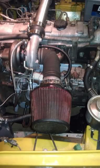

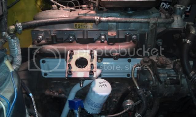

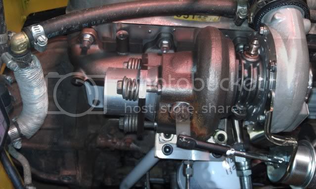

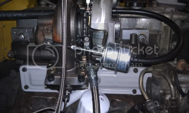

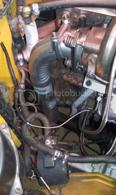

13bt manifold on with all new hardware.
by this point it was 11pm and sealer for the oil pan and side cover was pretty dry so i couldnt resist to dump the oil in it and take it for a spin :) Its surprisingly quiet with the 6'' of exhaust it has. no leaks and no abnormal noises so muffler shop today and im going to wrap the down pipe with exhaust wrap this evening.
And the grunt? Are you happy with the low end power?
You'll find you won't need a muffler; my turbo 2h never had one and was never loud.
im happy with the power. im still not used to the 3.70s considering i only put about 25 miles on them before i took it apart for the turbo. But it pulled the steepest hill in town on the way home last night at 60mph while before it would drop down to 35-40mph.

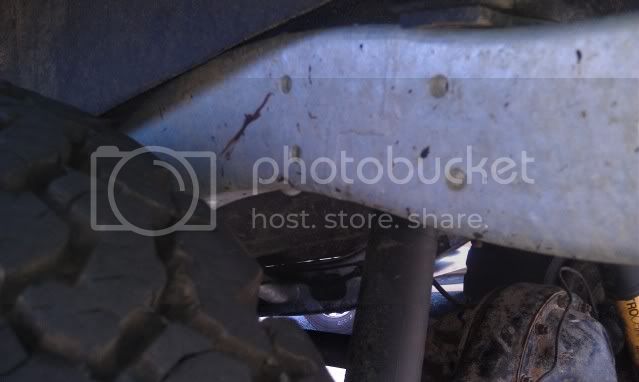

Ran over a deer last night in mississippi running 70 mph.
Got into Memphis around midnight and got a room.

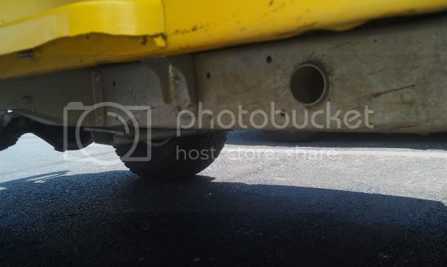

Glad I had 33" tires

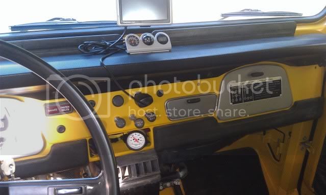

Egt gauge I threw in at the last minute.
