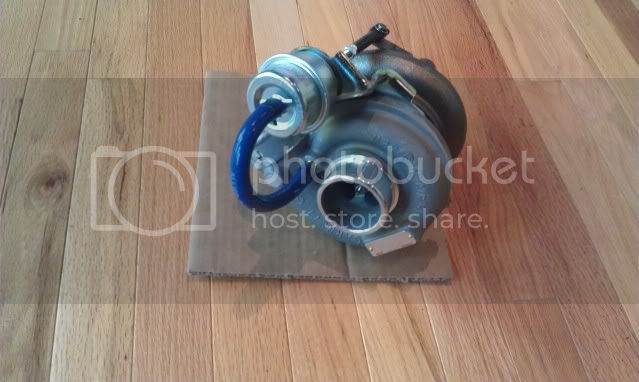

Have to share. Look what came in the mail.

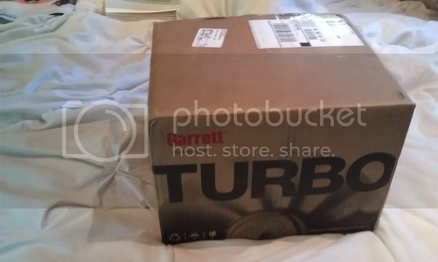

Sure is teeny tiny out of the box. Can't wait to see it on my 13bt manifold I have been stashing.
I'm excited to hear it I'm going to redo the exhaust out of 3" mandrel. No muffler and side exit as it is now. Should sound like a tractor. I got the rest of the plumbing and lines etc this afternoon it is a d42 kit. Still need to get a pyro and a couple of other small things but it will certainly be on before the next road trip.

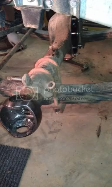

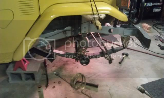

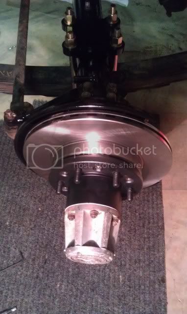

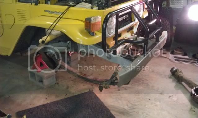

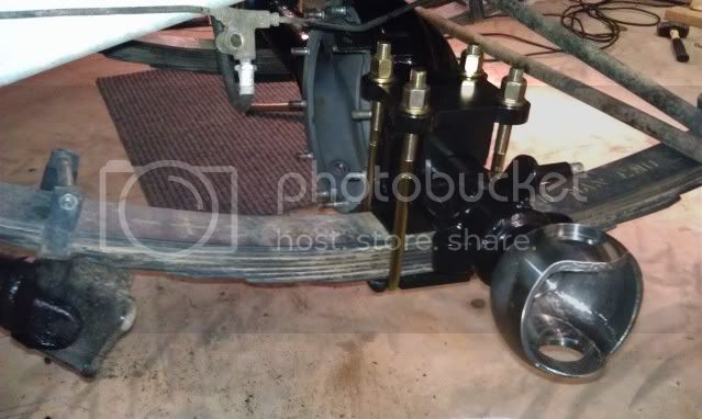

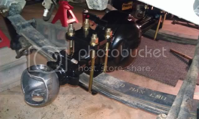

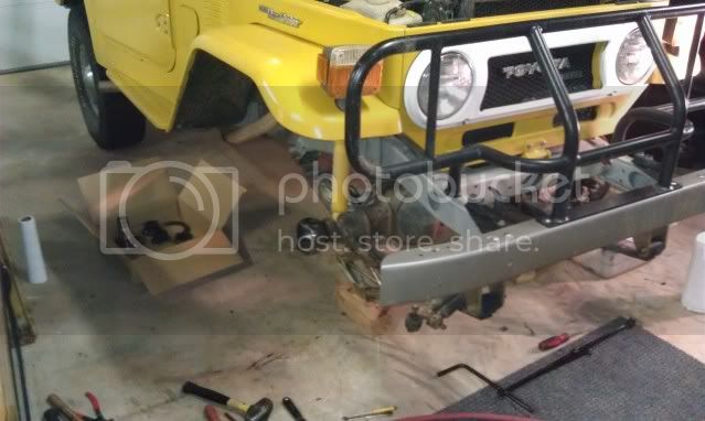

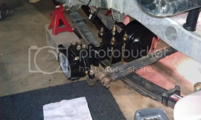

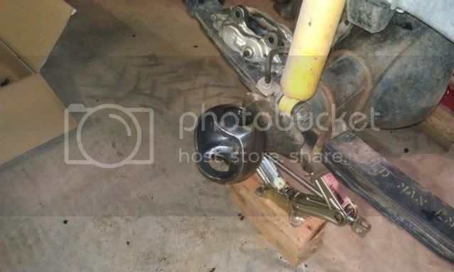

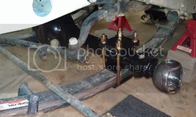

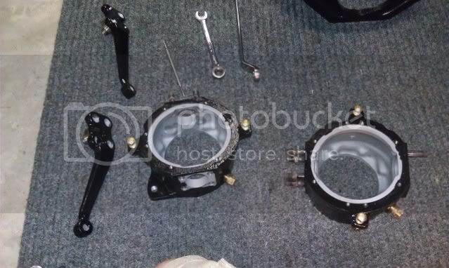

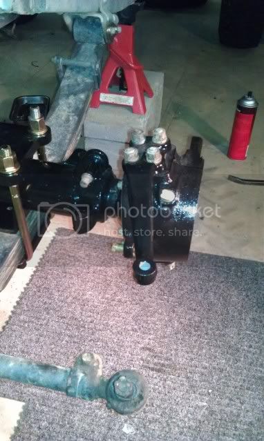

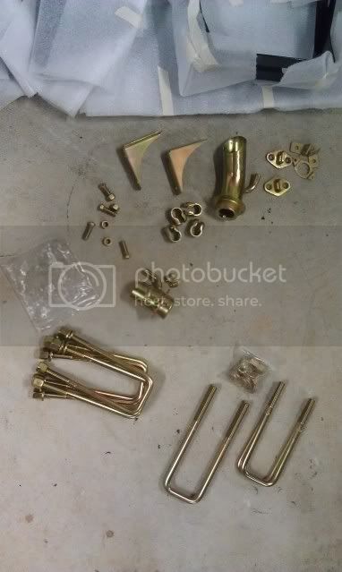

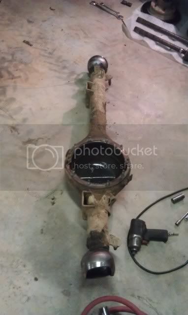

sand blasted all the parts including the housing. powder coated the backing plates, painted the housing, knuckles, steering arms and third with two coats of por15. 4plus ubolt flip kit, zinc plated the ubolts, steering stops and grease plugs on the knuckles. New rotors, new knuckle bearings and wheel bearings from georg @ valley hybrids, marlin inner axle seals, 3.70 third member from a fj60 which i set up with a solid pinion spacer i got from just differentials (worst service ever would never recommend to anyone). and a fine spline pinion flange from cruiser outfitters to bolt to the fj40 drive shaft, of course new pinion and third seals and pinion nuts from toyota. Also replaced the knuckle seal retainers with new units from toyota. Calipers are toyota remans with new pins, new toyota pads and hoses i put on earlier this year.

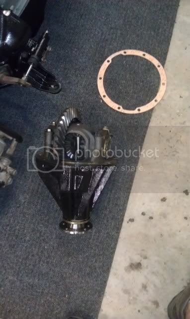

Unfortunately i didnt have time to go through the rear axle as thoroughly as i want before my trip so this past weekend i put in the 3.70 third which i also set up with a solid pinion spacer and a marlin hd pinion seal. I replaced the axle seals as well. I gotta admit with the 33's and 3.70s it is a DOG! Turbo is going on this week im hoping it will provide the much needed power.
With the turbo in there you will LOVE your 3:70s- especially going on the highway for long road trips.
Beautiful axle work - leave it to you do do the sexiest front axle rebuild on Mud....
