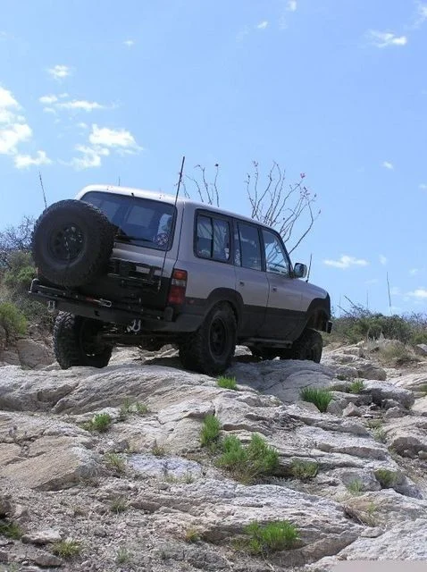

Here’s my girl Tortuga.

She’s a great runner and wheeler. She’s been my first project car and I’m pretty proud of the results. She’s not as clean and polished as some, but I think she’s the best 80 out there.

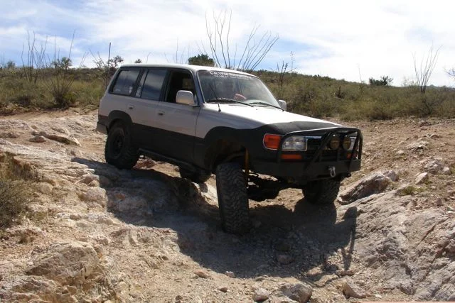

Sweet Rig, I am jealous. It looks like the hoops on the front bumper were added later according to that pic of you coming down the rocks? It does not look it needs anything. :cheers:

Does the winch being so high up block any air flow to the rad??

I've never seen any issue's with cooling. There's still lots of exposed grill for airflow. I live in Tucson, so if airflow was an issue, I would have found out by now.
