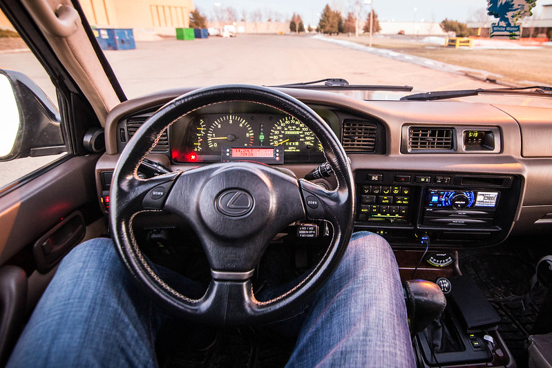

IS300 Steering Wheel Installed:
20130116-IMG_2133.jpg by RickaShay24, on Flickr
Spline count is the same and the wheel is currently installed. Still need to figure out the wiring for the cruise control module and also get the airbag working. I found an OEM Toyota airbag adaptor that I ordered so, fingers crossed, that will make the bag work. Cruiser control shouldn't be too bad as the connector on the IS300 wheel and the body-side of the steering wheel harness on the LX, are identical. They are however pinned in a different order but once I get some time I think the wheel will be 100% functional!

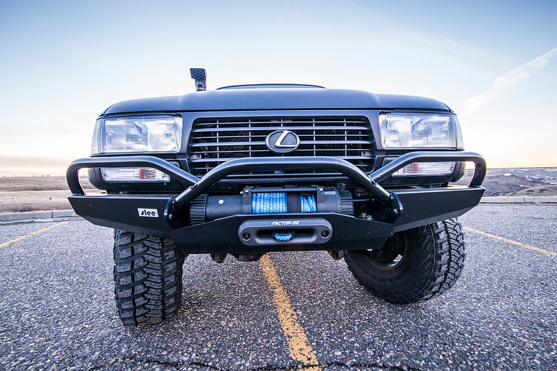

- Installed TJM Stealth 12k winch
- did a Solenoid Box relocation under the hood and away from the elements
- put on my Amsteel Blue 7/16" Synthetic line and found out my Factor 55 thimble is now too small. It will be for sale soon if anyone is interested!
- Installed my Factor 55 1.5" fairlead, this thing is beefy.

Factor 55 lookin' purdy:
20130116-IMG_2130.jpg by RickaShay24, on Flickr

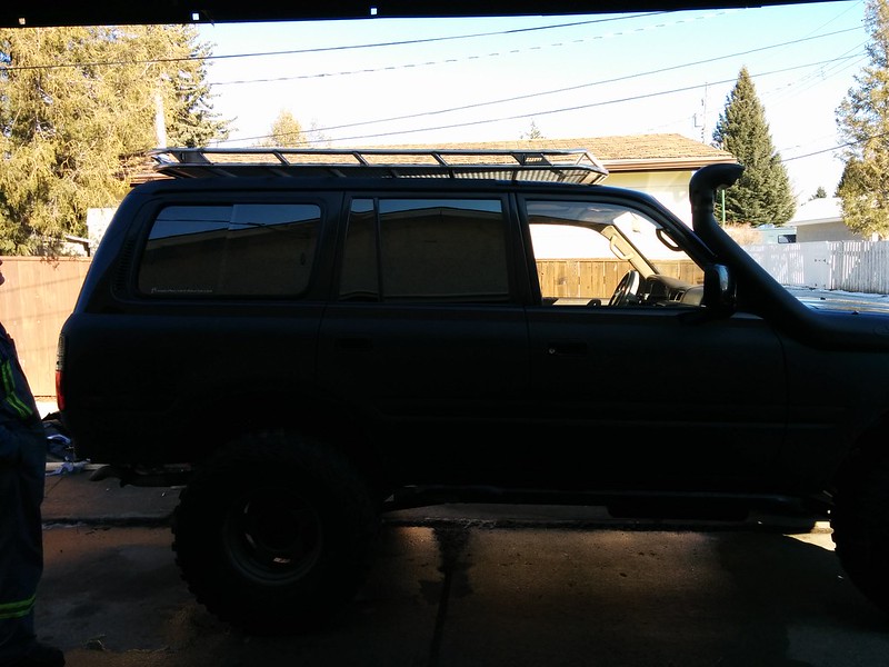

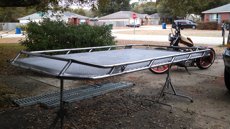

Just got this photo sent to me by Josh at Whitson Metalworks. He has finished up my roof rack and it's ready to ship. This guys does awesome work. I drew the rack on some graph paper and pretty much told him to build it. He built the rack on my 3rd Gen 4Runner and I could not of been happier, so I approached him with this project for my 80. It's dimensionally very similar in size to the Baja Rack. I am going to be trimming my rain gutter mounts so that the rack sits 1/2" off the top of the roof, as the goal is to keep it as low as possible.
LX450 Rack - Whitson Metal Works by RickaShay24, on Flickr
Any pics with your new rack installed yet?
I'm curious, what are the advantages if the is300 steering wheel? Is it just for looks? And what are the buttons on the side of it?
That roof rack looks sweet!
Sorry don't have it up in Canada yet. The guy who built it is in Florida and he's currently building a roof rack for a 3rd gen 4Runner that is semi-close to me. So I'm waiting so both racks can be shipped up at once to split the freight costs. I'll get some photos when it lands and I build a plexi wind fairing for the front.
My LX450 wheel was in really rough shape. I was originally going to get a re-finished one from Shane but for the price I just thought I would try something else. I also hate the LX450 seats and my original plan before I thought of the steering wheel, was to swap to IS300 seats. I found a good IS300 donor car and ended up buying the seats and steering wheel. I like the IS wheel though because A) it's in much better shape than my old wheel B) the overall diameter is a tiny bit smaller and gives me more leg room under the wheel C) it's a thick wheel and has a great overall feel D) It's still a Lexus/Toyota product and not aftermarket E) Im going to wire the old "shift" buttons for winch controls and a switch for my LED ligth bar.
That roof rack looks great! I'm looking forward to seeing what you do for your retrofit on the depo lights. I really like the orange glow from the shroud on that 4th gen 4runner you did, that could look really good on the 80?

Thanks! Yah I've thought about doing some amber halos or something but Im still undecided. Probably going to cram some LS460 projectors in those DEPO's to keep the Lexus theme going.

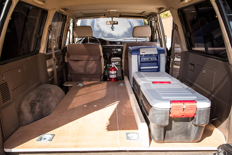

Well as I prepare for Moab next month, things are slowly turning from a pile of parts in my garage to something more substantial. I am picking away at the "to-do" list hour by hour as I find time. This weekend was allocated to getting my sleeping platform sorted and onto the right track. Not doing drawers at this point in time, although I suspect I will be adding an upper layer in the future. Right now I've got sleeping for 1 (and maybe the dog?) covered as well as some dedicated storage for pieces that will follow me even after I make basecamp and head to the trails.
I used 3/4" plywood with an Okoume veneer. The finish is very nice and I liked the color. The 2x4 is cedar for some contrast and grain factor.
20130412-IMG_2290.jpg by RickaShay24, on Flickr
As you can see, I countersunk some D-Rings in the sleeping area to allow for storage when Im not catching Z's. Not pictured, is the Hi-Lift which sits perfectly behind the front seats and is captured in place by the platform. You can access the Hi-Lift from either side and yet the weight is being kept low and the mass is contained so in case of a rollover, it won't eject and remove one of my limbs.
Once I reach the point of final assembly (after staining the wood) I will also be installing my ARB dual compressor in the passenger rear area. If you look close enough you can actually see the harness peaking out of those rear vent louvers. This should provide me fairly quick access to my air source via opening the hatch. I'll grab more photos of this once I get it assembled.

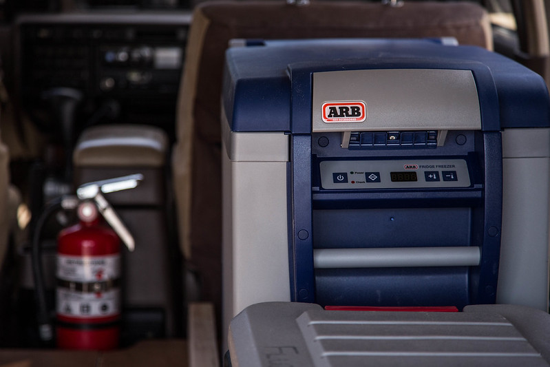

Super super excited for this mod - The ARB Fridge/Freezer. I've been dreaming of having this essential piece of camping gear ever since I got into wheeling, finally it's about to come to fruition.
20130412-IMG_2292.jpg by RickaShay24, on Flickr
