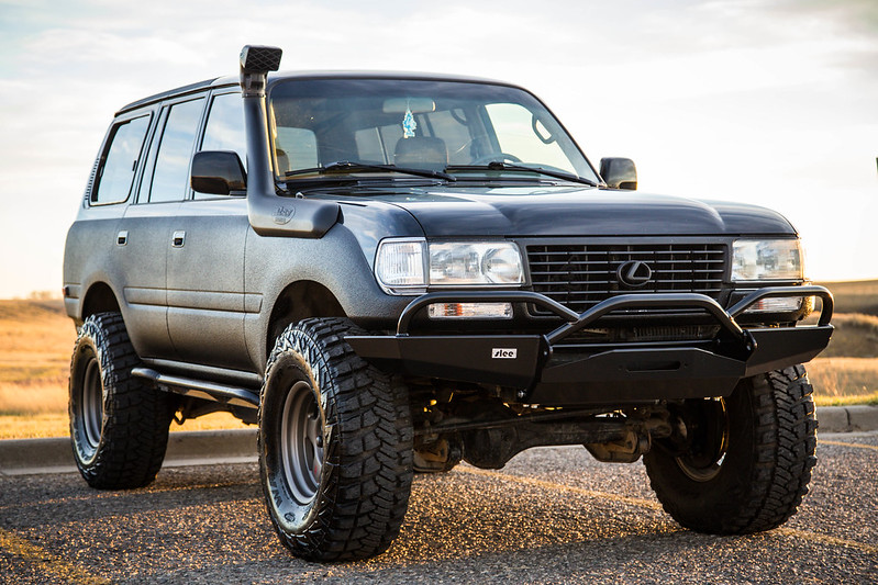

Sorry for the lack of updates. Just waiting to get the LX back from the welder with all the holes filled.
Ordered some Depo LED tail lights, clear corners, and turn signals. Hoping to update the look a little, and I think this should help. Not even going to bother with a projector retrofit until spring when I'll have time to finish it!
My LandTank seat extension kit arrived, really excited for the extra leg room.
Decided on going 37's out of the gate, not going to run 35's and wish I went bigger... Also thinking of doing J-Springs to get a little more lift for the 37's. My OME Heavy coils will be for sale soon, if anyone is interested. I'll be placing my order on August 1st for all of my ARB goodies:
- Snorkel
- Dual Compressor and air hose
- some misc. recovery gear that I need
- and the J's. Kinda want to swing for the Radlfo shocks but I might go with the OME L's for now just to be nice on the wallet and have a worry-free, bolt in application.

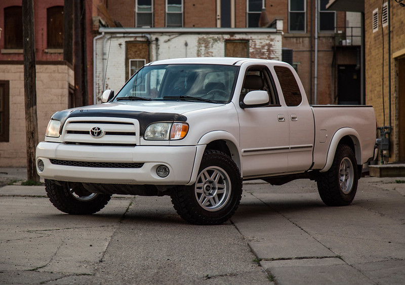

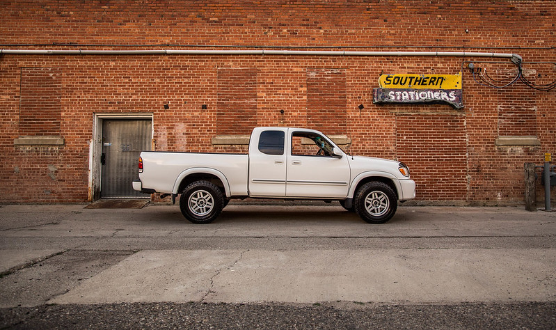

Not 80 series related, but I need to post SOME pics. Got some new wheels/tires on my DD.
20120718-IMG_1700.jpg by RickaShay24, on Flickr
20120718-IMG_1719.jpg by RickaShay24, on Flickr
20120718-IMG_1713.jpg by RickaShay24, on Flickr
Tundra looks good! I always thought that was the best body style for the tundra and that new bigger tundra should have just grown that version. Lol
I agree! I love my Tundra... deep down inside I want it to be long travel, have 35" tires, a bobbed bed, with a custom RTT cage/LT rear setup. However thinking like that will probably have me killed at this point.

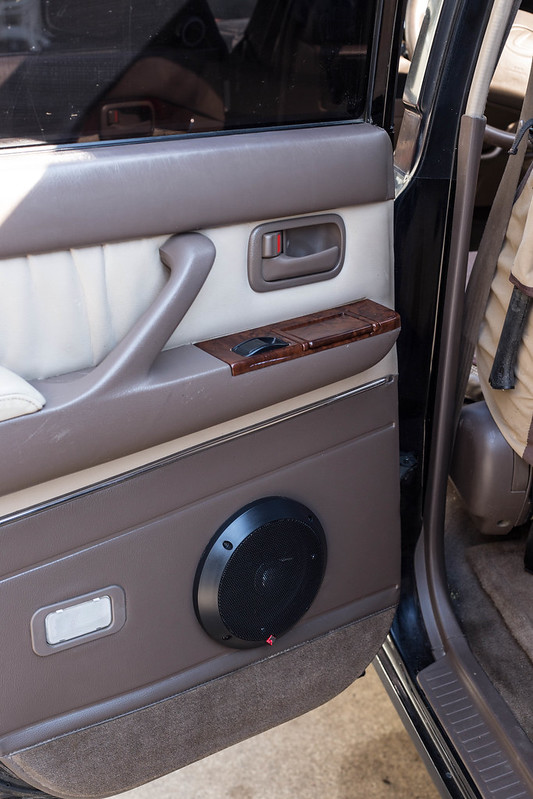

Started working on getting my new speakers in, I ordered a pair of Rockford T-165S for the front and T-165 for the rears. I got the door panels trimmed for the 6.5" rears but I had to run a small spacer to clear the power window arm. They should bolt in nicely now. Hoping the fronts are going to fit without issue....

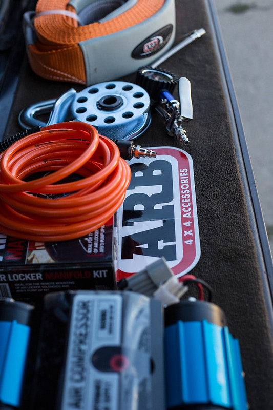

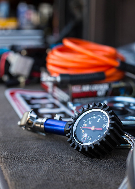

Placed an order from ARB as well, on the way:
- CKMTA12 Dual compressor
- Tire Inflation kit and guage
- Safari Snorkel
- Recovery Strap and Snatch Block
- Front 850J-springs

The ARB CKMTA24 is a piece of art, I can't wait to get this hard-mounted under the hood. Along with a barrage of other ARB goodies...

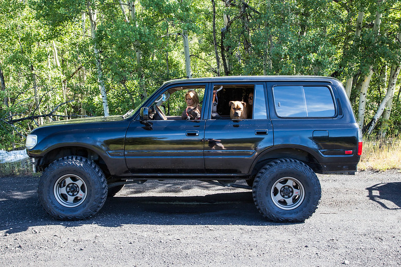

Stretchin' Tom Cruiser's Legs:
20120830-IMG_1843.jpg by RickaShay24, on Flickr
My co-pilots:
20120830-IMG_1846.jpg by RickaShay24, on Flickr

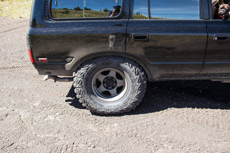

The 3.5" BS seems to be perfect for this tire size. Any more poke and I think the tires would be catching the body under articulation. At full bump here:

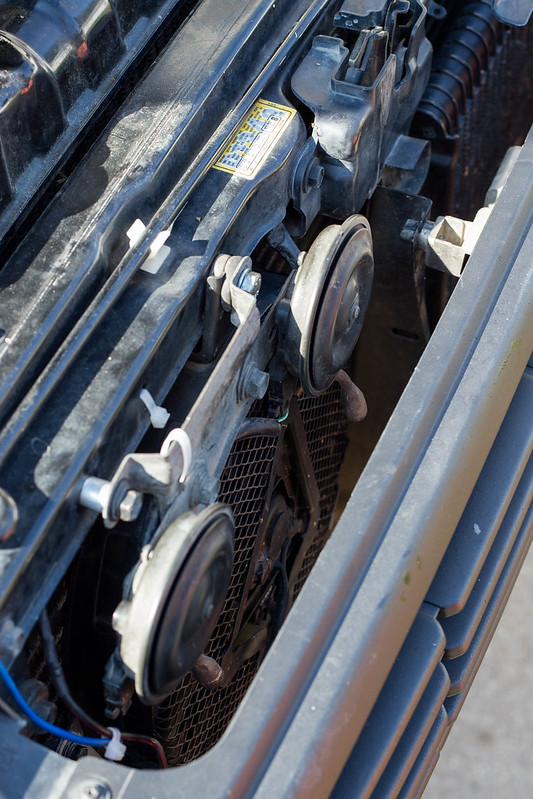

The previous owner had installed an Aux. Engine Fan that he sourced from an older 4Runner (2nd gen?). I think it was used to help keep the auto transmission fluid cool when towing, if I understood his explanation correctly. When we installed it (I actually did the install a couple years ago helping the PO out) we had to delete the horns to get it to fit. I totally forgot about this little detail when I bought the LX, and it bothered me not having the horn. I changed the fan mountings slightly to allow the horns to fit once more and still clear the hood. I also ran some thicker gauge wiring to negate any future issues with the fan.
20120904-IMG_1949.jpg by RickaShay24, on Flickr

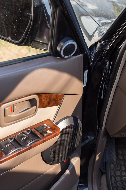

Here are a couple photos of the stereo post install. I installed the tweeters in the small plastic panel on the inside of the mirrors while the door panels were off. I thought I was so clever getting them to fit so nicely, until I put the door panels back on and realized that the tweeters would be blocked by the dash when the doors are closed. lol Serves me right for not checking in advance I guess.... I will leave them as-is because even though they are blocked, it still sounds 100% better than before.
Fronts:
20120904-IMG_1942.jpg by RickaShay24, on Flickr
Rears:
20120904-IMG_1943.jpg by RickaShay24, on Flickr

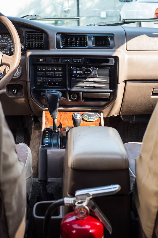

Headunit, Lev-o-gauge, and fire extinguisher installed/mounted:
20120904-IMG_1947.jpg by RickaShay24, on Flickr

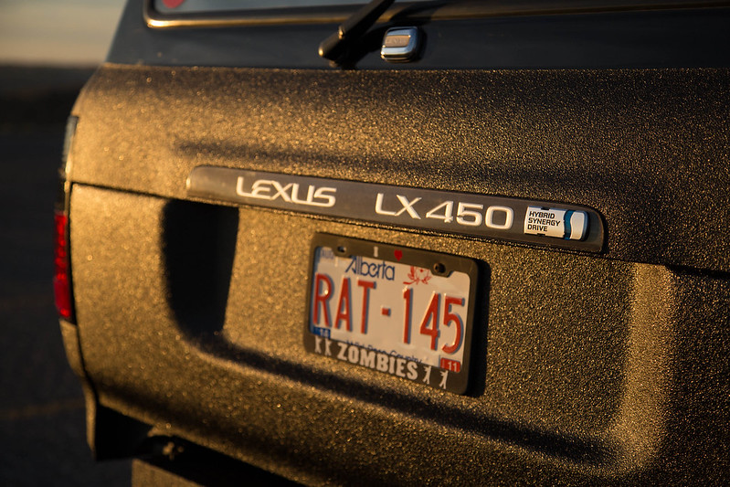

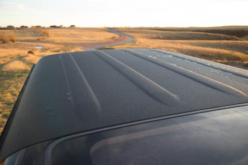

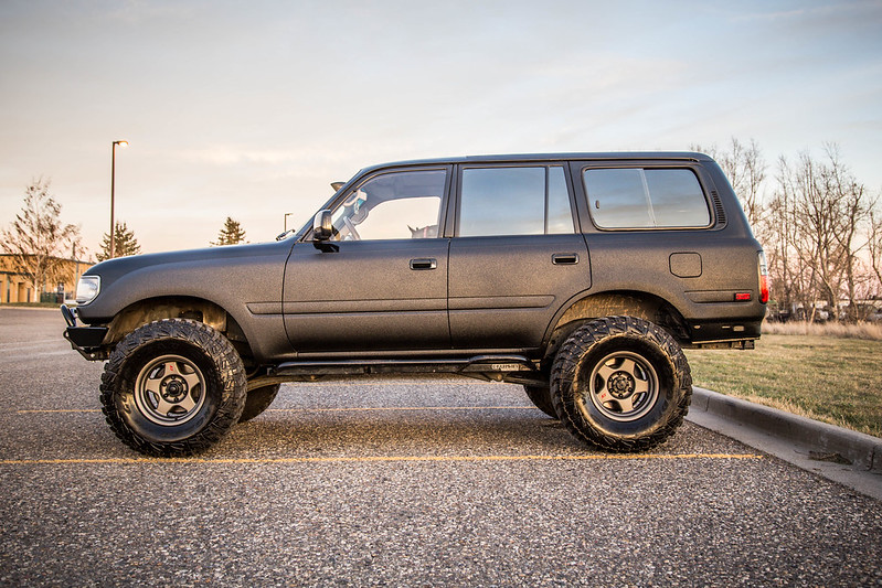

I somehow got lucky and was able to get home for the weekend. Cleaned the truck up, re-installed my Cruisin' Offroad sliders, installed the Slee bumper, did the washer relocation kit to make room for my ARB compressor under the hood, and moved my A/C dryer out of the way. Pretty productive day!
Here's some shots of my days labor and the new LineX:
20121025-IMG_1990.jpg by RickaShay24, on Flickr
20121025-IMG_1984.jpg by RickaShay24, on Flickr
20121025-IMG_1982.jpg by RickaShay24, on Flickr
20121025-IMG_1977.jpg by RickaShay24, on Flickr
Also did the roof:
20121025-IMG_1986.jpg by RickaShay24, on Flickr
20121025-IMG_1989.jpg by RickaShay24, on Flickr
