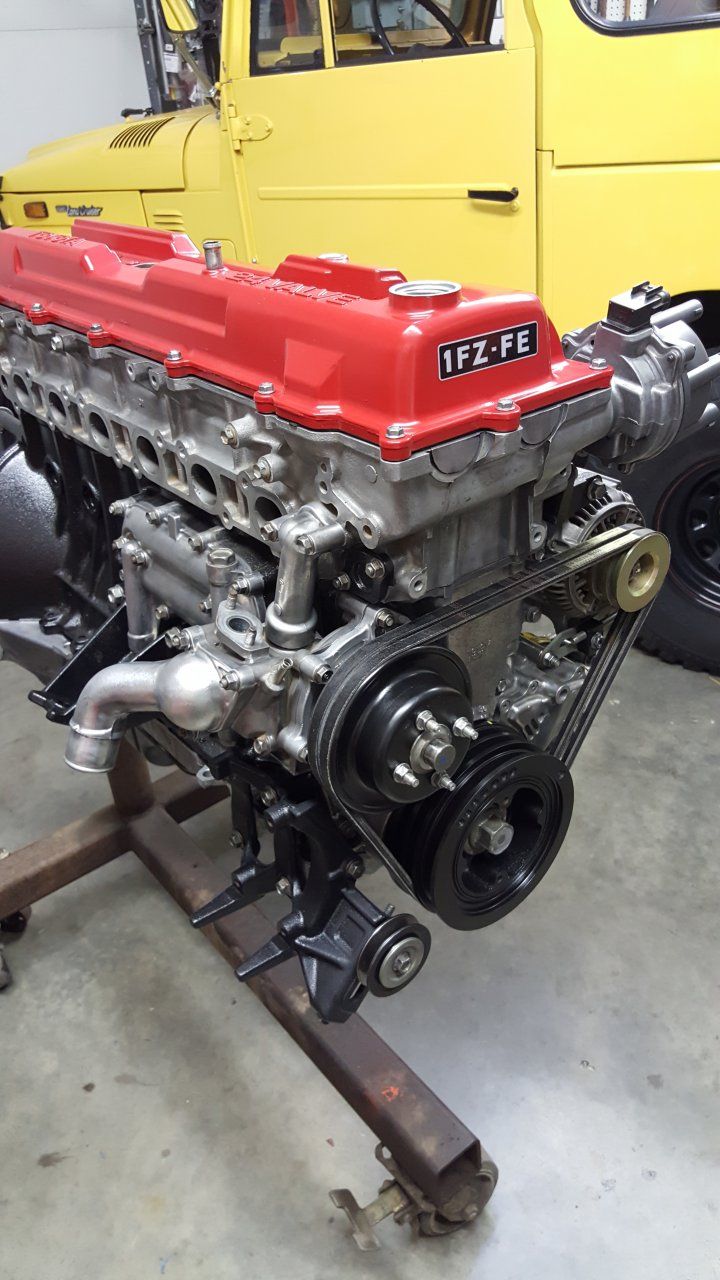

Alternator on. Exhaust manifolds, intake halves, and a few sensors and will be about ready for next week.
Looking really good there.... well except that blue, totally mucks up the the color scheme :hillbilly:

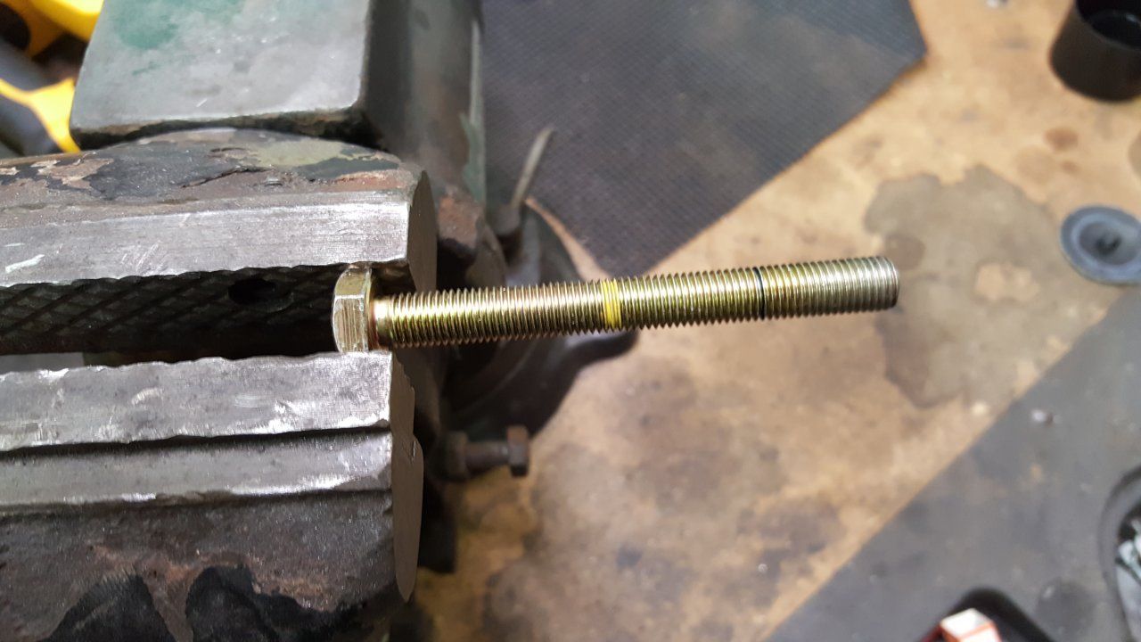

First issue ... I was forced to use the head that had 4 stripped exhaust threads (I had long ago sold the head from engine 2. :bang:)
I was relieved to find the stripped studs only went 0.450" into the head but there are 0.900" of thread available. I could find no longer studs so had to make them.

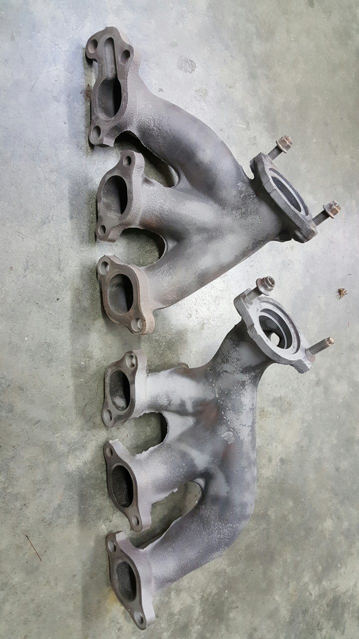

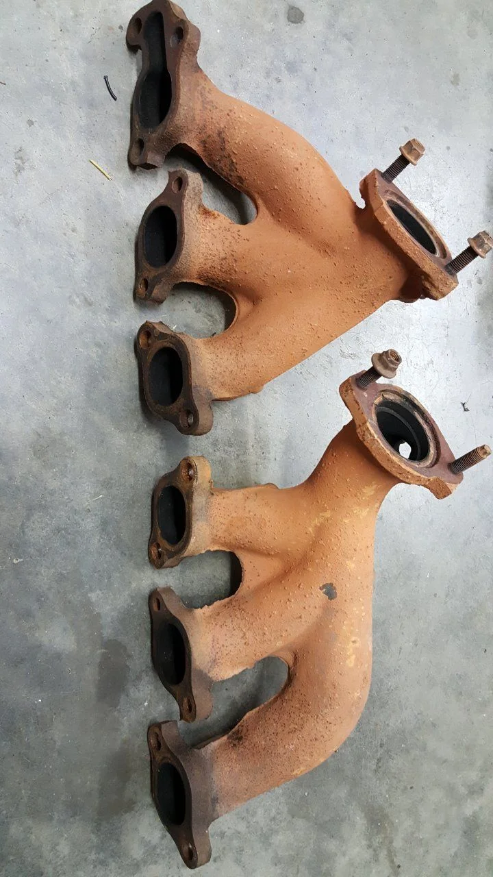

Then time to clean up the exhaust manifolds (a sign of sickness, right? Since the manifolds are only temporary)
Before ...

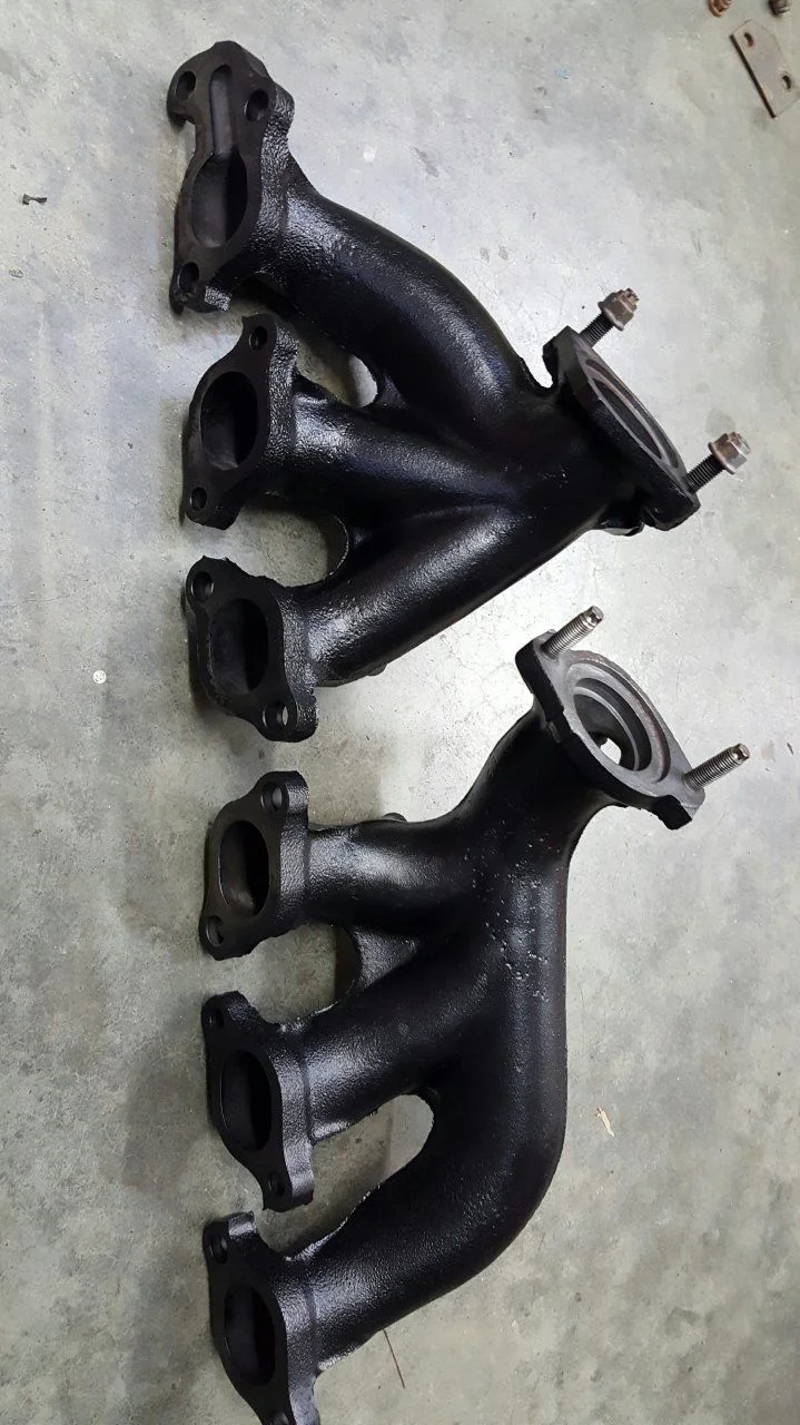

Some sand blasting

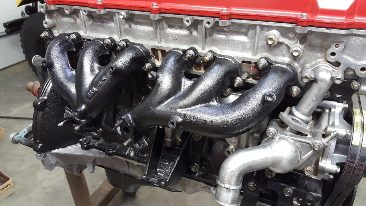

It's not really a fresh engine build unless it includes the smell of burning paint.

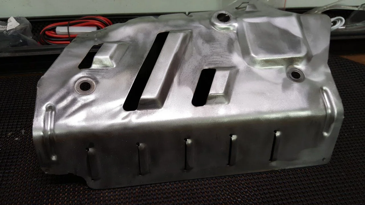

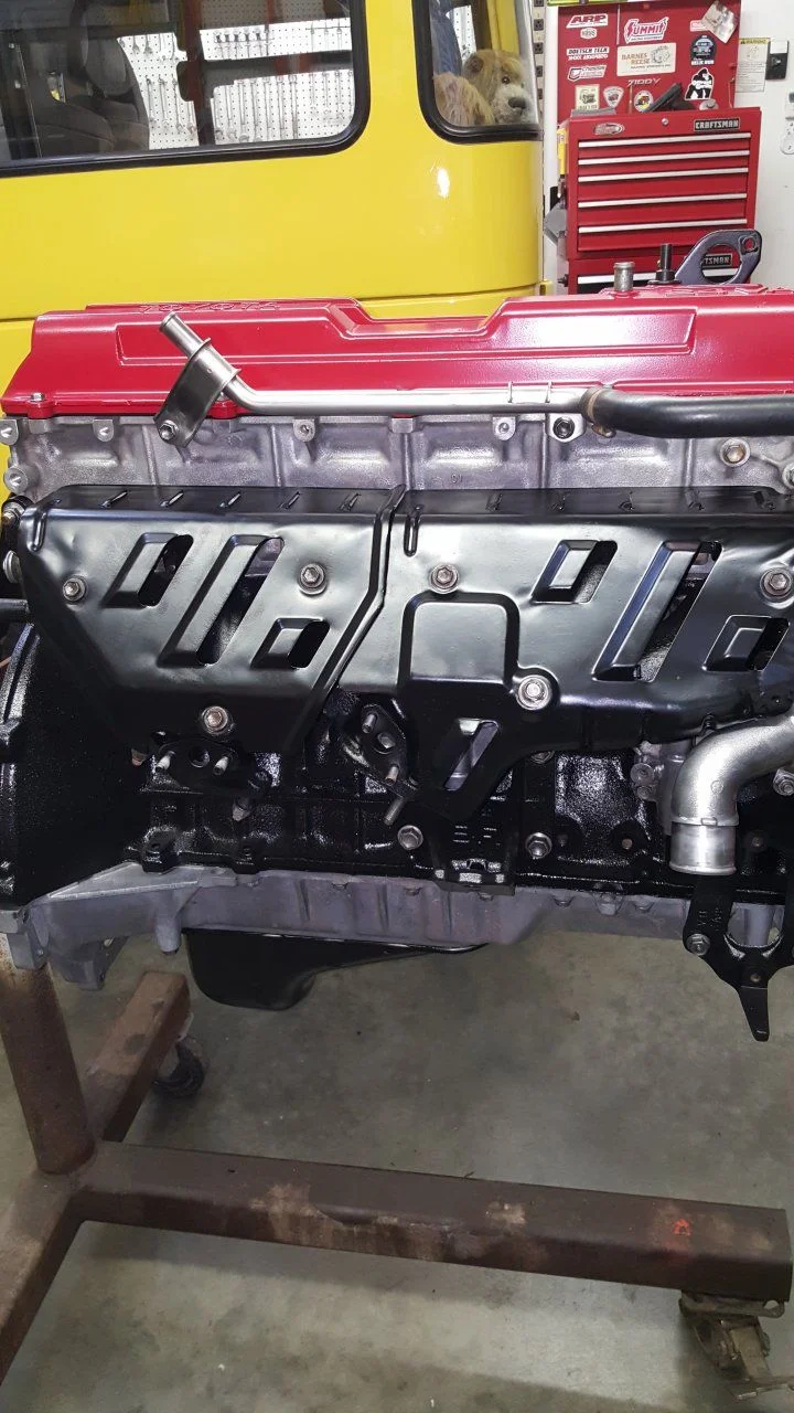

Now bolted on .....
So fresh and so clean clean.....

Will be running the PAIR (and EGR) for now ...
So that's pretty much it. Plan is to use the intake and throttle body off the old motor which Jason and I will start pulling Friday afternoon (special note of thanks to @jfz80 )
