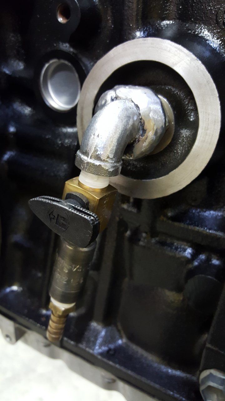

Last item in need of attention ... priming the oil galleys so we wouldn't be doing a dry start. Early chevies had it made ... stick a long shaft into the oil pump via distributor hole and spin it up with a drill. Toyota uses a gear driven pump so something different had to happen. I decided I was going to use an external pump to feed oil in through the filter boss.
The funny part ... I want to make a fitting to screw onto the filter threads. The threads are SAE ... 3/4 x 16. I think, heck, I got that. After 20 minutes of digging all I have is ONE 3/4 x 16 nut and it's a castle nut! Dang it.
Well, it ain't a castle nut no more....
Welded on a piece of iron pipe ....
And now have a fitting...
Oil priming ... part II
The pump I used is an old 1fz power steering pump. Took off the gear and turned it with a drill.
Pretty slick @Rice I had to make similar for pre lubing the Vortec and LS motors for the same reason. I used a SBC oil pump in a 5 gallon bucket.
I gave some thought to the chevy oil pump idea but was too lazy to go hunting down whatever box I have one stored in. This is plan b.
I believe version 2.0 of this SST needs to tap into the drain of the oil pan so I can circulate as much oil as I want.
Here ya go, drilled and tapped extra plug. I use my system every couple of months or so, so I figured long term.
That's the ticket. And once you're done with it your turbo oil can drain there. :D
