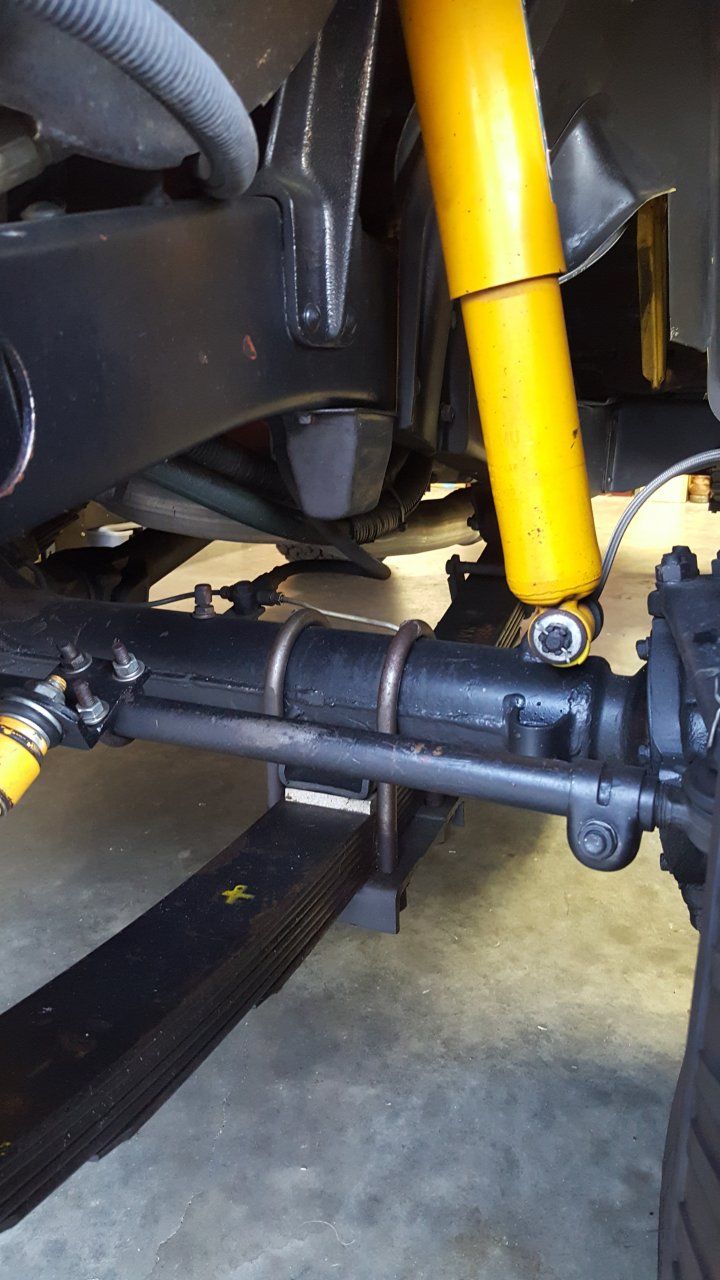

@Rice have you used that paint on frames or axles, leaf springs? Long term results? I am always on the hunt for better paint products. Quarts? Thin with acetone?
Looking good Rice, those words have a familiar ring o_O
Hi Stan.
The chassis paint is exclusively what I used on the frame and axles of the 40. Aside from it being dirty right now you can get an idea. I sprayed this in 2001. Note, the paint on the OME springs is what came on them out of the box.
The stuff is pretty thin right out of the bucket so I shot it straight, no thinner.

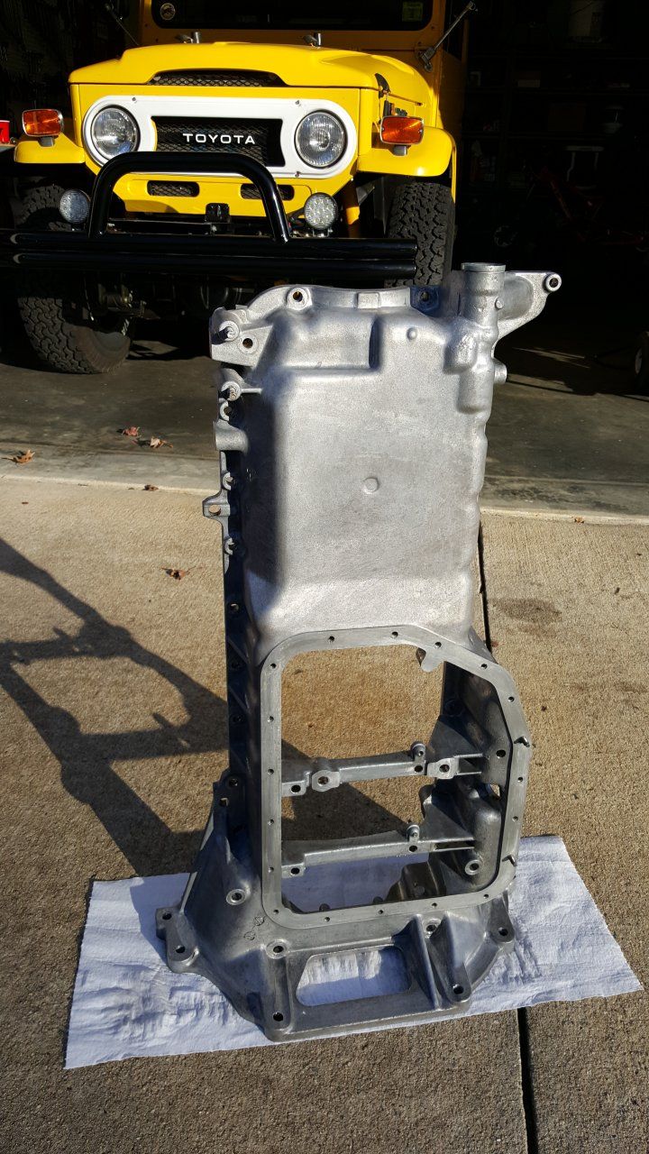

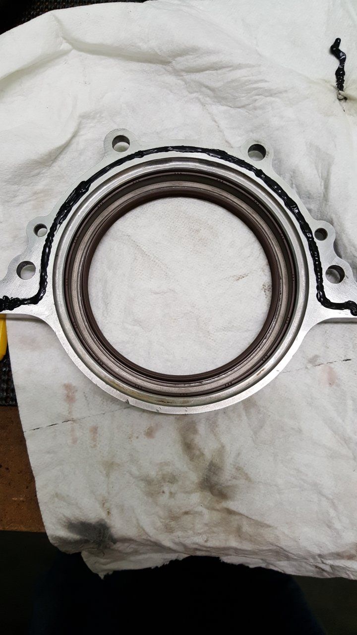

A little closer to ready. Rear main seal and upper pan complete. Paint was still wet on the lower pan; it and the oil level sensor will go in tomorrow.
Picture heavy update ....
Lower pan installed ....

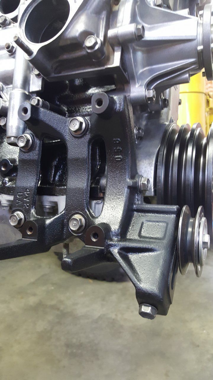

A/C bracket ready:
Continued .......
Installed A/C bracket:

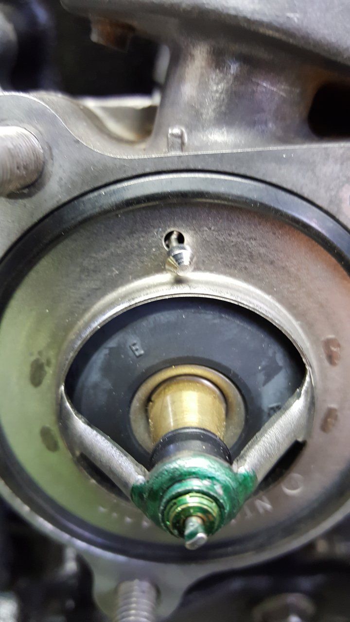

And did some cleaning on thermostat housing.
When installing t-stat don't forget to align your "jiggle valve". :bounce:
Then on with the return neck:
