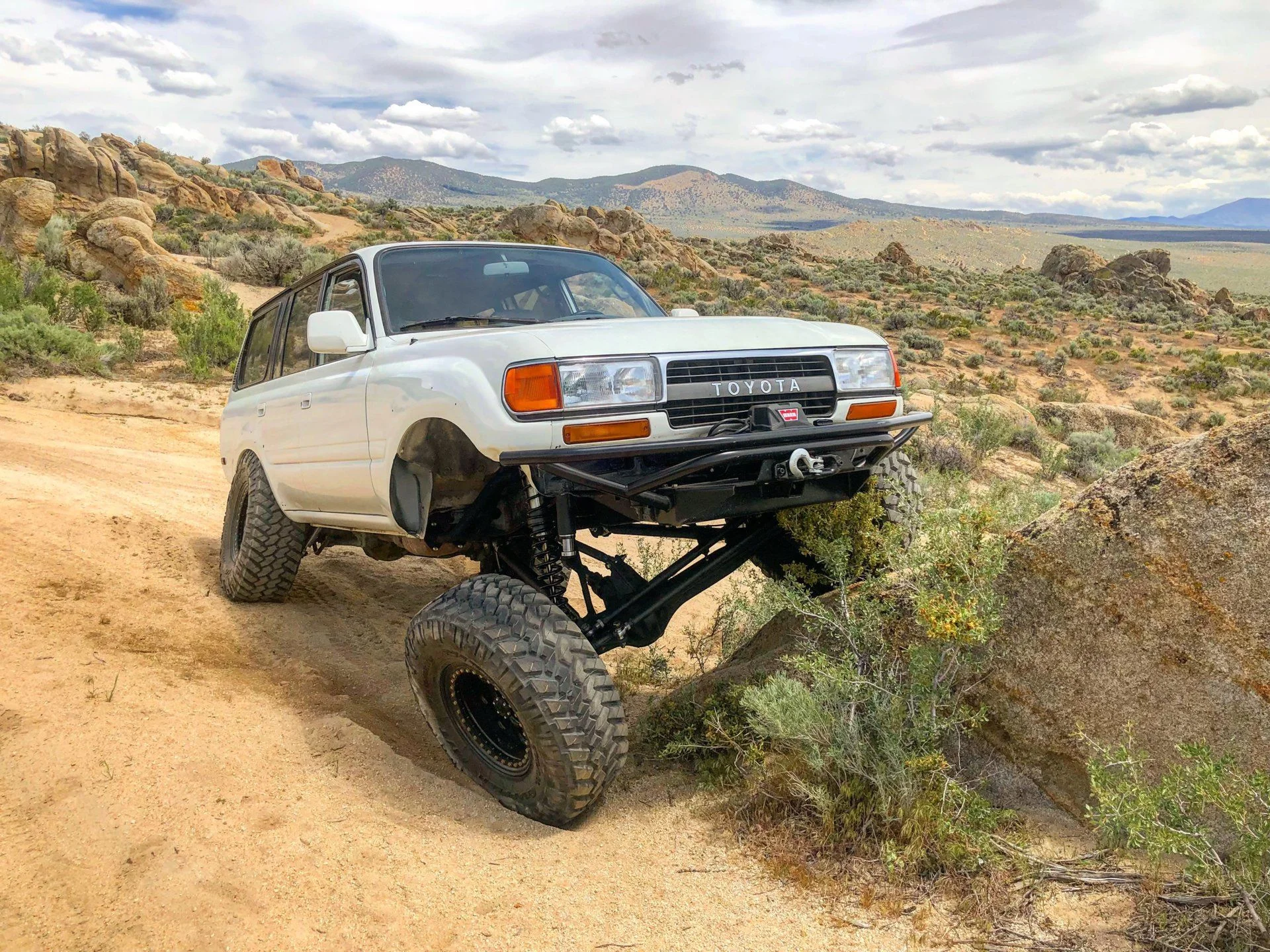

That looks amazing.
Is 14" travel up front a good match to 12" travel in the rear?
I really have no complaints with it honestly. Goes everywhere I point it with a really smooth ride.

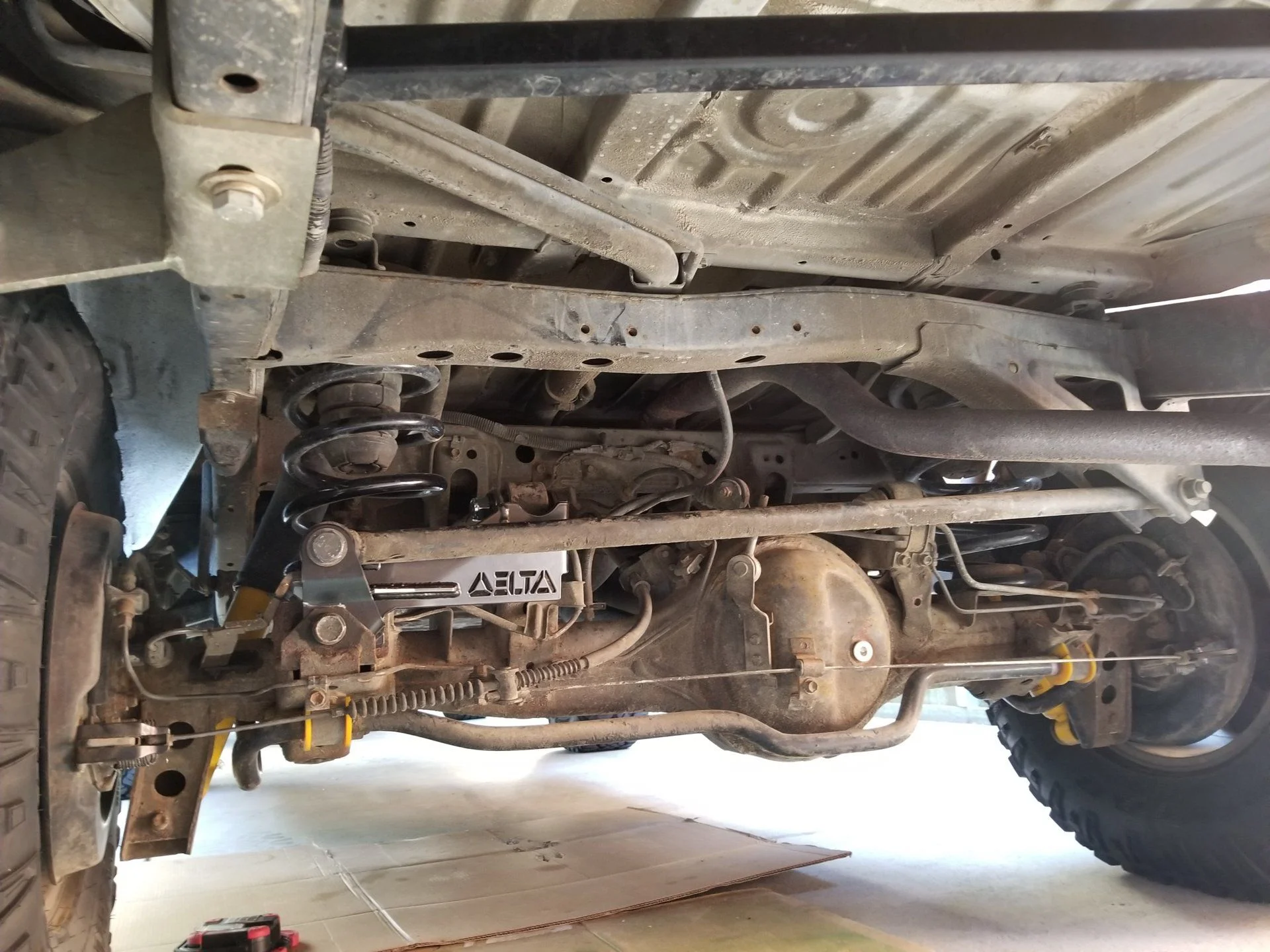

Just ordered the panhard bracket can’t wait to get it installed on my 80. I think I’ll be the first 3 linked 80 running it.. it drives great on the highway and around town so we will see how this helps her out.![]()
I got it to installed and I’ve driven about 100 miles with it, in town and on the freeway. Definitely made a difference, I have less body roll, and wandering now. Great product!
Well, I'll be damned. I just test drove my 80. Took the windy mountain road and the highway with the big sweeping turns. I would dare to say this bracket made as much difference as my castor plates in terms of handling. That sense of the 80 "lurching" as it entered a turn and me having to correct the steering a bit to get it back on line is now gone. It turns out my 80 was not too top heavy and my stock anti sway bars are stiff enough and my caster is perfectly adequate. Feels like a completly different truck. Amazing what that simple bracket accomplished.
Question: Do I need adjustable front and rear panhard bars to run this? Or can I keep my stock rear panhard and just run an adjustable panhard up front?
Unless you have a “just big enough” lift to NOT want to run a 5” bracket (due to needing extra bumpstop drops and therefore losing uptravel), you will be best off with stock panhard.Question: Do I need adjustable front and rear panhard bars to run this? Or can I keep my stock rear panhard and just run an adjustable panhard up front?
