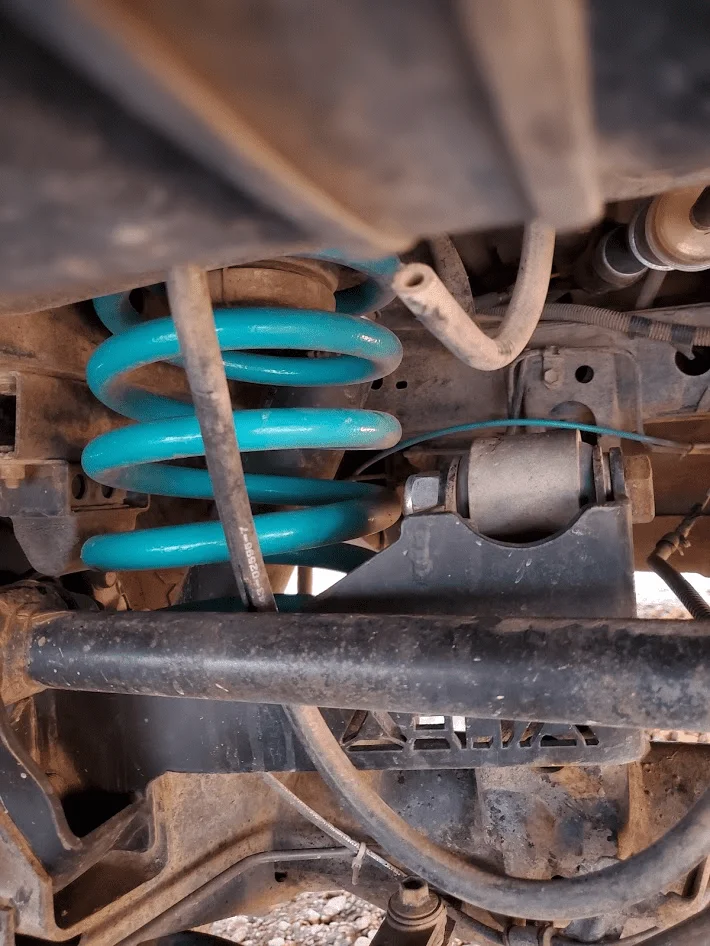

I installed the newer high clearance version, on a 1997 LX450 so here are my observations.
1. In Japan and other RHD markets, the rear Panhard bar is in a better orientation/direction relative to the front vs LHD markets.
2. I’m running the Dobinson tapered coils and ran into the same issues as the Slinky folks. The track arm bolt is too long and contacts the coil. I cut off about 10mm of the bolt using the stock upper control arm nut as a guide and thread chase. The nut is close, but shouldn’t make contact with the spring. Grinding of the bracket was not required.
3. Ideally, I would prefer to remove the coil spring and install the bolt in the opposite direction for added clearance. However, I didn’t have spring compressors on hand since I usually rent them. Pro Tip: if you own Slinky or Dobinson coils, buy spring compressors. They are cheap.
4. All of the pictures on this thread do not show the spare tire in the stock location. You can work around it, but it does make things a tad more difficult.
5. You will be in an awkward position to apply the necessary 181 foot pounds of torque to cinch down the bolts, so keep that in mind if your upper body strength is limited.
6. The bracket sheared the retaining clips for the ABS wire. Only the outside one can be retained if you unclip it before installing. I didn’t do this, and now it is zip tied to the bracket.

Only thing I'd like to address is (for anybody who has yet to install), there really is no need for spring compressors if the bolt is touching the spring, the spring should be able to be easily moved out of the way with an appropriately sized stick/prybar/2x4/etc.
Thanks for the notes!
Only thing I'd like to address is (for anybody who has yet to install), there really is no need for spring compressors if the bolt is touching the spring, the spring should be able to be easily moved out of the way with even an appropriately sized stick/prybar/2x4/etc.
Mine do. I removed the lower shock bolt, and used the factory jack to unseat the spring enough to unseat it, and that wasn’t enough. These springs have a massive amount of droop. The fat coil sits right in front of the bolt in my rig.
I’m sure for other coils, they are fine, but these tapered coils are really thick on the lower portion.
I'm just talking about for getting the bolt in there, not installing/removing springs. What I'm saying is you should be able to move the offending loop of the coil enough to slide the bolt in from the front side by just pushing the spring up or down just a little.
For sure, on most. I couldn’t on mine. They moved a little, but I couldn’t unseat enough to freely rotate. If I cut a 2x4 spacer and used the factory bottle jack, I could have pushed the axle down more perhaps.
Removing the driver side rear tire did make it easier in my case.

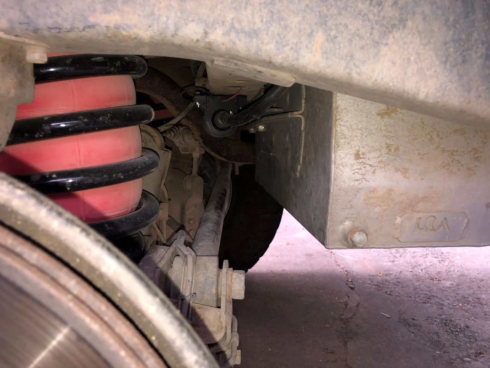

@alia176 in your post on page 8 comparing panhard rods, I notice you have airbags installed. When you removed the upper control arm link bolt did you need to deflate bag or remove your spring to get bolt out? Or did supension sag allow bolt to miss coil? I have OME springs and attempted to install PLB earlier today and had to abandon because spring coil blocked bolt removal and I did not want to chance puncturing bag prying on spring with sharp metal instruments:cautious:. At the time, I didn't think to deflate bag:bang:. Will give it another try soon, but am interested how other air bag owners got it done.
Also, has anyone with this PLB and stock exhaust have any contact issues (rod hitting exhaust pipe) when going over bumps? When I was pushing up panhard rod (for clearance) after disco-ing axle end, it looked like it wouldn't take much upward axle movement for rod to hit exhaust pipe. Pics are from earlier this summer, not today.
Hey Tom,
I'm trying to recall if the bolt interference with the bag was an issue but it's been a while. When it warms up today, I'll try to remember to crawl underneath and jog my memory. I wonder if I had turned the bolts around to facilitate installation/removal process :hmm: .
@alia176 Thanks, Ali! My big concern is tearing or puncturing air bag. I also have air bags on my F350, but they're different with leaf suspension. I think I'll be ok if I totally deflate bags and let supension sag to the limit when frame is jacked up. I should be able to control sag with a jack under the axle to find a spot where the bolt will miss the coil and with the bag deflated, I'll be able to push it out of the way if necessary.
Well, the PLB is installed. Avoiding the air bag was the biggest challenge. Took the rear wheels off to simplify jockying the axle up and down. Turned out to be the best idea because it also gave better view and access to upper control arm as well as better access to axle panhard mount for torqueing bolts. Maybe it was avoiding the aux fuel tank which always seemed in the way, but with the wheels removed, it sure opened it up. With the axle totally sagged, the upper control arm bolt slipped in between the coils. I used a putty knife to protect air bag from being damaged by bolt head while punching it out.
Panhead bolts are now 1/4" from being level compared to approx 2 1/2" difference before install. 1st test drive on highway and through town didn't reveal much difference. But I'll give it some time and some dirt roads and see how it goes.
apologies for the delay. As I suspected, I turned the UCA bolts around to facilitate the removal and installation. I changed the springs out and didn't re-install the air bags.
The answer to your question about the panhard rod hitting the exhaust during full suspension cycling is no. Mine has never close to making contact.
