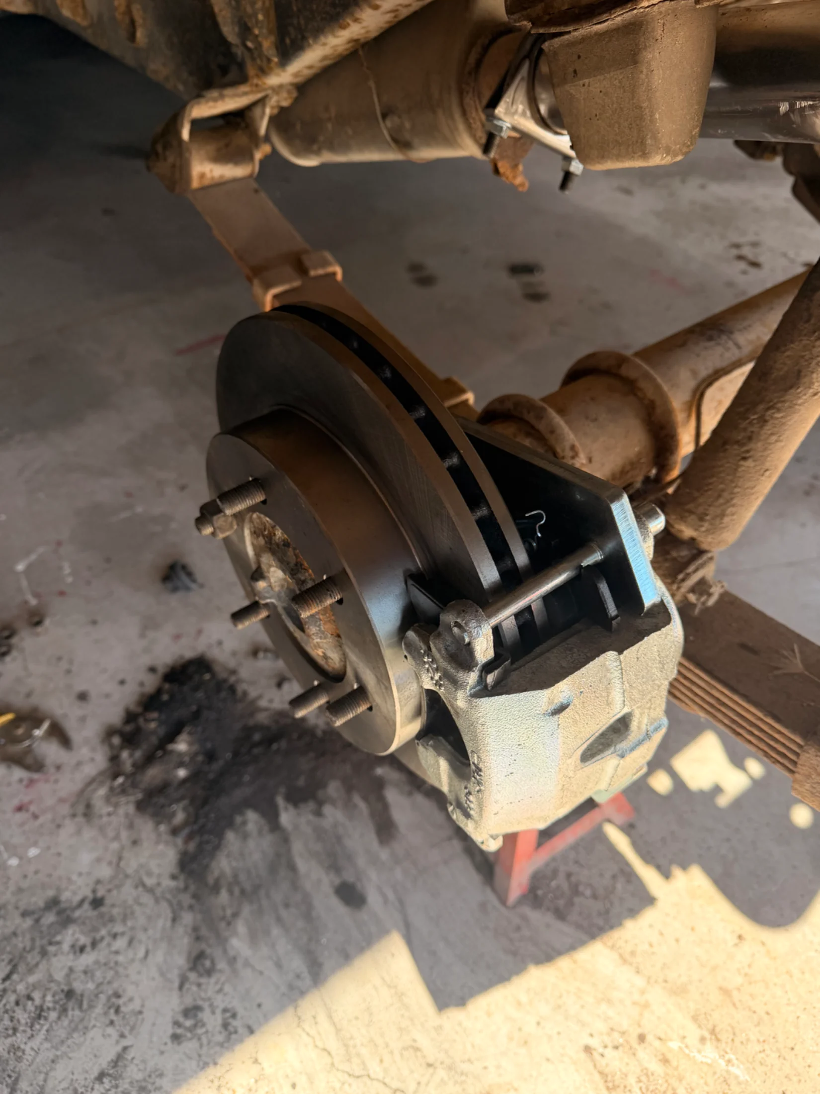

I’ve got some updates on the 67’. Got my HEI distributor from JTO installed. Man what a difference. Thing fires up and runs really nice. I also started my 4 wheel disc brake conversion as well. It’s going smoother than I thought it would. *knock knock
I’ll keep updating the progress as I get to it.View attachment 4119796
So you cut the backing plates off instead of opening up the rear differential? You passed up THE BEST OPPORTUNITY to inspect the rear bearings and races, as well as replace the axle seals. :rolleyes:
I’ll be digging into that soon enough.
