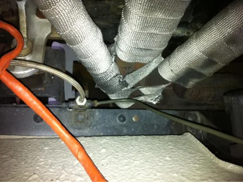

It looks like the adapter part # is wwmcspcr and was $45. The master is part# 260-7563 and was $146. This was a year ago.
I was wrong about the routing. I just went over the firewall and down to the frame then back to the rear.
The straight thru fitting that's next to the starter on the top of the frame got moved forward and replaced the T or 3 way brake fitting that supplies the right front brake. This way you don't have to try and come up with a 9mm plug.
The front circuit ends here.
This is why it is important to save the 9mm fittings. You can flare it on to a new line so it goes to the left front brake from your master.
Here you can see where the rear line comes off the front of the master thru the proportioning valve then up and over the firewall and down to the frame, then back to the rear axle. You can flare in the proportioning valve when you go with discs in the rear later.
