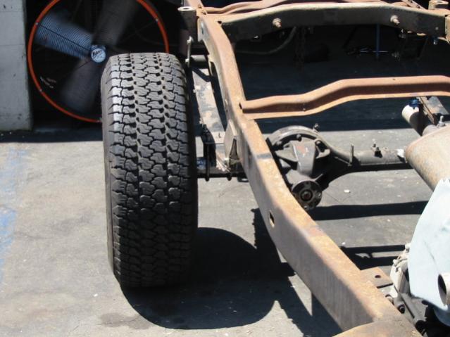

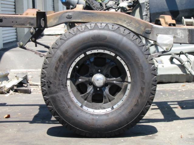

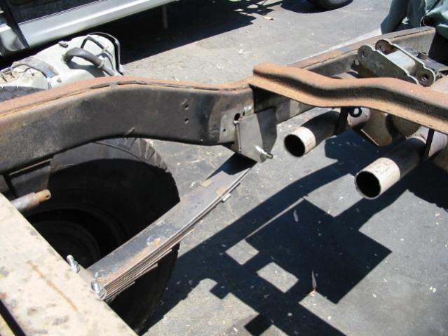

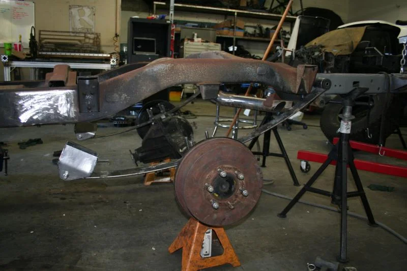

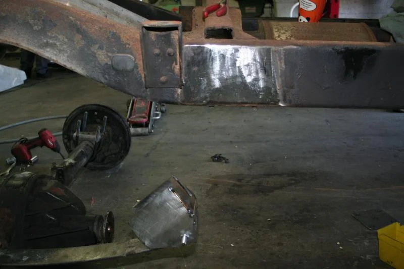

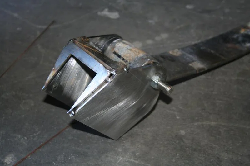

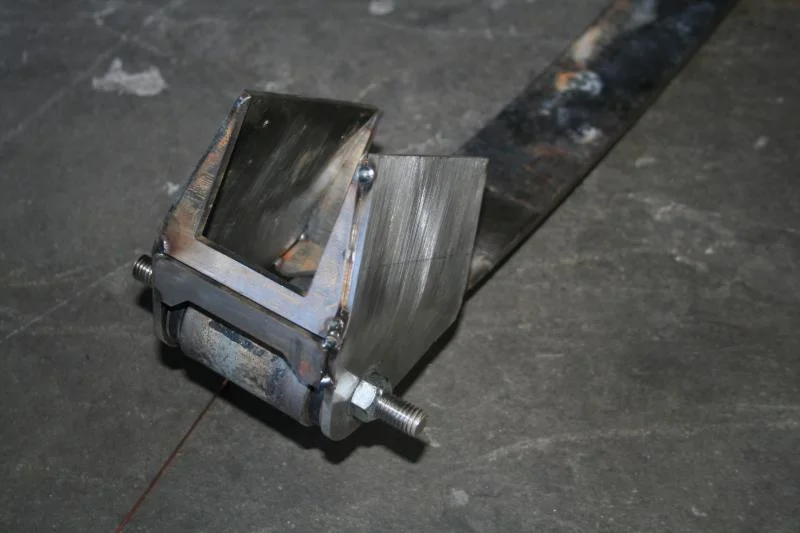

We'll we got some rear spring perchs mocked up and are probably going to modify the body mount back here. Not a problem though. Should have the rear done by the end of next week. Thanks to my buddies at Richer Racing in Oceanside for all the fab and support. :D I'll post em as I take em. Later all.

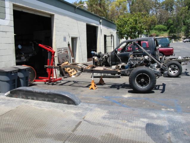

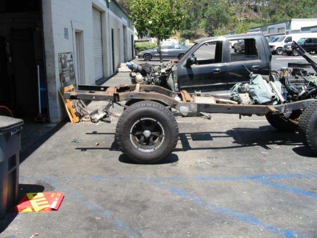

Rear end Mocked up
We'll, we got the rear end all mocked up where it's pretty much going to be. We just need to check the pinion angle and we can weld it up. I still need to add the traction bar. We'll tackle that next. Then off to the front 3 link:crybaby::frown::rolleyes::D:grinpimp::meh:

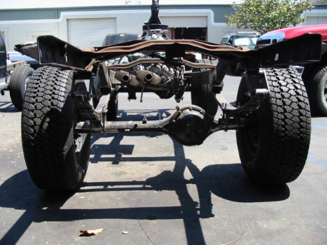

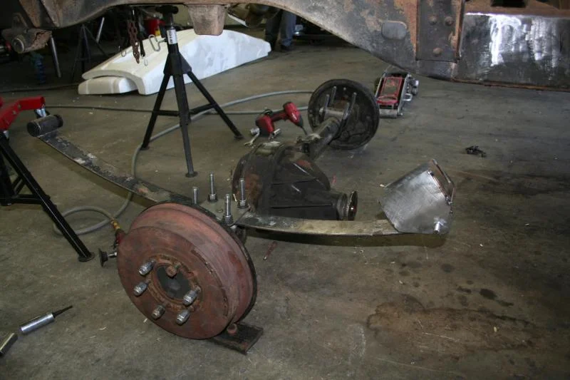

Nicer to be wider
It's going to be nice with the wider FJ62 front and rear axles. See there is more space from the tire to the frame. Noticeable to me anyway.:ban:

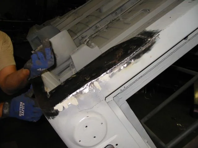

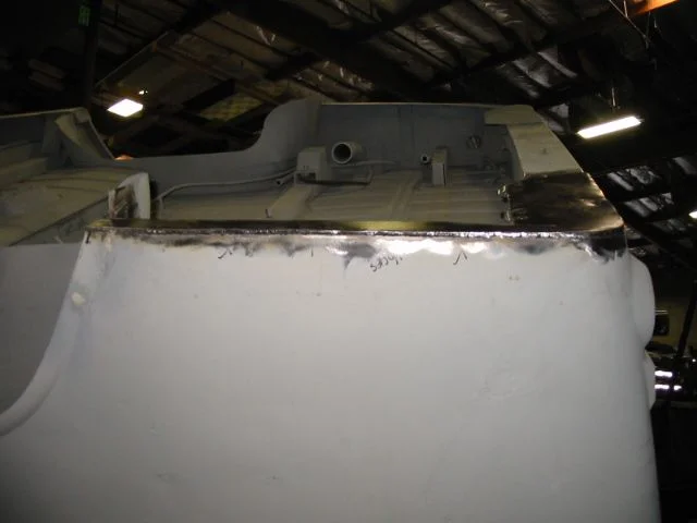

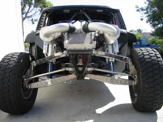

Well, I got my buddy Noah helping me on this body. Got the rear corners bottom patches on and welded. Should have all sheet metal welded on in the next two weeks, then the BONDO. Check out by buddies Dezert Racing Toy he built from scratch. COOL s*** and very fast:grinpimp:

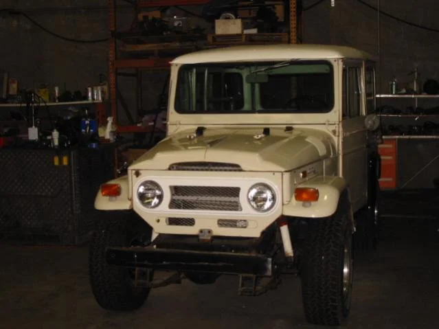

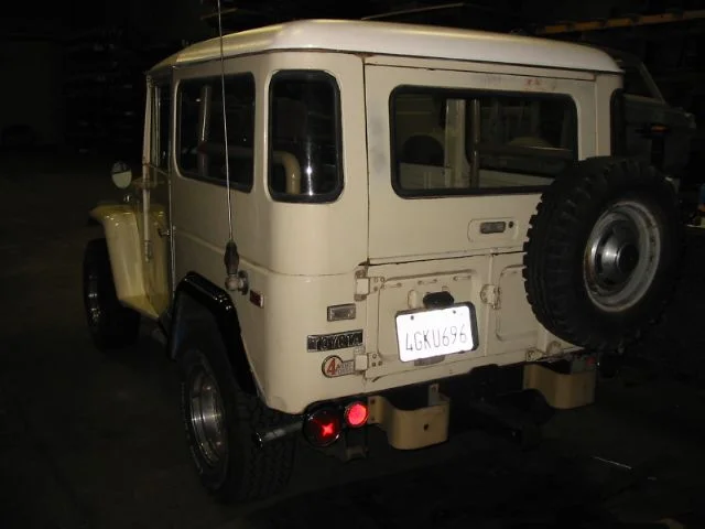

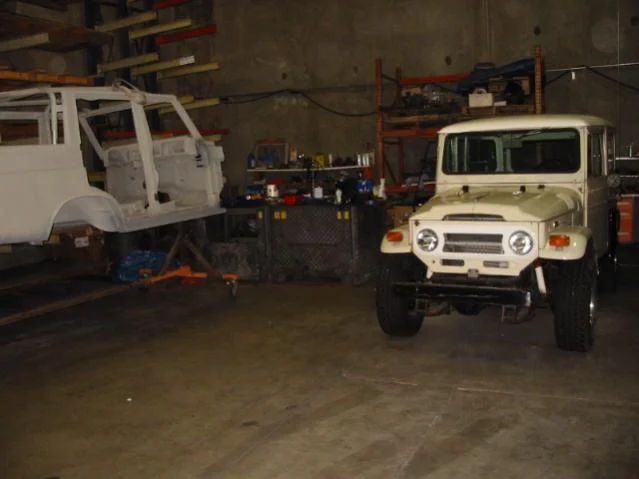

I just bought another one. :crybaby:1971 FJ40 in descent shape. It's got a 351W V8 and C6 Auto. Got a really good deal. His wife wanted it gone. That's funny because so does mine.:idea: Anyway. Now that a new year is here, I'll get back to my 55 project. Front suspension in designed and will be fabbed in the next couple of weeks. Keep ya'll posted.:cool::cool:
