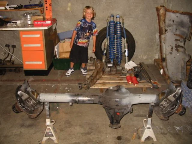

more body work
I've got the sheet metal pieces cut out for patch work. Almost done cutting the rockers for the sliders to fit both side and rear. :grinpimp::bounce:

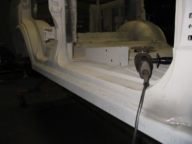

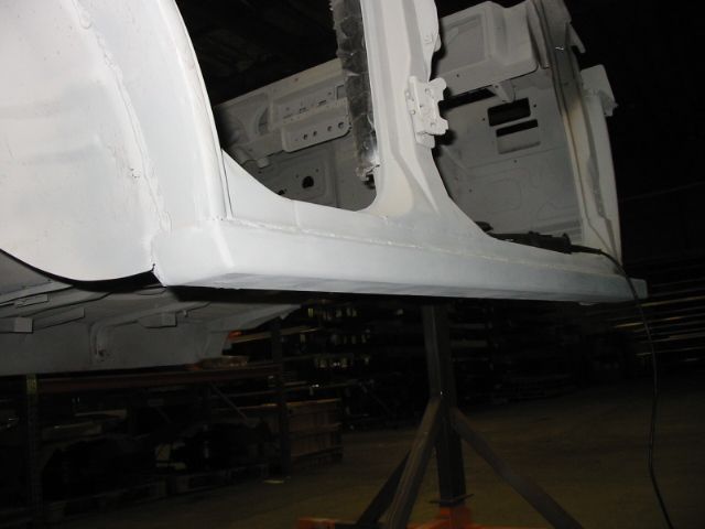

Sliders getting done
Well, I had some time to get the sliders fabbed and welded on. 2"x 4"x .250"wall should be stout enough:mad:. I'm welding them to the body while it's off, and them I'll put some supports to the frame after they meet again. I'm going to run them all the way to the front wheel well. I've pretty much got all the bad metal cut out and have made some patches. I'll get those welded in sometime soon. Gotta keep going. Gotta keep going. I keep telling myself. I'm afraid to stop, because you know, sometimes you stop for too long:eek: My business has been slow, so I seem to have a little time during the day to put some time into it. I'll post more as I go. Later all:beer:

Pass side slider is in!!!
Noah,
I'll find out what day would work. I'm going to do my best to keep the 45 if I can. If I can pull if off, I definitely will. I'm going to call Dom and see if he wants to come over and whomever else might want to do a "work on the cruzer night". I'll provide the place.
We just got the passenger side slider in and welded on both sides. I trimmed the body behind it to clean it up and more clearance. Now the drivers side. We did a patch job on the pass side door jam. I'll need to do some grinding to blend as best I can. I'll be in touch.
