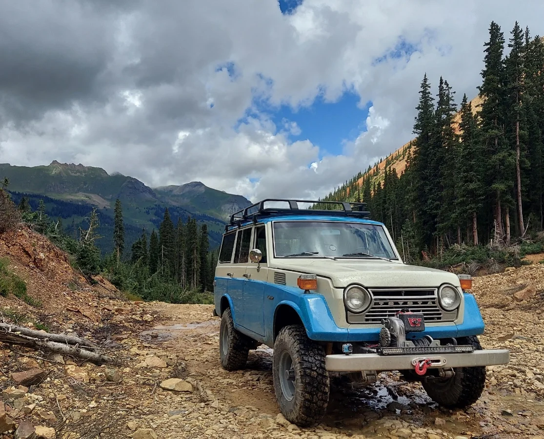

Residual Boulders 79 Pig Build - Picture Overload.

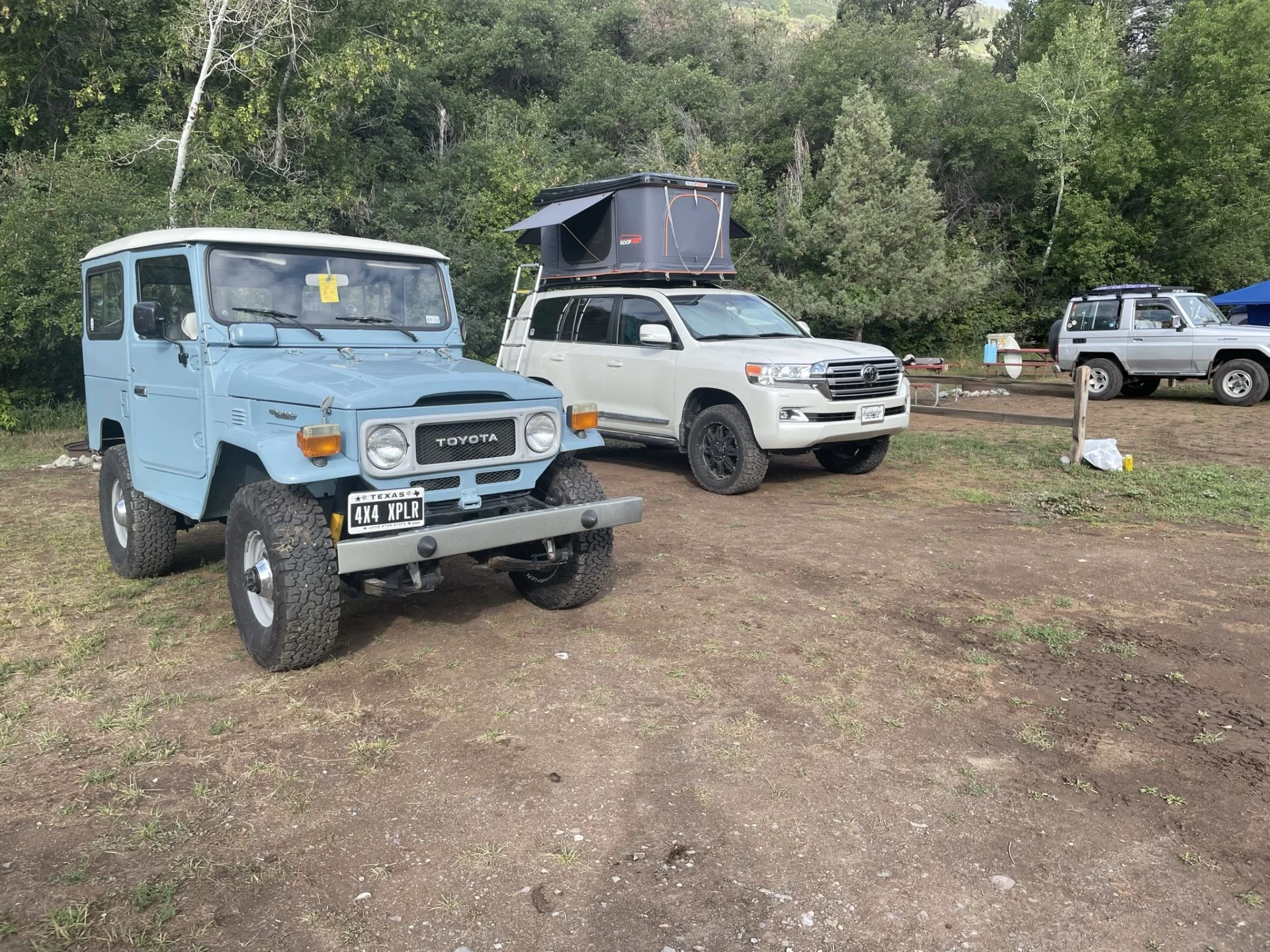

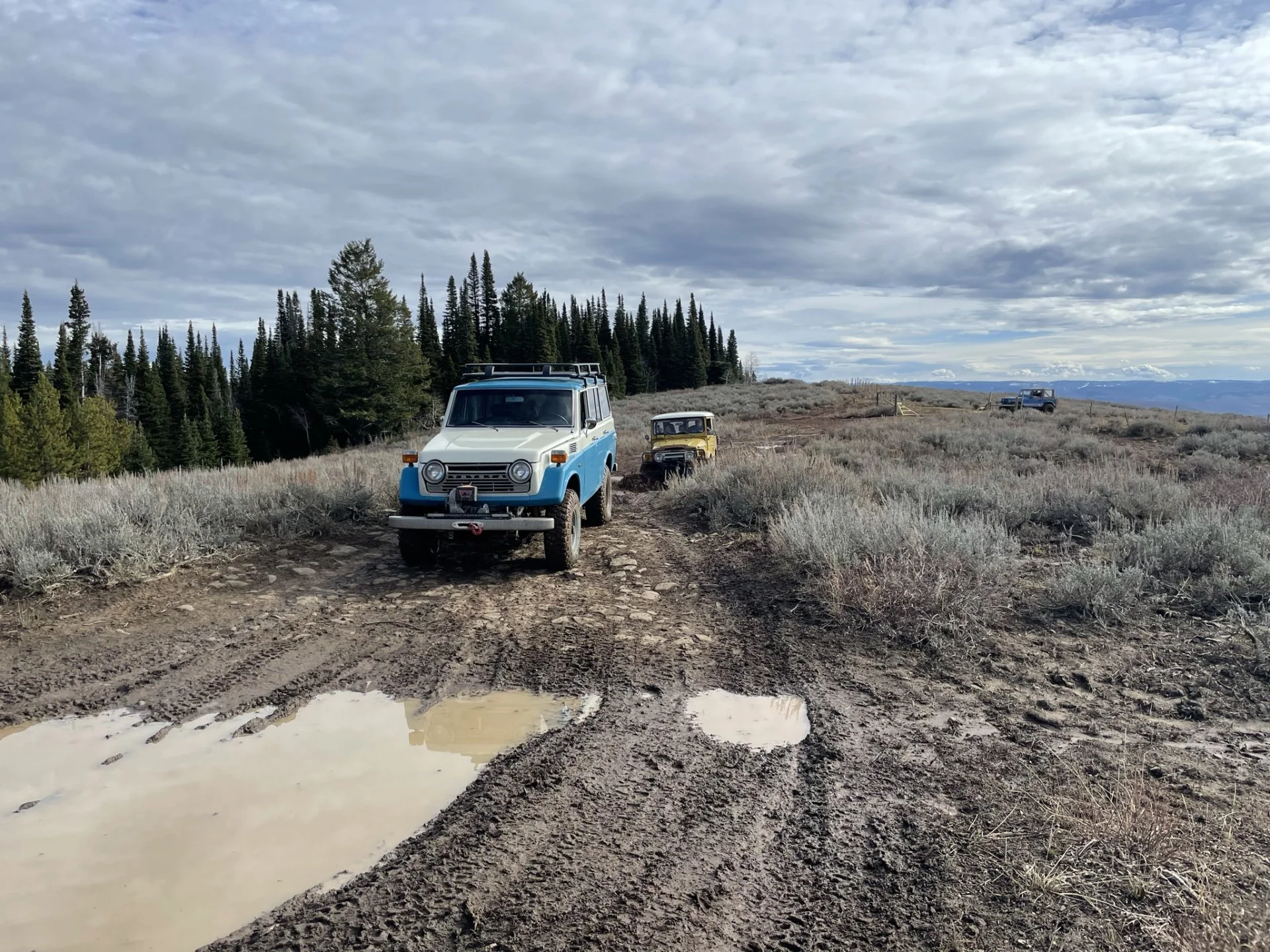

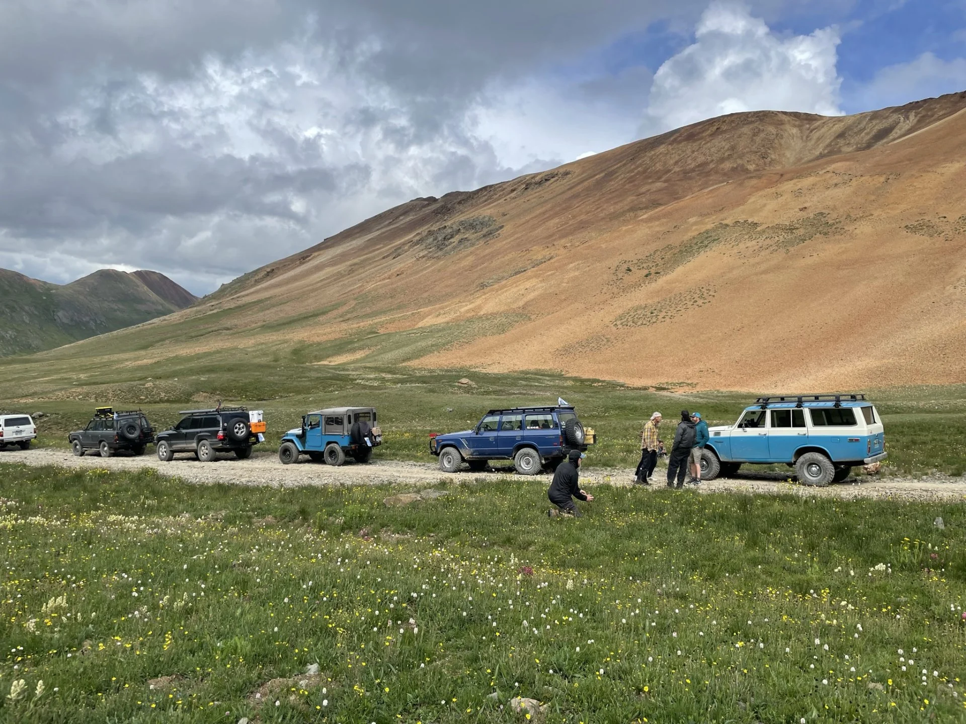

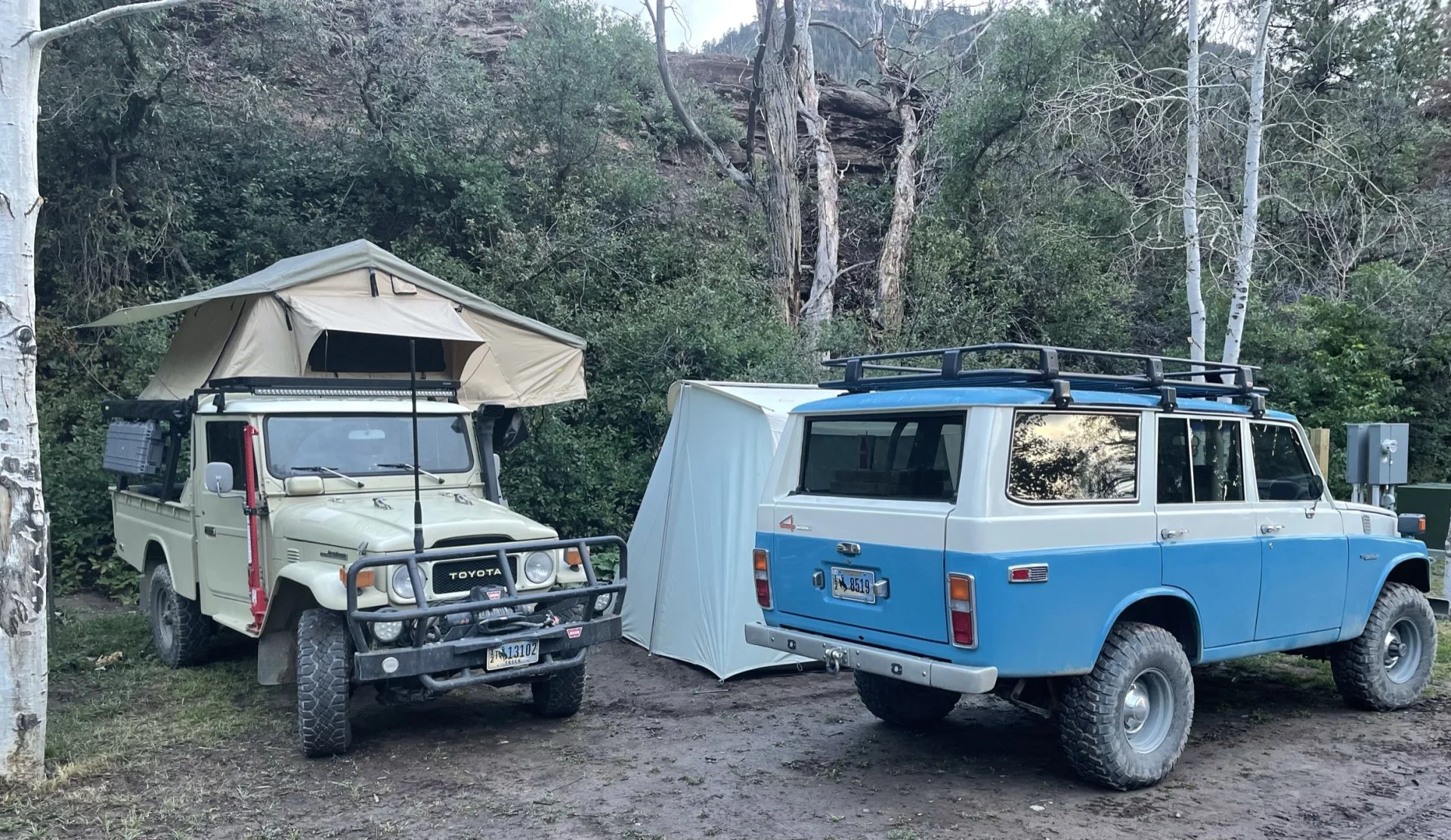

Lots of nice people at SAS #5. I was happy to see another 55 there belonging to Classic Cruisers. I didn't take enough pics, so many cool cruisers there. If yours is in the pics below, comment and tell me which one is yours.

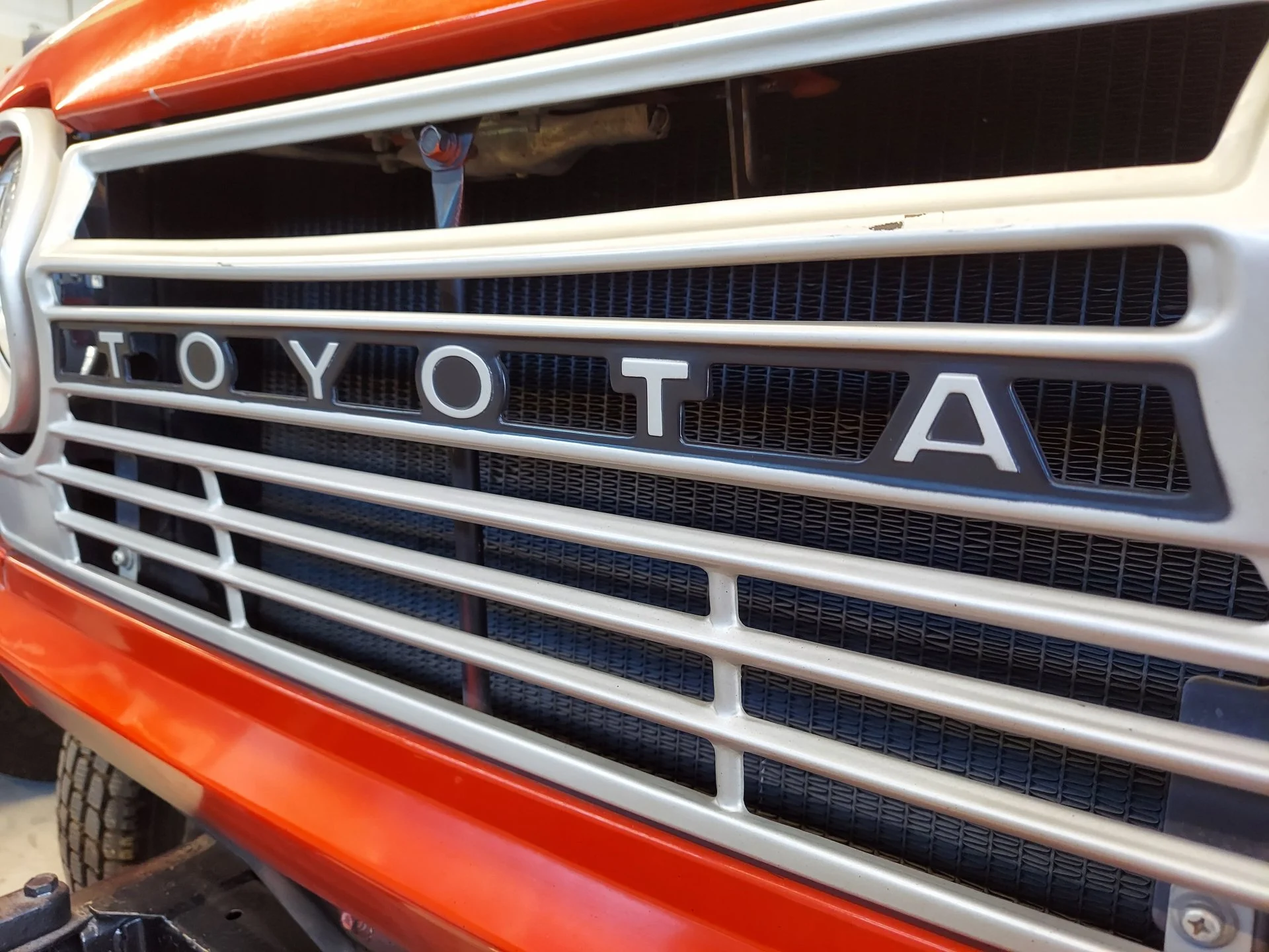

The grille is particular to 1979. It's cut out around the TOYOTA letters. Super rare. If you want to re-do the accent around the letters here is an untouched grille to copy.

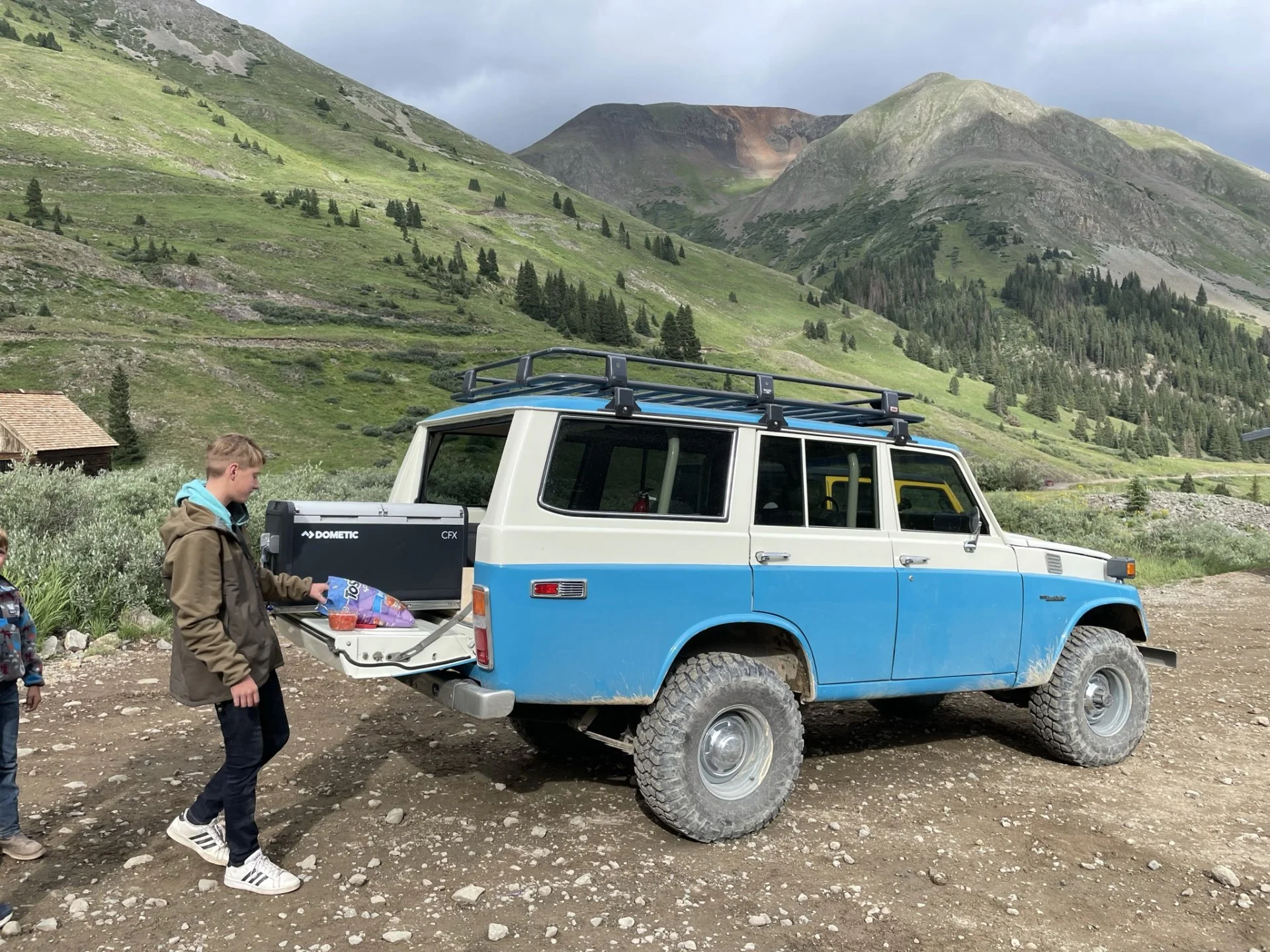

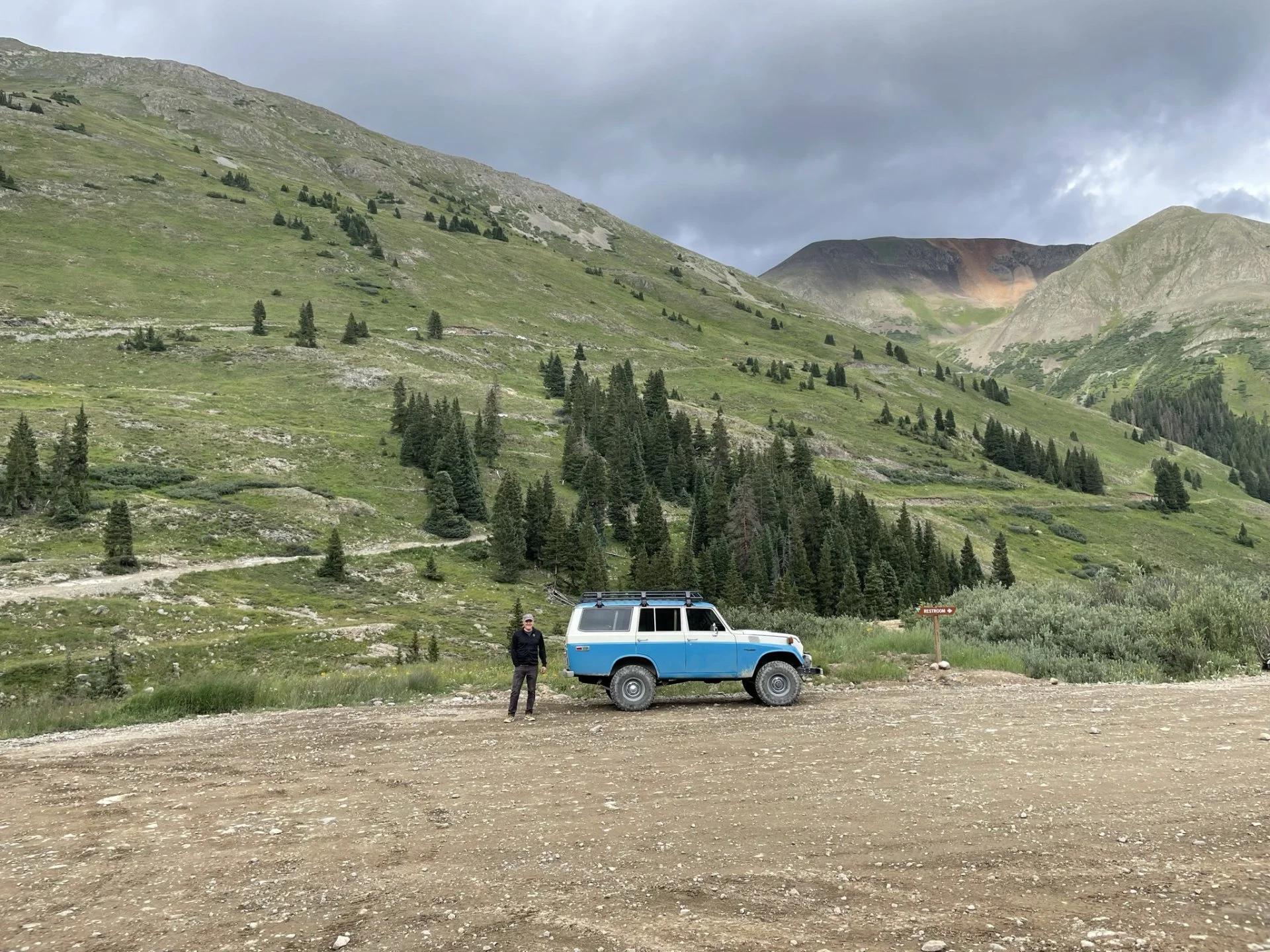

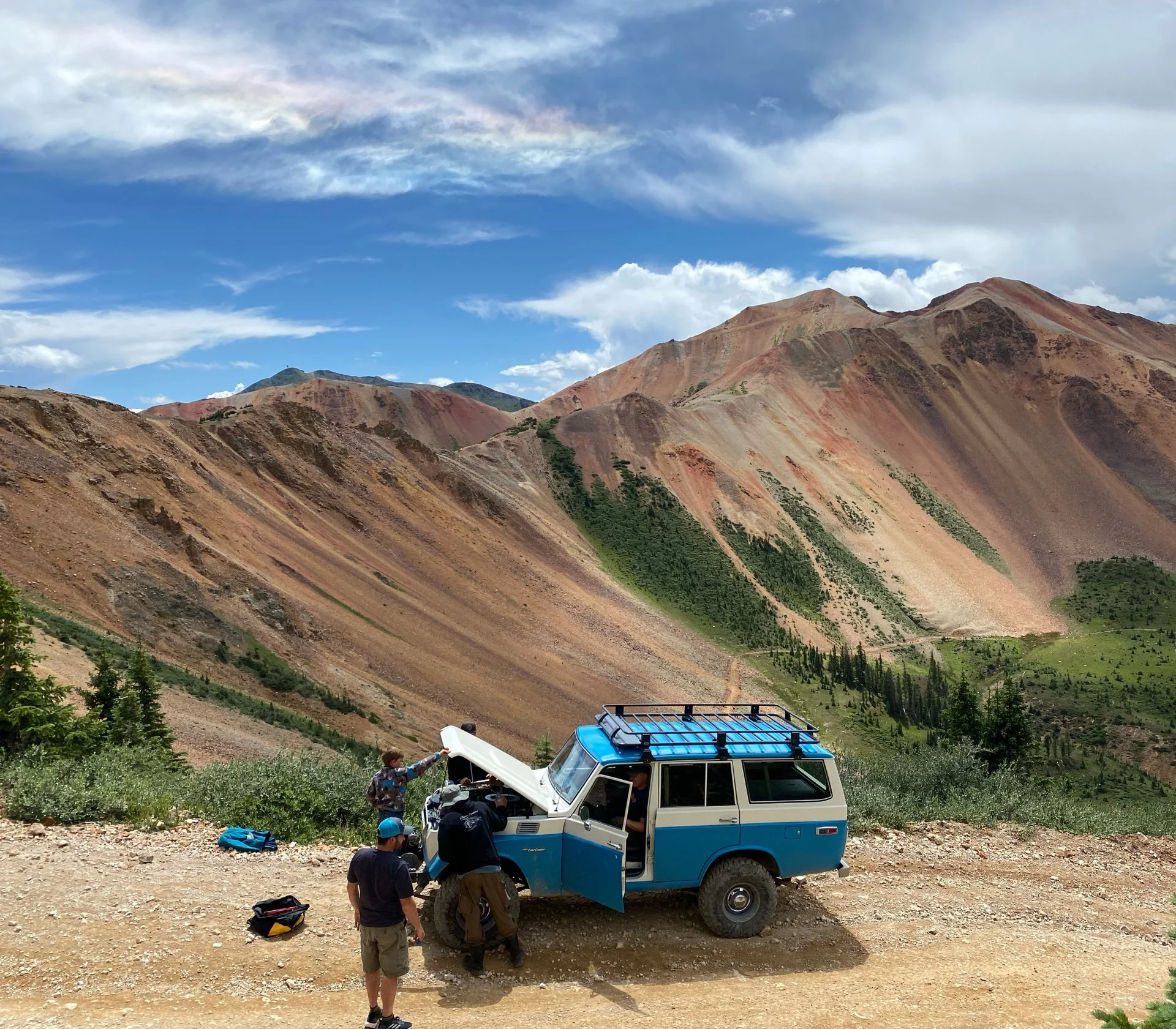

Remember that fuel pump that failed on me earlier in this thread? Welp, the napa replacement didn't last a year. Failed on me at about 12k feet at the top of corkscrew trail. I don't know everyone's handles on mud that were there to help but I sure appreciated it. The guys at Classic cruiser co helped determine what the issue was- great group of guys. Thanks Jim and Mark for towing me up to a flat spot to work on and everyone in the group that day that made sure we got out safely. @John McVicker happened to have an electric and a mechanical fuel pump in the back of his cruiser. Thanks again John! We were able to make the repair and drive all the way out (after I installed the pump backward). Sometimes I do things twice. I have since replaced the electric pump with a mechanical OEM. My son Rhen, and I will always remember that trip. Good times.
A man and his machine. It was fun to get out and experience these trails in something I have spent so much time working on.

The grille is particular to 1979. It's cut out around the TOYOTA letters. Super rare. If you want to re-do the accent around the letters here is an untouched grille to copy. View attachment 2913529
Oooh, thank you. I thought it might be something like that but just didn't have anything to reference to. I was going to paint the letters black. I like this better!
Thanks Dan! I need to come see you guys again at the new location.

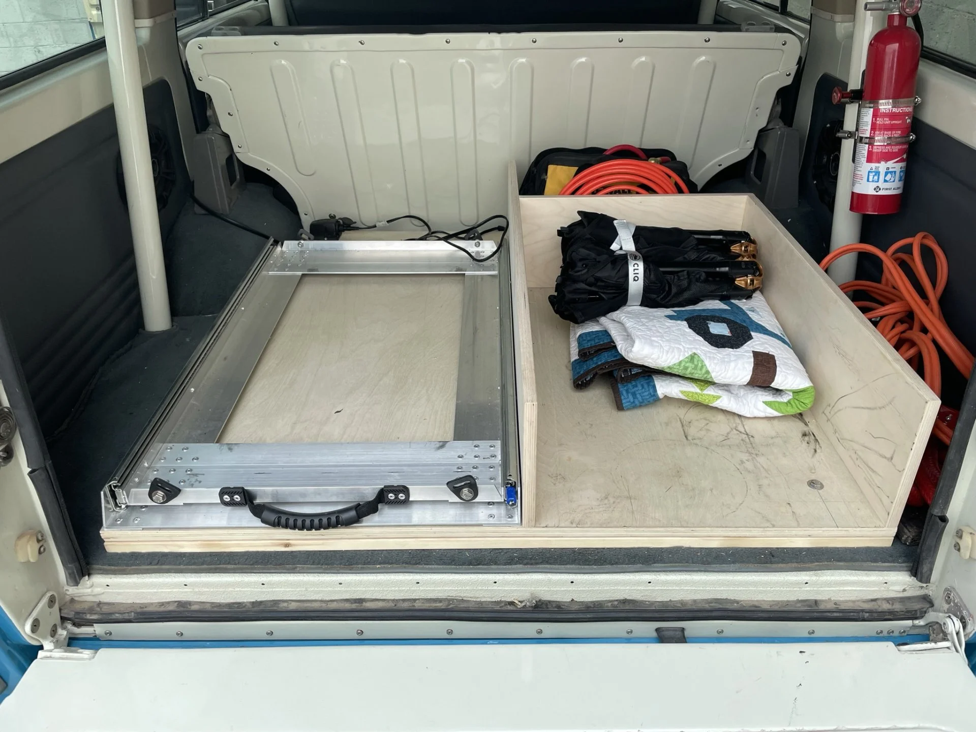

Suprisingly there was not an off the shelf solution for a fridge slide for the 55. 😂 Day before SAS my bro and I put this together, mounted with a bolt in each corner where cargo tie downs might be so if I ever want to remove it I can in just a few minutes. Didn't quite get the drawer finished for the right side before SAS. Plan to finish that up and coat with something that looks nicer back there.
the slide was nice at camp and out on the trail:

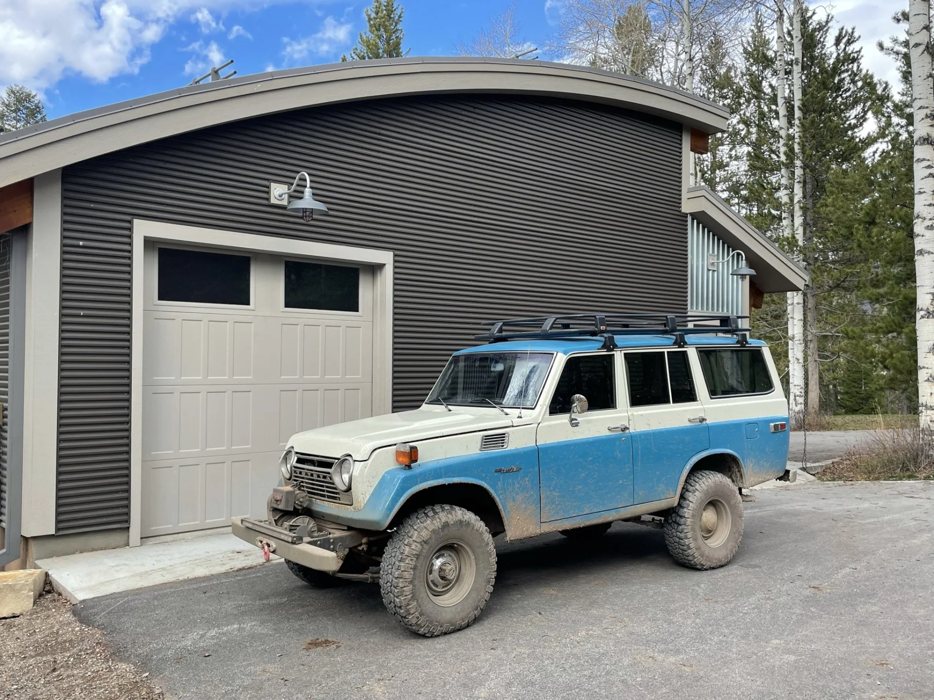

I love the stance of this truck. the tire/wheel combo and ride height are perfect.
