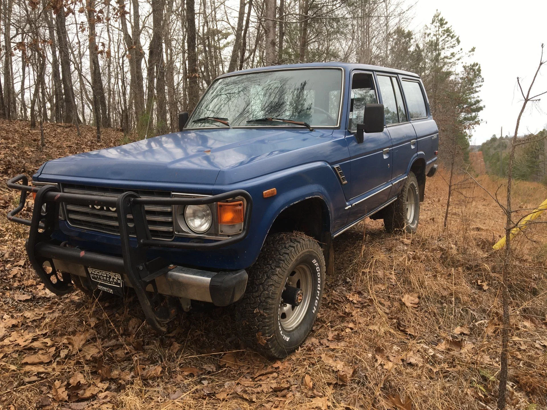

Well, I have been harassing the previous owner of this 60 for YEARS. It was just sitting and sitting by his shop, always in the same spot. The one time I saw it moved, I called the tire shop where it was parked and they actually gave me his #.

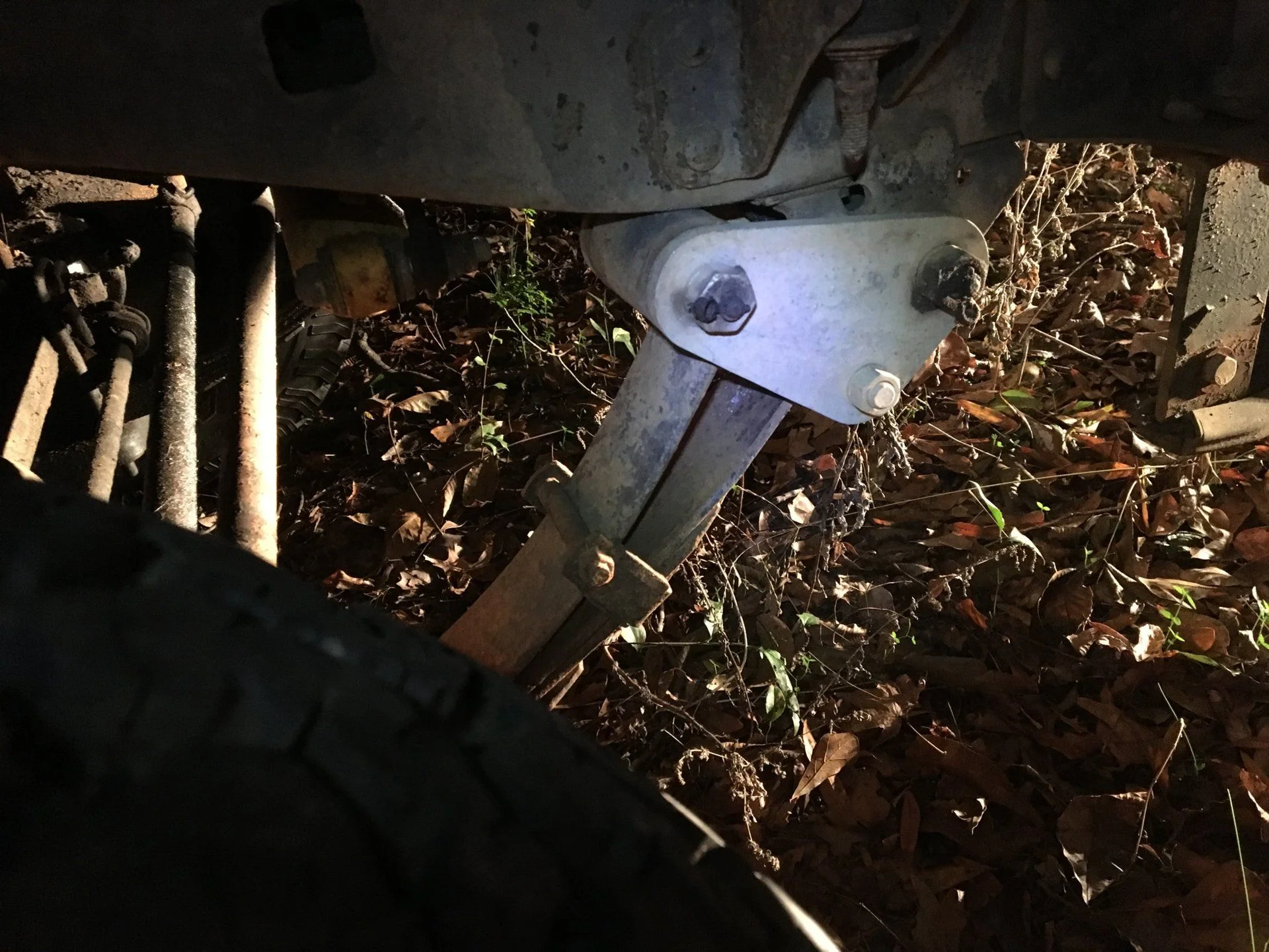

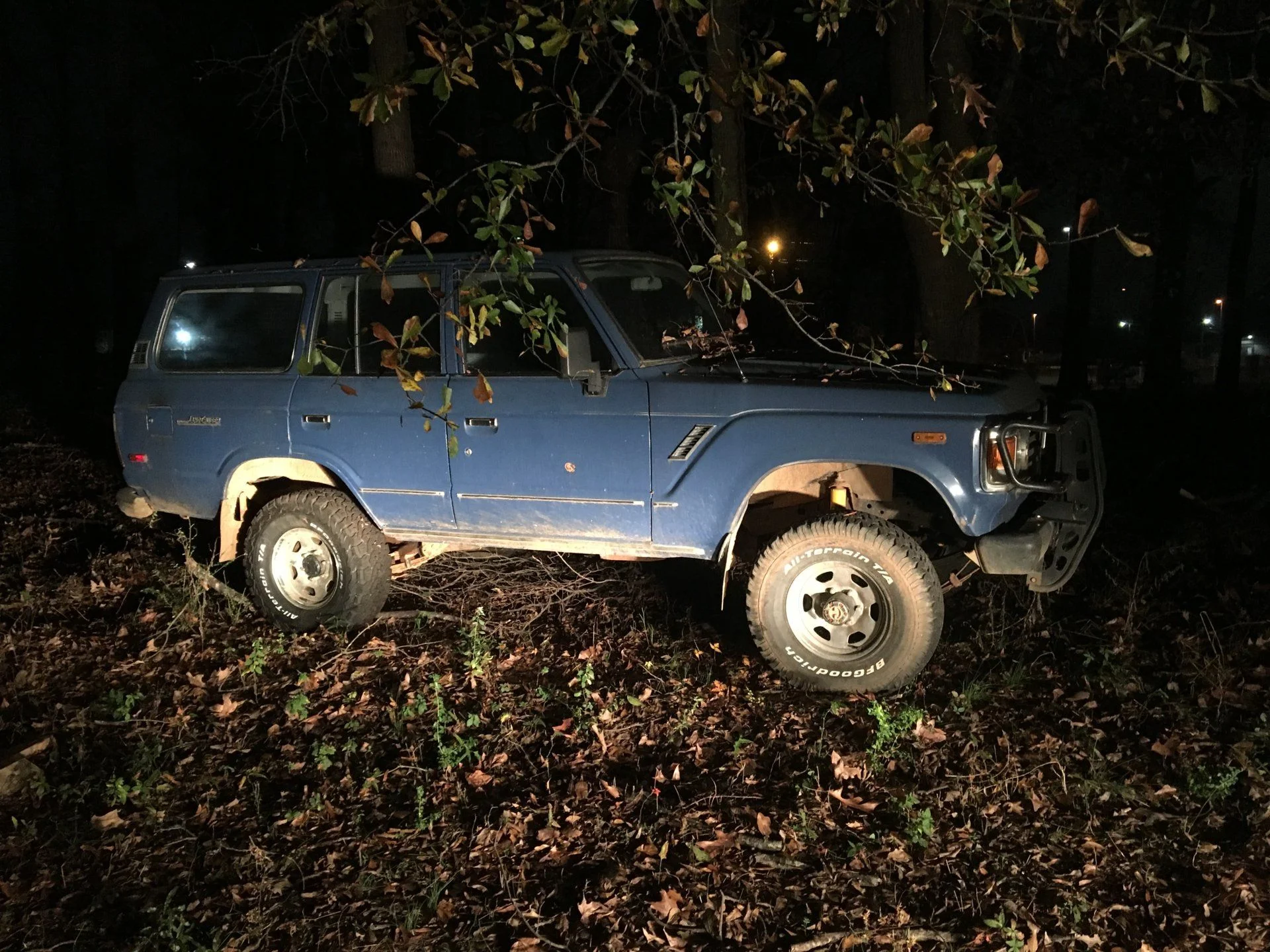

Recently, it had moved to in the woods so I did a little recon on it: descent body, shackles on backwards, good color, new BFGs, old OME lift, leaky PS, new exhaust. Almost all wins in my book.

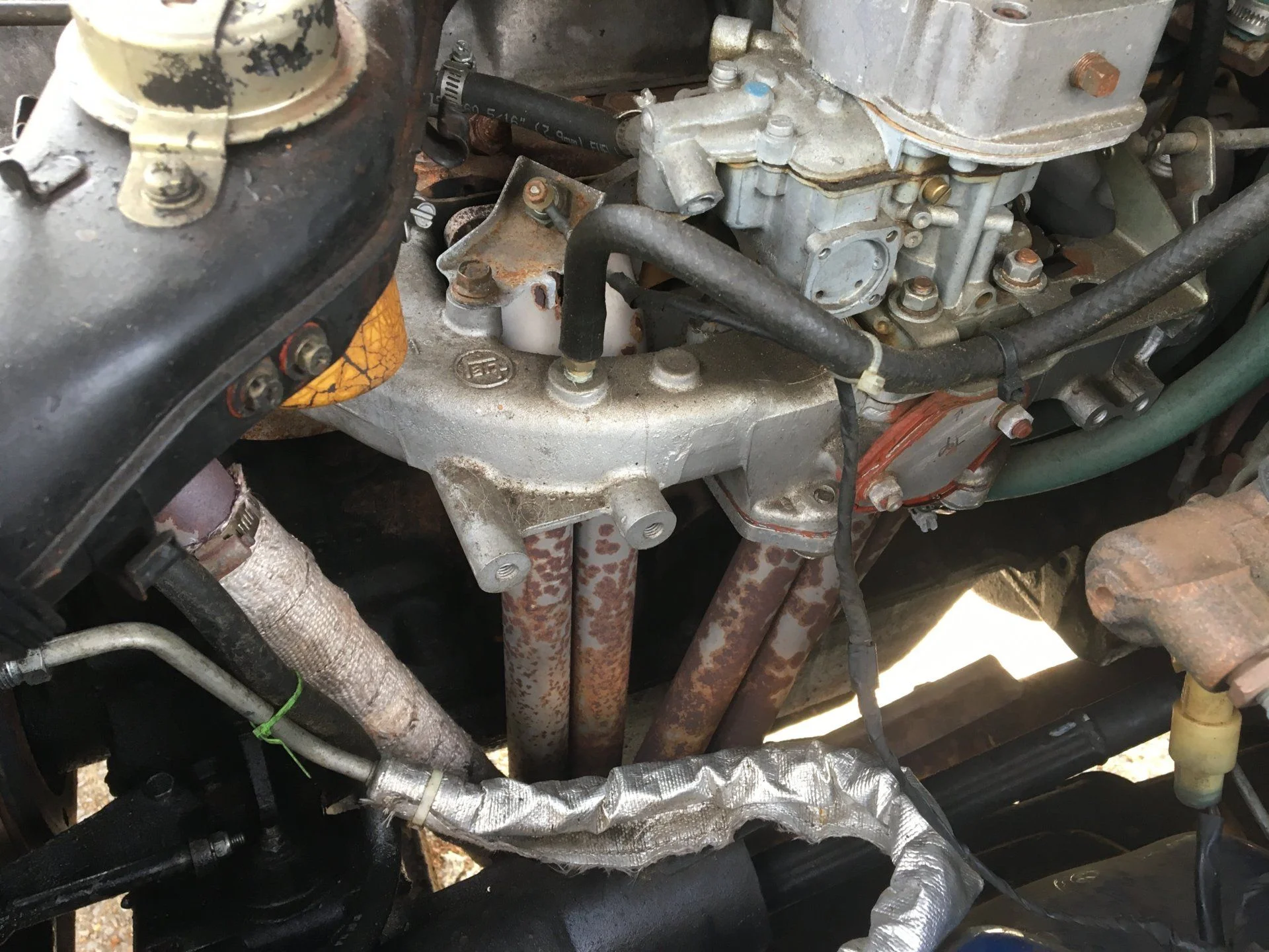

He paid too much for it and didn't want to come off the price any, but years of pestering finally paid off and I drove her home last Saturday!! AC! Desmogged, new Webber, K&N, header, all new hoses, new radiator maybe? somebody had loved this truck at one time. It wasn't this guy, but someone had.

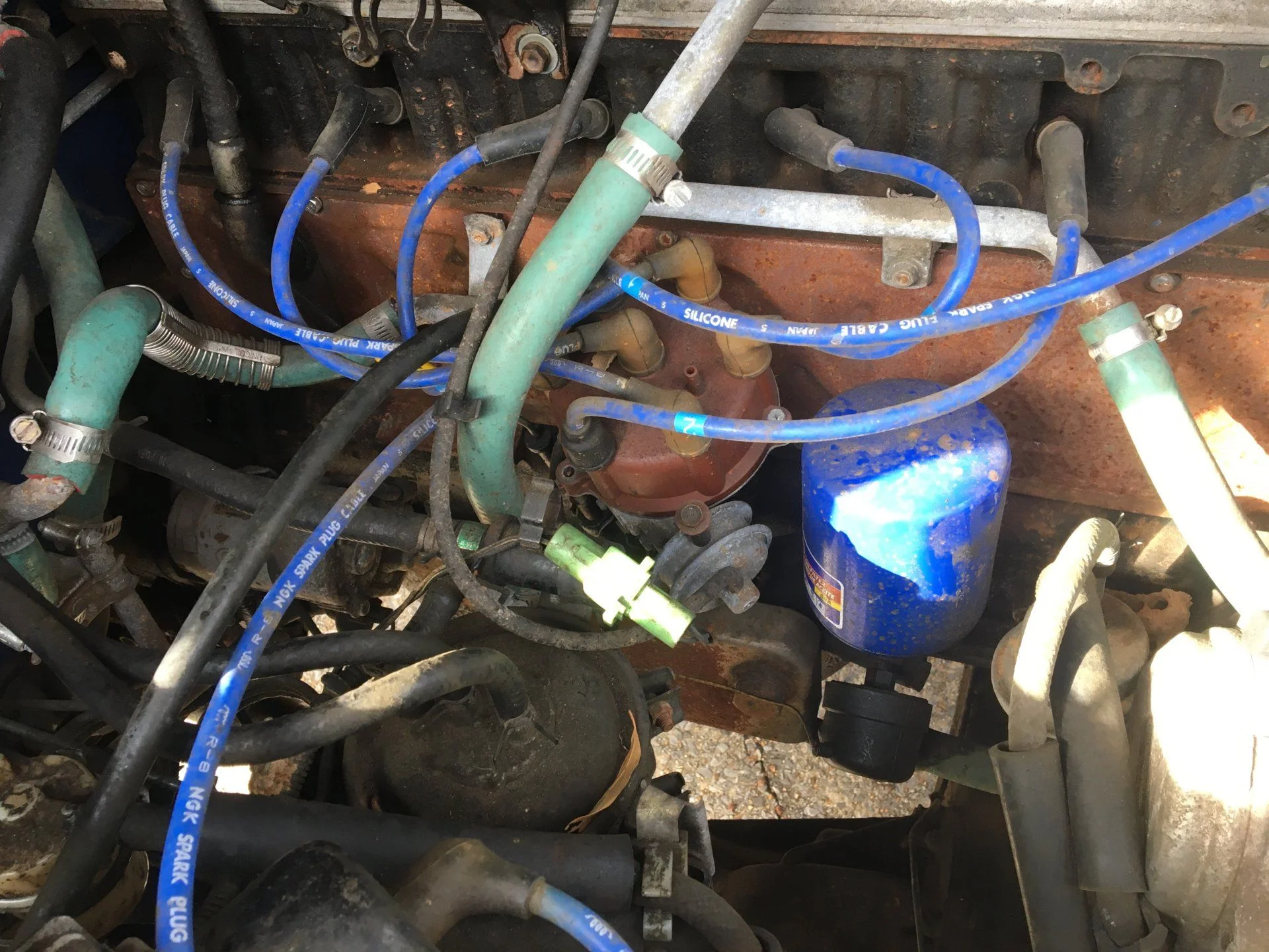

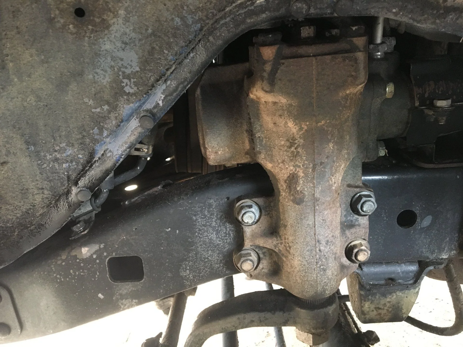

First stop was ORileys for whining PS pump and some snakeoil aka SeaFoam. Drove pretty well. Slow and smooth. Let some degrease soak and pressure washed the underside to help find leaks and make axle pulling not so nasty. Cleaned up pretty well. The vacuum advance was on the wrong port and I don't think it's working even after swapping the line anyway. Took her on the trails a little and took off brush guard (get it cheap. Pickup only!) Ran out of time on the diagnosis because she quit driving cruising down the road.
I had literally driven by this perfect trailer for sale 5 min before. Big blue then sputtered and died on the way back home. Would run off of starter fluid, but never crank.

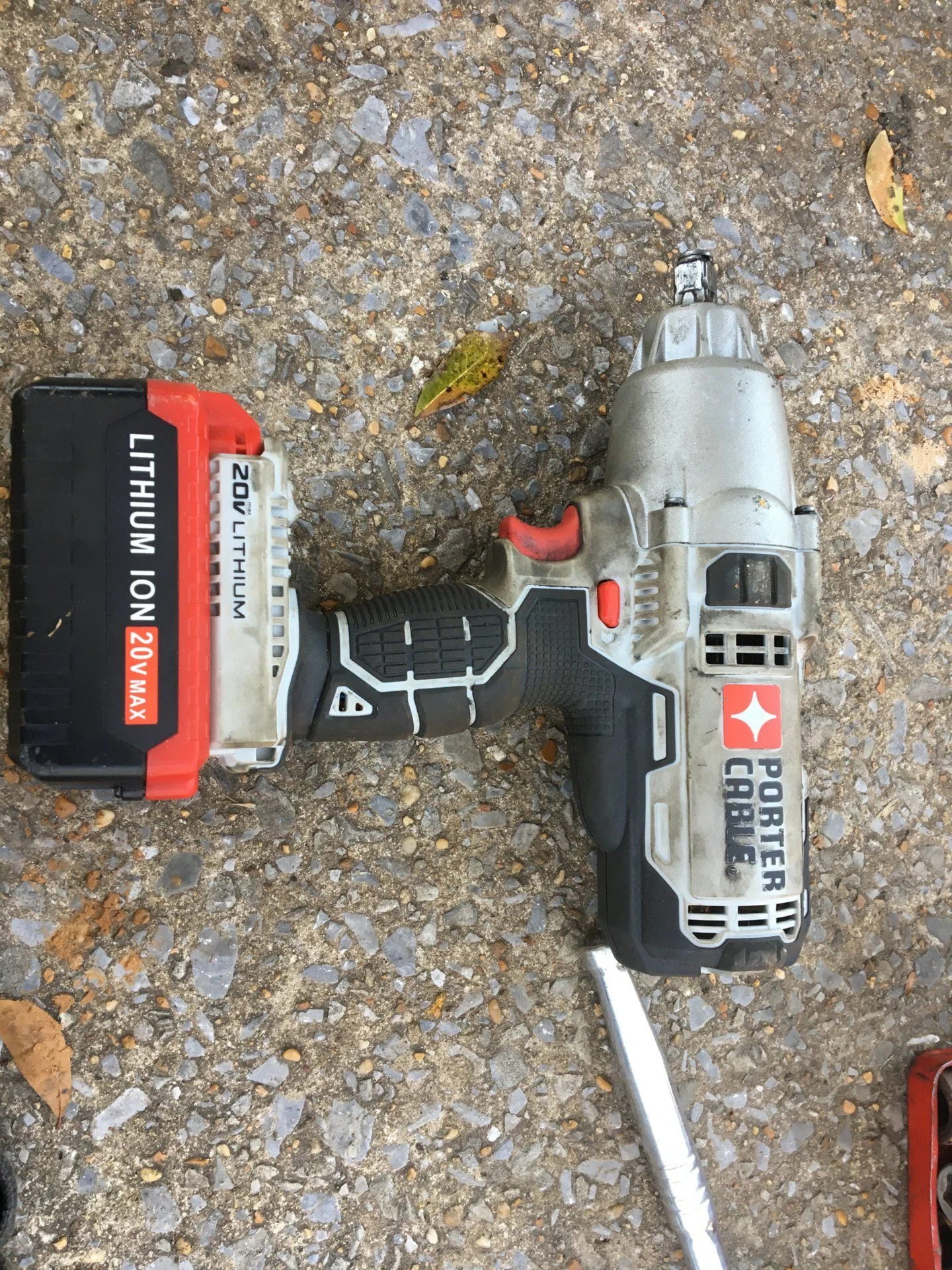

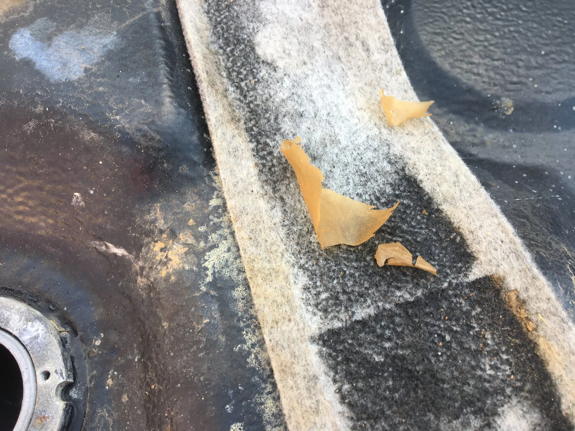

So, I drop the tank, it's full of this mess. Could be old fuel or even some old tank coating?? The tag had not been renewed in a few years, so no telling how little times being driven. Dropping the tank wasn't really that hard, just annoying dealing with the 20 gallons of premium I had put in it the day prior. No way to not get some gas on you. Also go to use my new favorite tool: cordless impact. So fun.
I let some purple-power-eat-your-face-super-cleaner-stuff soak for an hour and pressured wash it for 10 min. Lot s and lots of this came out. This one piece is 6" long.

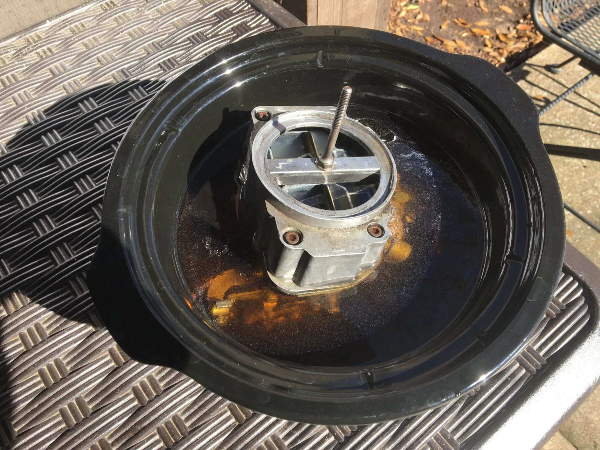

I replaced every fuel line i touched and have the carb soaking in pine sol for a few days. This used to clean up dirt bike carbs pretty well. Don't tell my ole lady that I used the crock pot though!!
Lots of little jet pluggers in the carb filter as well.

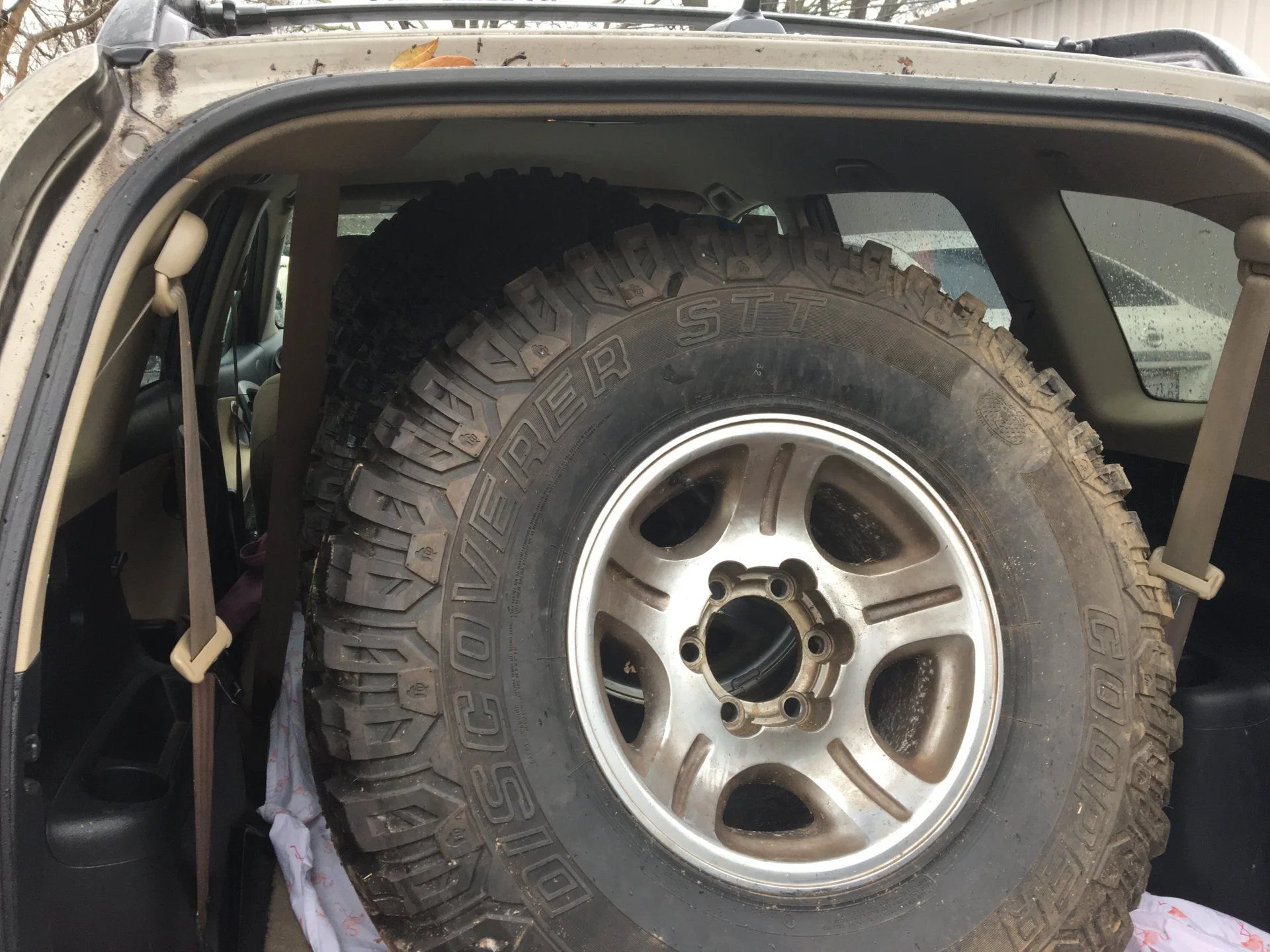

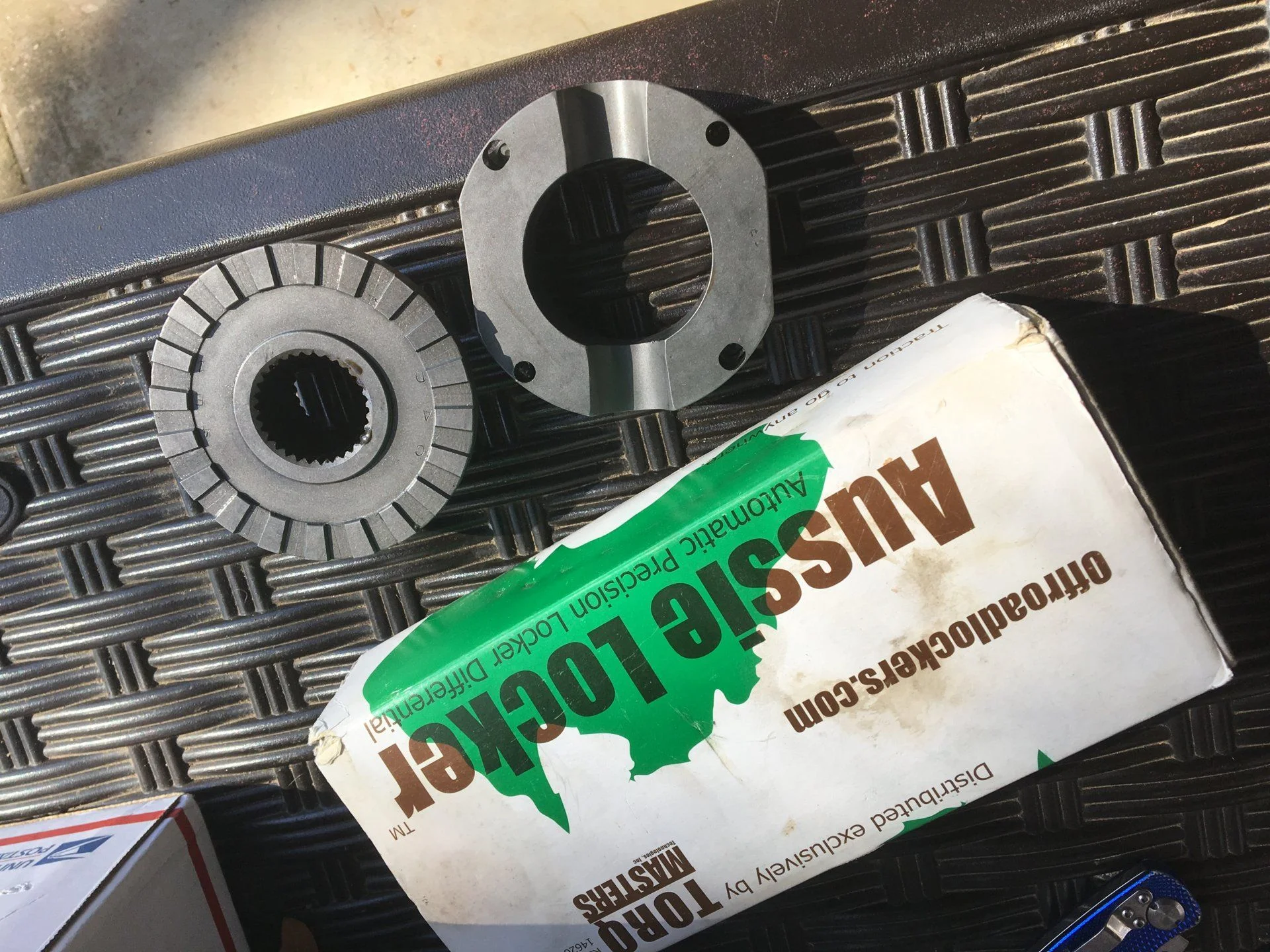

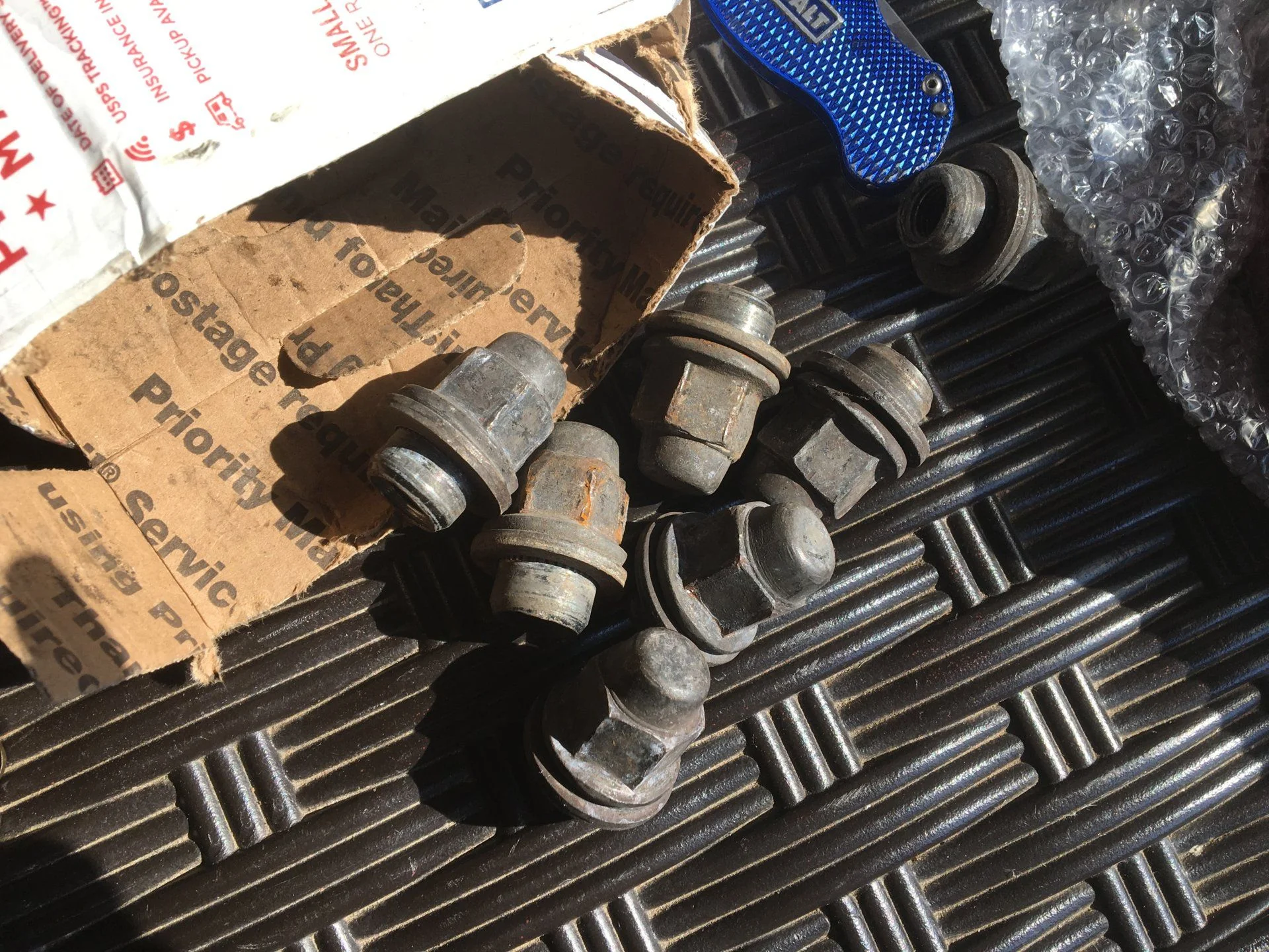

Bought these 315s today from a fellow Mudder, along with some lunchbox lockers, x2 4.10 FJ62 diffs, all in the mud classifieds, nice wheel spacers from Poly Performance, and about to pull trigger on some chromoly front shafts and front end rebuild kit too. I have a new 9.5k winch that was on sale during Christmas and plan on fabbing some simple, clean, bumpers and sliders. @mel lowe came through like a pure badass and mailed me lug nuts for the wheels on super short notice! Thanks again! The LX450 wheels are some of my favorite and I hope they will look right on the old body style. They may get a few coats of gunmetal gray paint.

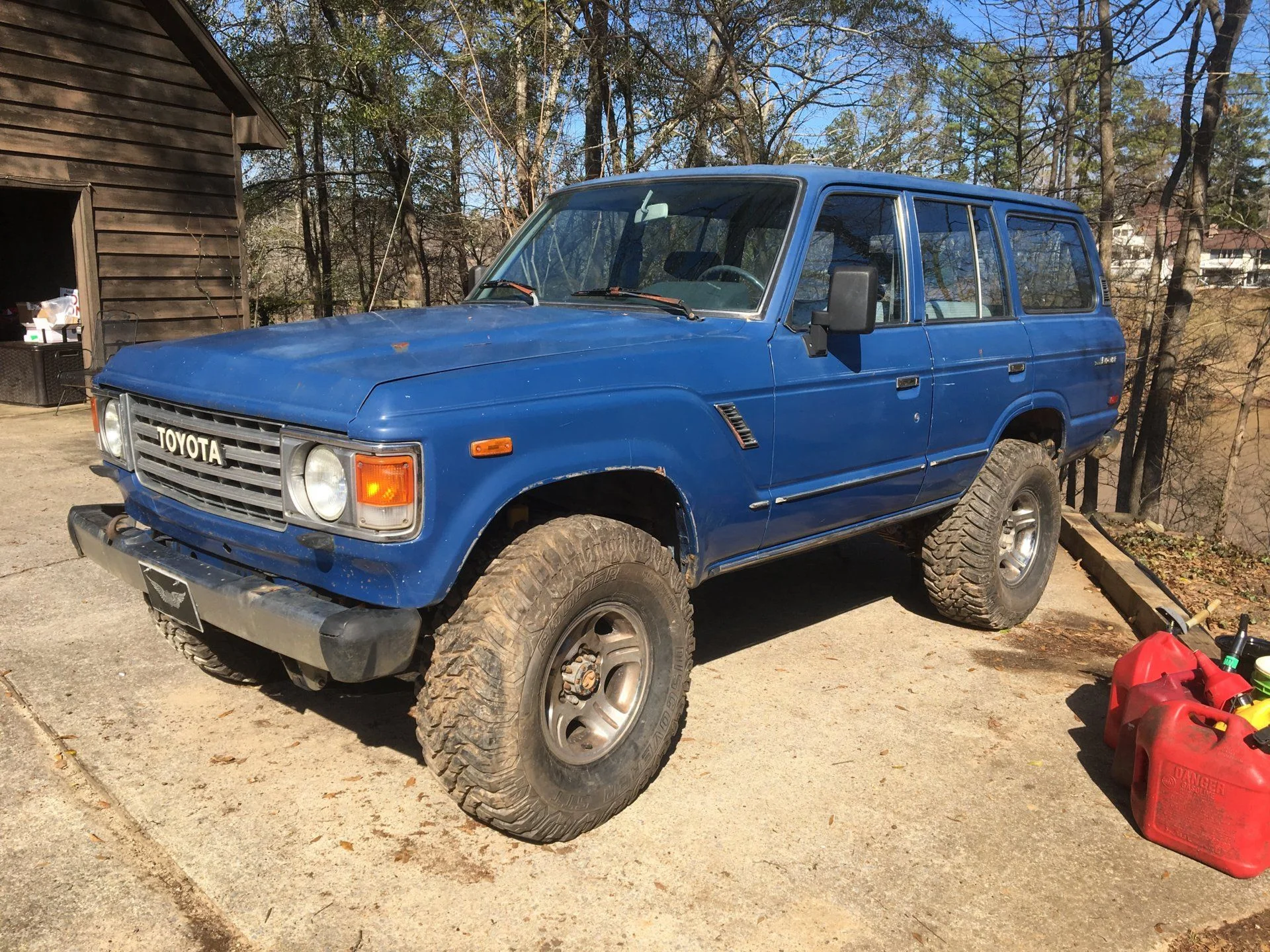

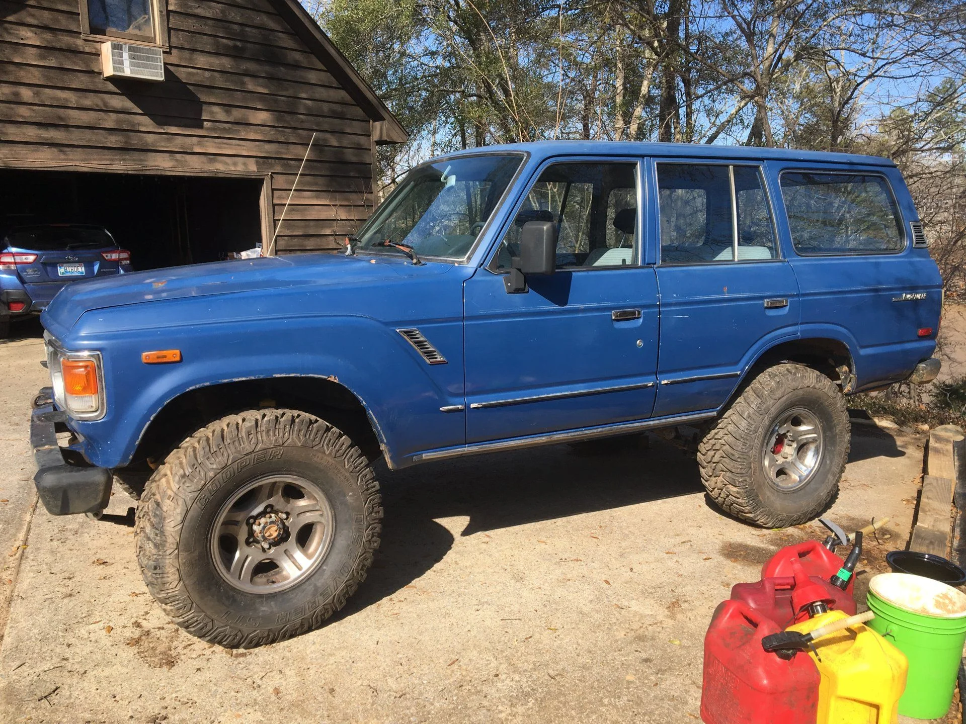

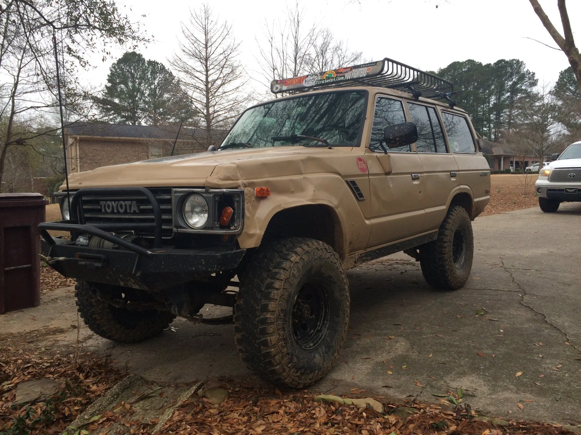

Still love it, even missing a few parts! As I backed out of driveway this morning....
Bought these 315s today from a fellow Mudder...

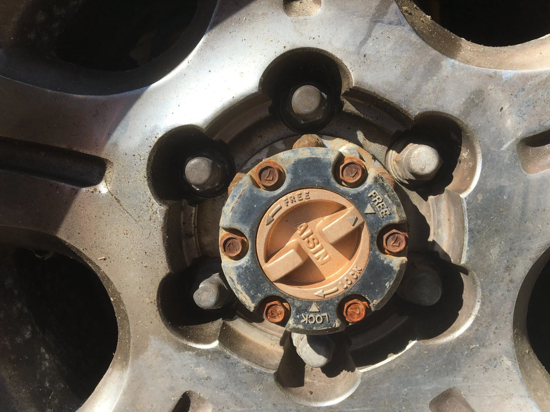

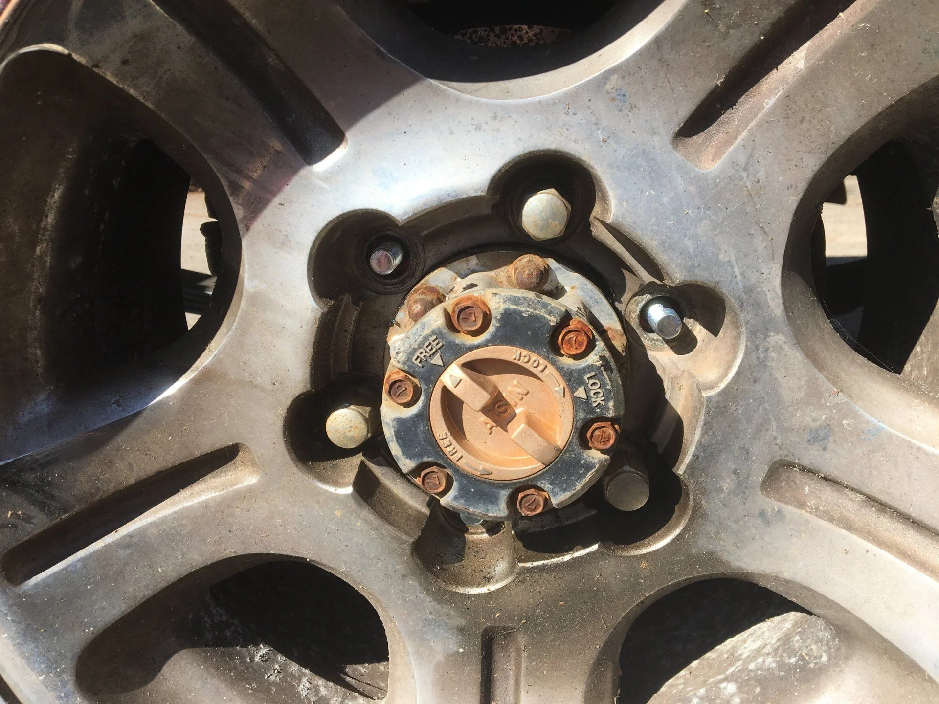

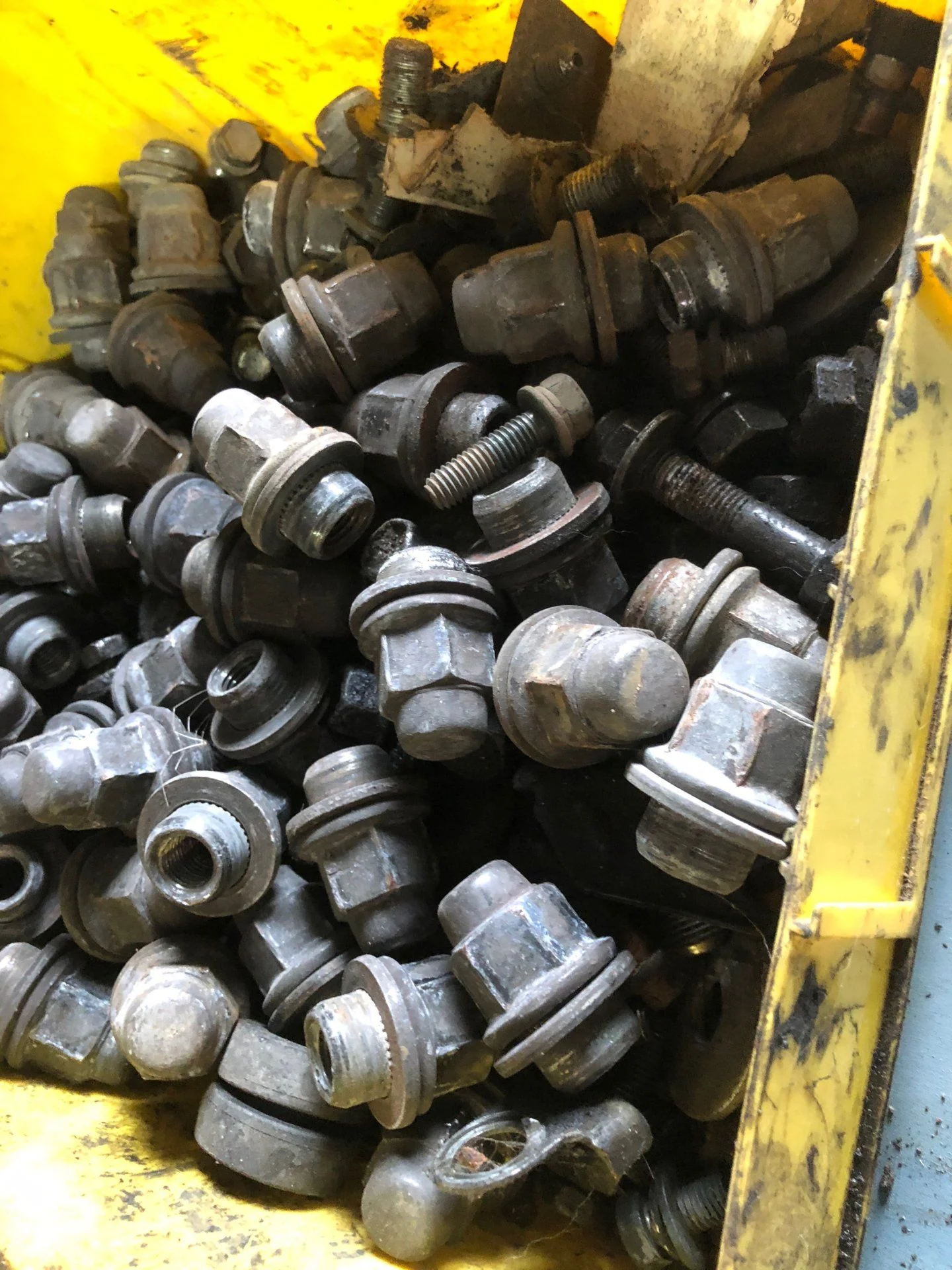

Congratulations! But, hate to tell you: don't expect those LX450 wheels to fit. If the 60 is like the 62 (I believe it is) the factory rims are lug-centric, meaning the conical lug nuts force the wheel into center. The LX rims are hub-centric, meaning they use flat nuts and the hub itself centers the wheel. That, and the wheel doesn't clear the tie rod because the LX's offset is deeper. I know this because I tried to install the very same wheels on my rig. You might be able to bubba-rig something with the right spacers (???)

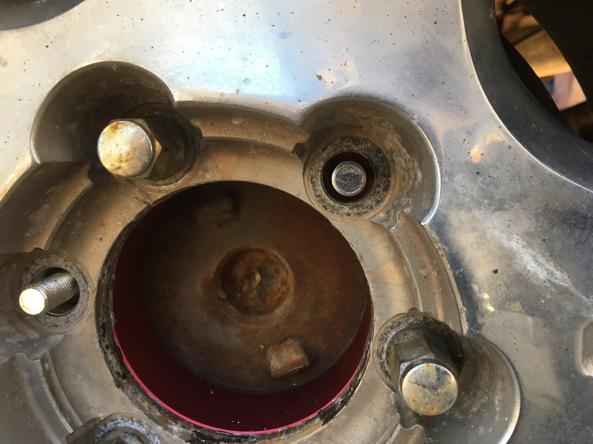

I used the Slee method in the link above: I used three lug center nuts to get wheel centered, then put on three hub centric lug nuts and they went on perfectly. Then replaced the three lug with three more hub.
There is very very little room for it not to fit correctly, espically in the front over the lock out.
If i fly off the road and die, you can all say I told you so, but I really don't think it's going to be an issue.
BIG MEATS ON!!!! Thanks @jdlsantos for a good deal on the tires and making the 60 look right!

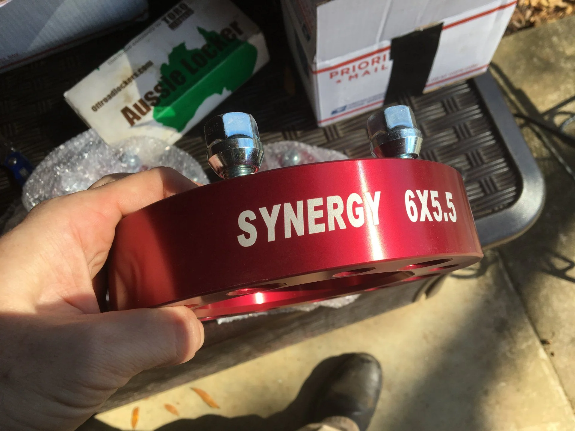

These are the spacers I bought
Synergy Lug Centric Wheel Spacers
They are same billet quality as the $ blues ones and not the cheap cast Chinese aluminum ones on eBay.
John the salesman was very helpful at PP.
Thanks again @mel lowe for shipping lug nuts so quickly!
