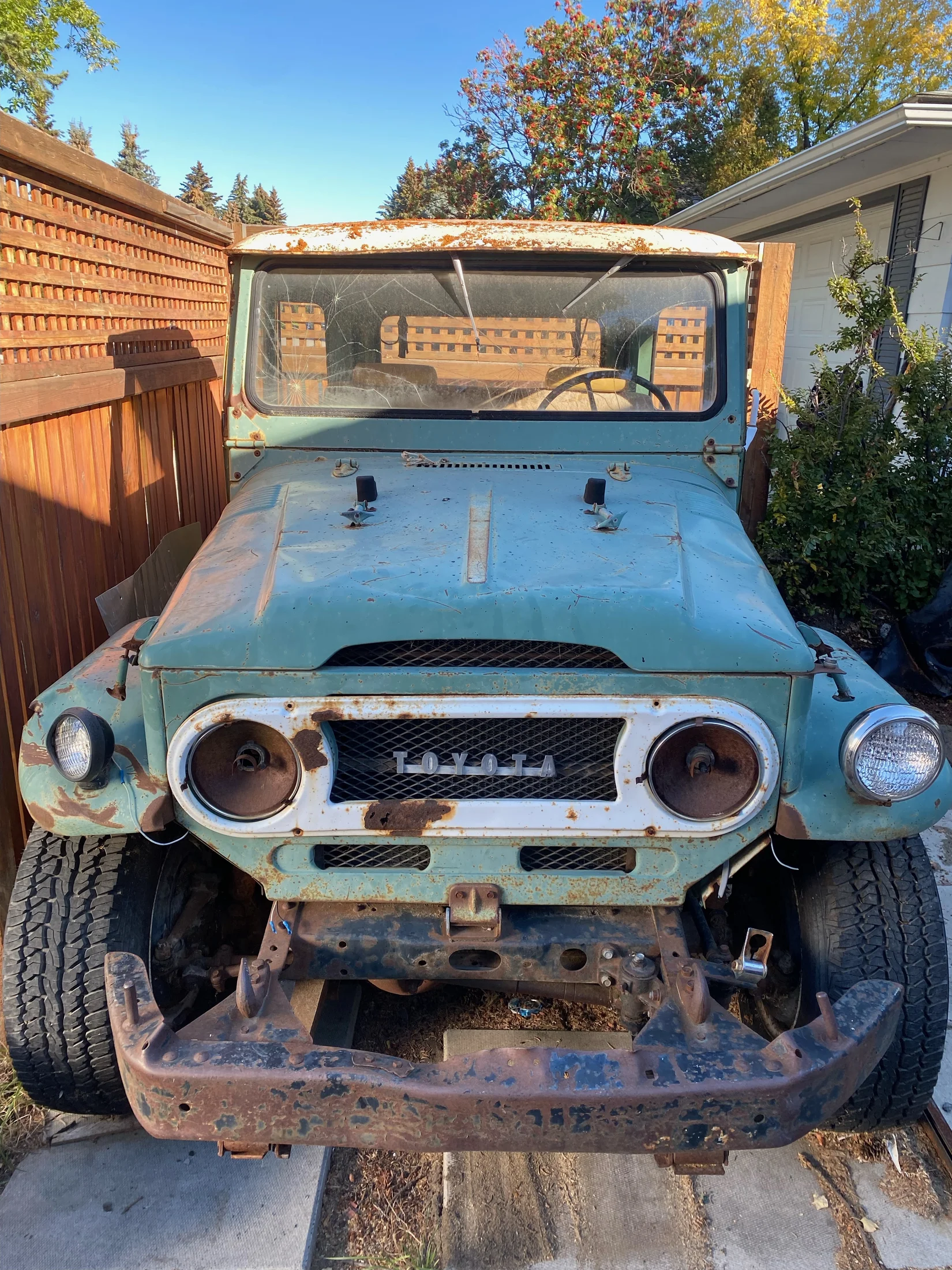

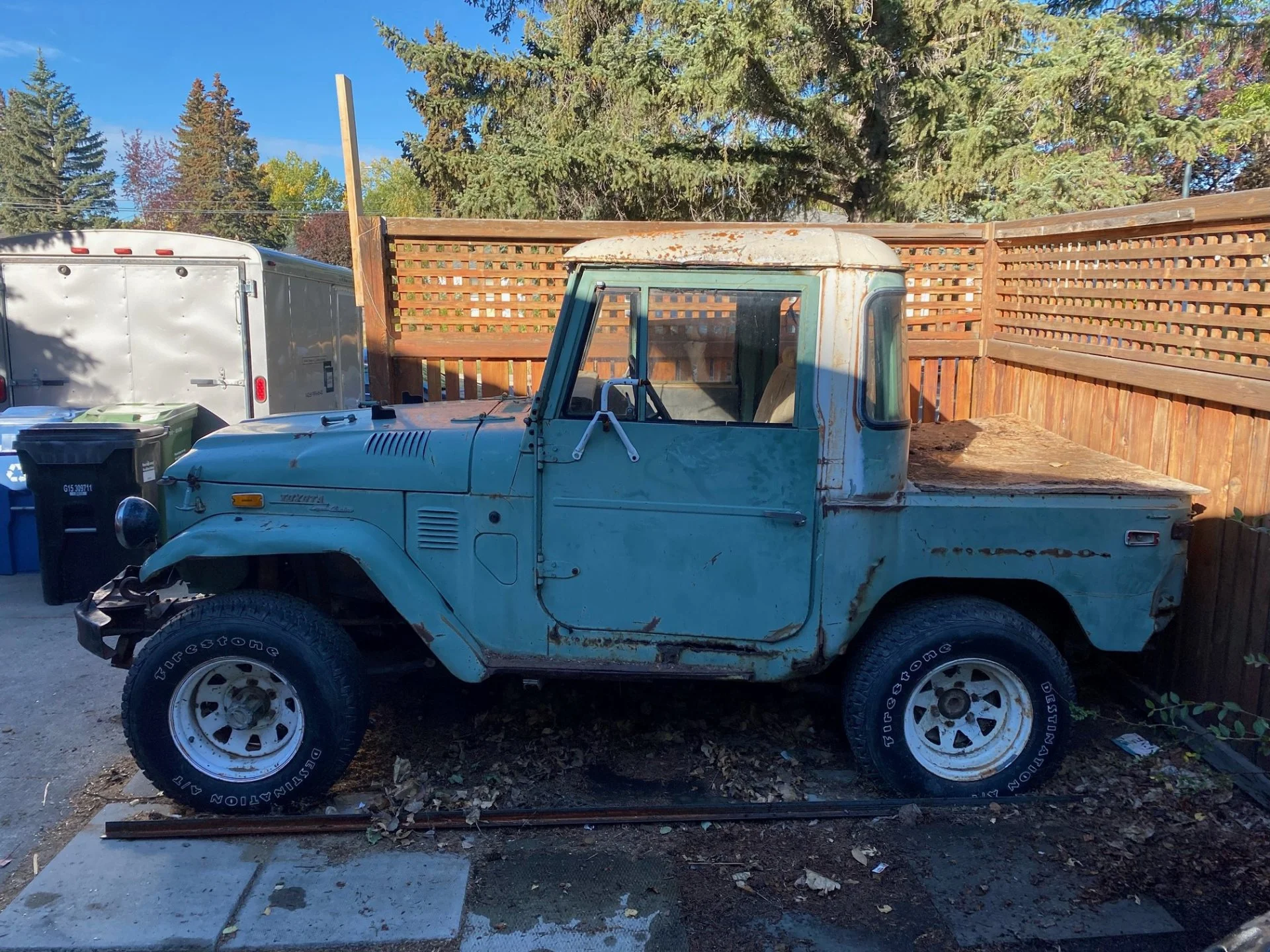

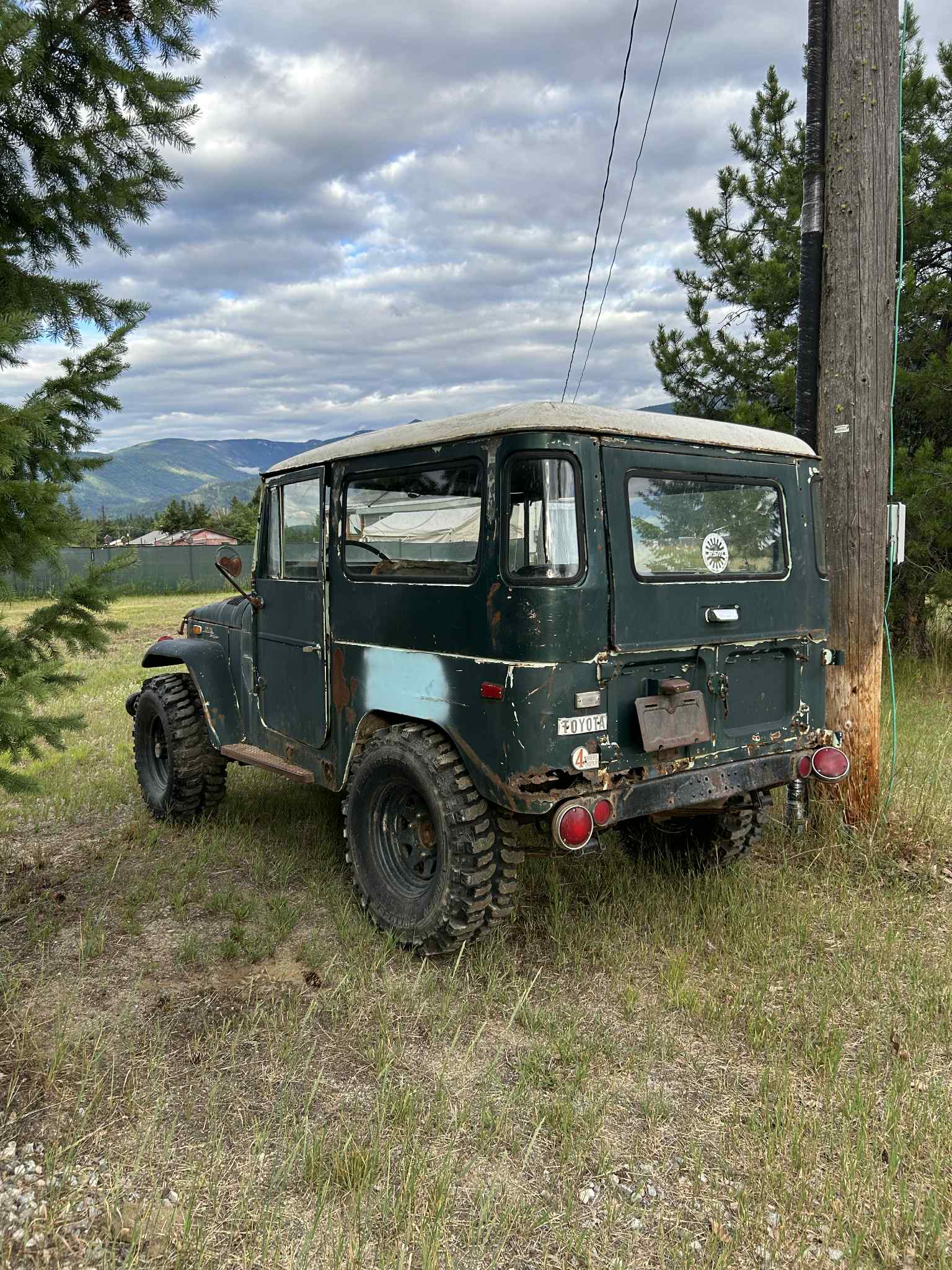

It’s originally Spring Green, which is a very light mint green. Here’s a crappy pic that the seller sent me a couple months ago.
The underside of the hood is the OG colour.

LOL! 🤣 I remember seeing that pic now, but, as I sit here in HOT & HUMID Florida, I thought that was an old mattress sitting on top of it! Now that I see your pic larger, I realize it was snow. LOL!!! Probably did not have my glasses on when I saw it.

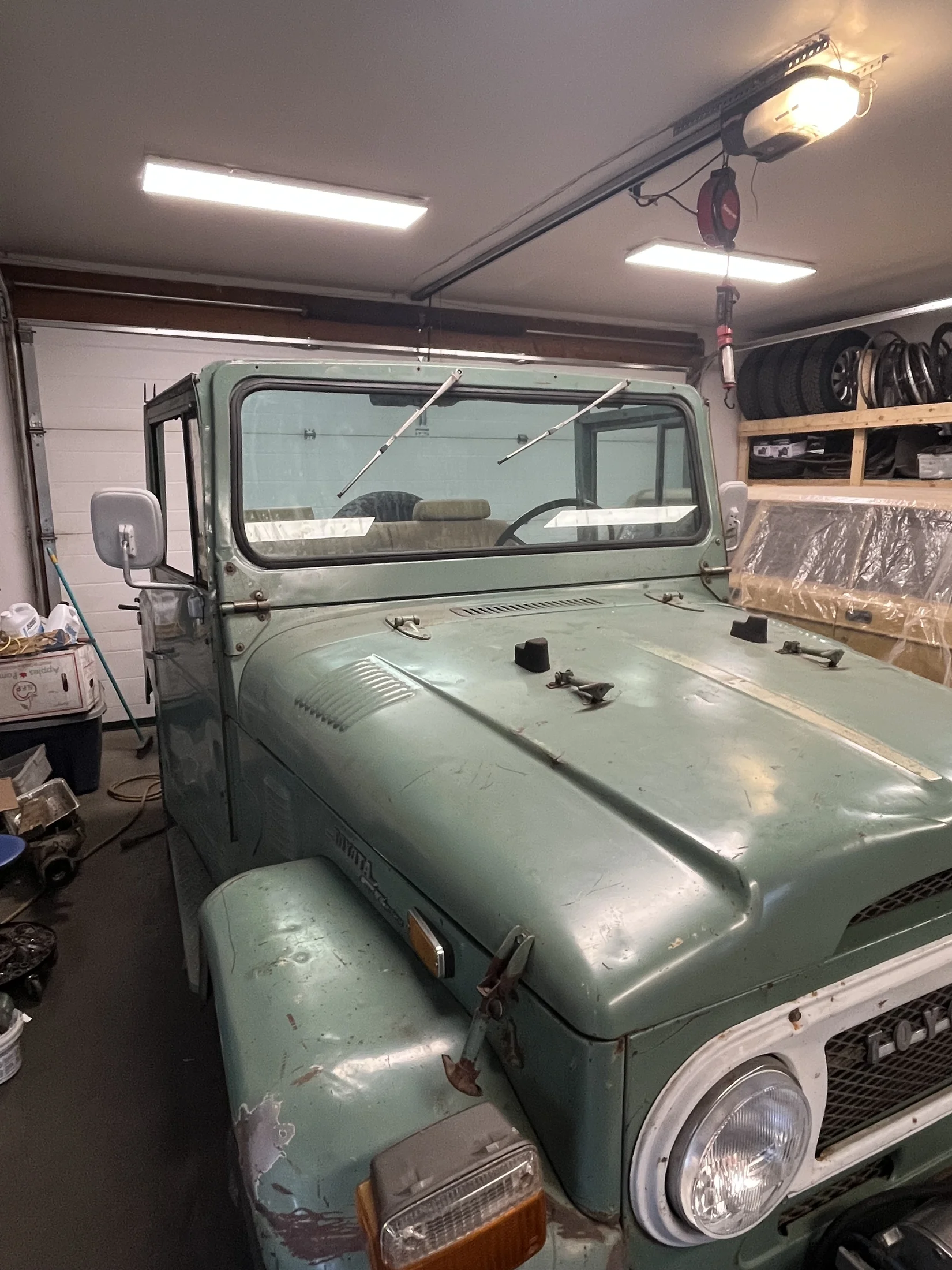

IT’S ALIVE!
I don’t have any documentary proof, but yesterday I pulled the 40 out of the garage and drove it around the block a couple of times! It ran pretty well, even though I have not fully timed it. The gearbox is very notchy, but everything seems to work! Was able to run it through all three gears.

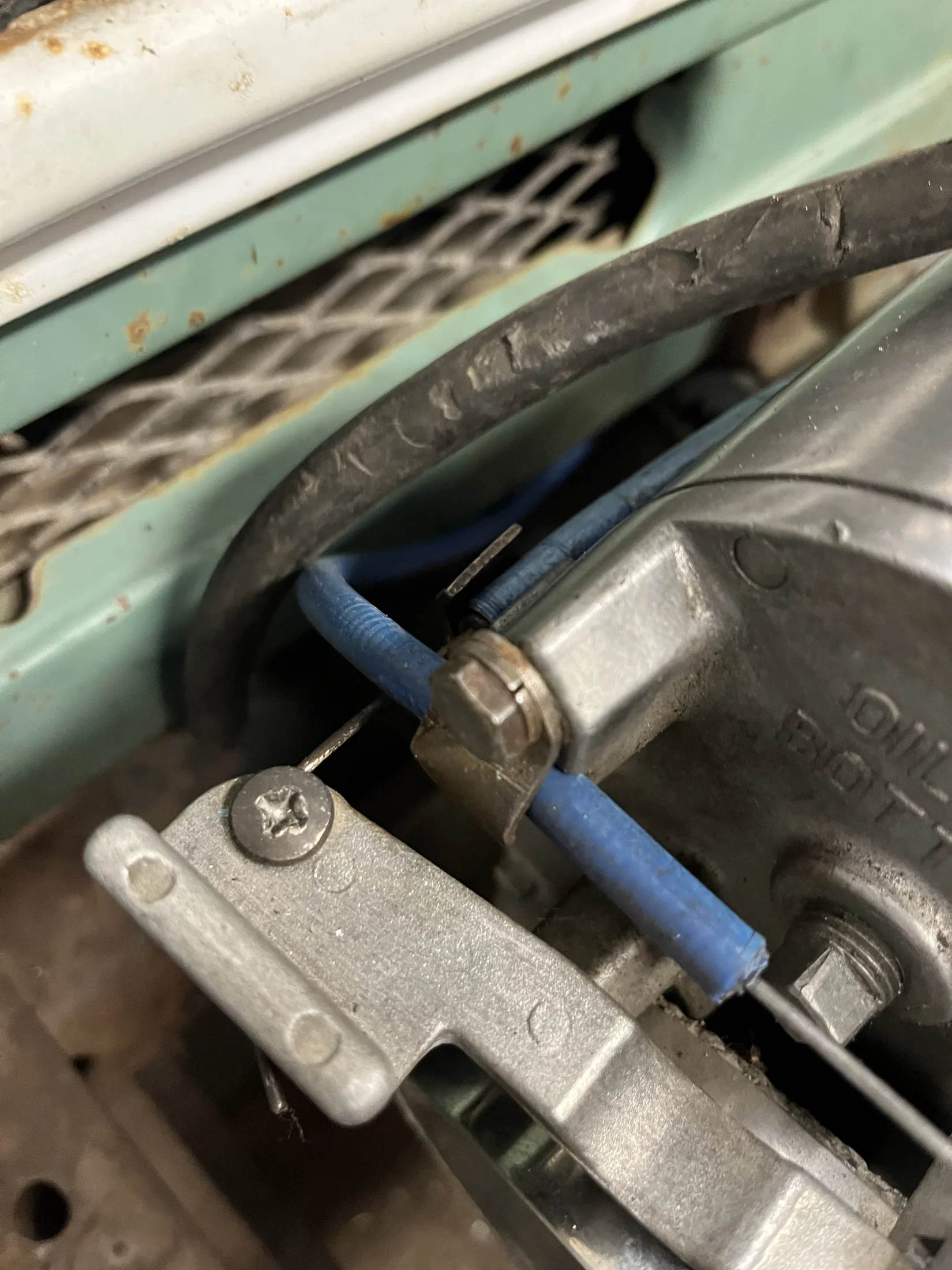

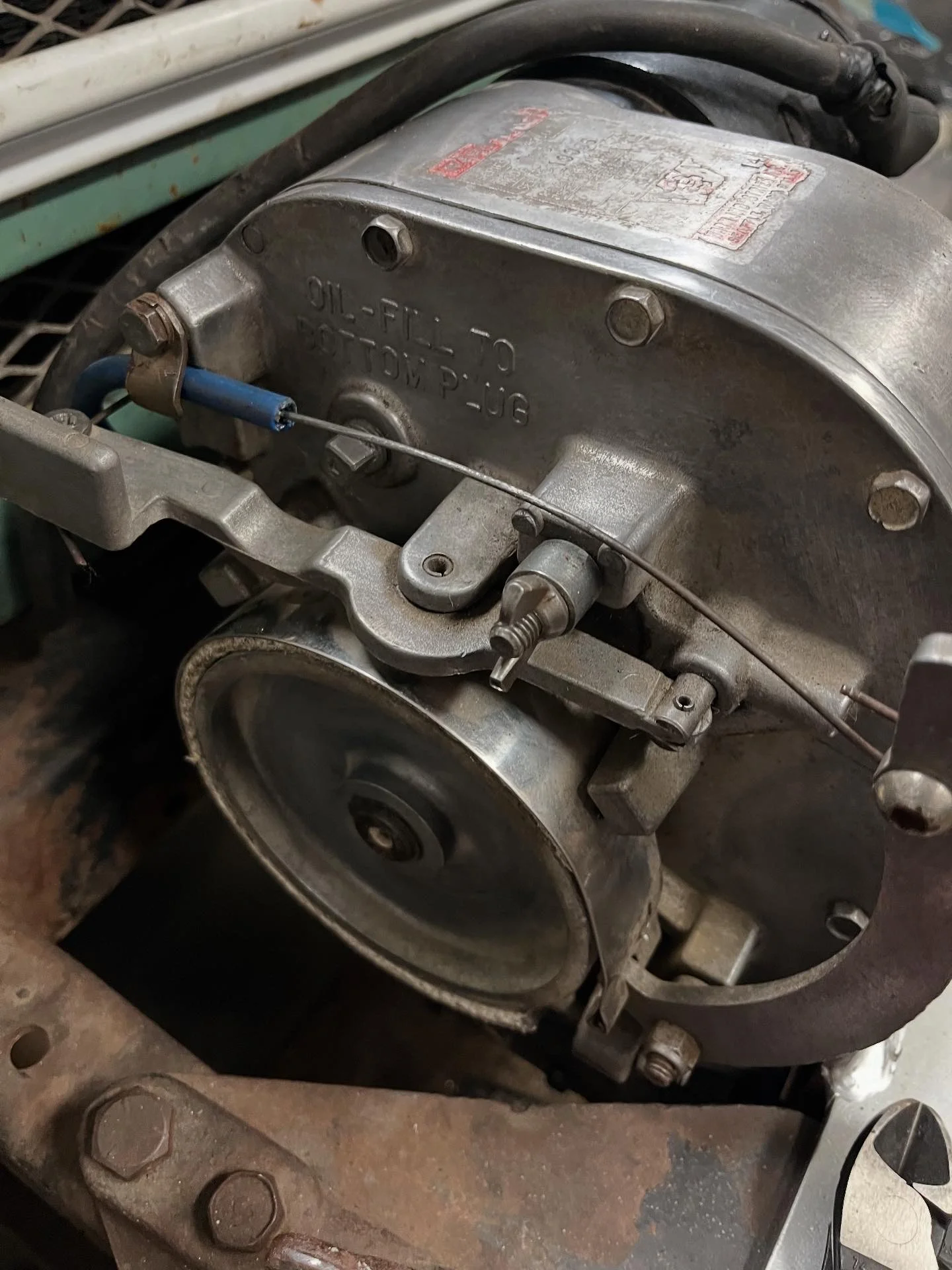

I’ve got a few minor updates for y’all. Firstly, I got the cable controls sorted for the 5687. I just need to fabricate a bracket for the switch, and the winch will be fully functional. I don’t know that I’ll ever really use the winch at all, but you never know. I at least need to get it running so that I can re-spool the cable, haha.
Here’s the brake cable and clutch cable connected and working properly. I learned that the small butterfly nut above the brake drum is for when you’re operating the winch from outside the cab and you need to engage/lock the brake. The brake lining on this winch is in surprisingly good shape.

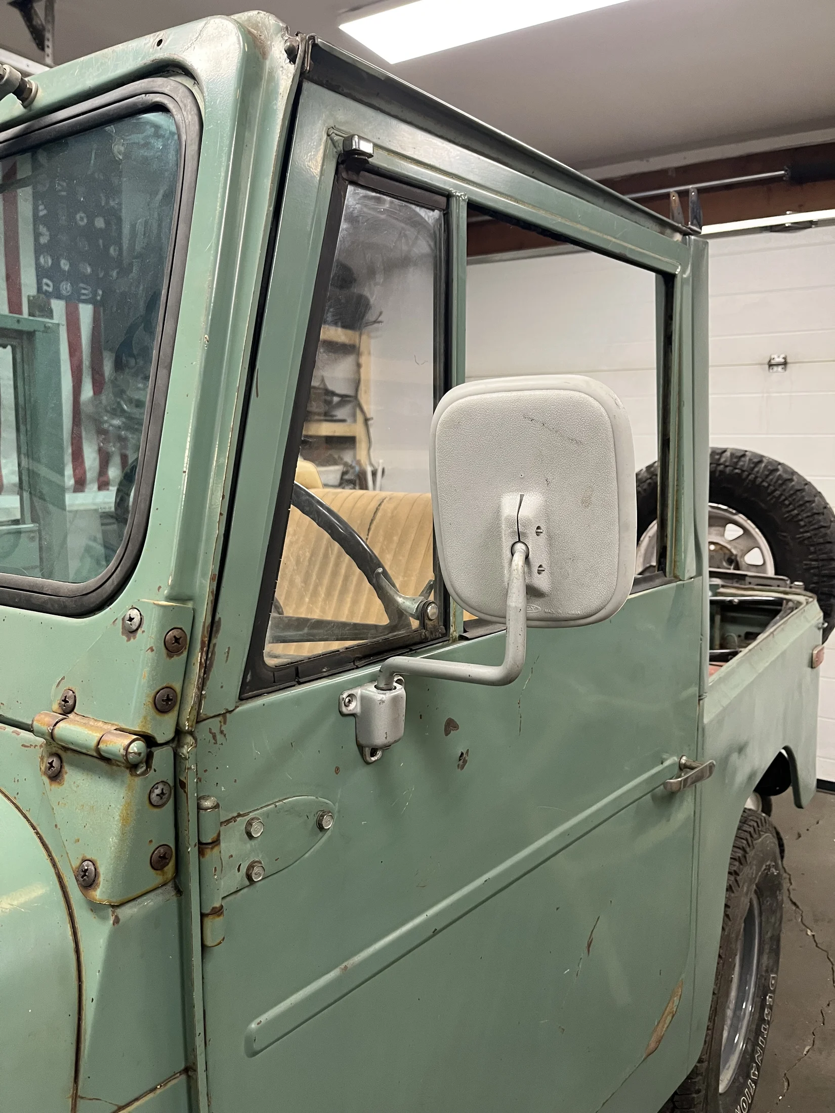

I also installed some mirrors. In keeping with the rest of this truck, they’re not period correct, but a fella sent them to me for the cost of shipping, so I’m running them. One step closer to being legal!

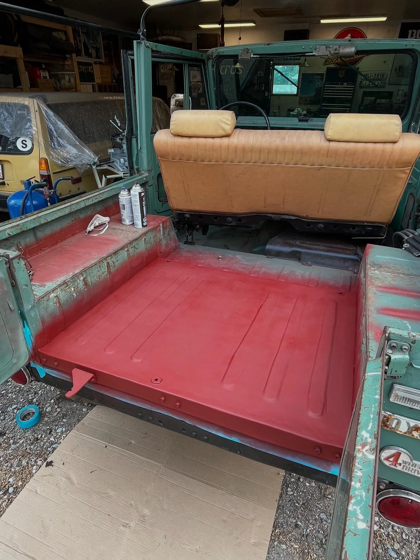

Nice, calm summer day today, so I decided to do some painting. First up was undercoating. I went through a couple can of Dupli-Color rubberized undercoat/sound deadener, and was able to undercoat the rear wheel tubs and the underside of the cargo floor. I used this Dupli-Color stuff on my FJ62 and it’s great. Goes on easy, dries fast. Plus, unlike tar-based undercoats, you can paint over it. I don’t have any great pics of the undercoating, but I did snap some shots of the work I did on the top side of the tub!

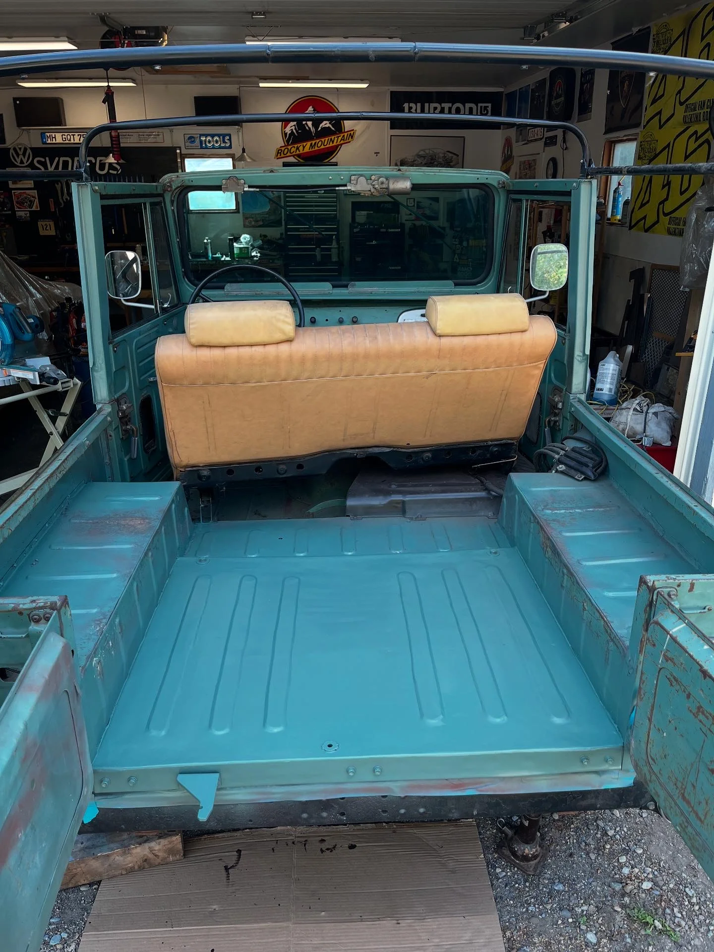

Here I’ve laid down some red oxide over a coat of self-etch. This was all bare metal, so I definitely wanted to start with an etching primer, but I wanted red oxide under the top coat so that the red shows through when the paint gets scratched, etc. Anyway, I then pulled out my custom spray bombs and hit the cargo floor with top coat, and this is how it turned out. I will be blending the old paint/rust with the new, but that will happen after its h had a chance to cure.

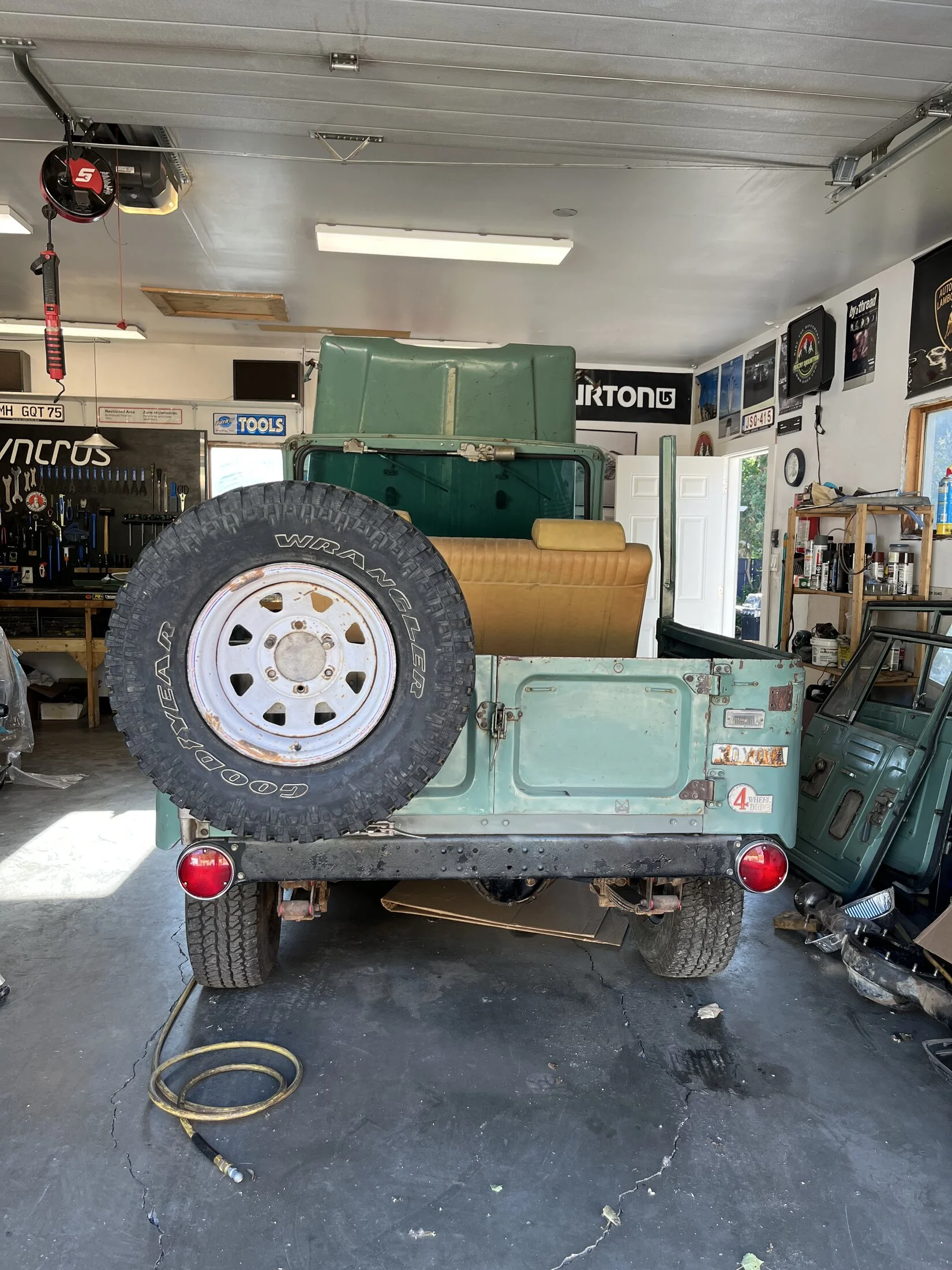

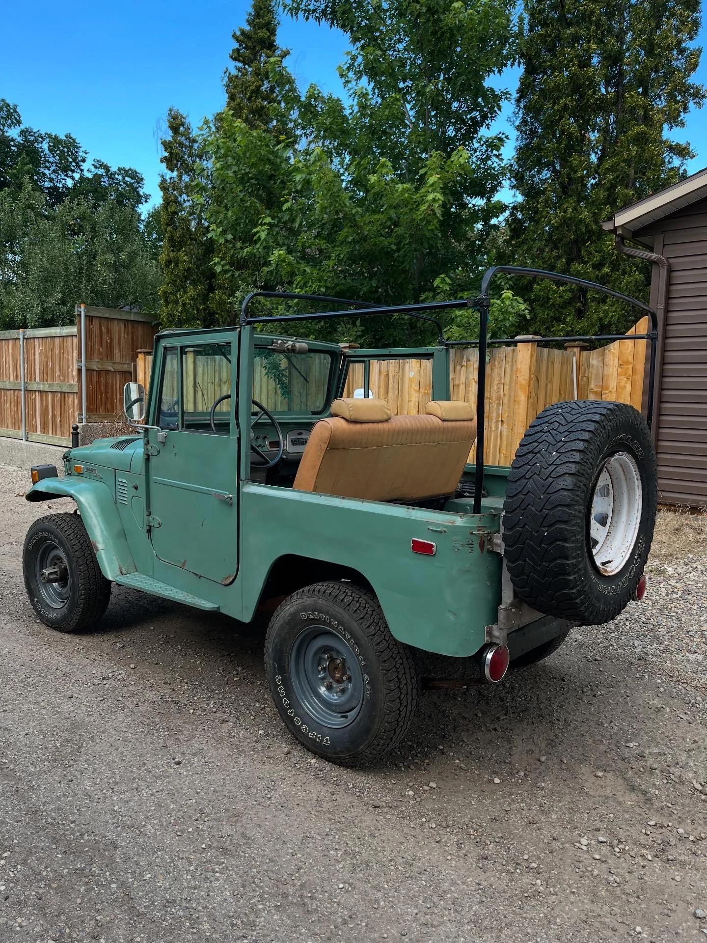

So yeah, the truck is really coming together. It moves easily under its own power now, so I was able to get a bunch of shots from several angles. It is turning out pretty much as I’d envisioned it, which is really fun.
