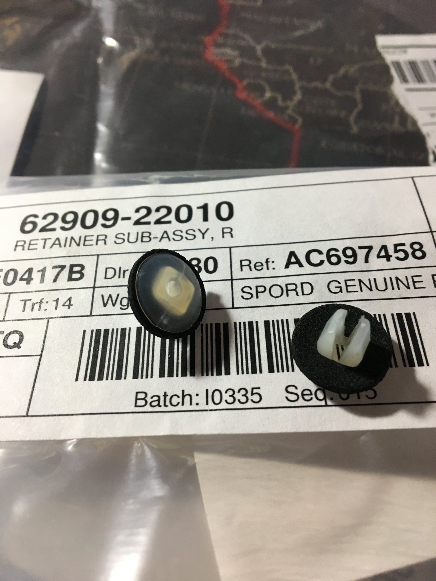

Just got mine and cannot wait to install....quick question. The screw hole in the gasket is as big as the screw and not the actual insert or round part that indents into the truck. Is that right? seems like that will keep it from being flush mounted at the corners.
I actually figured it out and one fits nicely but the plastic grommets on the other side crumbled....off to find those....grrrr
If you you find a fitting part can you post up here. I have one I’m missing.
No luck.....maybe someone here can help us out. It would be a square plastic retainer that fits in a hole that is 3/16th. I called the dealer and he shows nothing but said I could come by and he would see if he could match it up. Looking aftermarket at these retainers and I am not seeing anything that small.

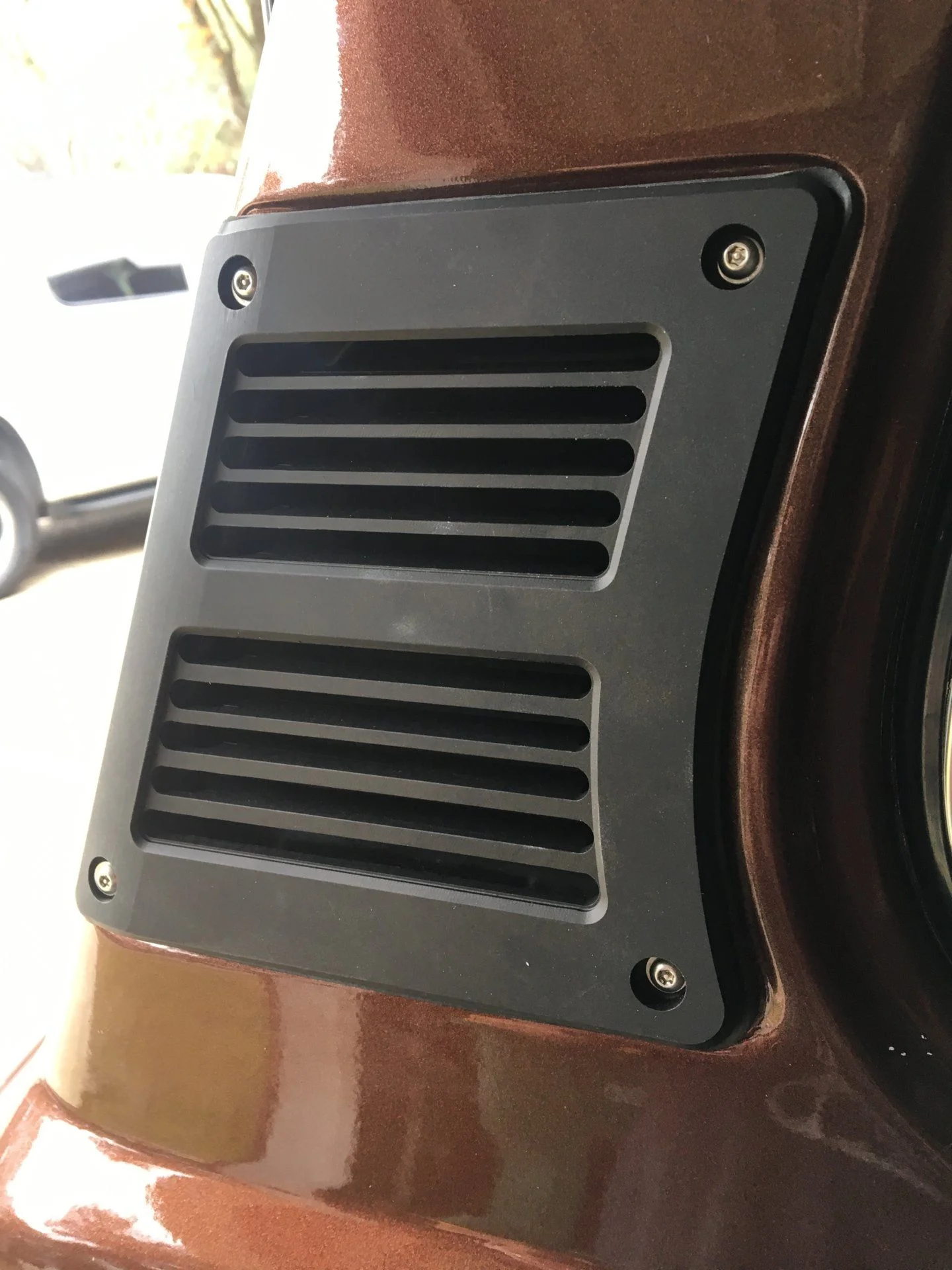

The bare aluminum sold out quicker. I got mine delivered yesterday, beautiful work.
Thanks @pandasfj !!! My dealer had none and none in their warehouse, but I ordered from one I have before and they were only $1.34 each. I of course cannot drive around with a hole in the side of my ride so improvised for the time being. Shaved some lic plate retainers down and it worked for now.

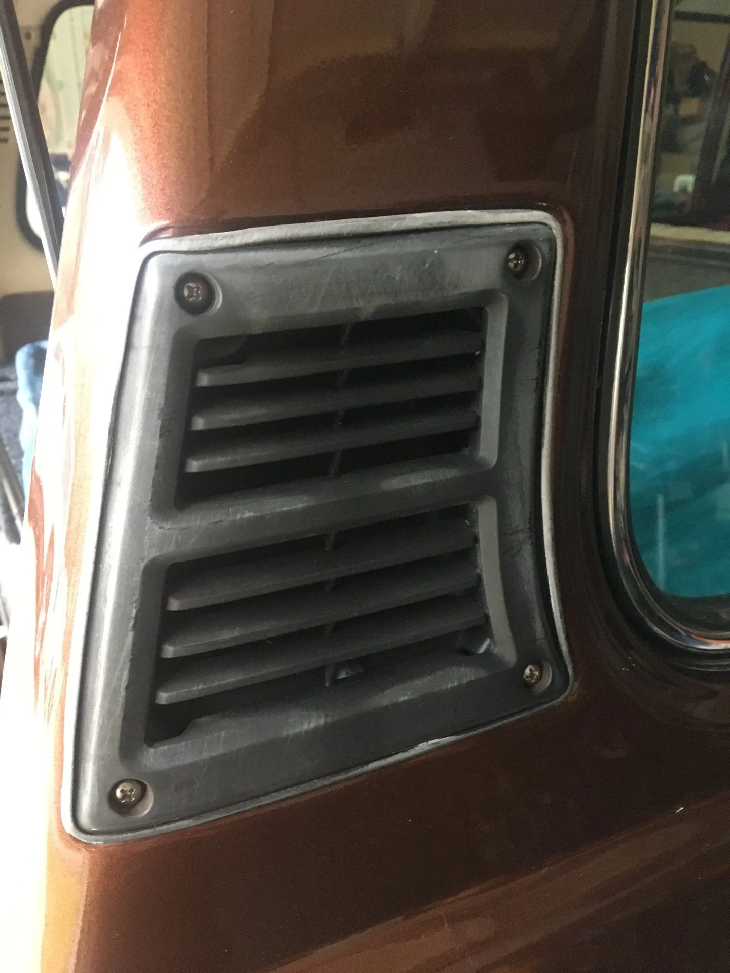

This upgrade was just as satisfying at replacing my hood insulator. Here are the before and after....
Ok, so when you order these go ahead and order the grommets. These will put a bit more pressure on your grommets as the new vent is metal vs plastic. Mine literally just crumbled and the ones that seemed fine just crumbled when I touched them from the backside. Anyway, The part number called out before was correct and I ordered extra as I do whenever I order parts. I used toyotapartsdeal.com and they were only $.34 each. It's a dealer out of Ca.
1900866
Mine crumbled too. I went ahead and used rivnuts.
