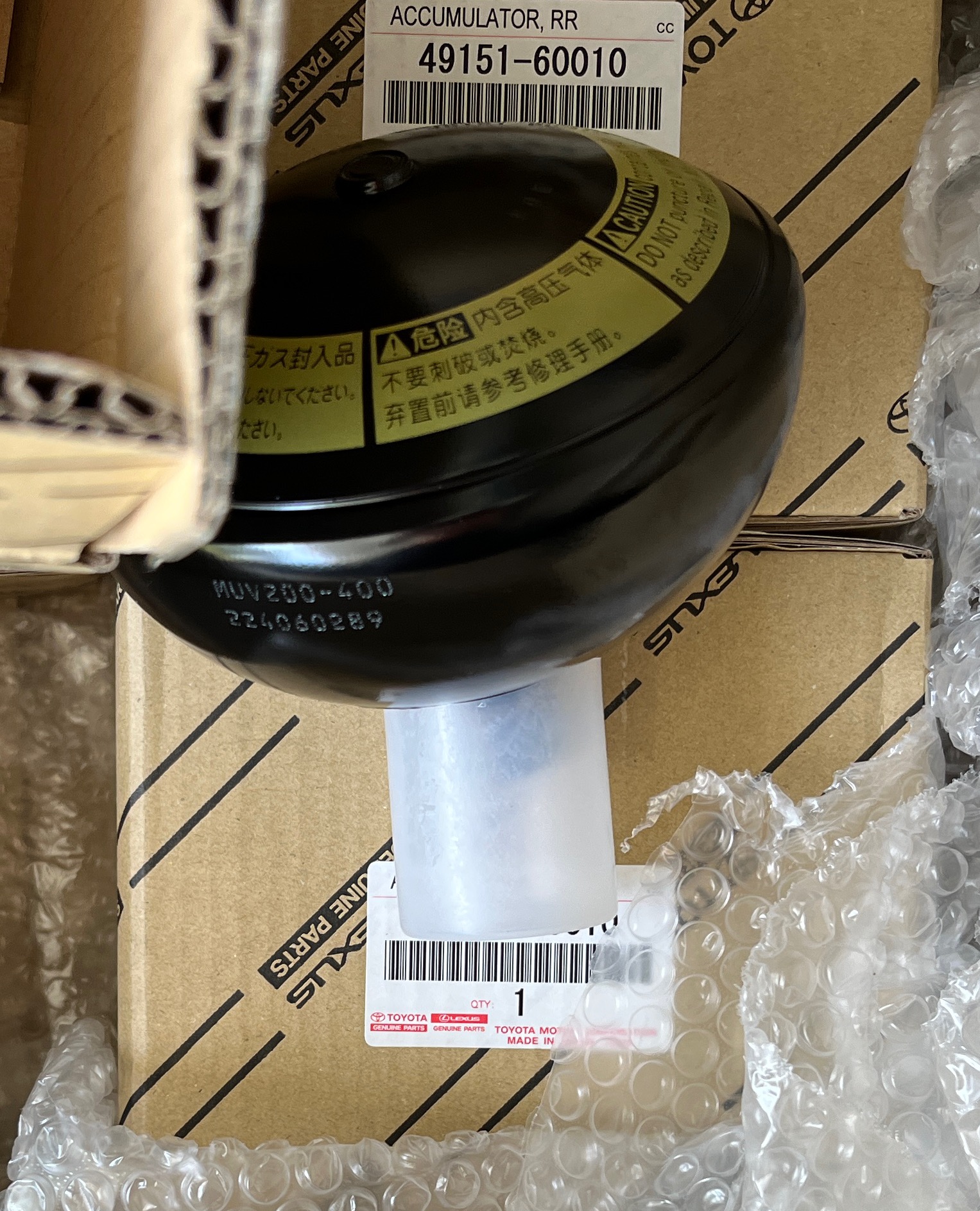

This weekend I plan on replacing the AHC globes on my 06 LX with 260k with the new ones I bought from Impex. I’m at 8 graduations now H to L.

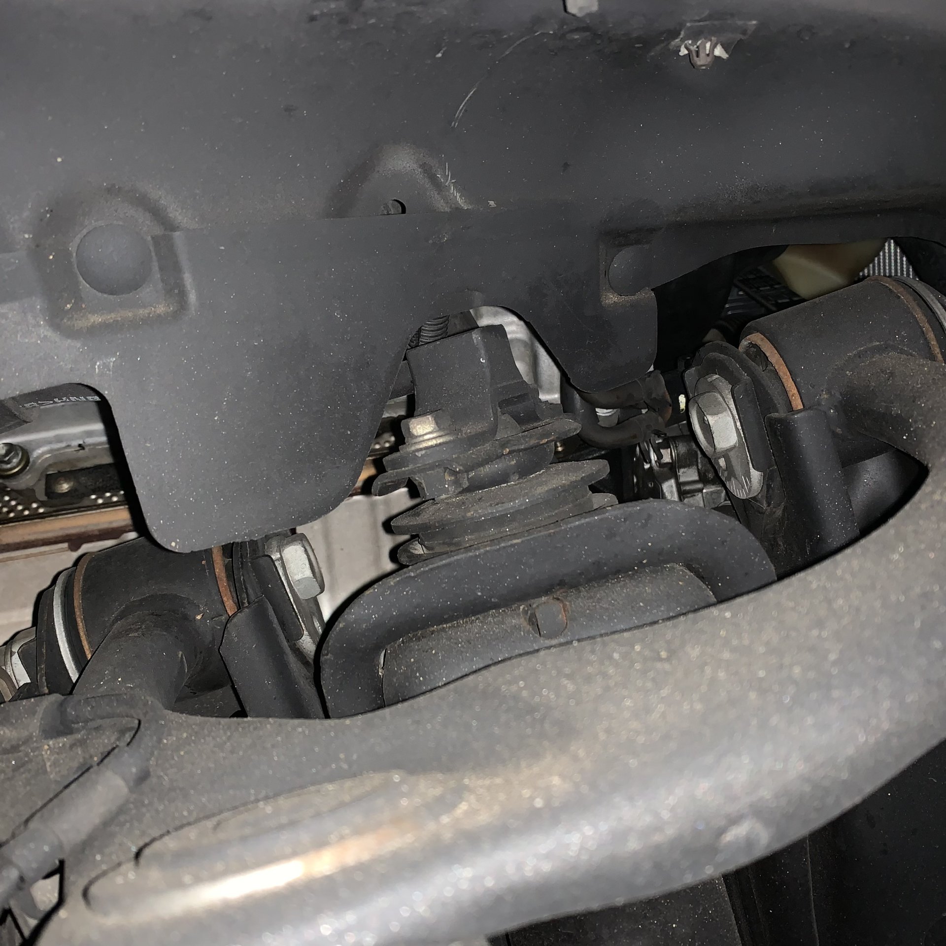

I’ve been contemplating removing the front shocks entirely to do the upper cushions as well as the lower bushings. I’d need to order the pieces for the upper fronts.
I have a 2.5L tin of new AHC Oil. And 4 weeks ago I flushed out the old oil with a fresh 2.5L tin before deciding to order new globes via Impex.
So, finally, my question…should I remove the AHC shock to replace the upper cushions and insulators while affording me easier access to press the lower shock bushings out and in with my ball joint style press?

I would definitely vote for removing the entire AHC shock if you're going to be doing globes and therefore a bleed anyway. Assuming you're not too rusted out, I think it's work the extra few buck and time.

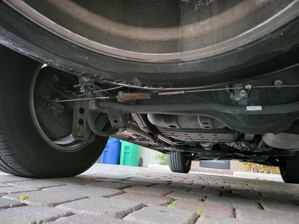

Thank you for the insight. No rust, lucky...the e-brake turnbuckle is the worst of it!

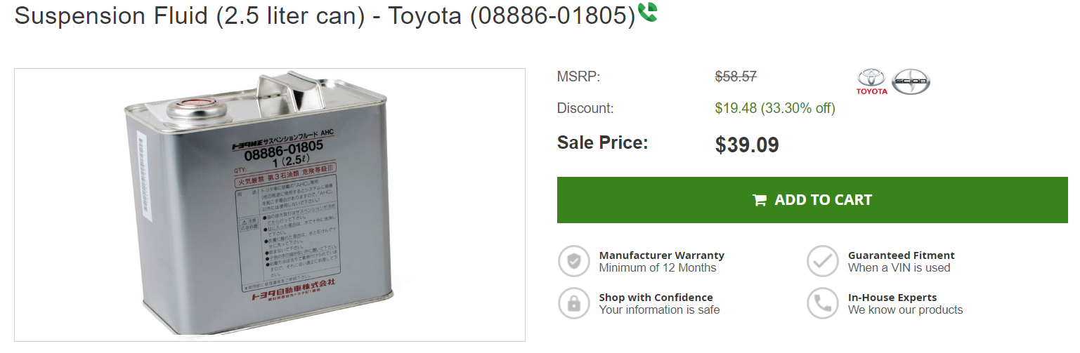

Looks like AHC fluids are on national backorder (2.5L drums), impex no longer ship these since early May and I'm down to 6.5L of these in my garage.
Local stealership is asking for $70-90+ tax on these (if they have them).
That's not welcome news. I was about to order some to have on hand when I replace the ram bushings.
Looks like the AHC fluid is labelled hazmat. Amayama offers sea shipping for these and 4 cans costed me $35.50 each with a manual shipping quote.
I’ll get them in up to 3 months time.
Replaced my factory globes with new Toyota globes due to increased road transfer. Removal of old globes was a lot easier than expected. I started using penetrating fluid a week ago and the globes turned right out with a 36mm crowfoot and my 16 inch torque wrench. Was kind of surprised the thin 36mm crowfoot was still serviceable after replacing all globes.
