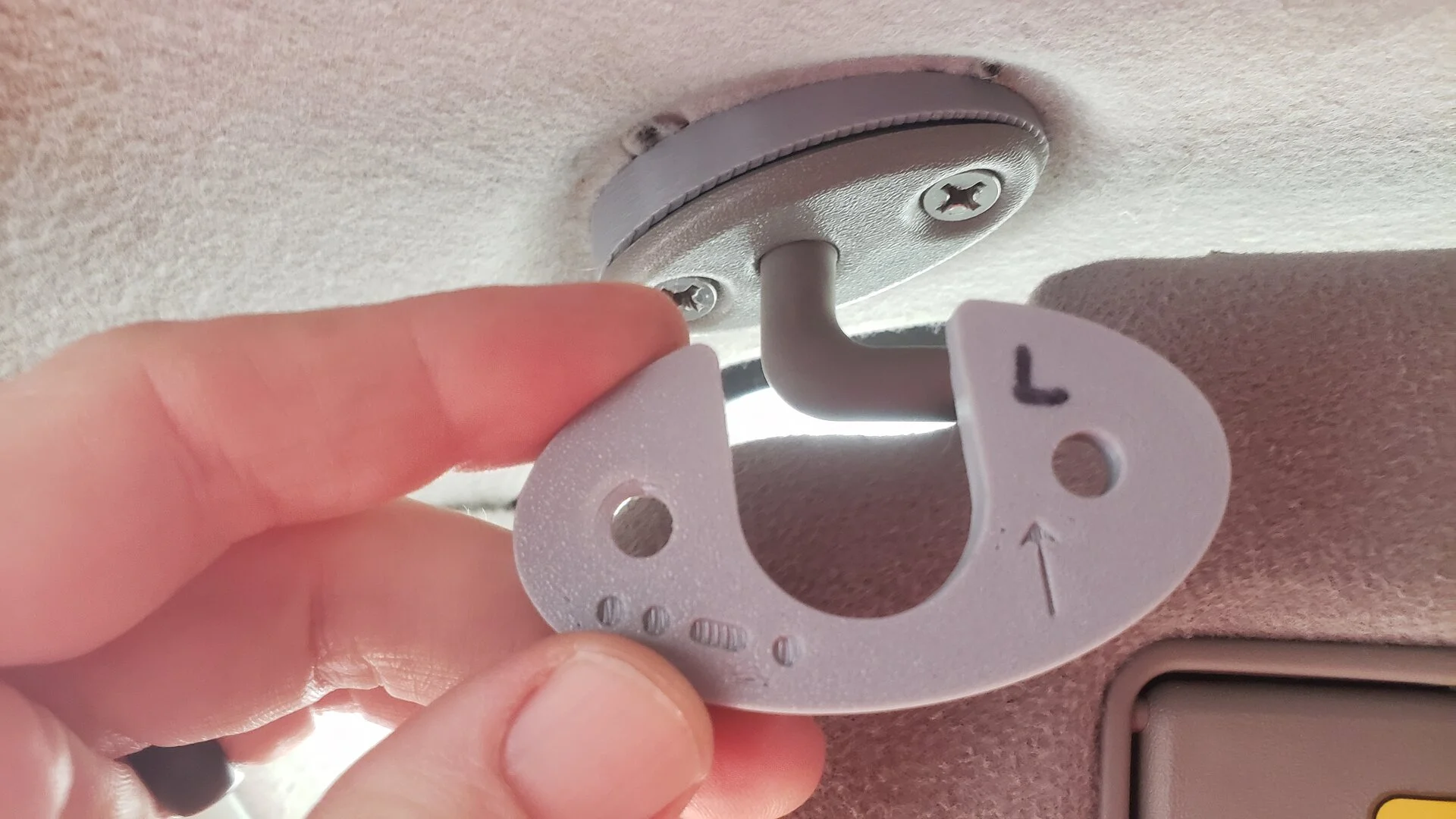

Hey Mudders,
If anyone can post up or DM me some pics of the mounting locations of their LS430 visors, that would be much appreciated. I'm using the Solve Function mounting parts and I'm getting some scrape on the headliner upon moving them toward the window, and it seems like they only work if I reverse them left to right. Only if I put the left side on the right, and install with the skinny side toward the center line of the rig do they work for me (opposite of the instructions). I've got to be doing something wrong here.
Am I missing something?
Thanks.

Hey Mudders,
Thanks.
Let me know if you are still having an issue happy to help out.
