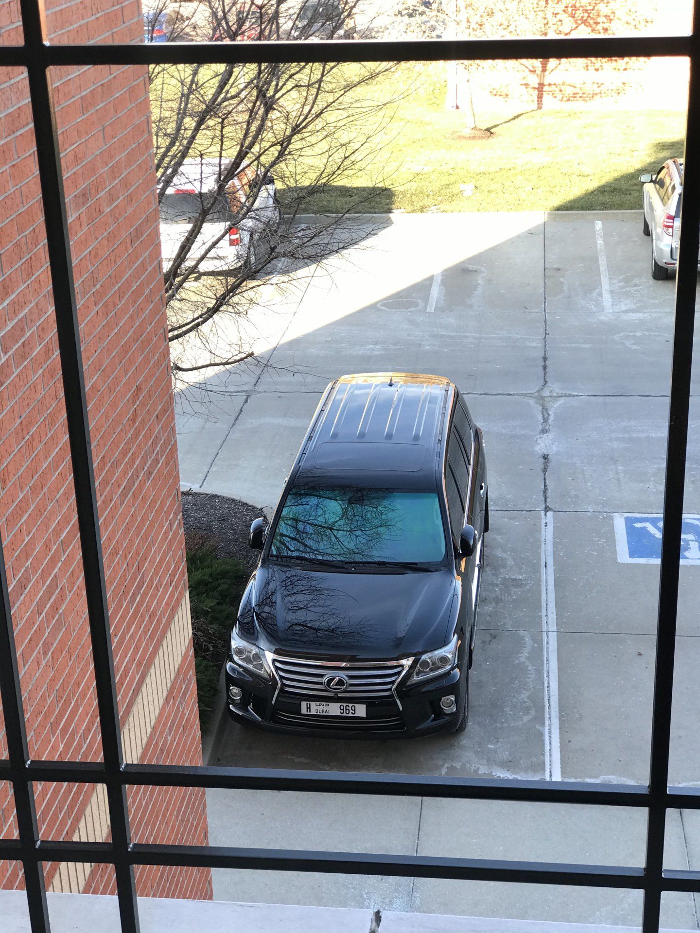

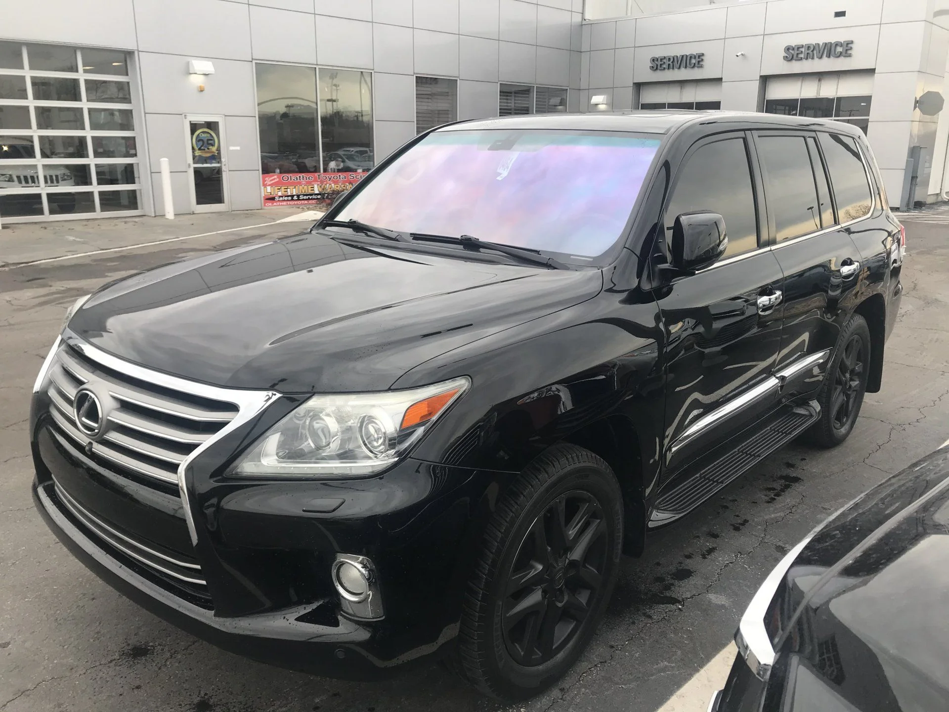

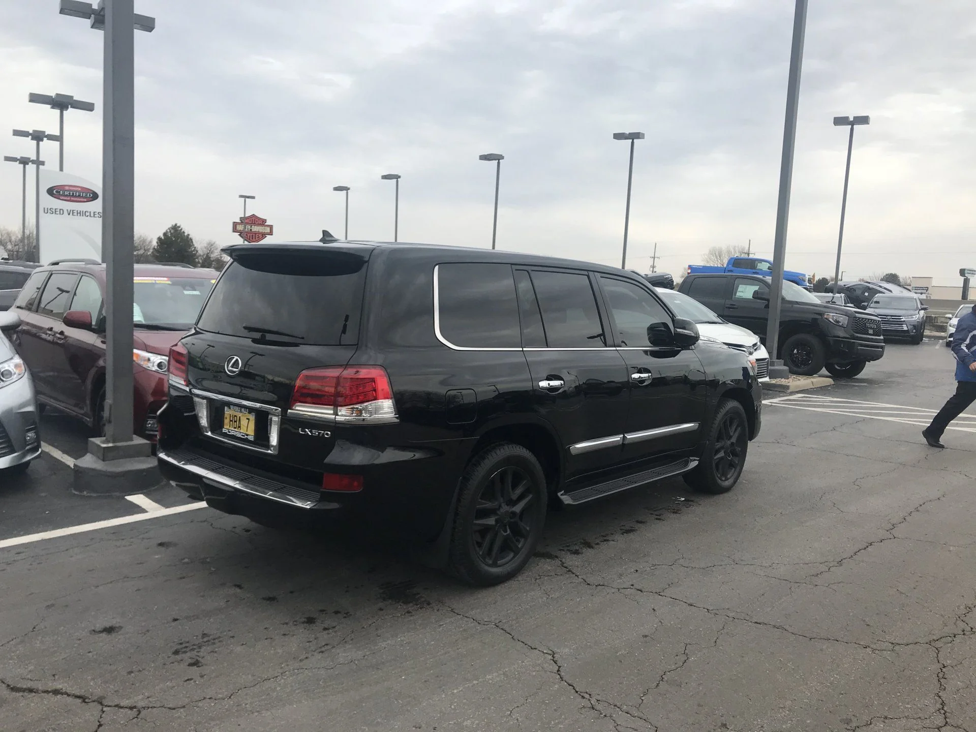

I appreciate that. They broke the tabs on one of the silver covers, but I didn’t say anything about it. Don’t plan on putting it on as long as I own the truck. Here are a few photos.

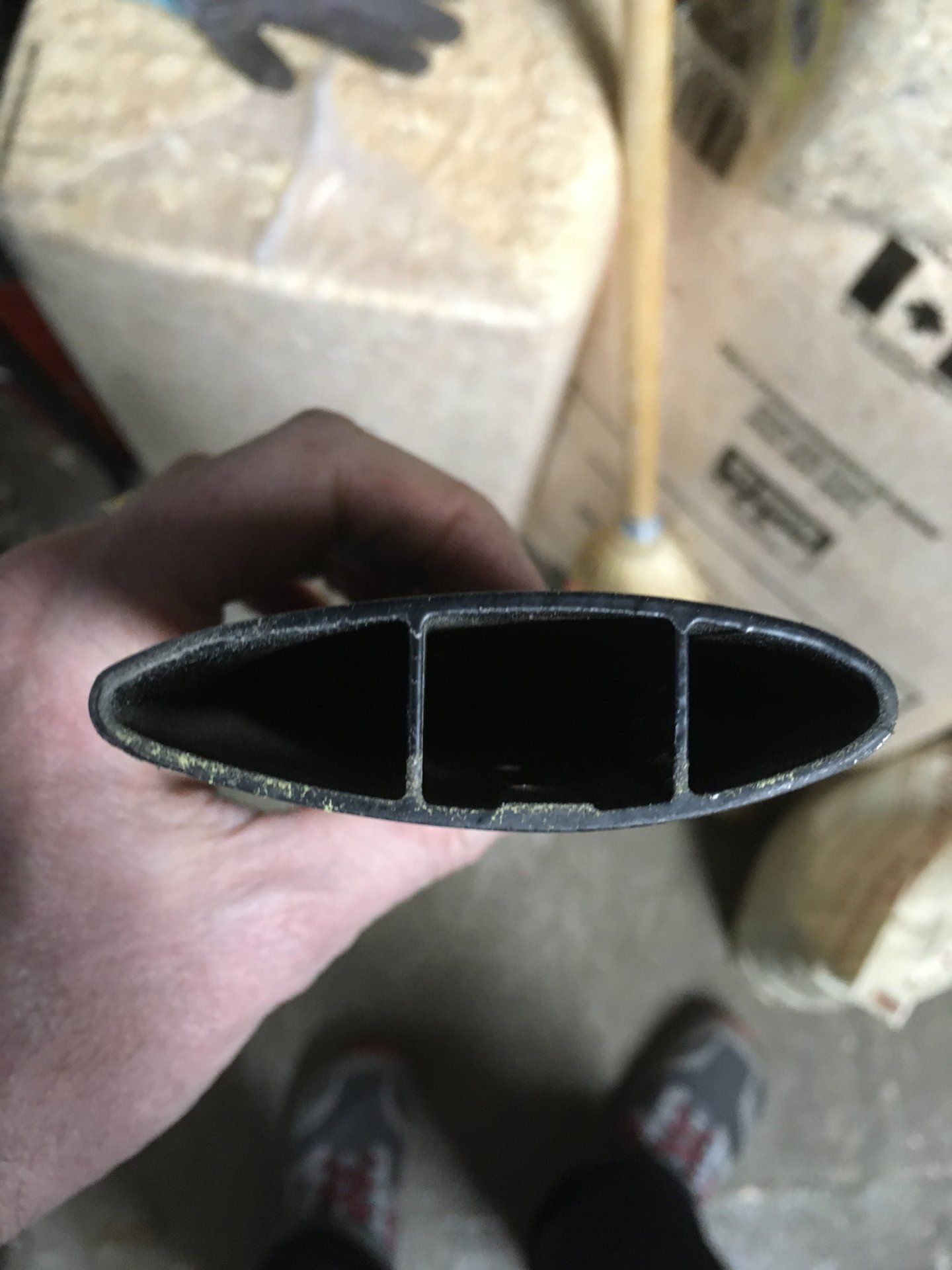

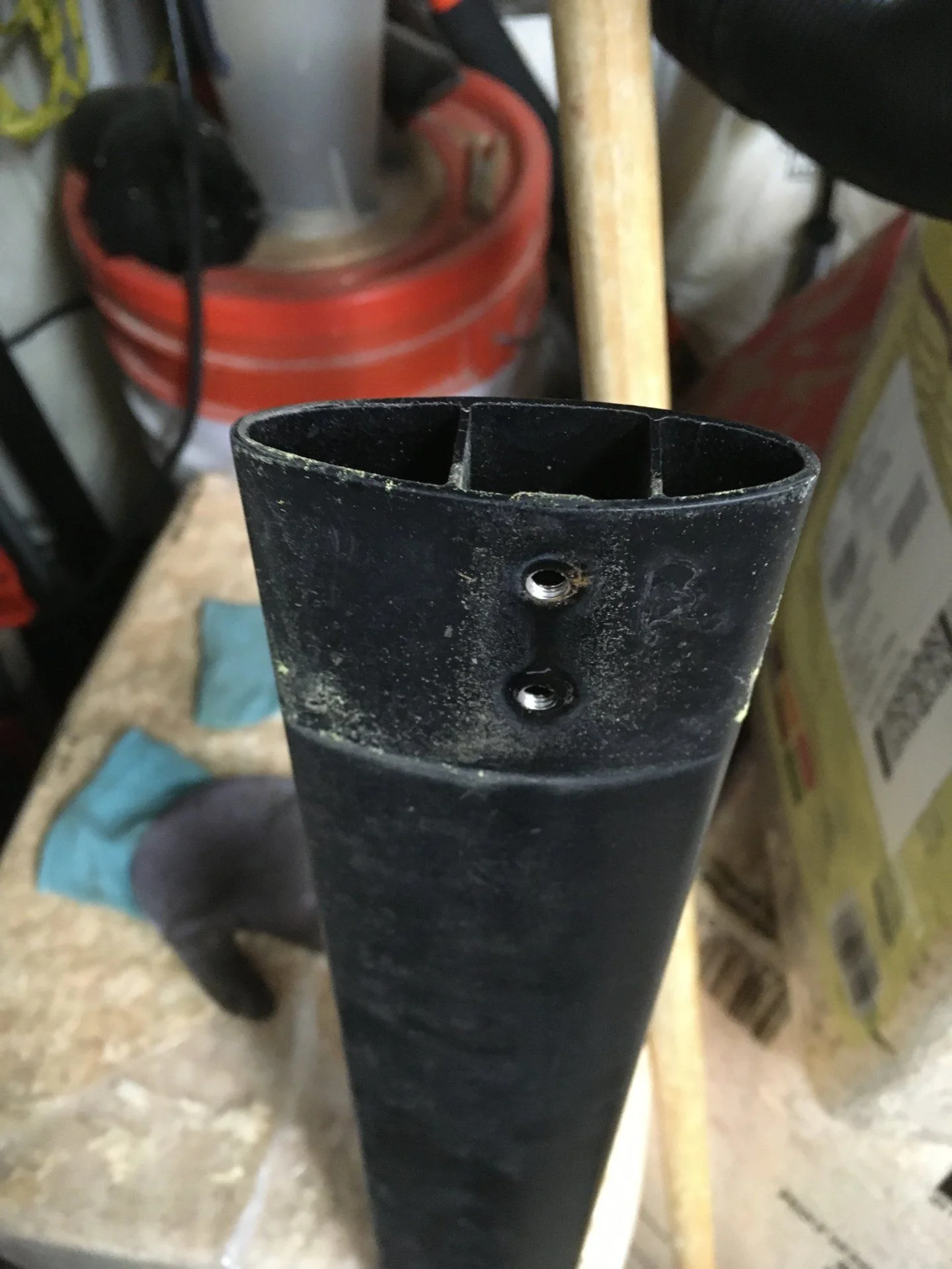

Cross Bars spoken for by @CharlieS
No I had an extra pair of the wider size already from a rack I got last year that was a two pad.
I guess they could be extended.... But I didn't try. Any additional cross bars I'll make out of 1020
