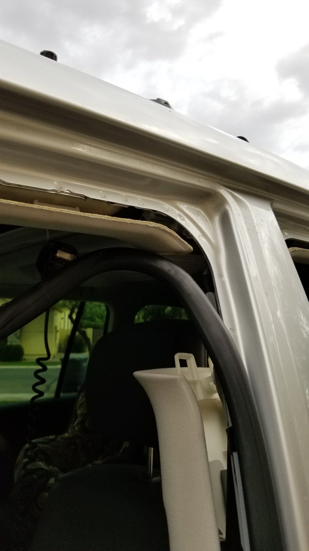

I waited till it was dark outside. I then took flashlight and looked down the hole. (this can't be done during the day since there is too much light).
I found the part sitting there and could also hear it rattle around in the head liner just behind passanger seat

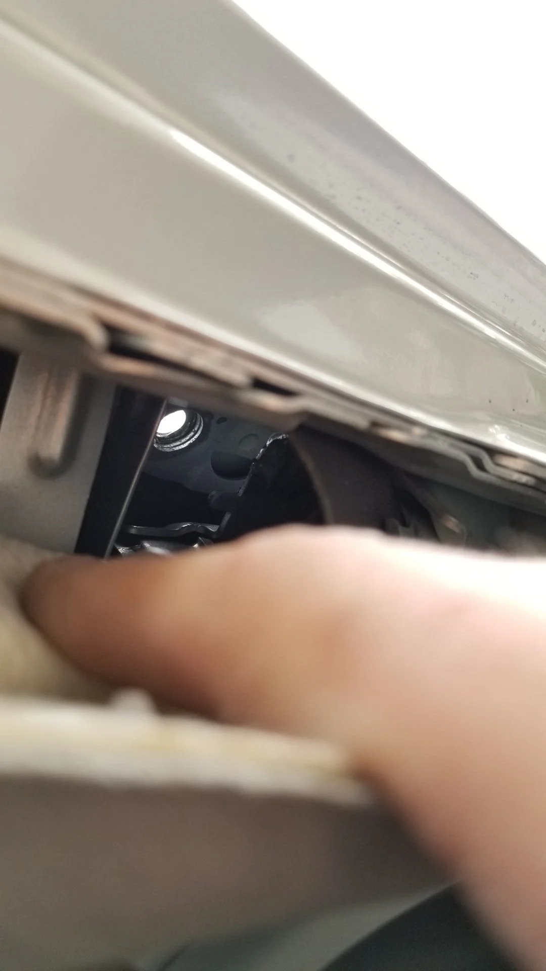

I pried the headliner by opening the seam a little and I was able to just reach the nutplate with my finger tips and pull it out
I then jimmy rigged a long wire tie to fishing line and fed it down the same hole and pulled it out the same crack in the headliner
I then fed the wire tie through the hole of the nutplate and pull it straight back into place.
I then screwed in a bolt to hold it
PM if you need more description but that is the jist of what I did

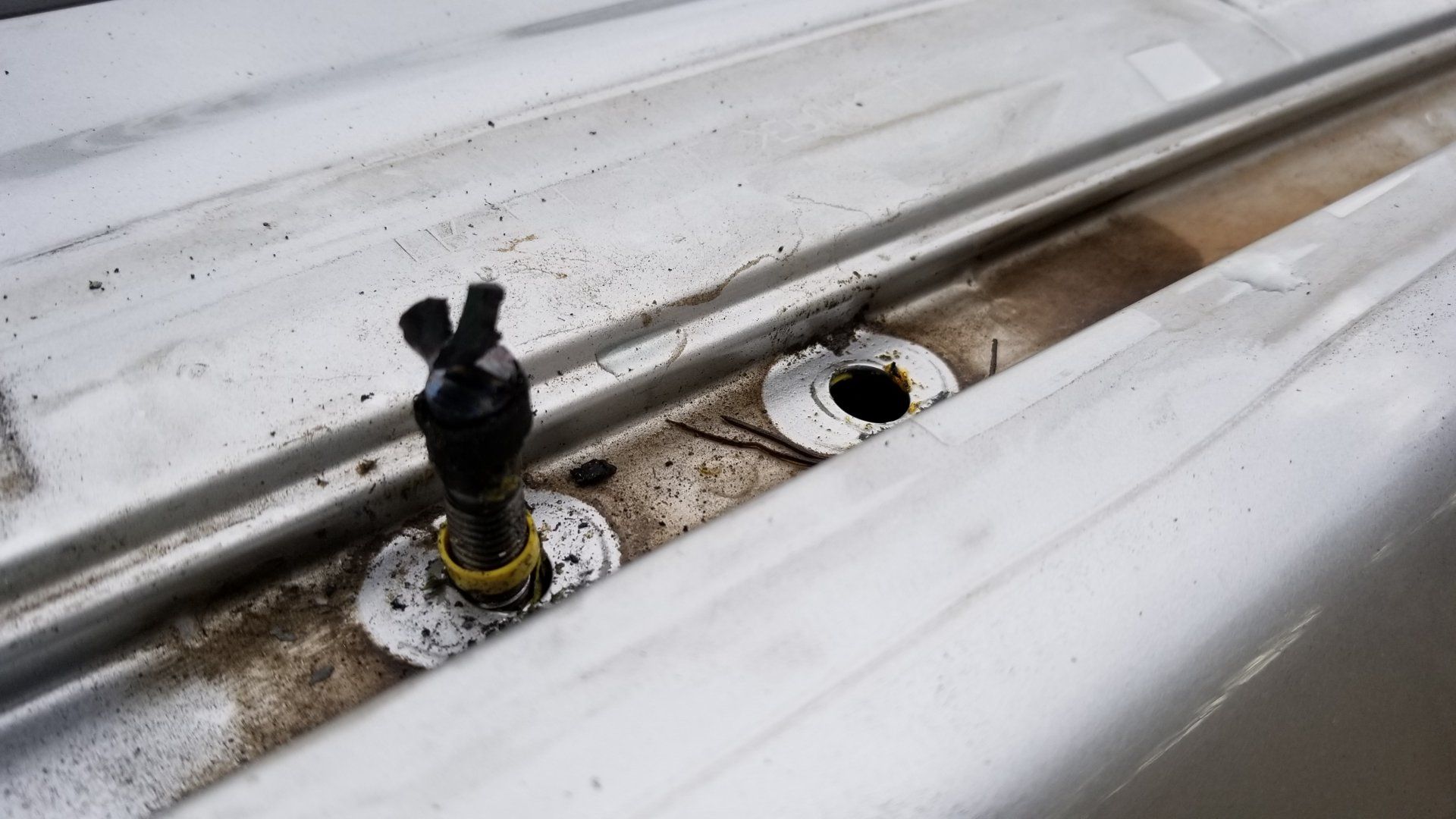

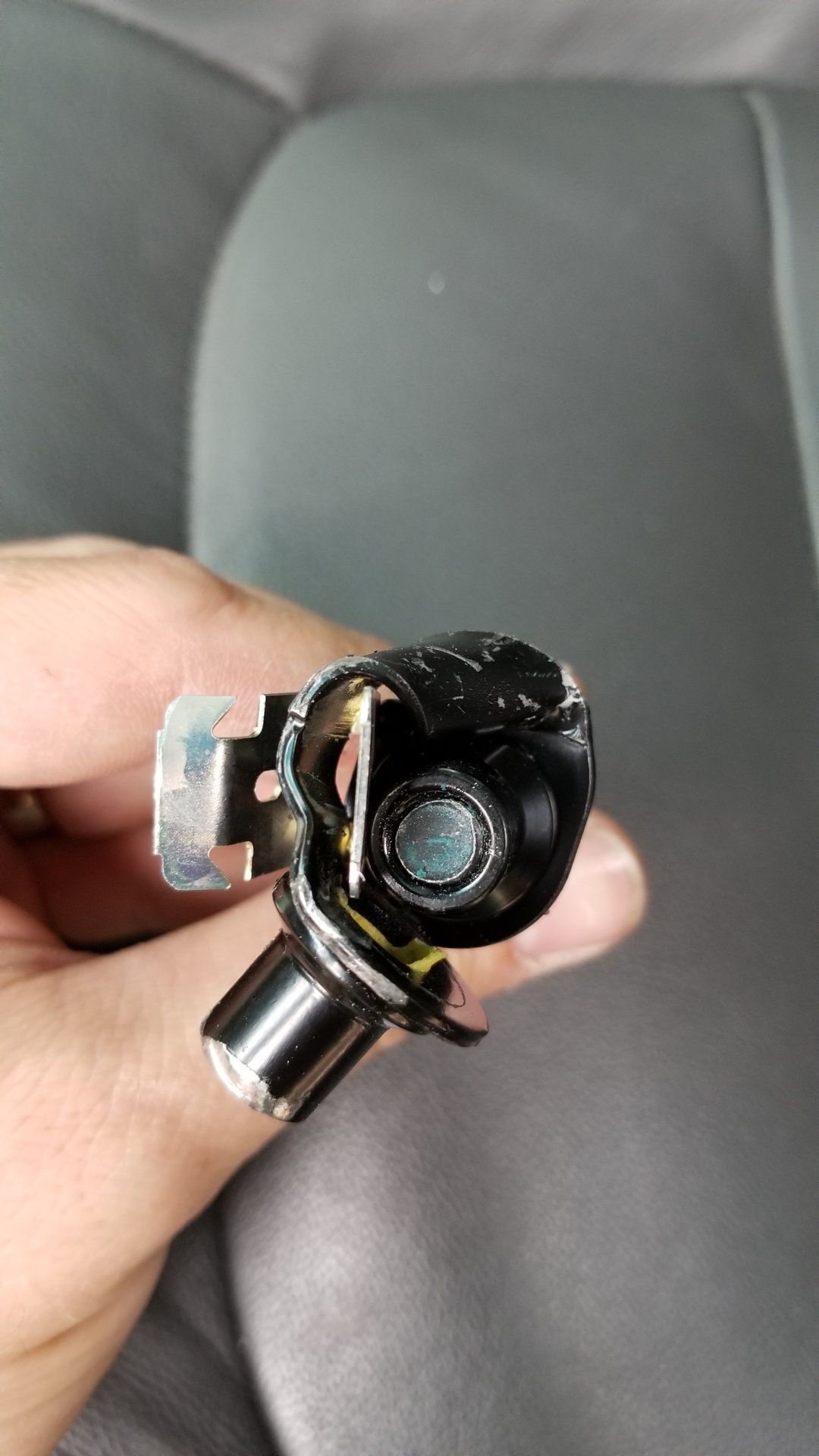

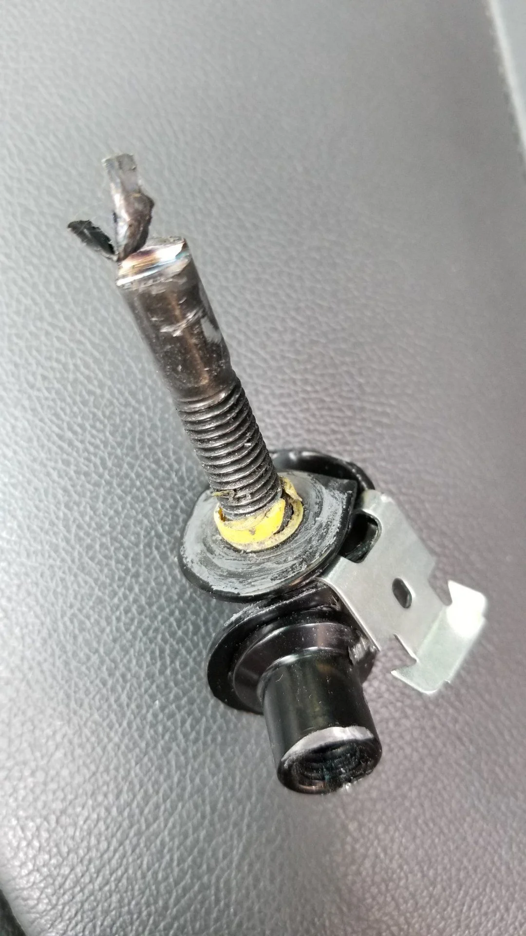

Well f*** me sideways. Thanks Front Runner for the complete lack of instructions. Until finding this thread, I had no idea I was supposed loosen both bolts before removing one of them. So I happened to completely mangle the bracket and had to go through the headliner to get it out. More pics to come, but I sure which I found this thread BEFORE starting this project!!! And yes, what you see is the bolt head cutoff with a grinder to get it removed...

Holy crap, winner of the most buggered roof rack bolt... you:D
I feel your pain as another victim of the factory roof rack nut design fail. Just tell yourself whatever doesn't kill you only makes you a better mechanic, or something like that
