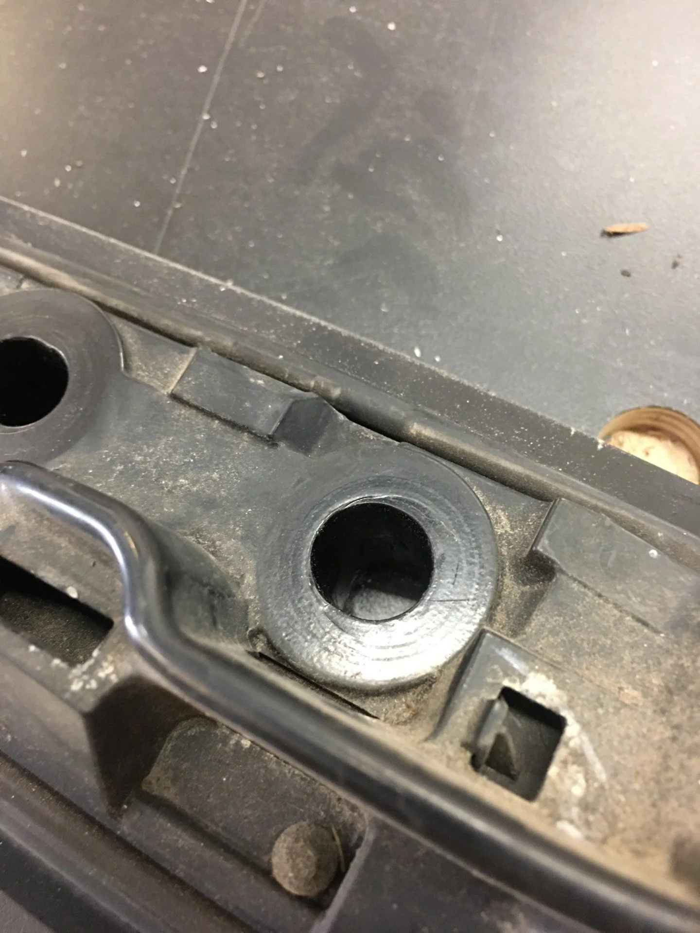

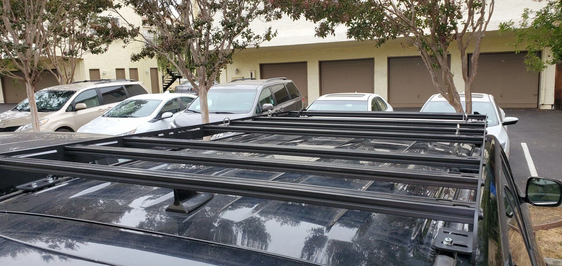

Installing a Prinsu rack on 2015 LX is my current C-19 Project.

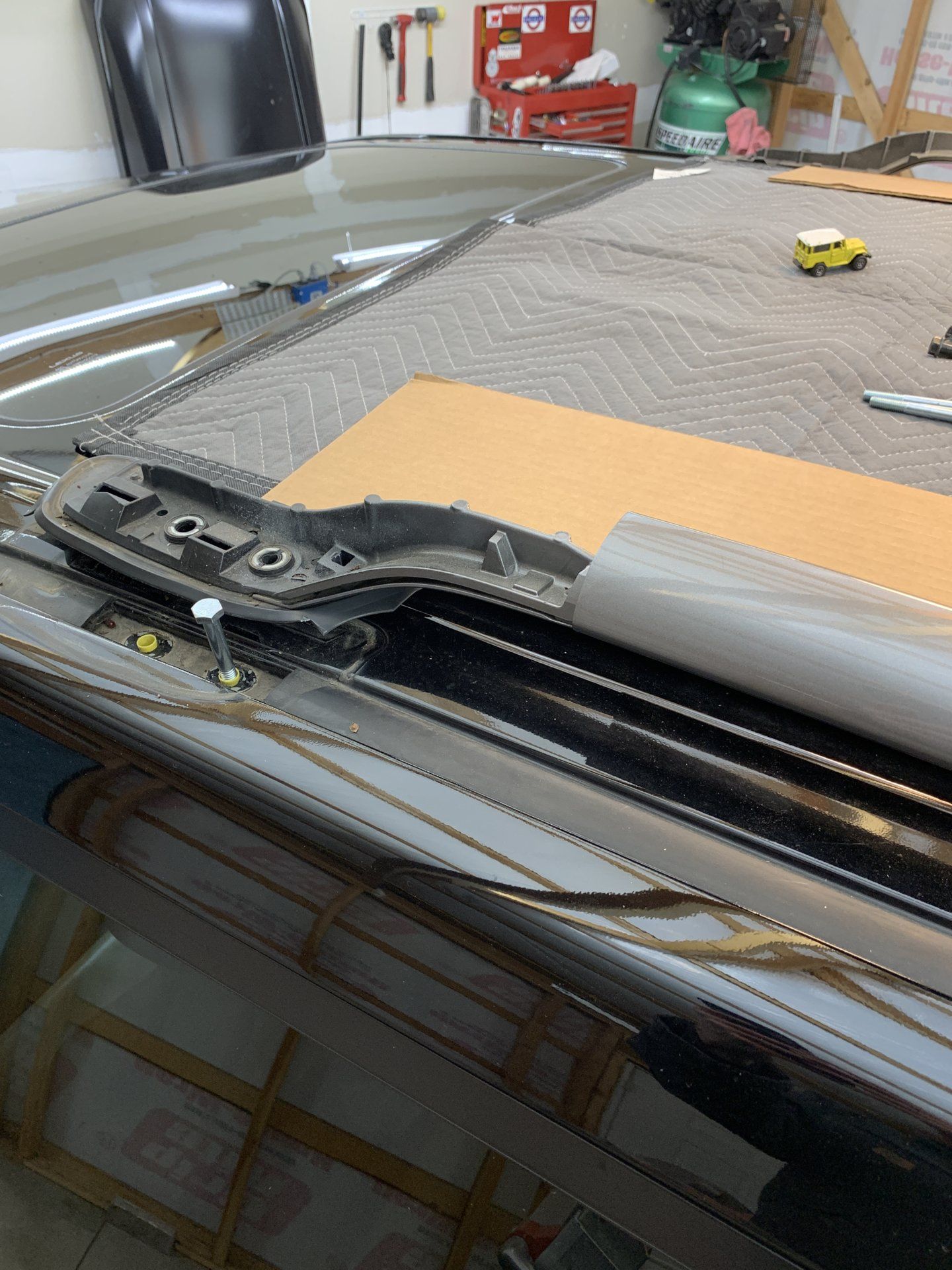

Drivers side bolts came out fairly easy with the captive nut plate staying put. When I started the passenger side I could tell the captive nut plates were both broken loose with a lot of up and down movement. There was some damage to the OEM rack so I am guessing there was some work in the past. One of the rubber grommets was missing too.

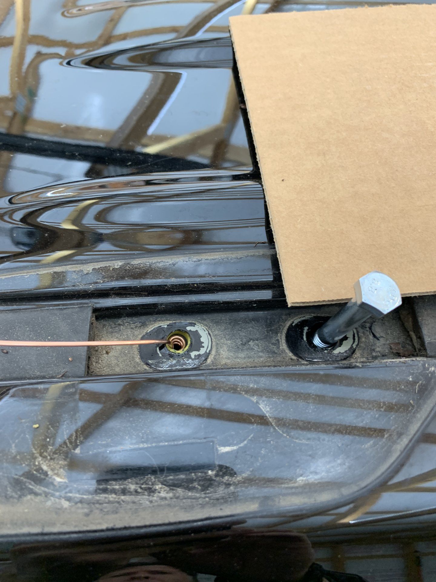

Using specialized tools (copper wire) I was able to keep the rear plate in place until I got the rack foot off and out of the way to get a bolt back in one of the holes.
The front capture plate was all messed up and I lost it down in the headliner. LED light down in one hole, I played Operation until I recovered it. FUN
Two different 'glues' in gutter/seam that will take a few hours to clean-up
I had to stop and glue the 2 captive nut plates in place as best I could and wait overnight...more to come.

Well my FUN never ends. The passenger side plates were really buggered by the last "work" so today as I tried to install the Prinsu side plates I had to tap the rear plate (8x1.25) to get the new bolts the thread back in correctly. What is good about the LX is 2 of the 4 are not used by the OEM rack so they were not eff'd up.
Basically passenger side 3 hours work; drivers side 30 mins.

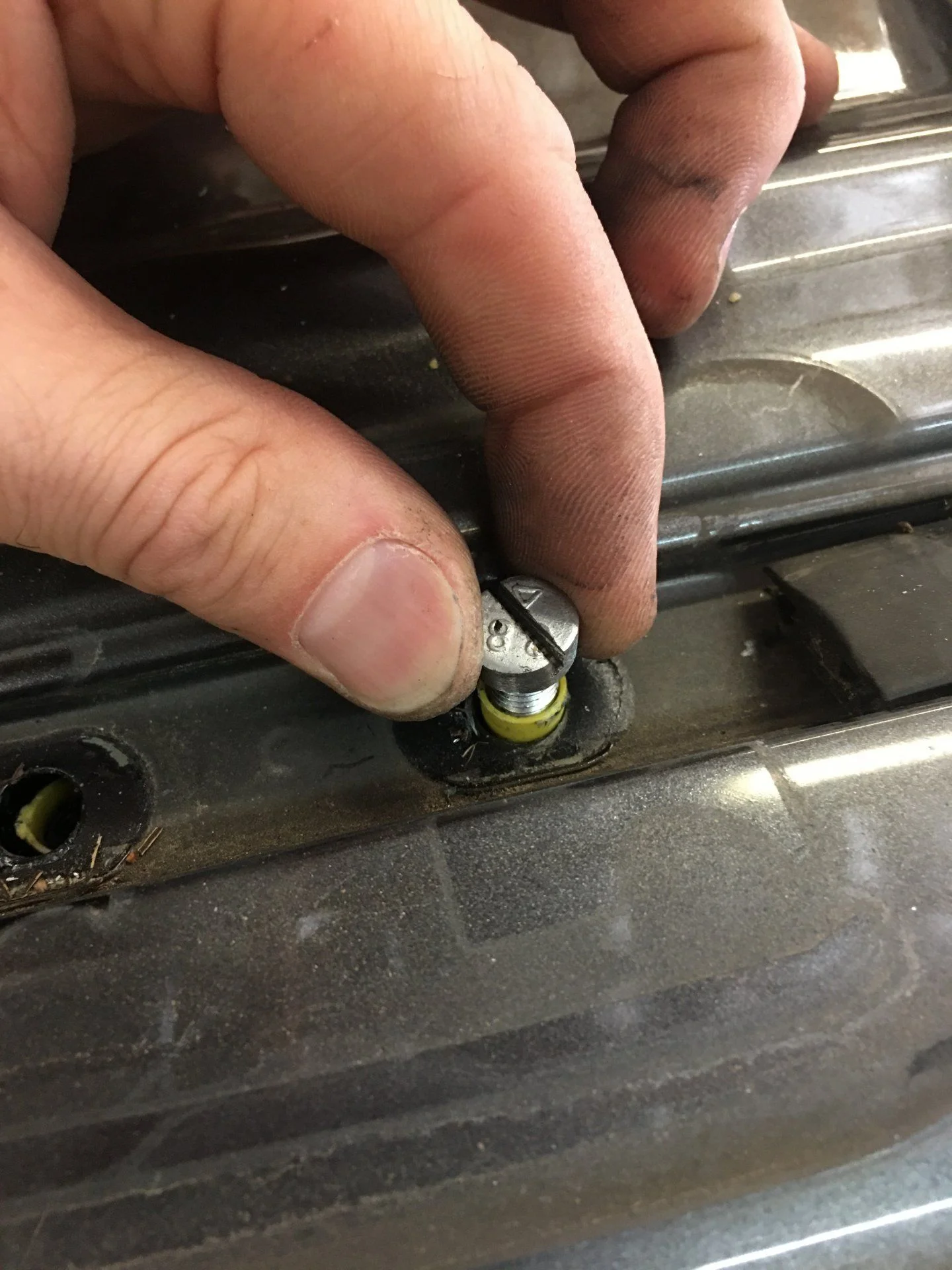

Hey guys. Here's a dirty fix I came up with to keep the nut plates from falling if you break one loose. Take another M8 bolt and grind the head round and just small enough to fit inside the roof rack's hole but not small enough to slip through the roof itself. grind a screwdriver slot across the head. Use this to secure one side of any loose nut plates while you take the rails off. Fast and easy.
Need more photos of your wheel and tire setup! Without rack would Be cool, too. Love the bronze. What size Nittos?
They are these from the Classifieds
Nittos are 285/60R18
Thanks! Meant on your rig. I have the same LX and was curious how they look.

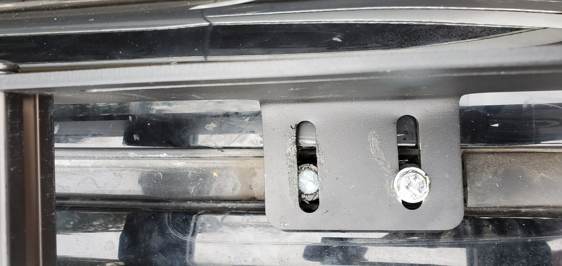

Hi All, thanks for all the great posts on removing the roof rails. We followed the guidance and successfully installed the prinsu rack BUT we still had problems with the back, passenger side mount point. One of the screws is in the nut plate but the other side of the nut plate is bent and will not line up with the other screw. We tried pulling it closer with a long, modified nail with no success. I have that screw hole filled in with silicone for the moment. Any ideas on how I can get the nut plate to line up with the screw? Or must I move on to headliner removal? Any ideas welcome!
Maybe loose all the others so that the bad one can be threaded. Tighten it up slowly to see if you can reshape the bent one a little. If it can’t be threaded your gonna have to drill out the prinsu a little
Loosen the other bolt holding that plate as much as you can (without it coming off) so you have some movement, try to get both bolts started before tightening either all the way. If it is the rearmost mount point, you could pop off the interior trim panels and back of the headliner to get to it for adjustment or replacement.

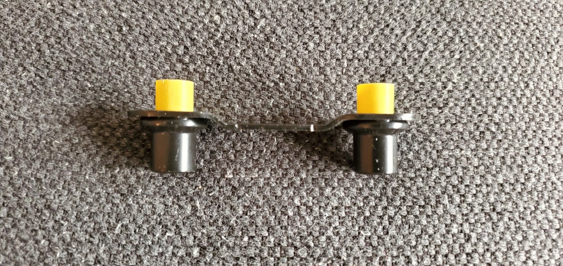

I’m glad I found this thread or I would’ve definitely broke the nut plate. Are you guys trimming the yellow tabs so that the spacer sits flush? Or do the yellow tabs compress when tightening the mount?
