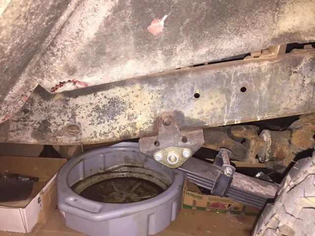

Well not sure if this is what you were looking for:

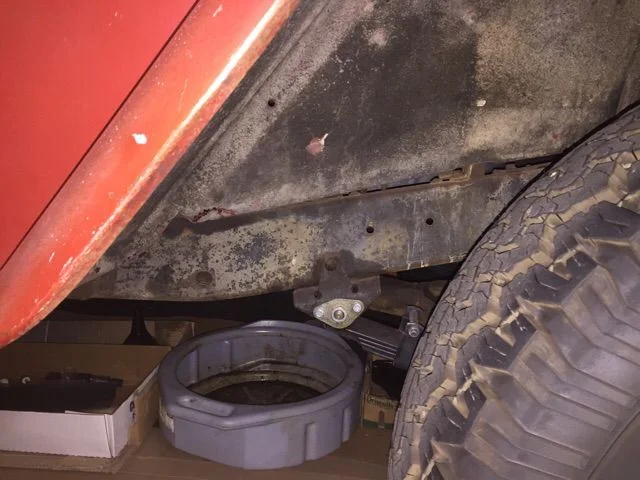

If not let me know and I'll try again. I know when I installed mine it wasn't easy and I needed to use a ratcheting strap to pull the spring into place.
JDC, sometimes the bolts are a smidge too long and touch the spring. Obviously any exposed thread inside the spring hanger is just wasted material. If this is the problem, just cut/grind the bolts shorter as needed.
Thanks Jim. I am planning on using blue loctite for final assembly. Is there a better product or is this overkill?
Those little bolts are only there to keep the big shoulder of the springpin held into the precision hole of the spring hanger. They don't really see much load & never loosen up IME. A little loctite won't hurt, but is prolly unnecessary. Actually, because you are also in OH, I strongly recommend anti-seez on all the things. You & I will have far more difficulty with rusty/stuck fasteners, rather than fasteners that come loose.
FWIW, things that do loosen up, IME: shock bolts/nuts, spring u-bolts & nuts.

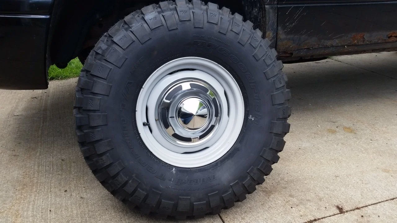

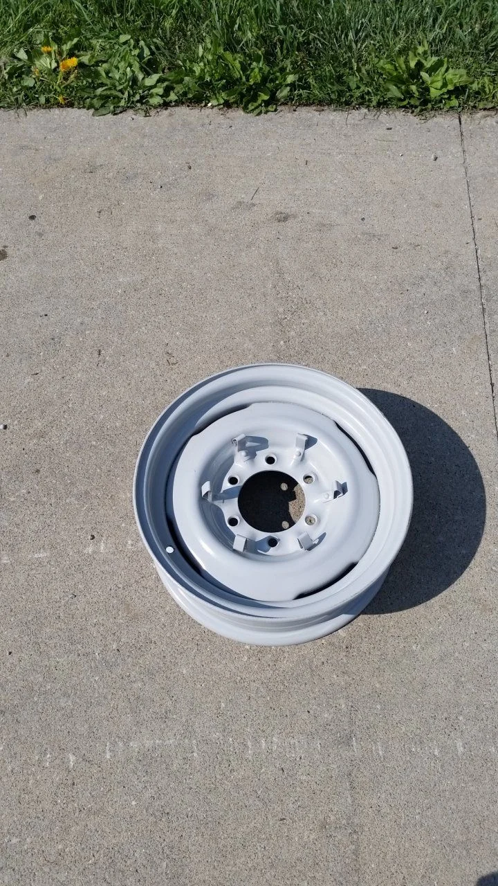

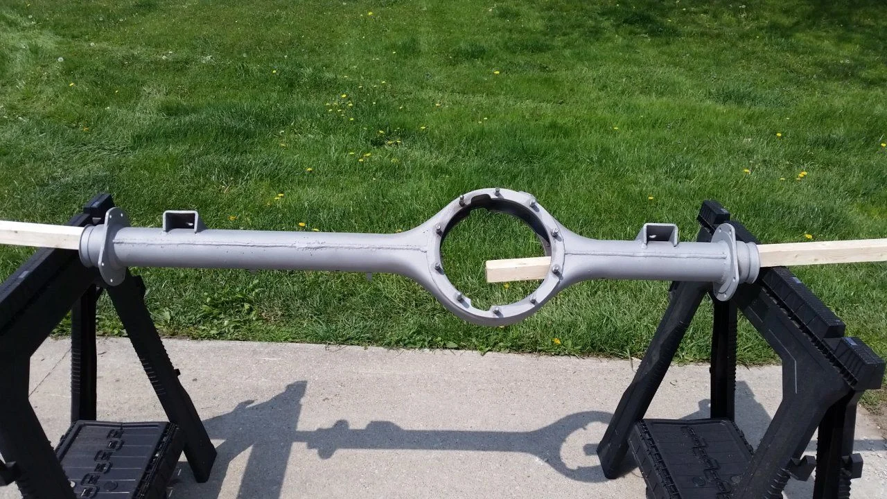

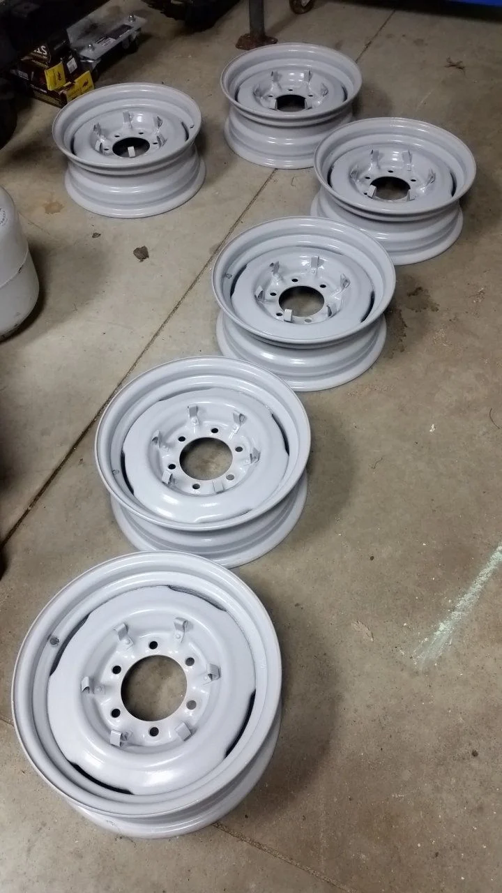

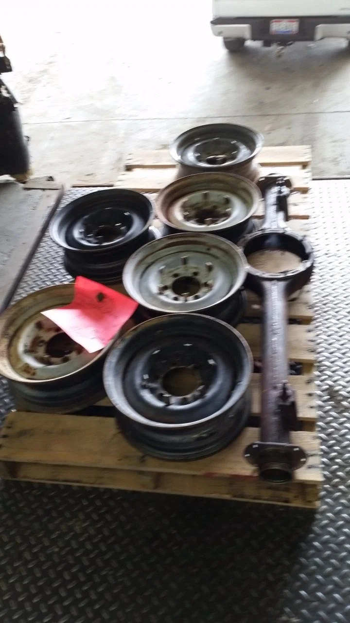

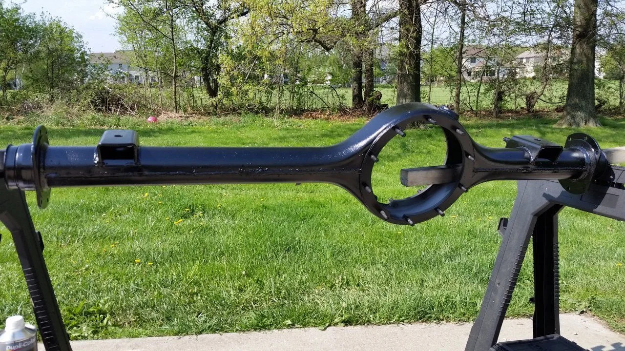

Did you blast the axle and wheels yourself?
And then had the wheels commercially PC'd, and painted the axle yourself?
Thanks jim,
We had the same company that did the frame sandblast both and pc the wheels. I painted the axle housing.
After putting a hubcap on I do not like the how light the rims turned out. I will let them sit awhile and then might scuff and paint with a color matched to original.

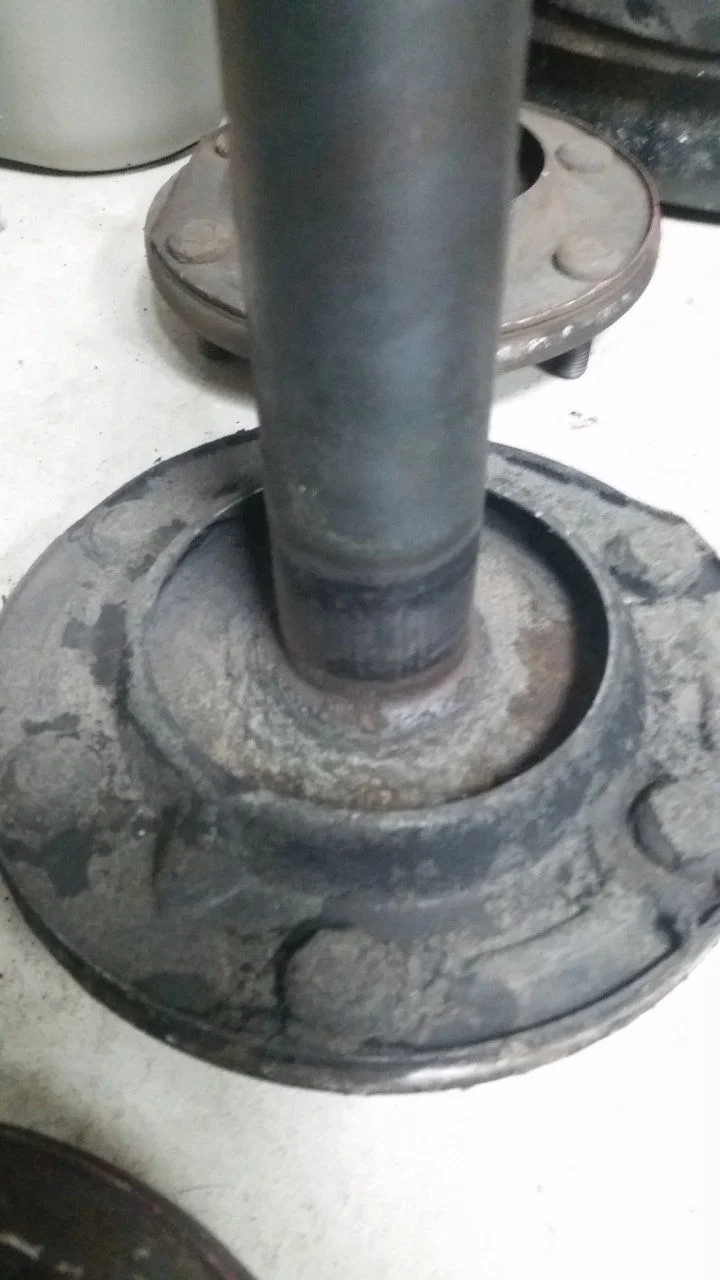

The usual rear axle seal is a rubber encased design. They do not get sealant.
In general, the only type of seal that *may* get sealant is the style w/ bare metal OD.
