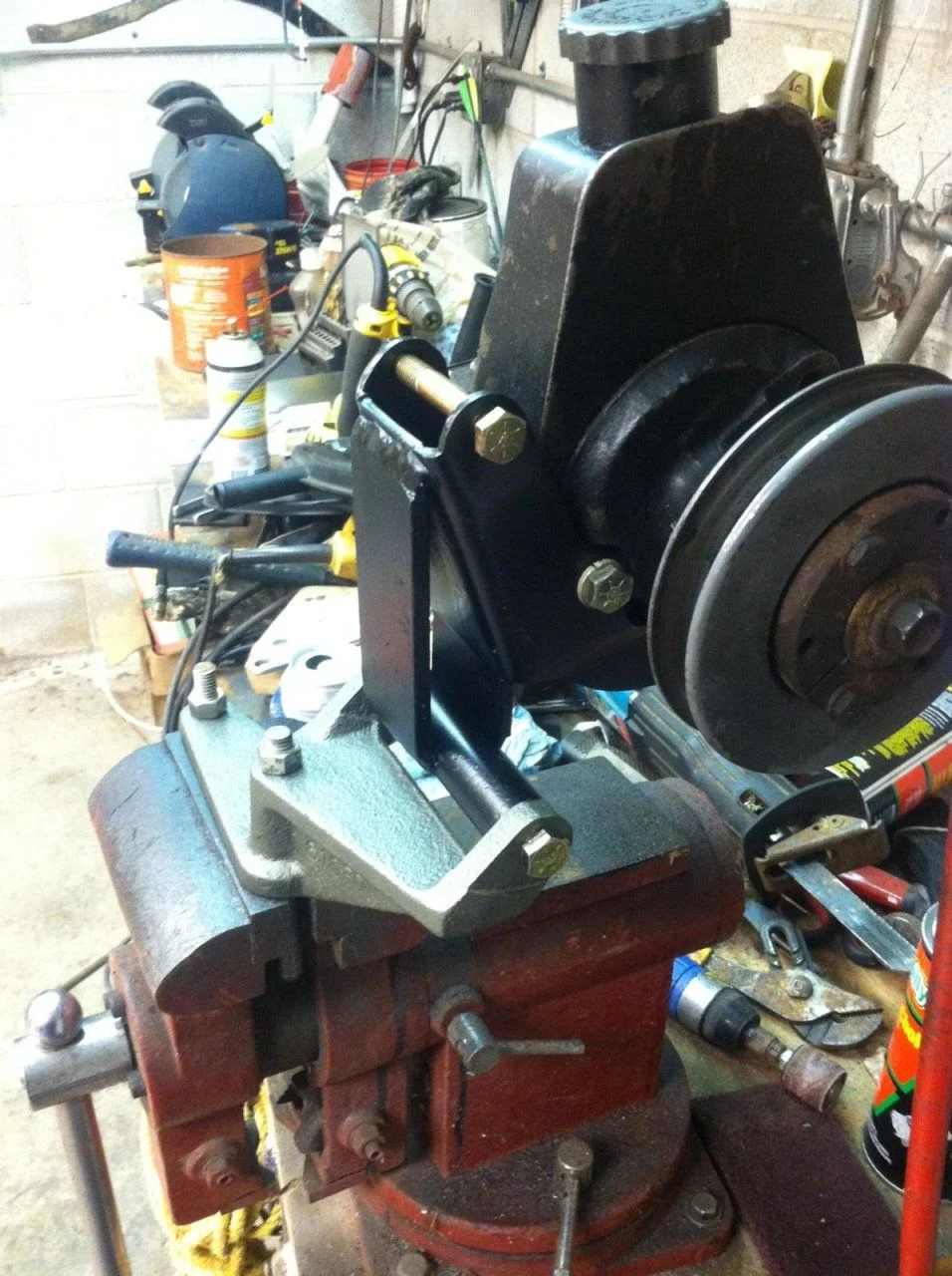

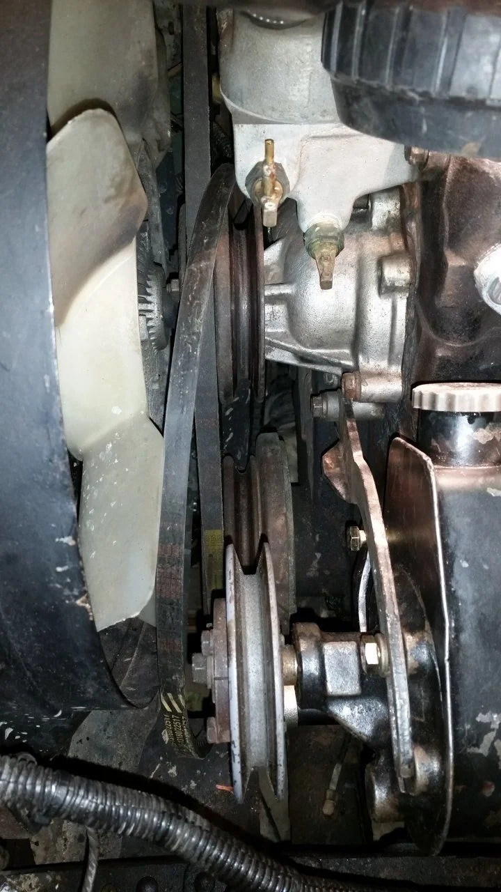

Focusing on the Saginaw mount, I made a spacer for the lower front mounting holes, sourced a 1/2" bolt from lowes and tried a shorter belt. The shorter belt, threw everything off. Reinstalling the TR22455 15mmx1172mm belts made the pulley alignment better. I'm going to think about overnight, but might slot the bracket holes at the block to allow a small adjustment towards the rear of the engine....
Shorter belt:
TR22455:
The stud that I had the adjuster mounted to was not allowing the arm to sit flush along the back of the pump. I removed it and installed a bolt. When I fill the pump, I'll use some rtv in the threads to seal it.
Looking good man, getting those brackets right are a PITA. Looks like you got it pretty darn close.
Thanks, I used Mark's bracket. I've got it dialed in now. I just need to take it apart, sandblast, repaint and reassemble.
COOL, glad you got it worked out.
I know I had to fiddle with mine for a day or two to get everything worked out. My bracket is home made using a rifle barrel blank and the bracket from the smog pump and modified part of the saginaw bracket.
