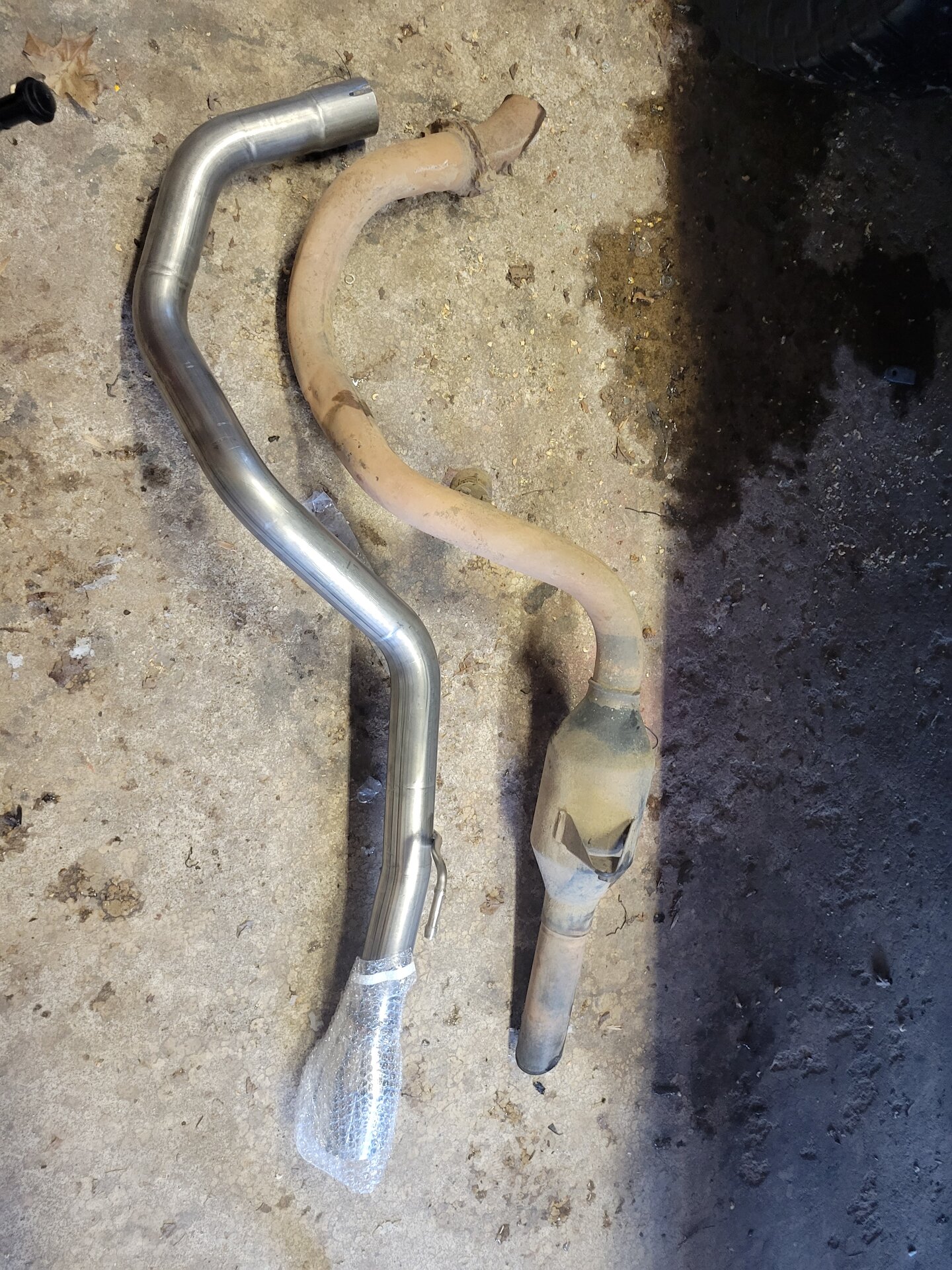

I was able to un-bolt the handle and remove the factory pipe from the head, then install the M12x1.00 to 1/4" NPT adapter from there. So the rest of my setup is all normal 1/4" NPT - I used a flex hose and tire inflator with a gauge from Harbor Freight. This was partially due to where I mounted it, so the hose would not interfere with the strut on the hood, but also allowed me to add in a pressure shut-off switch. If you mount it lower or somewhere else you can keep more of the factory compressor parts.
