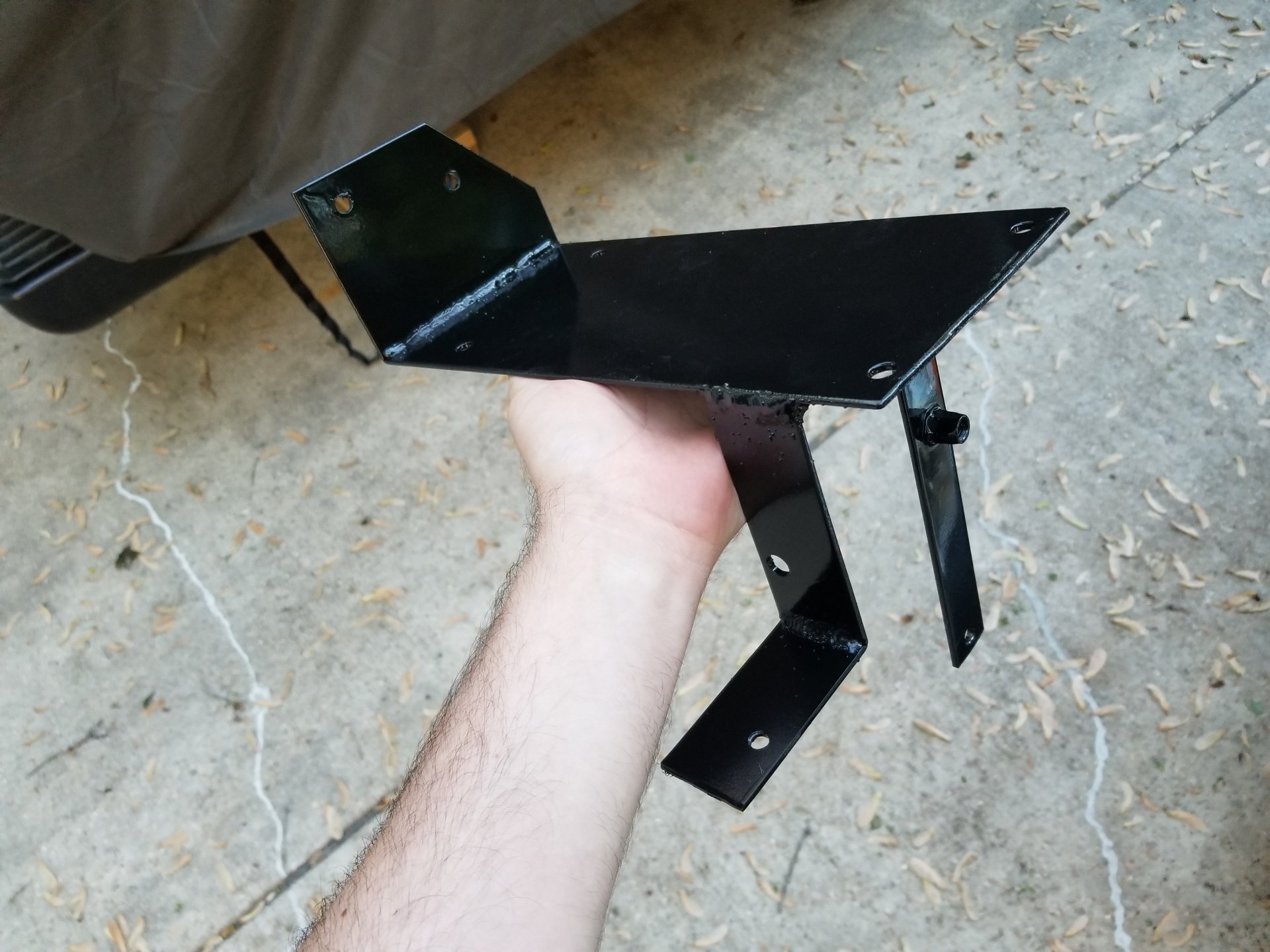

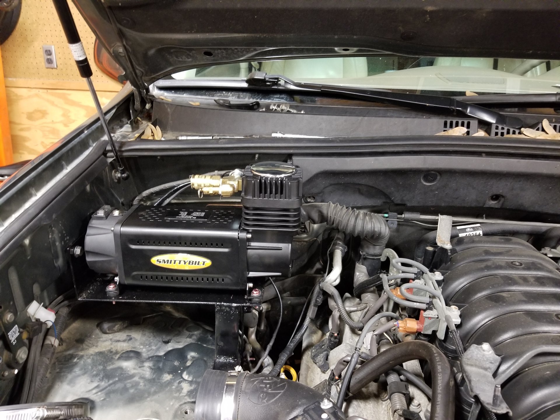

Added onboard air today. I used a Smittybilt 2781. I fabricated the tray out of a 5-inch wide piece of 10-ga steel and the feet out of some scrap pieces of 1/8" steel, using a cardboard template. Unfortunately I did not have my flux core voltage/wire feed settings quite right and got a ton of splatter, but no one will see it anyway, so I didn't bother grinding it. It holds the compressor really well.
For the compressor I modified it quite a bit by removing the "handle", threading a M12x1.00 to 1/4" NPT adapter into the cylinder head, and then adding a 4-way NPT block with a pressure switch, safety valve, and QD connector. The actual tires get aired up using a 25' flex coil hose with a inflator and gauge (all 1/4" NPT as well). I wired the compressor directly to the battery using 10-ga wire and a 40-amp circuit breaker.
On a test run I inflated my 32" tire from 18 to 32 psi in 1 min 15 seconds, which is about twice as fast as my handheld compressor. I still have a small air leak where the adapter is threaded into the cylinder head, so I hope I can get a bit more out of it. The Smittybilt is a decent compressor for the money, but it is Chinese....if I was wheeling a lot I'd pony up for a ARB twin. This whole set up with the compressor, bracket, wiring, fittings, etc cost me around $300.

I was able to un-bolt the handle and remove the factory pipe from the head, then install the M12x1.00 to 1/4" NPT adapter from there. So the rest of my setup is all normal 1/4" NPT - I used a flex hose and tire inflator with a gauge from Harbor Freight. This was partially due to where I mounted it, so the hose would not interfere with the strut on the hood, but also allowed me to add in a pressure shut-off switch. If you mount it lower or somewhere else you can keep more of the factory compressor parts.
There are a couple of problems with this compressor, including that it gets HOT. This past weekend it got so hot that a small hole melted in my flex hose when I was blowing up an inflatable kayak. The QD was too hot to touch as well. I've modified the setup a bit to account for that and will post a picture in a few days. The other is the wiring - it actually has a wire nut connecting the battery leads to the compressor motor (inside the compressor, under the switch area). I wasn't comfortable with a wire nut in an area that might get wet so I removed it and replaced it with a 10 ga heat shrink butt splice.

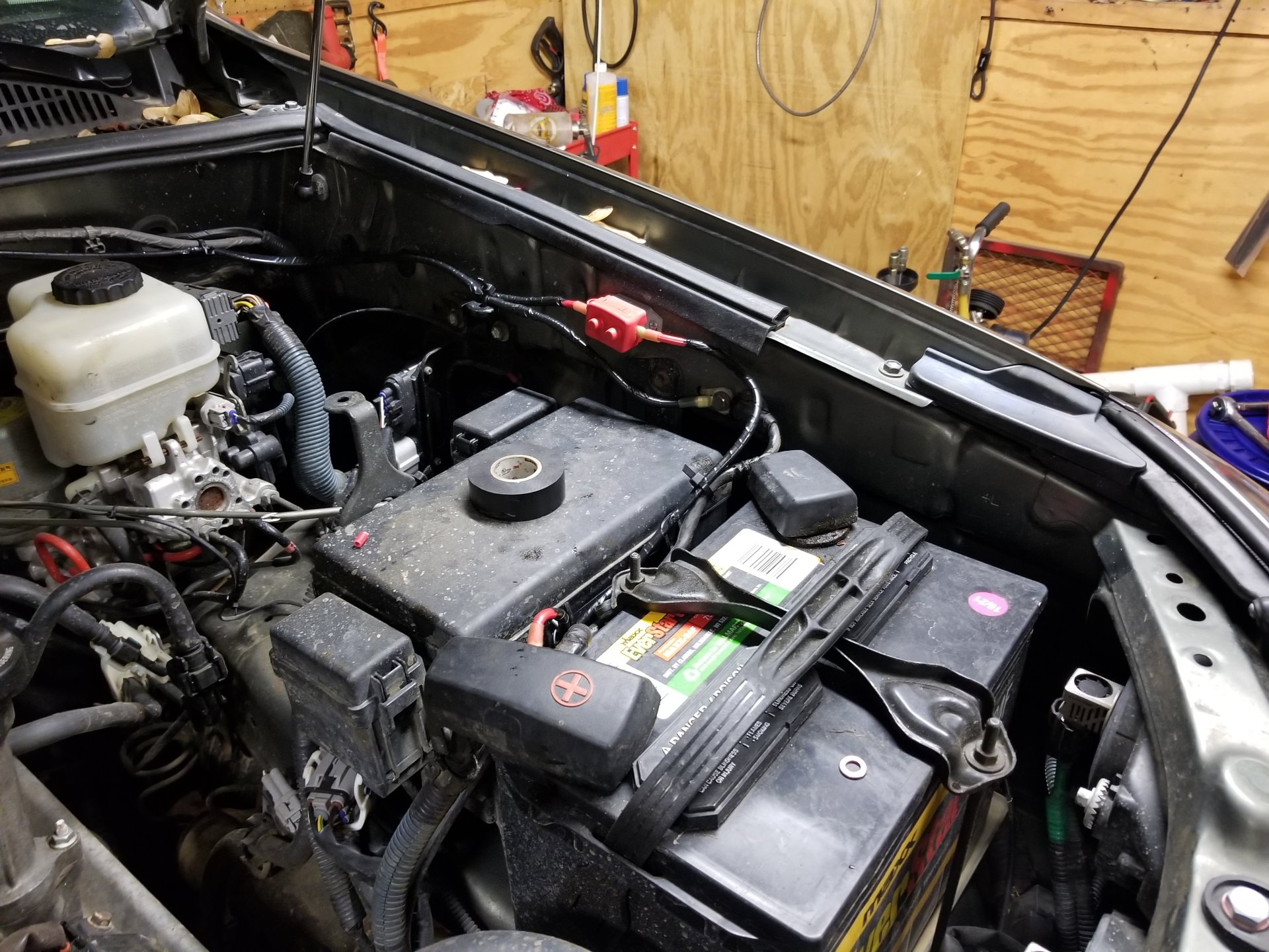

If you do want to wire it to the battery, it's not particular difficult and is probably safer that using the provided cables, as you get a better connection and have less of a chance of shorting something out when hooking/unhooking. I added the 40-amp circuit breaker on the positive side, a few inches past the battery, just to keep my GX from burning down if there is an electrical issue between the battery and compressor.

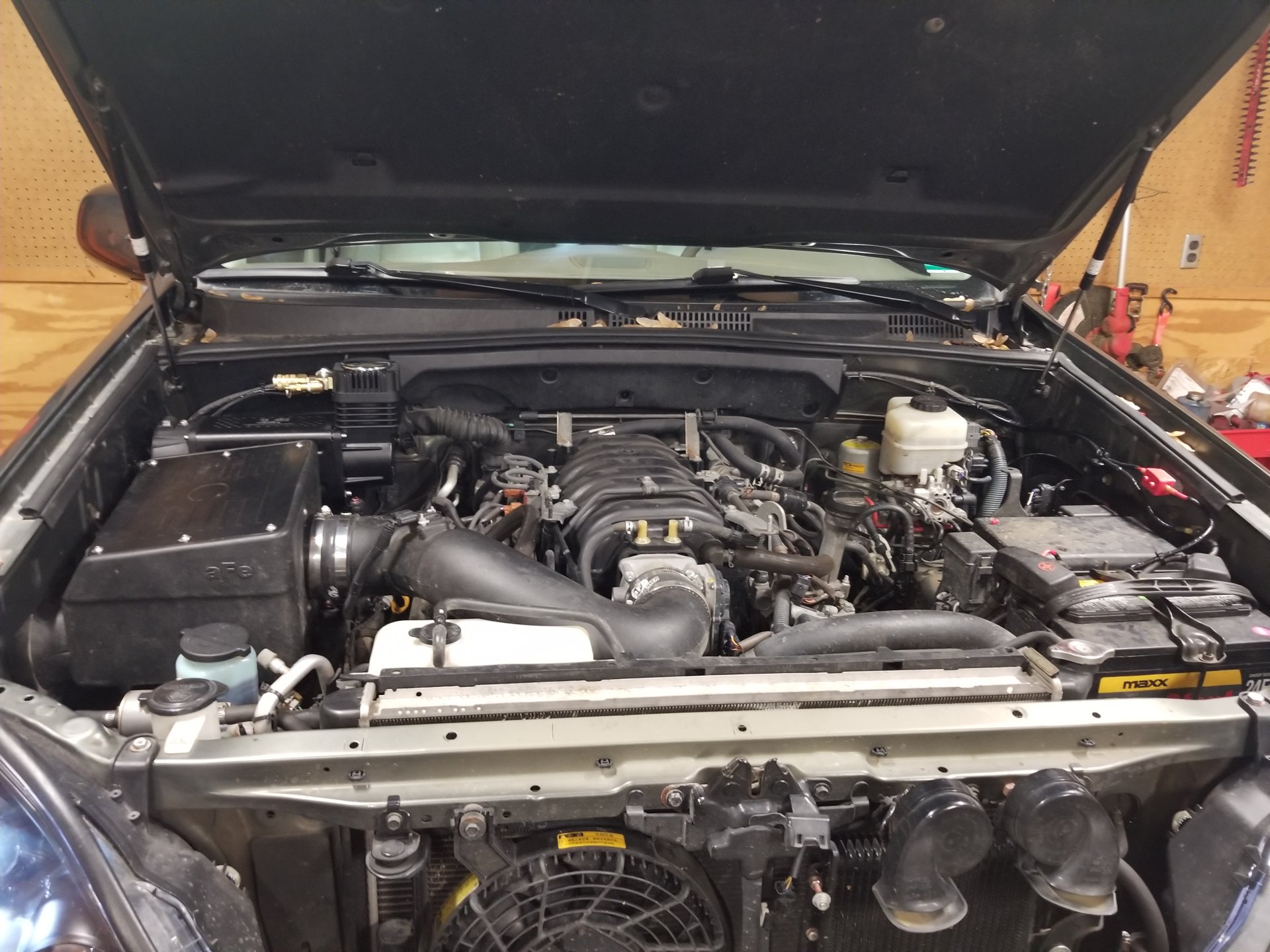

Photos of my tweaks (final maybe?) to the air setup are listed below. Due to the QD chuck getting super hot (probably 150F+), I switched the setup to a 1/4" NPT pipe nipple and a MUSA Goodyear air hose (rated to 190F). I then ran the hose to the PS inner fender and made a simple bracket to accept a 1/4" NPT bulkhead fitting and relocated the QD fitting to there. The bracket is attached with M6 bolts to two rivnuts I installed in the PS inner fender. The QD should stay cooler and keep from cooking any more nylon flex hoses.
