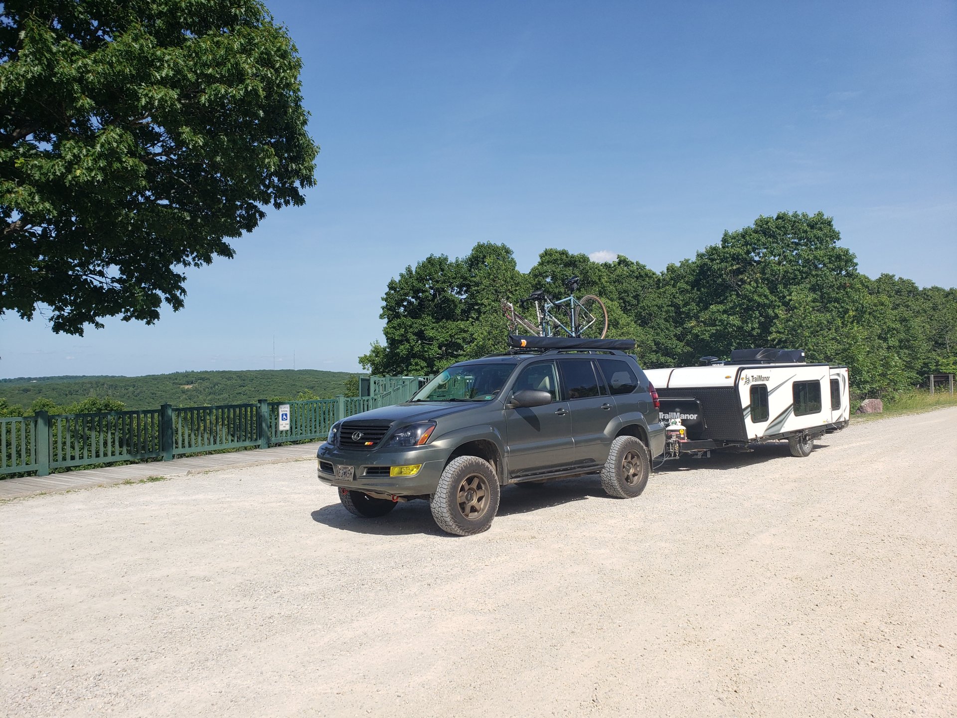

We took a Father's Day weekend camping trip, so I was able to test out the Nomad valve body a bit more. The highest point in MO was along the way, so I pulled our camper up to the top (around 900 ft of total climbing in 5-6 miles, but a few really steep sections). The trans temps made it right up to 200F, but never above. Considering it was 95F out (at the bottom anyway, cooler on top), with the AC on and our family of 4 in the GX, I was pretty happy. I still need to install the lockup switch, and I think this would have helped even more as much of the pull was in 2nd and 3rd gear. The valve body is a pretty good towing upgrade otherwise - the firmer shifts are nice and it holds gears longer than before (zero gear hunting too). The trans temp was 170-180F on the rolling hills, outside of the sustained climbs - lower than temps were stock (no VB and upgraded cooler) with no trailer hooked up.

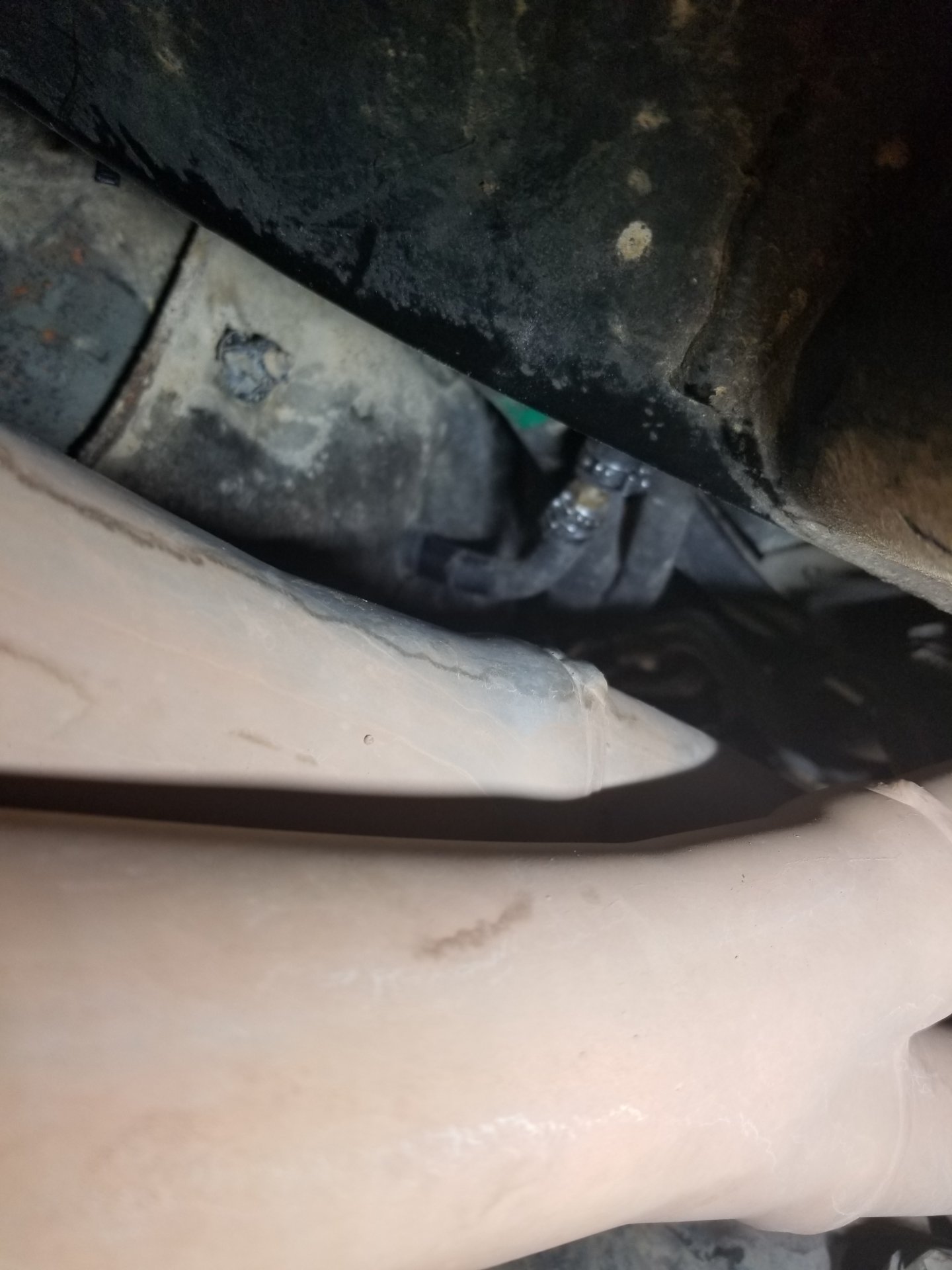

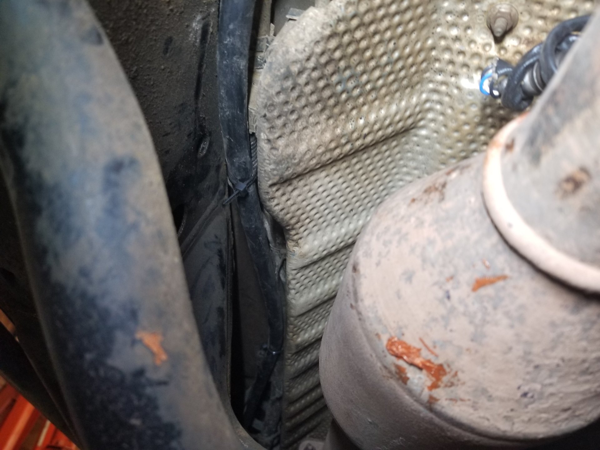

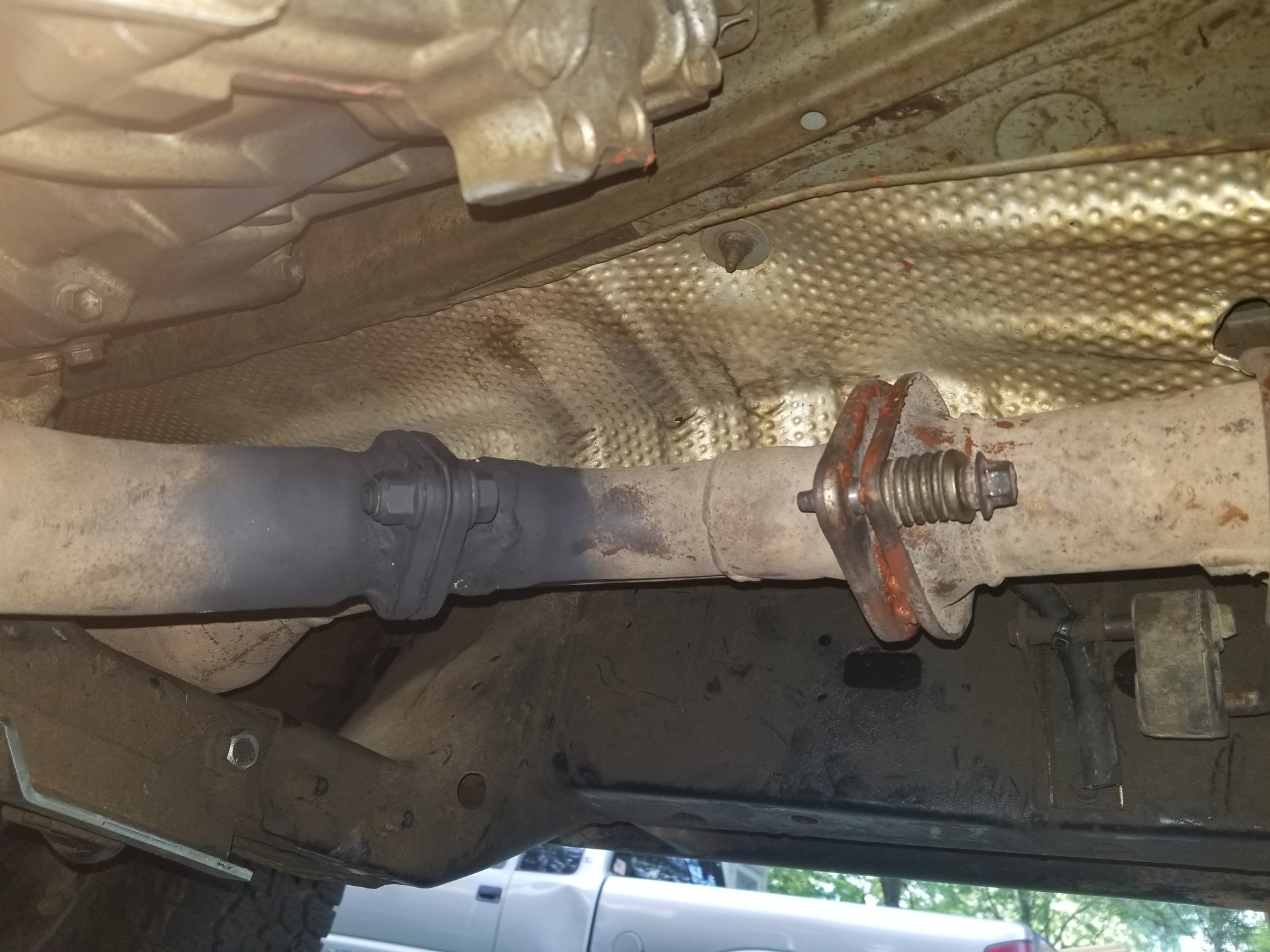

Several hours this weekend were spent fixing exhaust leaks. I had a bad one at the flange in the Y pipe, one at each header collector, and one at the Y pipe to catback. The Y pipe flange was rust-welded together so I cut out the old one and welded in some new pieces. A Subaru EJ25 midpipe gasket was a perfect fit for the new flange. Then I slathered the Y pipe to catback gasket in copper RTV and added washers to the spring bolts to get a good seal. After replacing the collector gaskets and using more copper RTV there are no more leaks!

I'm curious what method did you use to diagnose your exhaust leak? Excess noise, cracked pipe & Soapy water?
Several hours this weekend were spent fixing exhaust leaks. I had a bad one at the flange in the Y pipe, one at each header collector, and one at the Y pipe to catback. The Y pipe flange was rust-welded together so I cut out the old one and welded in some new pieces. A Subaru EJ25 midpipe gasket was a perfect fit for the new flange. Then I slathered the Y pipe to catback gasket in copper RTV and added washers to the spring bolts to get a good seal. After replacing the collector gaskers and usimg more copper RTV there are no more leaks!
Next up was extending the AC drip line. Thus was a 10 minute job I should have done years ago. I used ear clamps, a barb hose connector, and some leftover power steering hose to route it back past the transfer case crossmember.
Exhaust leaks suck.
Soapy wooder works like a charm.
Excess noise led me to realize I had a leak. A shop vac discharge hose taped into the tailpipe and a spray bottle of soapy water found them right away. Definitely a great trick I had seen on YouTube.
I was worried it was at the header/manifold gaskets but the soapy water verified zero leaks at both sides.

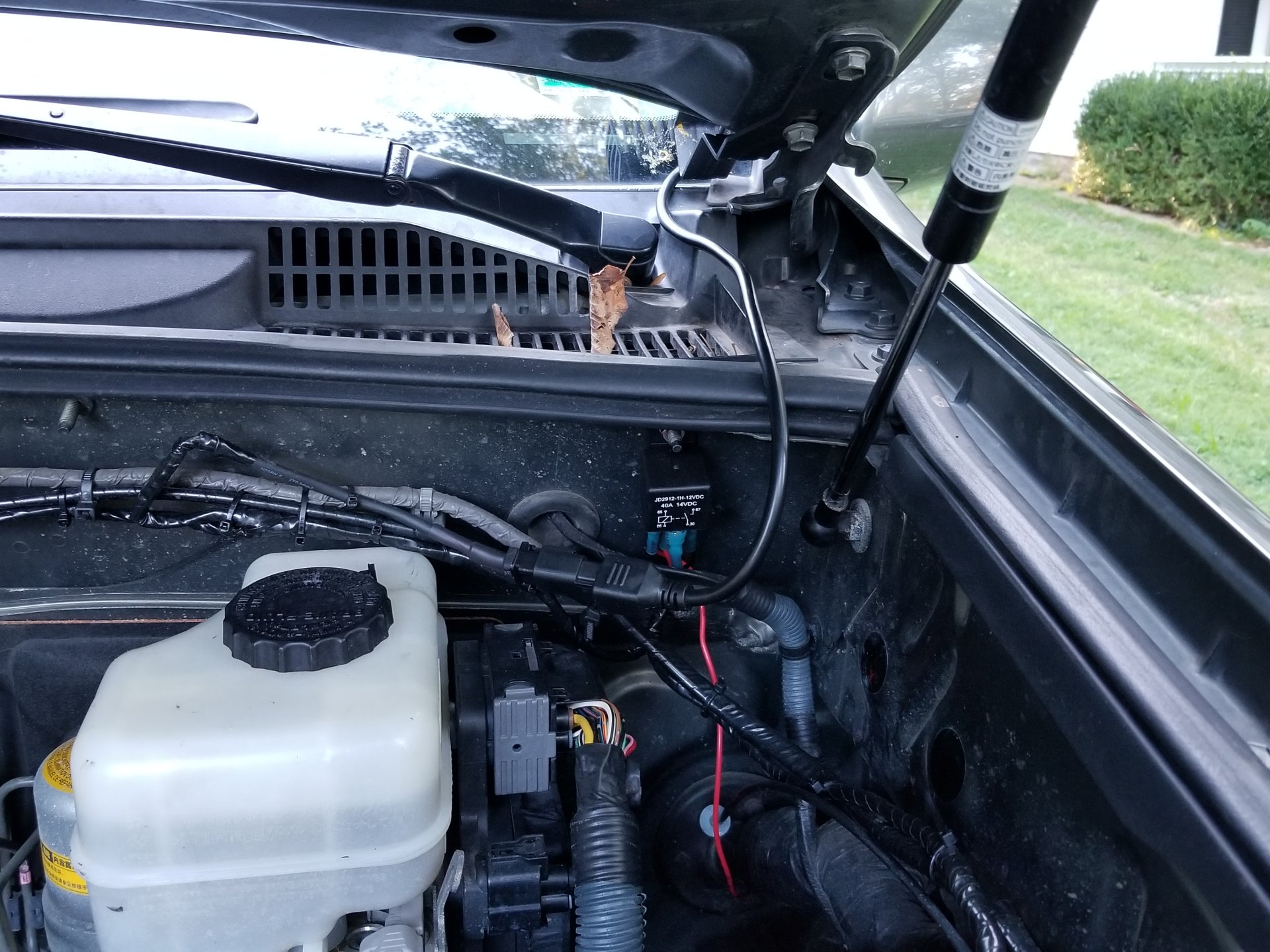

I built the wiring harness from scratch, including running the lights off of a circuit tap in the engine bay (off of the seat heater fuse), adding a 40A relay, using 16-ga wire everywhere with lots of heat-shrink connectors, and wrapping the harness in 3M electrical tape. On the inside the lights are activated by a CH4X4 switch in place of the OEM aux jack. Power for the switch comes from a circuit tap added to the rear wiper fuse, and the wire running to the relay is routed through the OEM wiring harness grommet near the steering column.

Installation of ditch lights was completed this evening. I used a $11 set of Amazon brackets for a 05-15 Tacoma and a set of Cali Raised side projecting pods. I had initially used a set of Harbor Freight Roadshock floods, but they whistled like crazy above 45 mph, so they were returned and the Cali Raised lights went on and don't whistle. Overall, I went with cheap lights due to how easy it is for ditch lights to get stolen.
