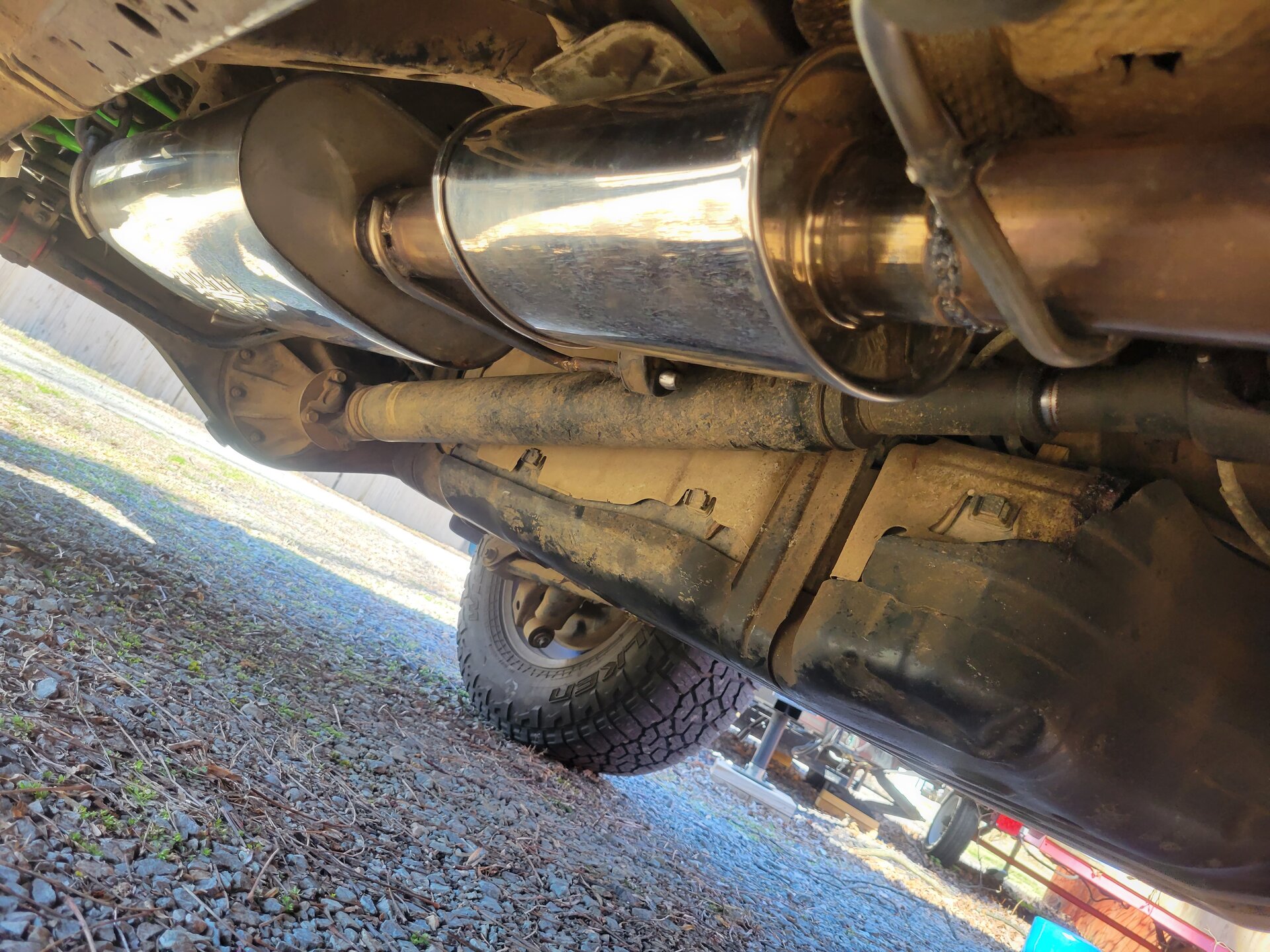

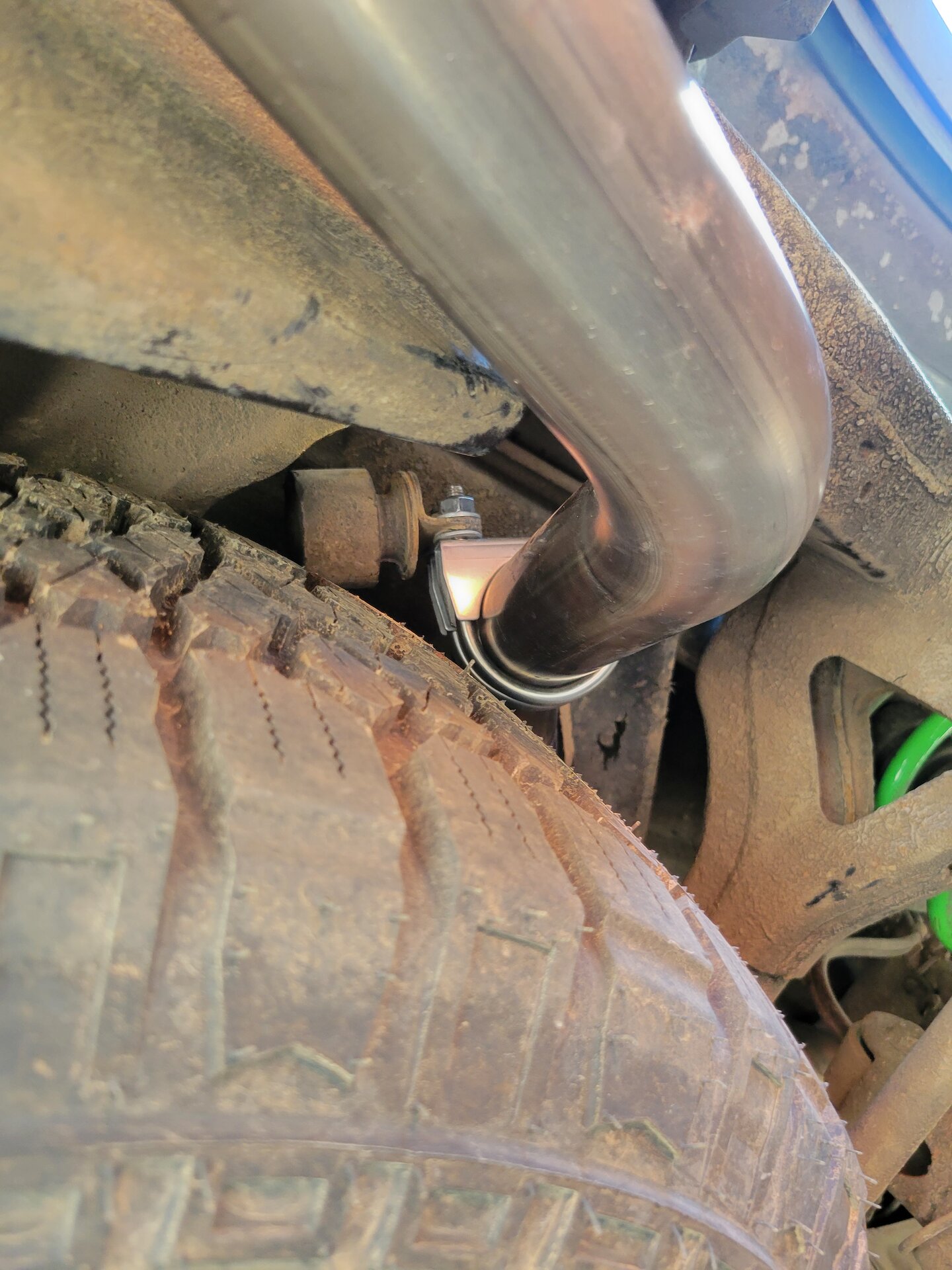

Built a Helmholtz resonator today and installed it just before the end of the tailpipe. Used 304 SS components including a 1.5" 90 (4.75" long) and a 4" straight pipe turned into a sealed can (4-7/8" long). Added a clamp so the can portion can come off. The drone is gone. It's almost stock quiet at cruise, at around 58-59 db at 70 mph. Lesson learned, the drone on one of these comes from the tailpipe behind the muffler, not in front of it (which is probably why Mr. T put the OEM resonator here).
I also extended the Borla tip a couple of inches and finished the edge of the cut into the OEM bumper cover.
Realizing the tip has a decent chance of getting destroyed off-road, I also added a slip joint to make the Borla tip removable, and cut a 2.5" turn down to length for off-road use (or when hauling stuff on a hitch carrier).
Really happy with the low-speed and highway sound. Buuuut....the exhaust now has a whistle at 3K RPM. Not sure if it's from the slip joint or a small glob of weld/wire inside the exhaust. I may play with it more later, but am pretty happy for now to have a better-performing and cruising-quiet exhaust for our upcoming spring break trip with our camper.
