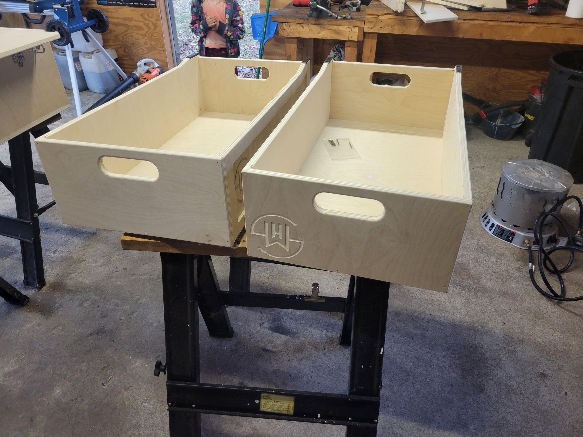

Drawers and sleeping platform are unboxed and ready to start finish work (will be at least a few weeks due to some work travel). I really like the overall design concept. The construction, materials, and details are all pretty good. Finishing, as of now, will include staining the rear vertical items (ends of the box and drawers) to match my rear door table (which is close-ish to the OEM wood stain) and then spray everything in a few coats of polyurethane. Then make a removable "mat" for the top of the drawers and the sleeping platform out of boat carpet (already purchased and similar in color to the OEM carpet). I actually really like the sandalwood/beige/maple OEM Lexus interior and want these drawers to fit in with the rest of the rig.

Nice! I ended up ordering these ones with the pre-coated black bed liner about 4 weeks ago.
Excited to see how yours turns out!

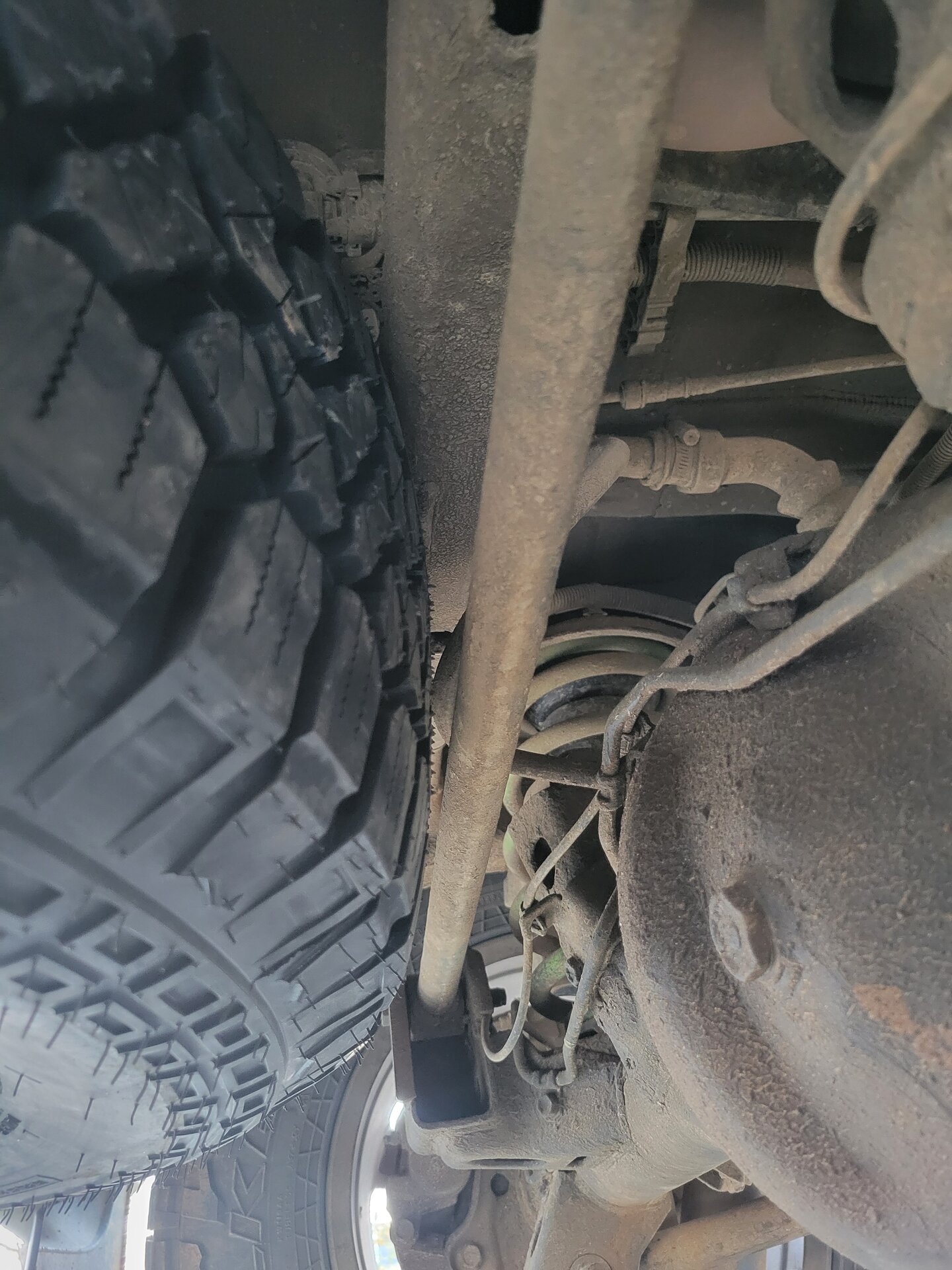

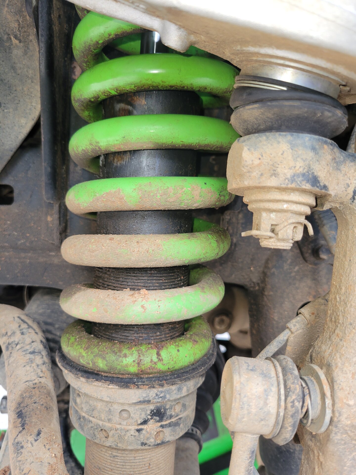

My GX, for around a year now, has had an annoying squeaking/rubbing noise when going over bumps (worse after off-roading). I finally figured it was just my polyurethane sway bar bushings or the shock shafts, and finally decided to spray them with some PB Blaster to quiet things up. Low and behold, my prebuilt Ironman front coilovers both had slightly bent coil springs (driver's side was the worst) that were contacting the shock body. I installed the coilovers as-shipped and haven't adjusted them at all. Did some reading online and others have had this problem; apparently Ironman had a bad batch of coils but replaced most front coilovers under warranty. I love the lift otherwise and sent in a warranty claim - we will see how it goes with it being honored.
Looks like they are leaking too
I doused them pretty good in PB Blaster yesterday, thinking the noise was the shock shaft going into the body, so that's the oily stuff at the bottom. They didn't have any evidence of leaking before I sprayed them. The PB made the noise go away as the shock body is now lubricated against the coil :)
Test-fit the SHW drawers today. They fit really well and have plenty of room for sleeping. The platform will only be used when camping and stored outside of the GX otherwise. I started sanding them today and hope to stain them over the weekend.

1. Ironman is sending me new front coilovers! Good to see them stand behind their product without having a big fight over a warranty replacement.

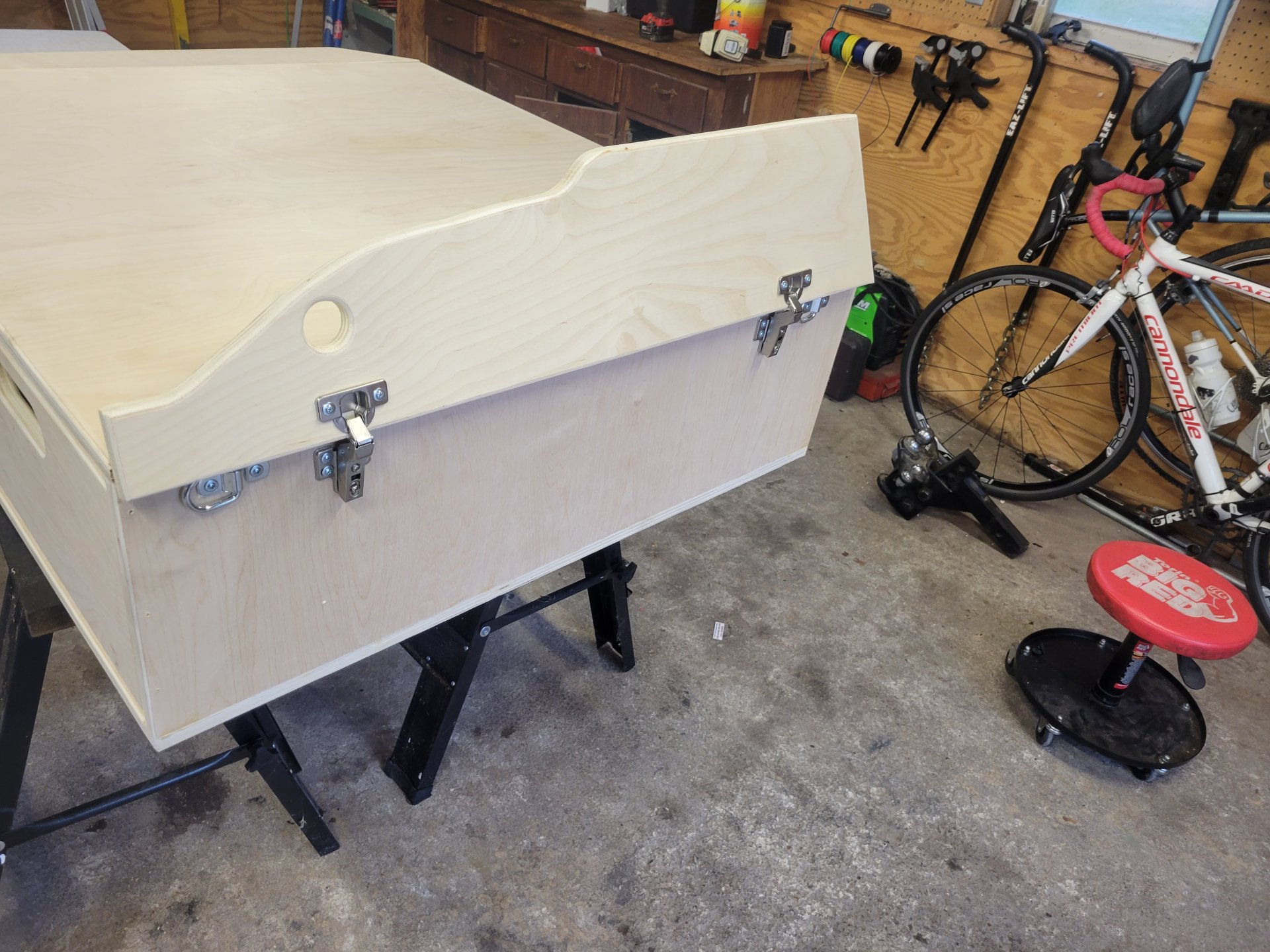

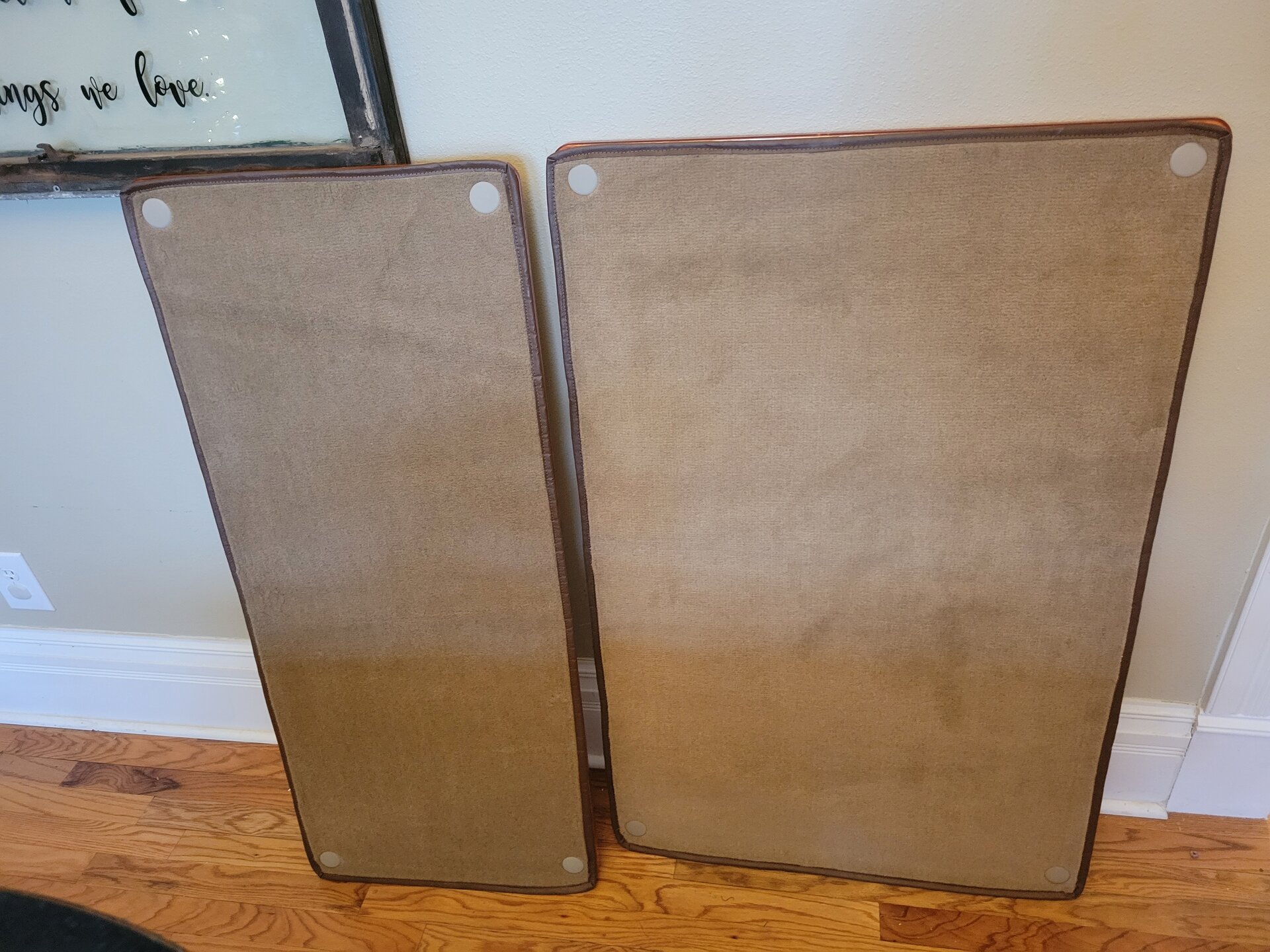

Used our balmy 30F afternoon to install the drawers. I finally completed finishing them by giving every panel 2-3 coats of polyurethane, adding 6 stainless tie-downs to the deck, and cutting some boat carpet for a top mat. I also made matching carpets for the sleeping platforms, and attached them with some plastic headliner rivets. A local upholstery shop sewed the edging on all 3 pieces of carpet for $65.
These resulted in much more usable space then before. I was able to fit nearly all of my seldom-used emergency gear (recovery straps, axe, shovel, saw, jumper cables, rock hammer, etc) along the sides of the drawers. My other more-used emergency gear (tool kit, tire repair kit) and air up/down equipment took up less than 1/2 of a drawer, giving me at least 1.5 drawers to fill with trip-specific gear.
I still need to finish the attachment between the drawers and sleeping platform and make some kind of an organization system for inside the drawers themselves. I may also get a universal cut-to-fit rubber mat to protect the carpet when hauling firewood and other dirty stuff.

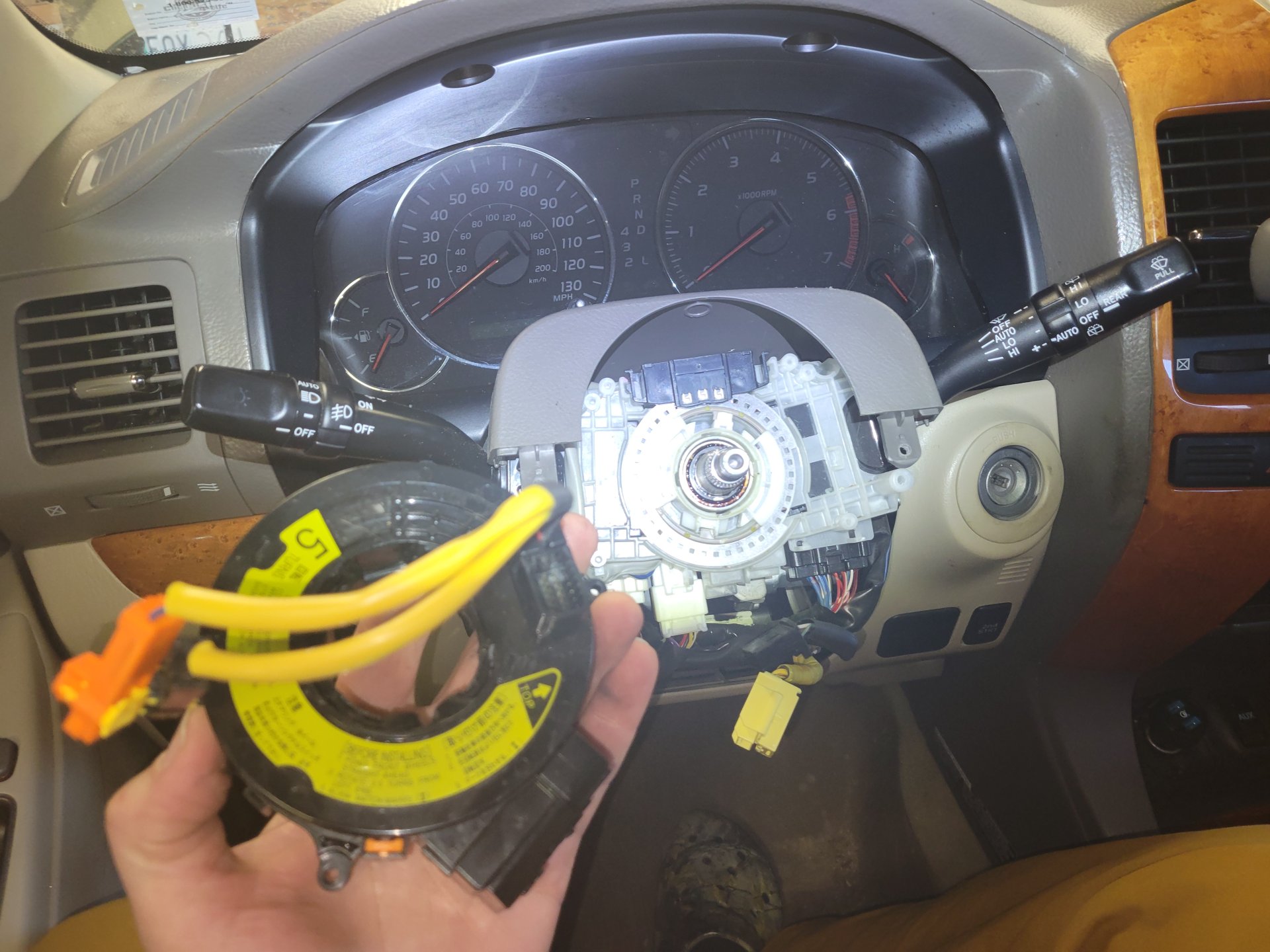

Next off was swapping out the clock spring from destroying one last weekend. I purchased a used OEM spring for $30 on eBay. The install was really easy, it's probably a ~20 minute job once you figure a few things out. Now my airbag light is off and my steering wheel buttons work again!
