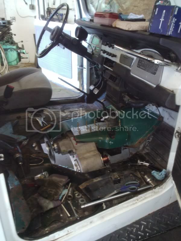

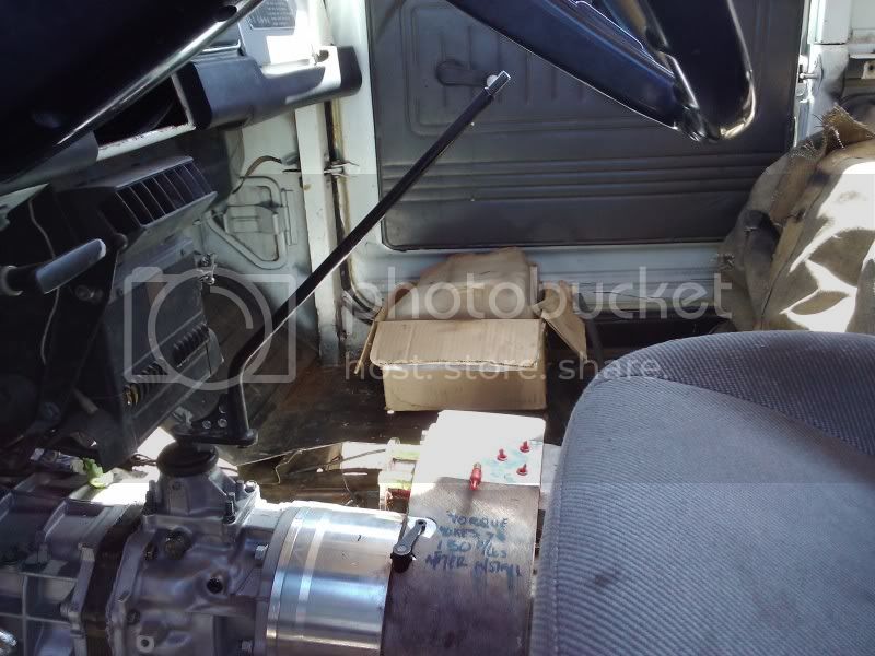

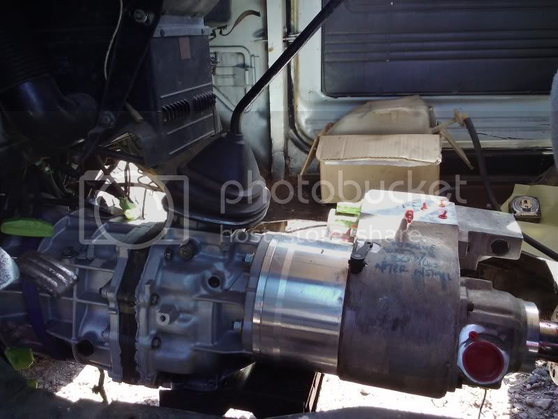

Here is a pic of the shifter installed, factory boot may even work once the hole on the dog house has been massaged...

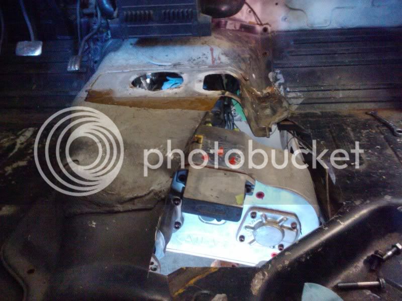

The seat was taken out to remove the gas tank, its sitting in the back of the truck. I have also removed quite a bit of the floor on the passenger side of the dog house. This sat. I am going to cut the dog house up where it doesn't fit.
Seat
I really love your setup. It was just look a little like your future passenger shoudnt have a left leg.;)

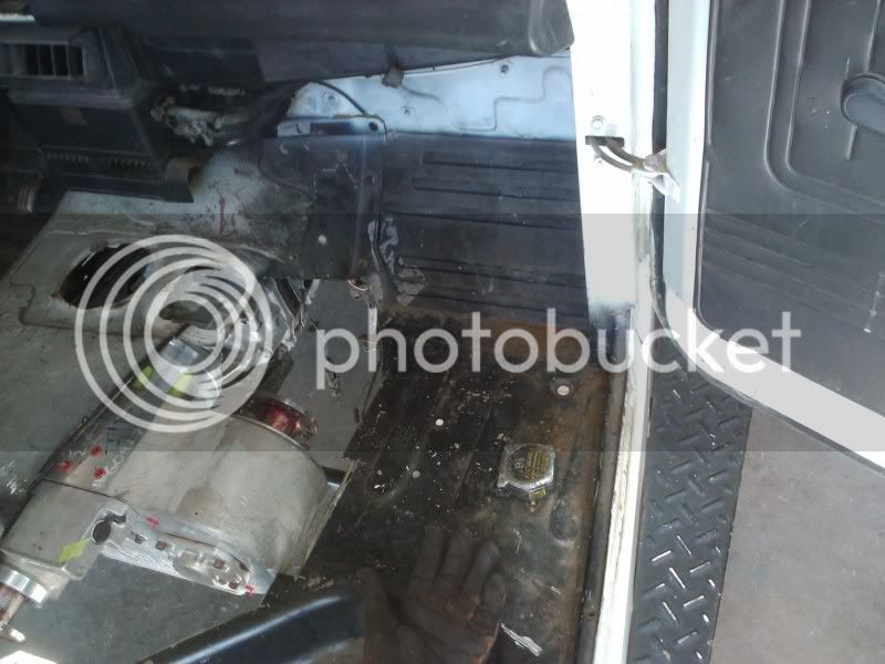

You are correct the passenger will have a little less room than normal because the t-case is clocked flat ( I debated this at great length but in the end decided I wanted a flat belly with some room to spare; 2 piece drive shaft so that the rear could be clocked down and for link placement ). Factory the passenger has more floor space than the driver, now the passenger will have just a bit less than the driver ( the 40's factory drivetrain is offset to the drivers side by about 2"s; now the drivetrain is centered).

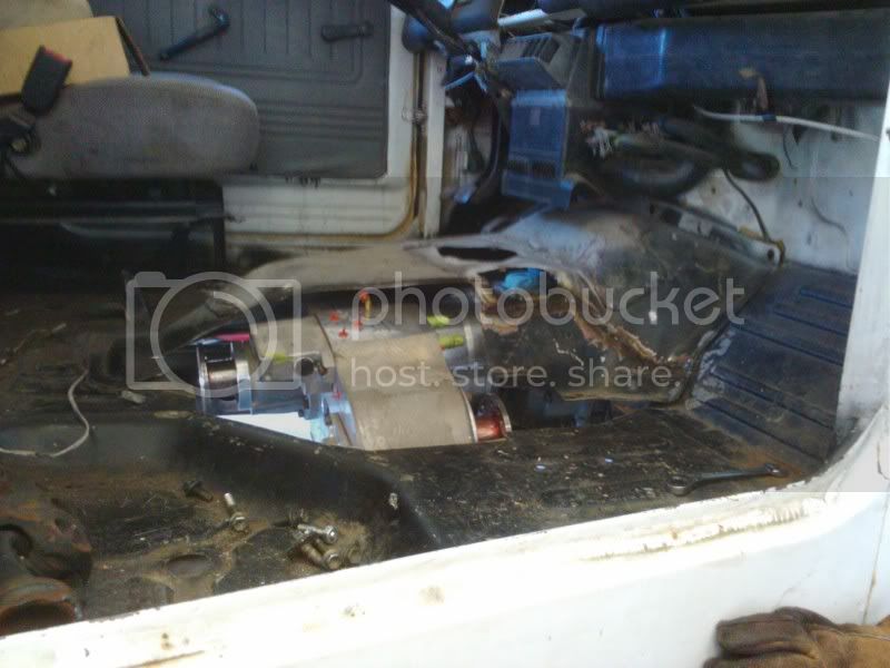

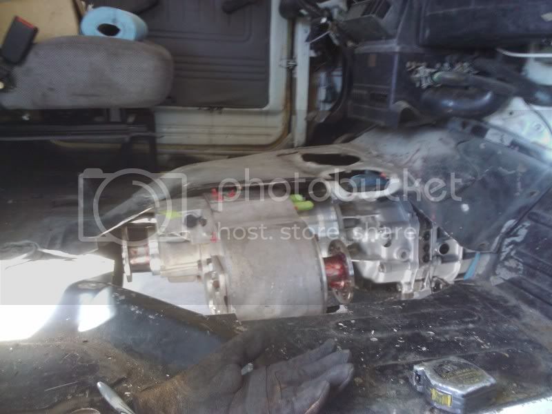

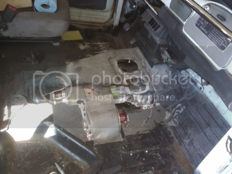

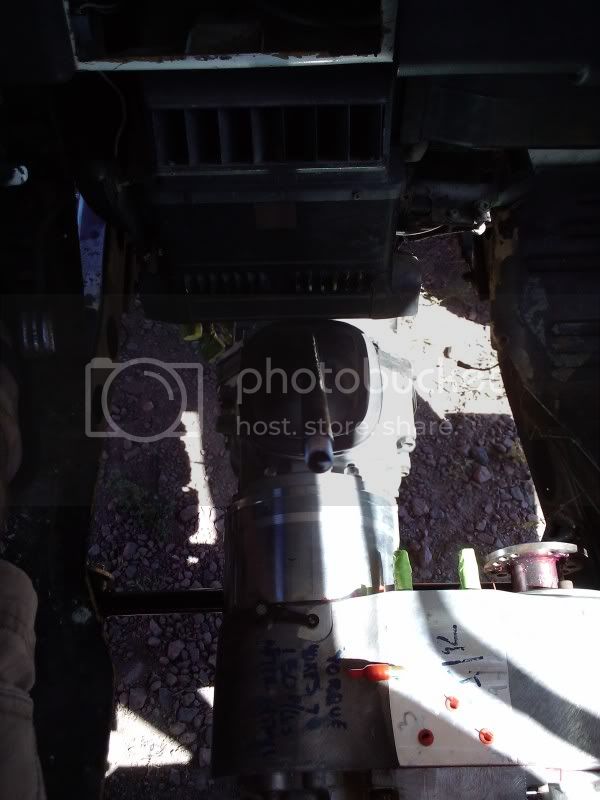

Most of last Saturday felt like a waist however a major change was made, started out the day by marking up the dog house and trimming it down to fit the t-case clocked flat. Then I started thinking about the angle the front two piece shaft as it was looking kind of steep.

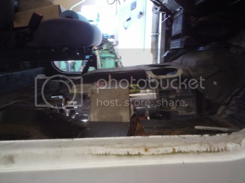

So I clocked the t-case all the way down, the only negative is that its quite a bit closer to the frame rail ( about 3/4" till it will touch). I am now going to build an additional control arm that will go from the trans mount, catch the drain bolts in the t-case, then catch a rubber bushing. (I'll draw something up in paint to display it.)
First pictures are of the t-case in the flat position.
Next pictures are of the t-case clocked all the way down.
It doesn't look like much however it dropped the front output by over 2"s, and the bottom of the t-case is still barely above the bottom of the frame rail.

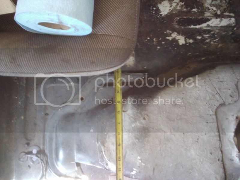

Also noticed just how far the seat is off, I was planning to change it anyways. The seat will be shifted 5.5" to the center its way off... Previous owner special!
Also noticed just how different the early and late dog house's are, early dog houses are considerably narrower. I may switch to an early style because I have to modify all of it anyways. I set and early one it there just to see how it looks and I like it more... However we will see...
That sucker hanging below the frame now?
you "need" a 2 piece shaft, or do you "want" it? should be a straight shot!
Flat Skids are worth way more than passenger comfort..
(if you dont belive that, now is a good time to head on back to the 40 section!)
Nope the t-case is still above the bottom of the frame rail, I still intend to have a flat belly.
I "want" a 2 piece shaft although the angle isn't that bad. I am all about function over form, just trying to build the best I can...

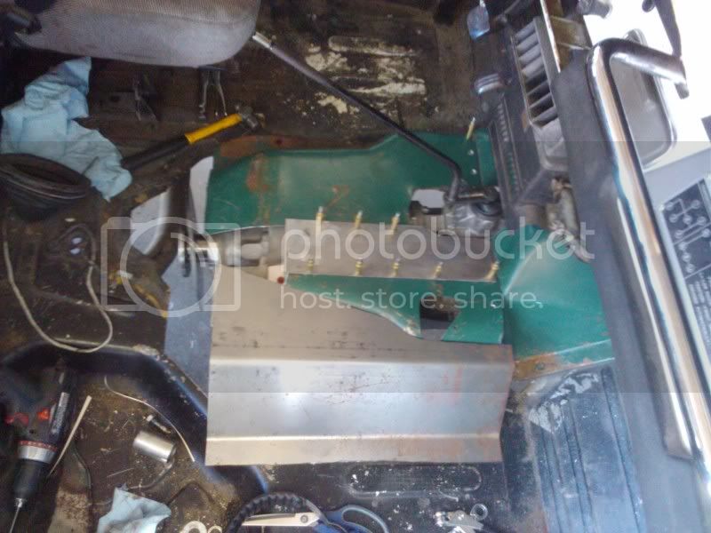

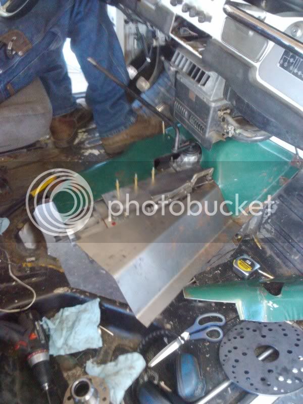

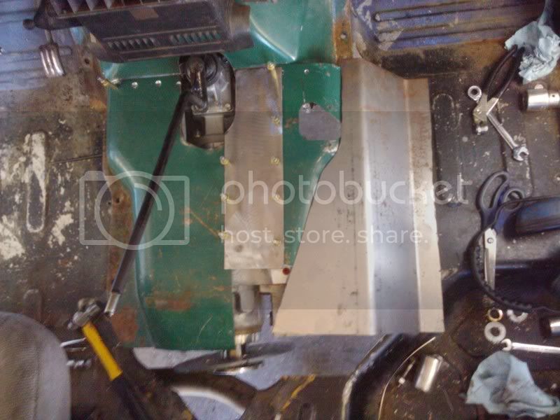

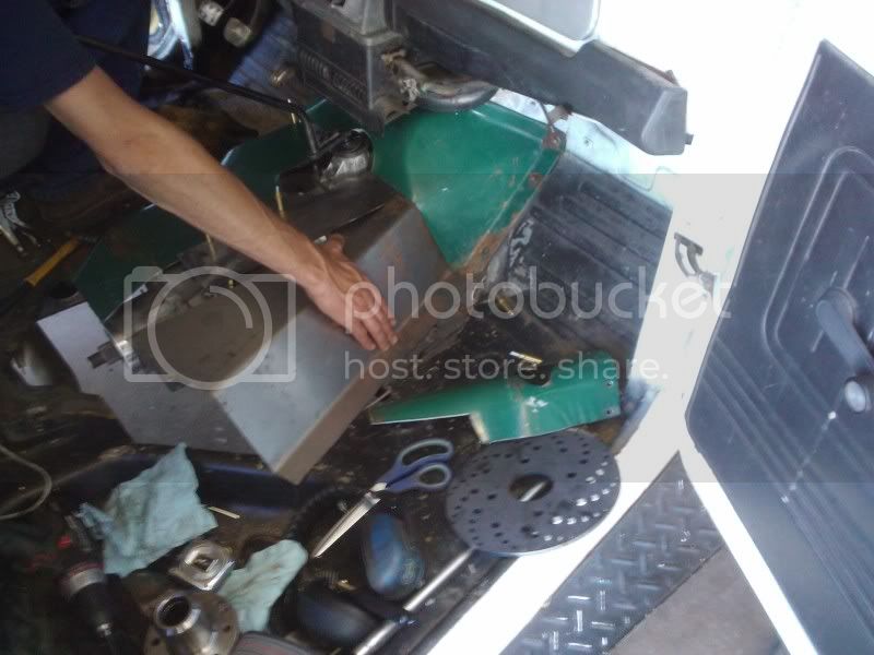

Again had a very long weekend playing with the dog house... After two days of heading in one direction, accidentally figured out how I will complete the dog house.
I'll show a few pictures of the process, we had been working towards, found the direction we were working in was starting to get very complicated. When we where putting the tools up I dropped a piece we had made and it fell into a sweet position. I called Justin over to look after discussing it for about an hour we decided that was the direction we will press towards. So now i am at square one again, but I feel like I have direction once again...
Started with an early style dog house as its much smaller than the late style, I like it better...
Was working really hard to make it look kinda like a 40 dog house. The more I played with it the more I realized it was going to be hard to finish, nicely...
Also the way I was headed it ate up most of the floor. Like I said once we started cleaning up I dropped the piece we made and it fell very close to where it needed to be....
So it wont look like a 40 dog house any more but it will give me lots a room on the passenger side. I will make some pieces that are mitered together. To form all the way around the opening then cap the top piece...
