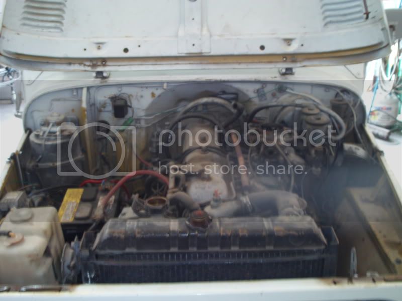

Starting with a 77 FJ-40....
Found a 2004 5vze with 20k miles, swapped in a 2002 manual wire harness & ECU.

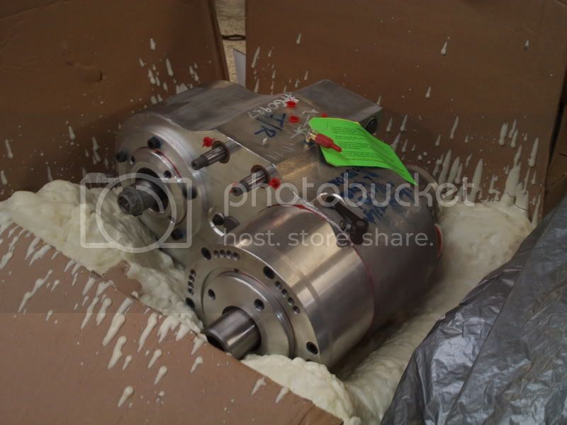

Redline built a trans that measures only 22 15/16" long.
Its a mutt trans R150 bell housing, R151 nose cone, R151 gear set, R151 center plate, AX-15 output shaft, and AX-15 tail housing. Which will bolt directly to an Atlas. (can also be made to bolt to a v8, by changing the input shaft and bellhousing)

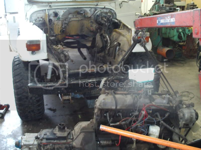

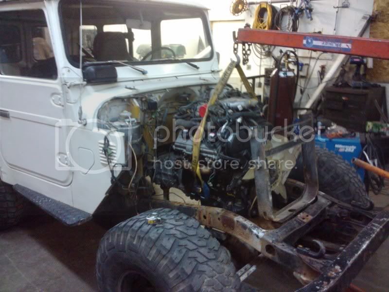

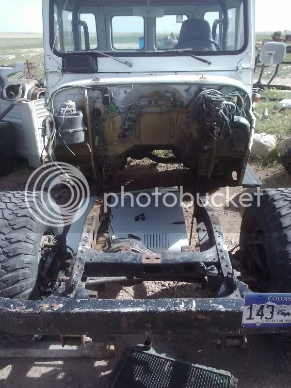

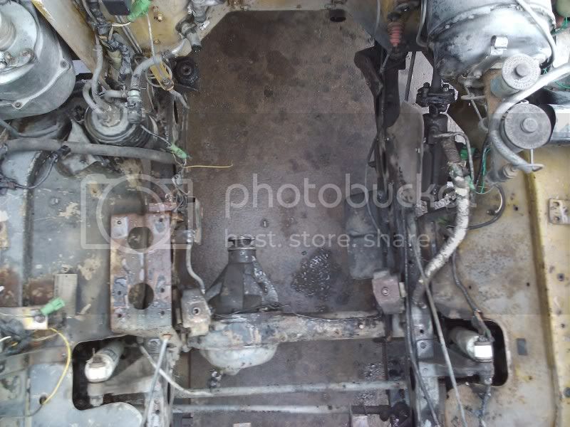

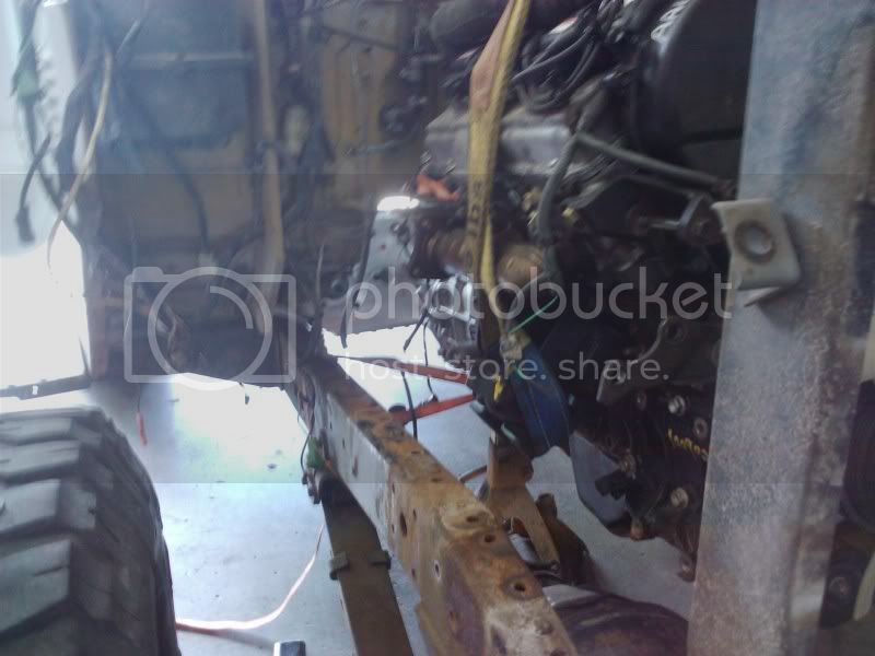

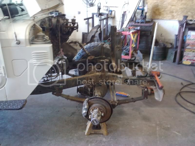

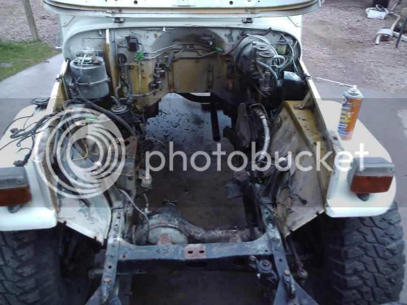

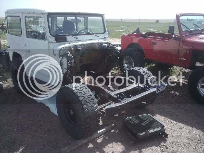

Pulling the motor, cutting rivets...

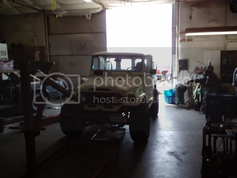

For the record it drove to the shop & into the garage under its own power. Part of me is saddened by this because I know the drivetrain going in certainly wont last 33+ years or be half as reliable...
Ahh well I'll have to build another one on down the road that stays more true to the fold...
Drivetrain is out approximately hour and half later. You can also see that this cruiser was originally Mustard! It will be that color again some day.

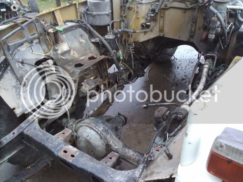

Then started removing rivets to release the motor mounts, shock mounts, & trans mounts....

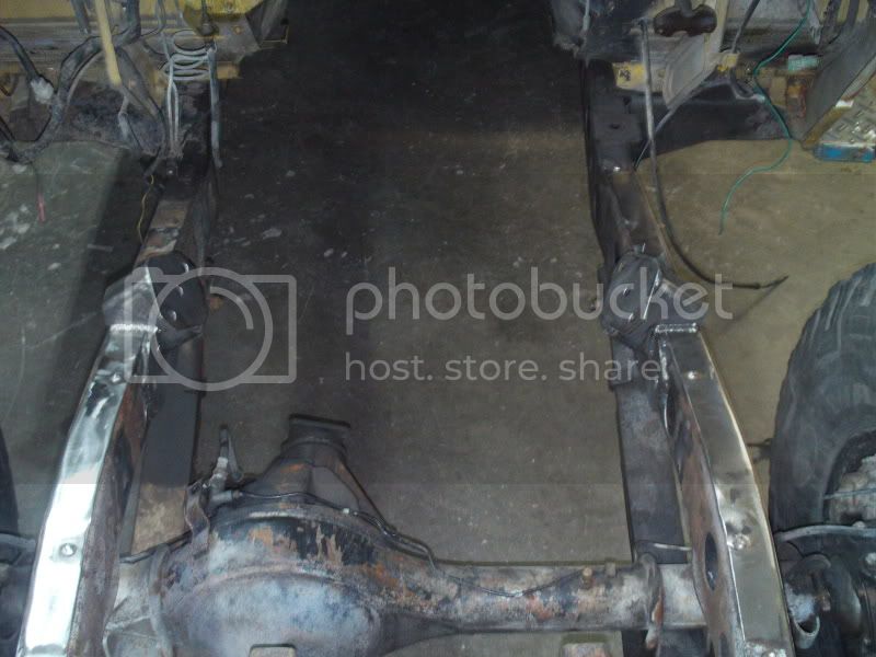

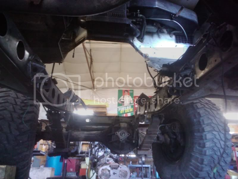

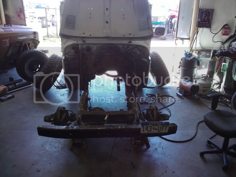

Pressure washed the frame to remove the crud, basically washed an entire tree out of the frame to include 4 pine cones and tons of branches.

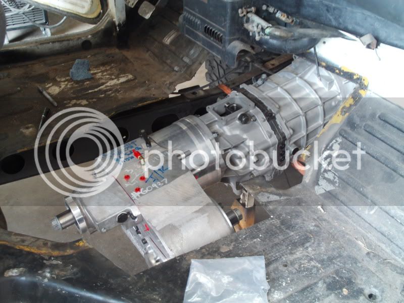

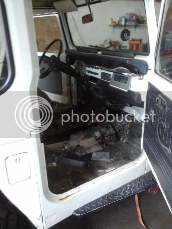

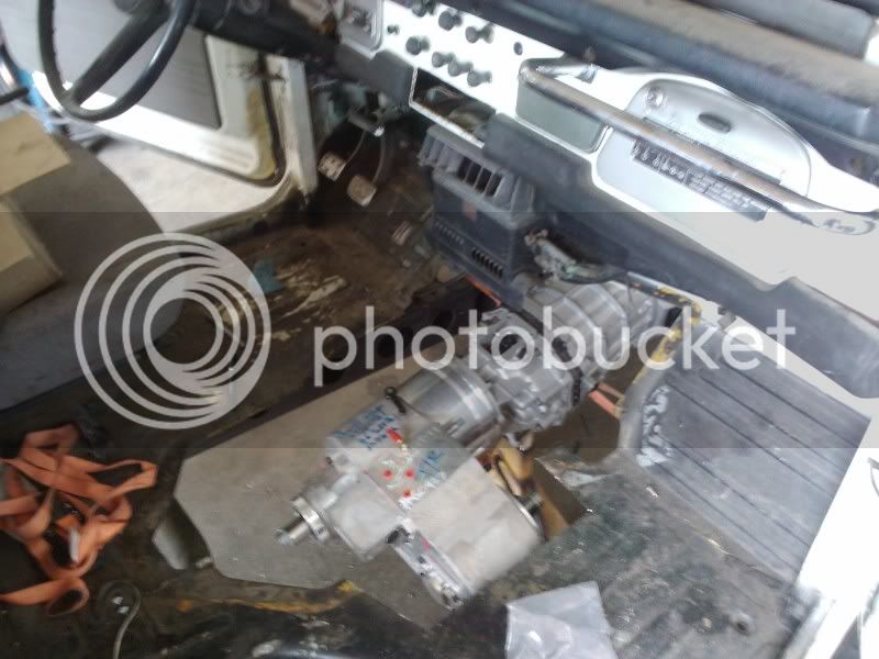

Starting drivetrain fitment...

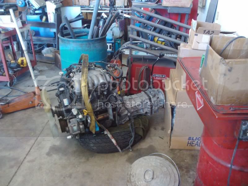

Started getting measurements for drivetrain placement, the V6 will fit very easily and will be kind of goofy looking because of how much room is behind it. We Don't have exact placement established, however we measured it for three different places... Will most likely leave it in the most forward position though.

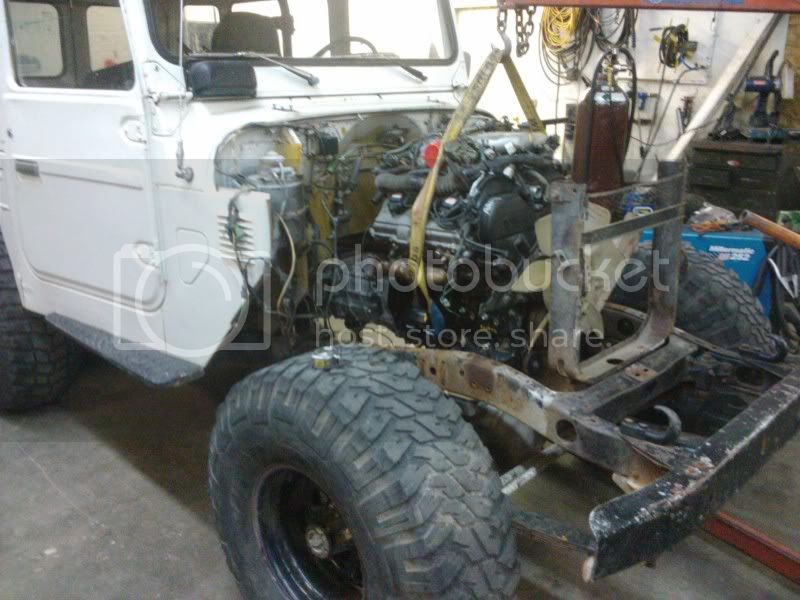

Motor with trans bolted up
Atlas barely clears the frame rail at this point.

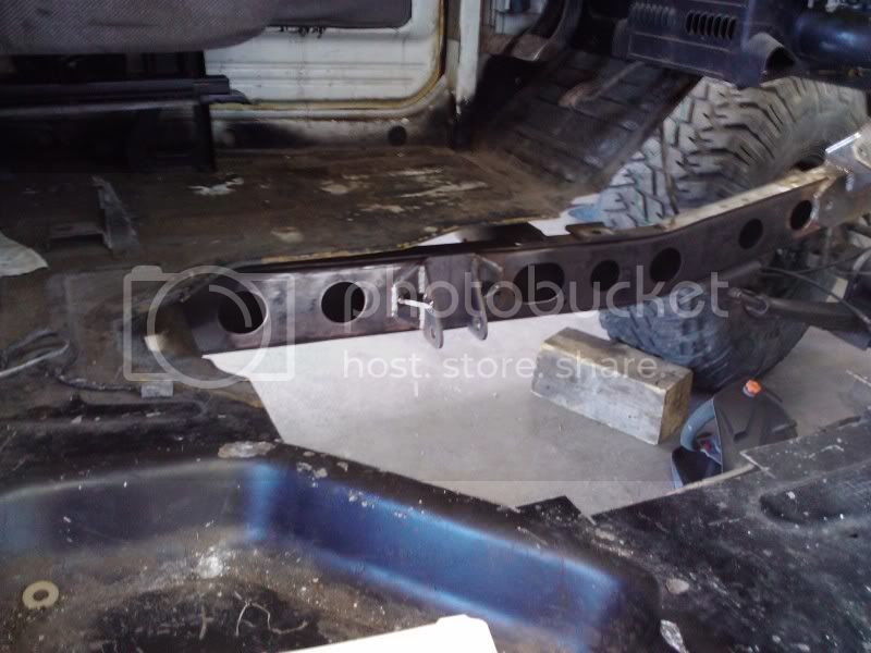

Had to remove a small section of the floor in order to clearance the Atlas and still have nothing hang below the frame rail.

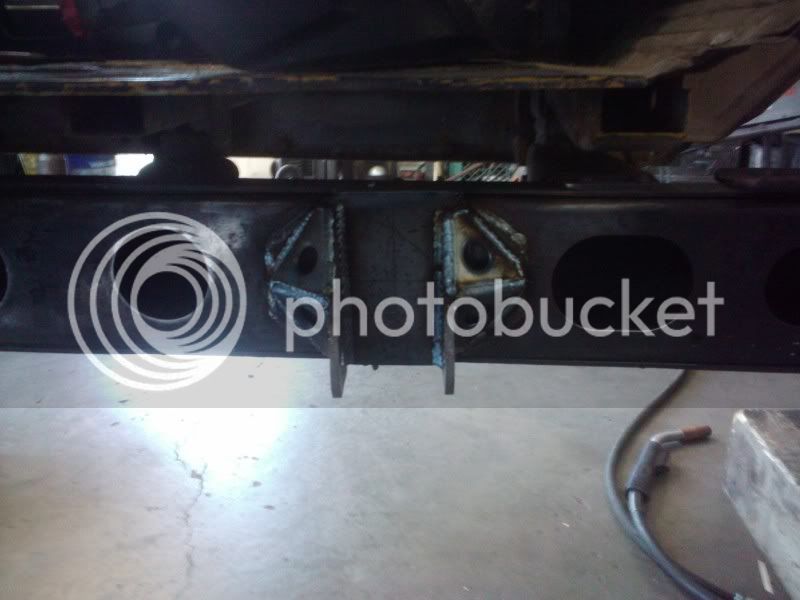

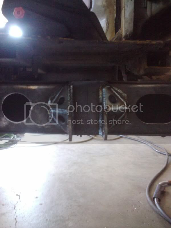

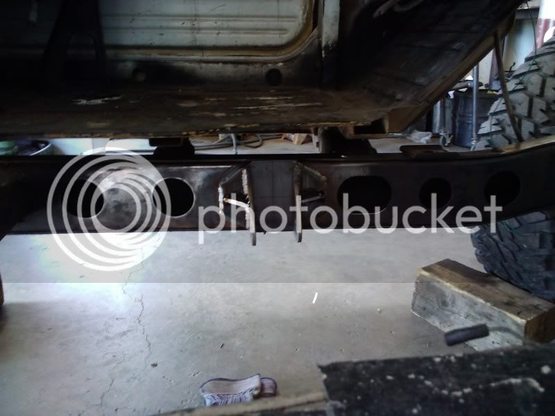

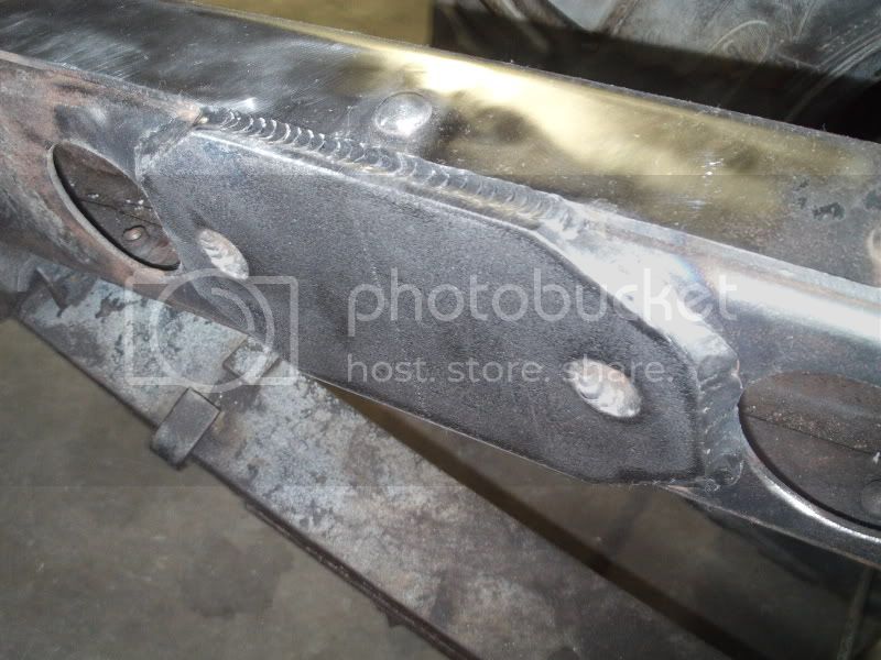

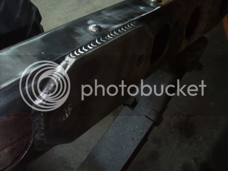

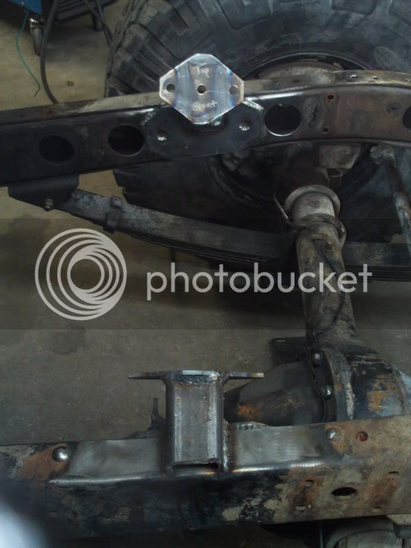

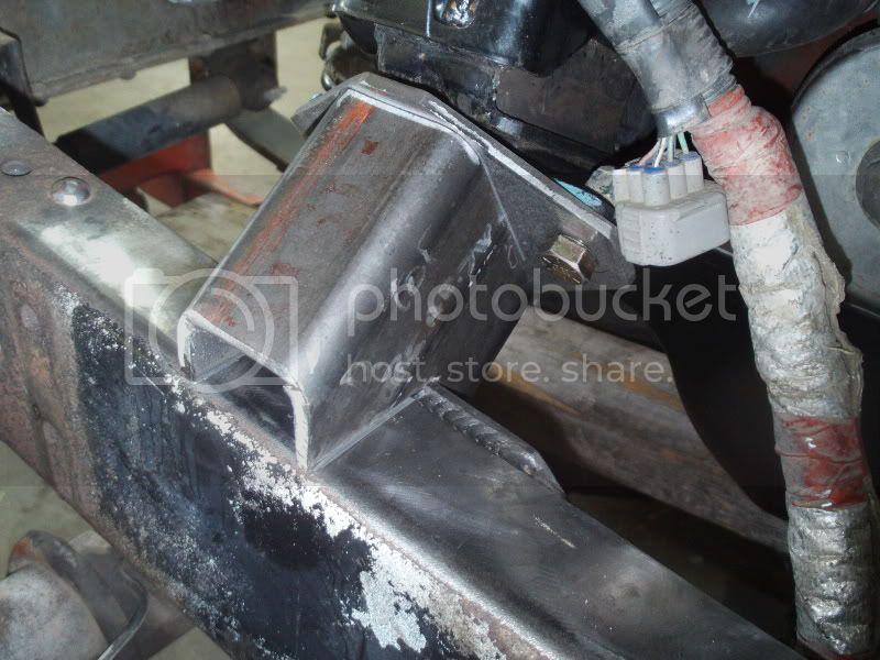

Motor mounts are almost done
Passenger scab plate
Driver scab plate
Motor mount fitment
Motor mounts all welded up
Motor mounts are about 90% still have some gusseting to complete before they will be considered finished.

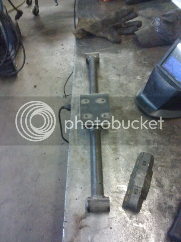

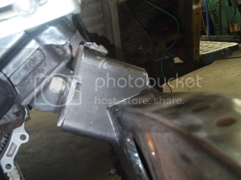

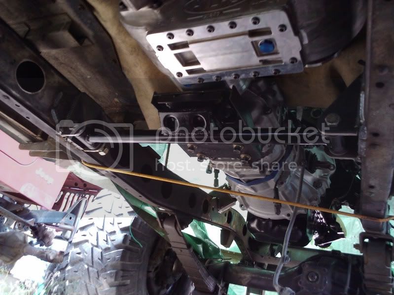

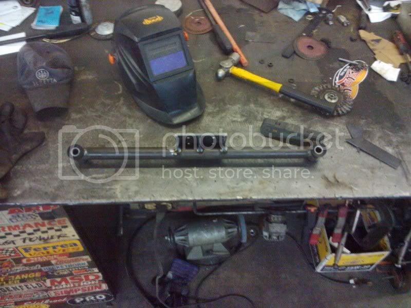

Transmission mount
Started work on the transmission mount, probably would have finished, however I nicked my chin with shrapnel-ed flap disc. Probably should have gone in & had it looked at but I wanted to get more done... ;) Lens on the phone needs to be cleaned I apologize...
Will plate the vertical gussets to help with lateral strength. Top plate is 1/4", vertical gussets are 3/16", and tube is 1-1/4 X .1875 wall.
Will finish the trans mount next weekend, the drivetrain will then be able to stay in the truck for a little bit. Which will be nice because I am tired of putting it in and then taking it out hehe...

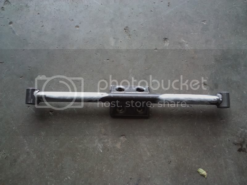

Trans mount
Cleaning the finished mount up for paint, would love the natural finish of 120 grit except for the rust it would make.

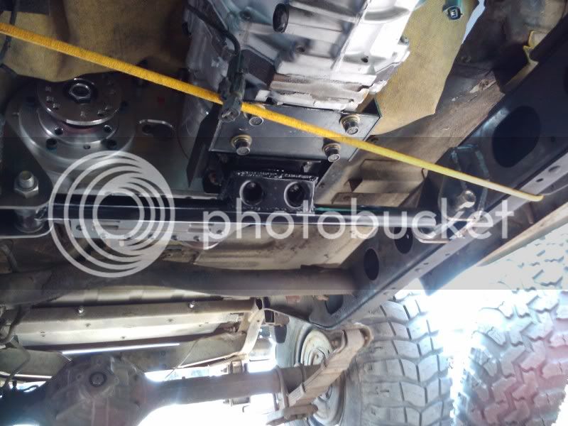

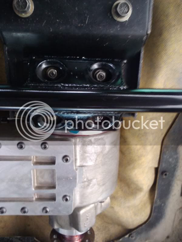

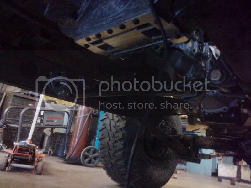

Installed picture from the back & front.
Nuts are accessible through the dimpled holes to the rubber trans mount
