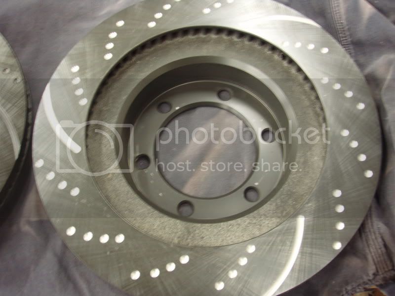

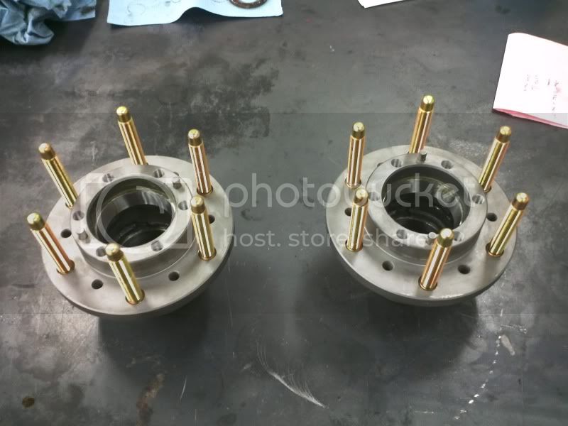

Finally finished off another set of 4 hubs and just finished pressing in the races and lug studs. Now I need to clean them one more time and start laying down some paint. I will try and get them prepped and painted by the weekend so that they can be mounted on the spindles! I test fit the hubs on some cheap Autozone rotors and they fit great, but they dont slide all the way down on the EBC rotors I have for the project. The EBC's have a little non machined area at the top of the hat. I'll fix that on the lathe... (its always something...)
Here are two of the four... Decided on some racing lug studs that are 1/2-20 so buying lug nuts should be a breeze... Will be looking for some A-corn style lug nuts...
You can see the lip in this picture, hub fits snug all the way down to that lip... I looked at several different rotors before deciding on the final OD of the hub just didnt check the rotors I had... BOOO! At least I'll be able to run any rotor I can find in the future...
What about putting a 45* chamfer on the hub lip? Er.. maybe that's what yur sayin'.
