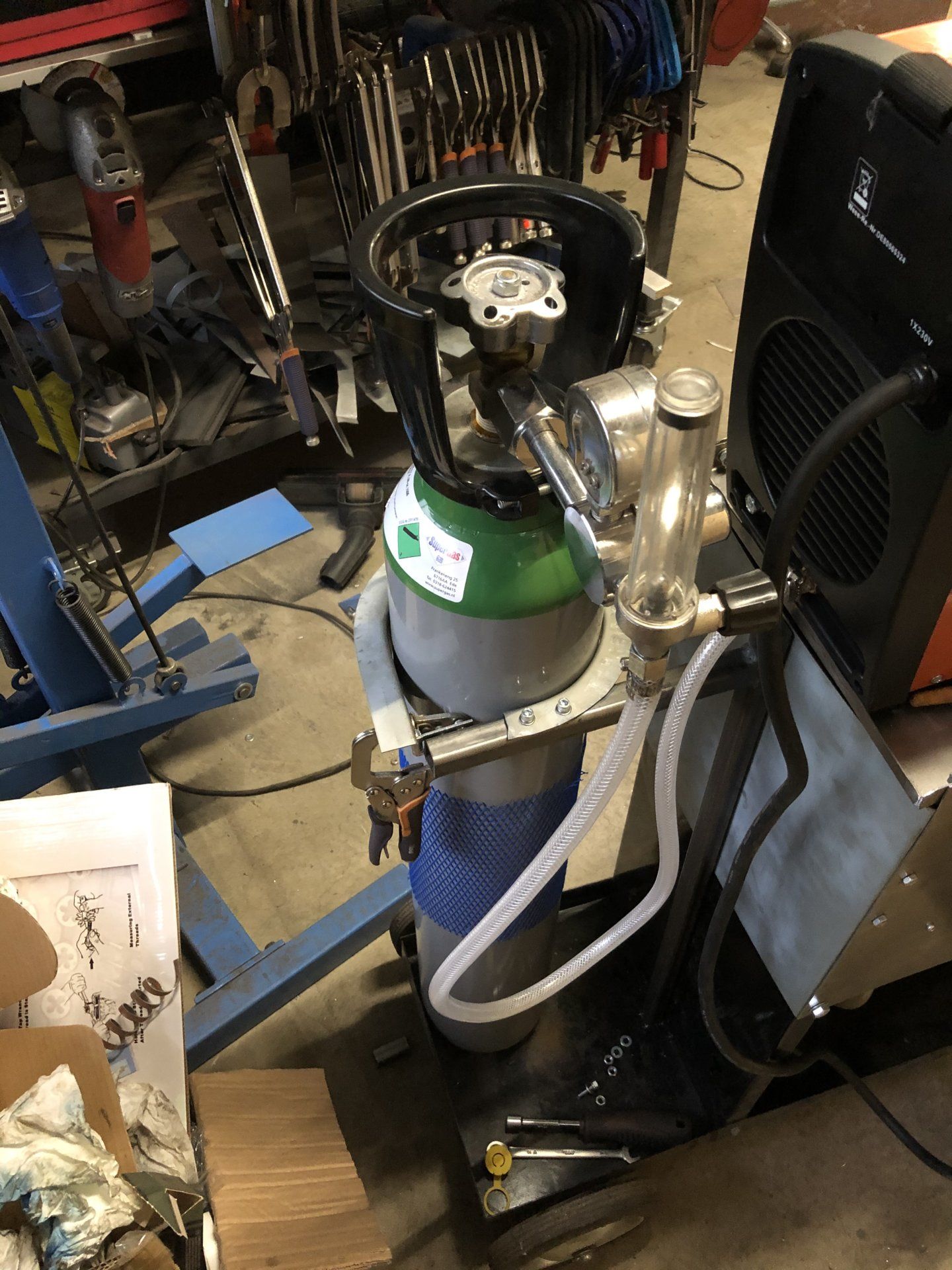

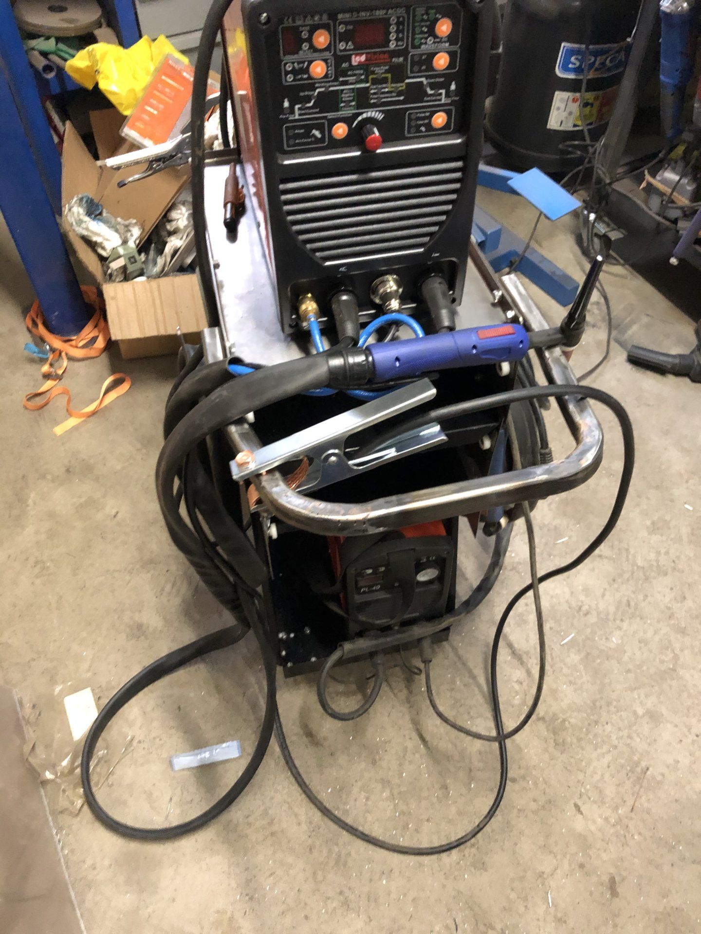

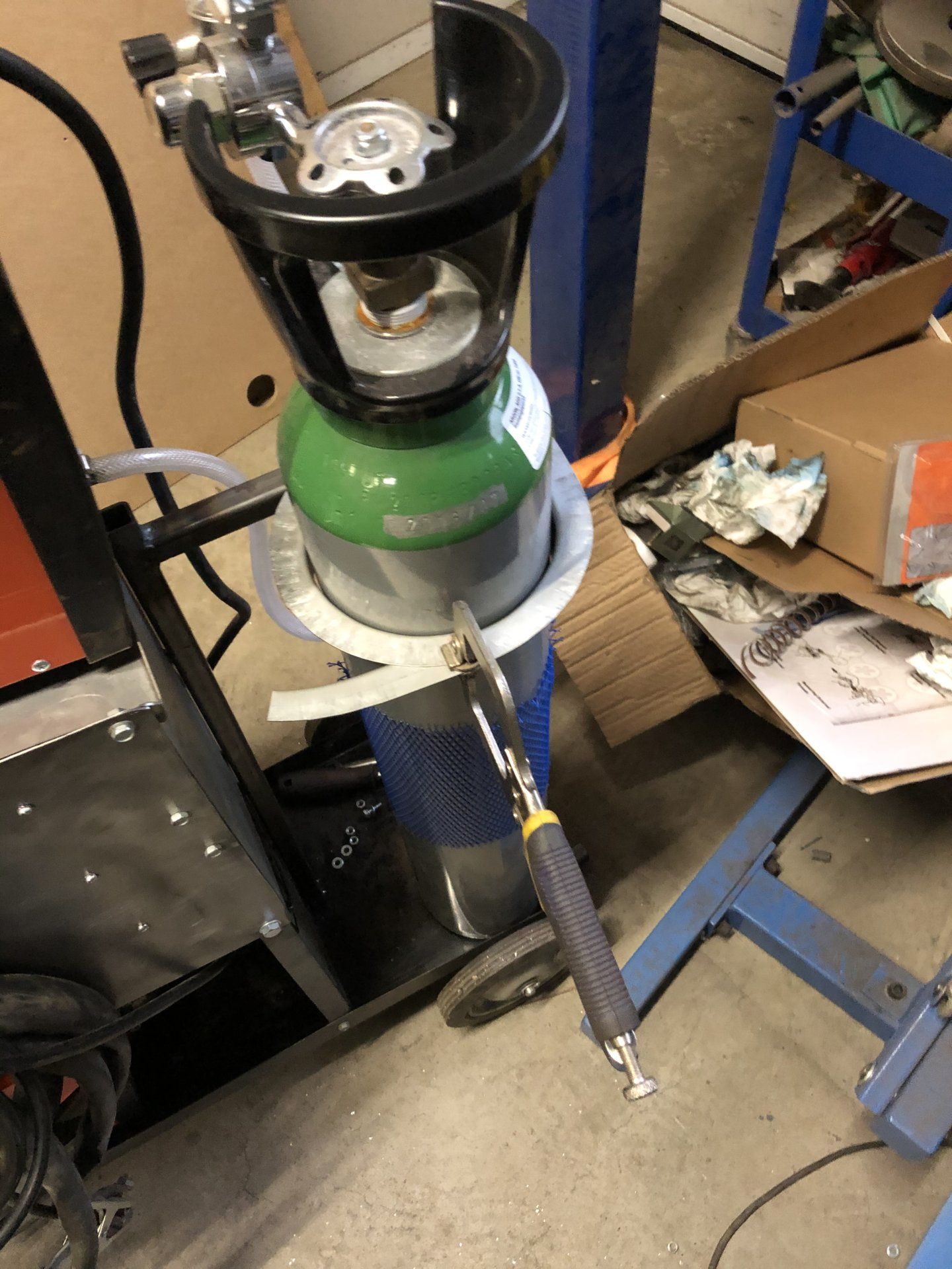

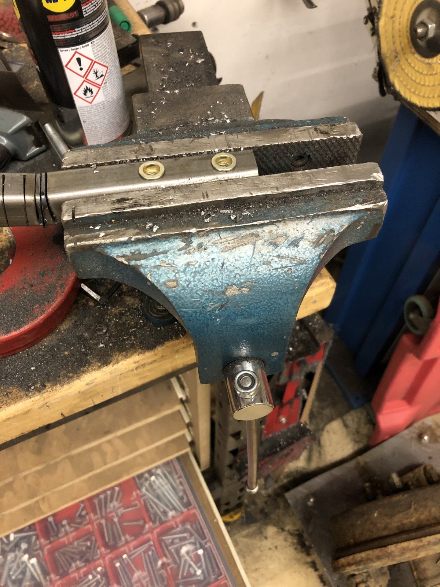

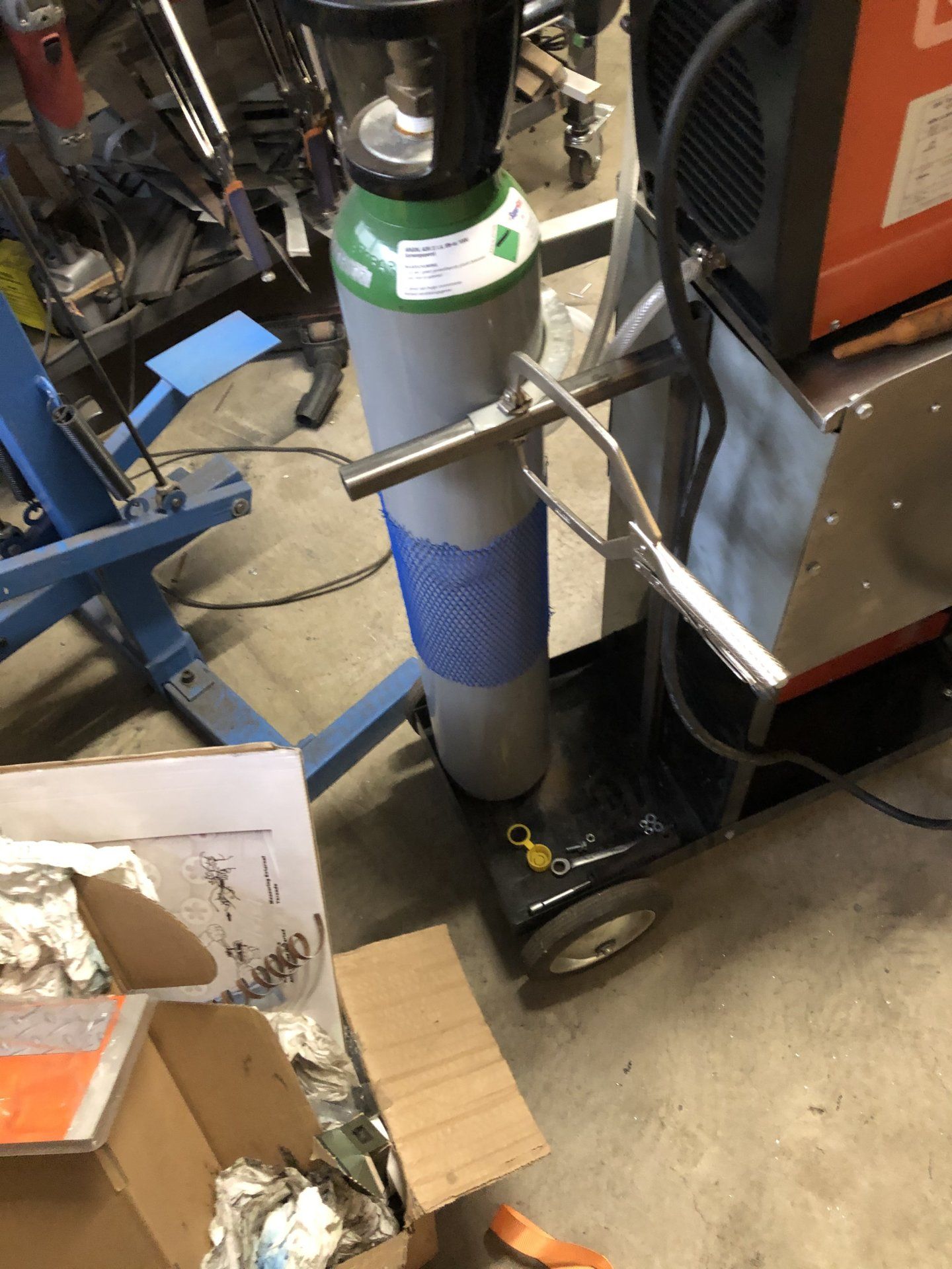

Made some cuts in a piece of square tubing, drilled some holes and added a few nutserts.
Mounted it to the cart and welded the cuts.
Some grinding later.

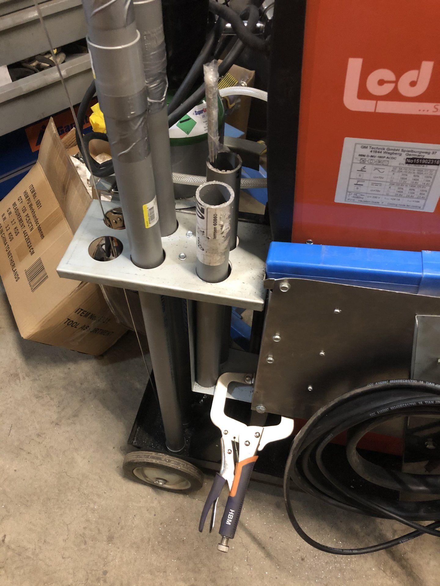

Another section of square tubing welded to some square tubing with a few nutserts in it gave me a bracket for the gas bottle.
A bend piece of sheet and a strecher gave me this.

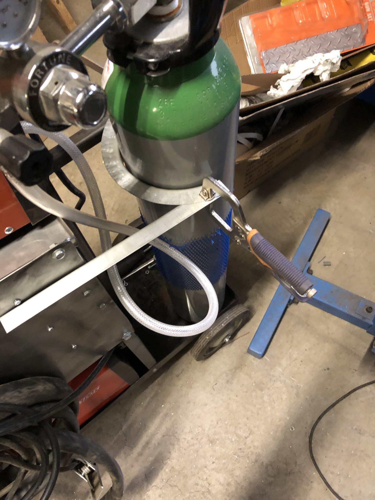

Bolted on there and added a hinge with another radius part.
Next a pin or bolt is added and the bottle is fixed in the cart. Not sure about the bottom yet, maybe a piece of mdf does the trick.

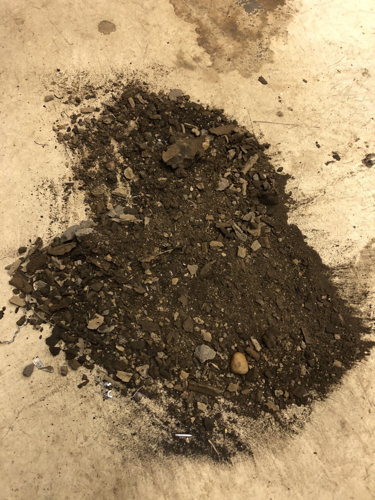

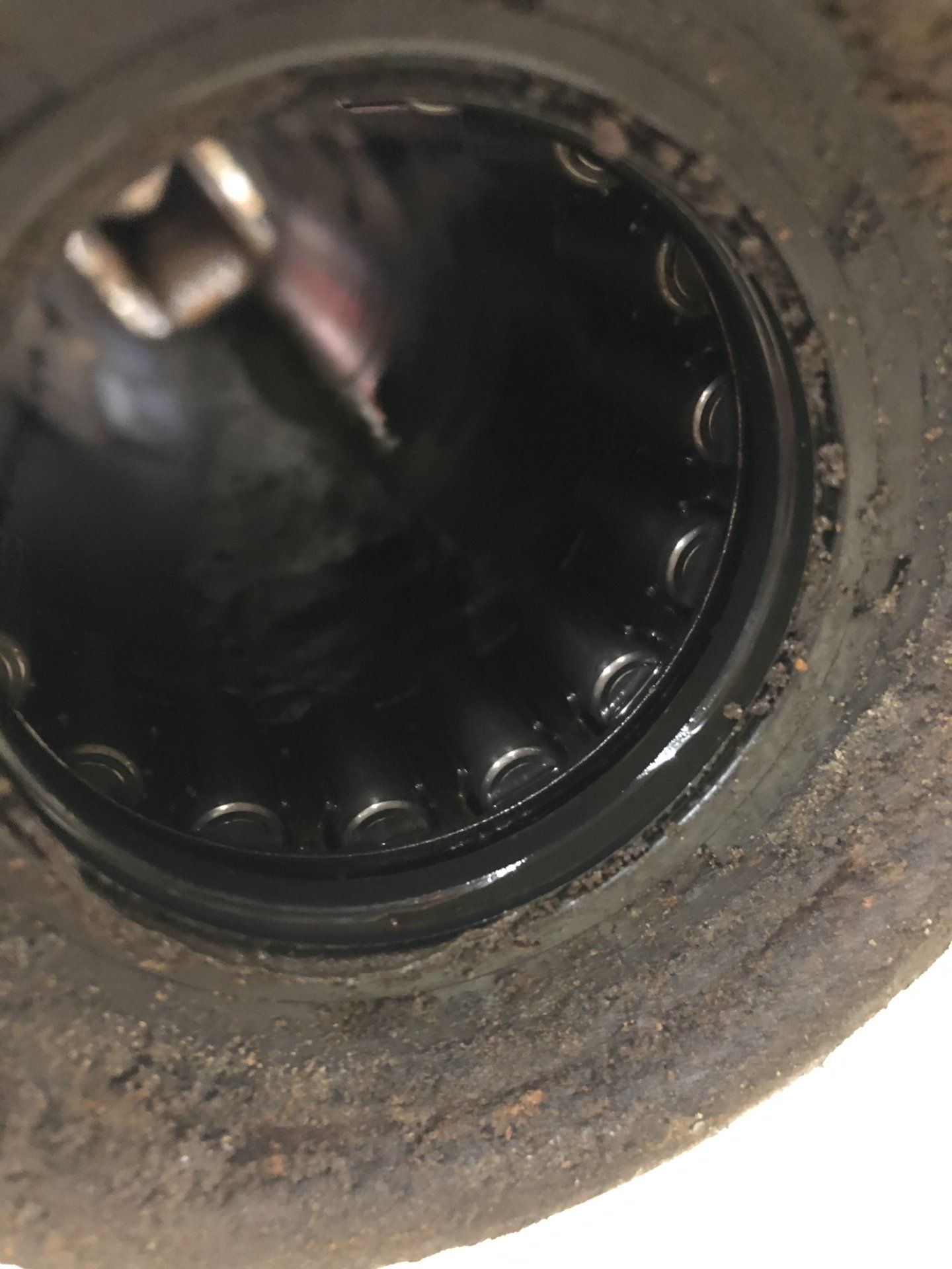

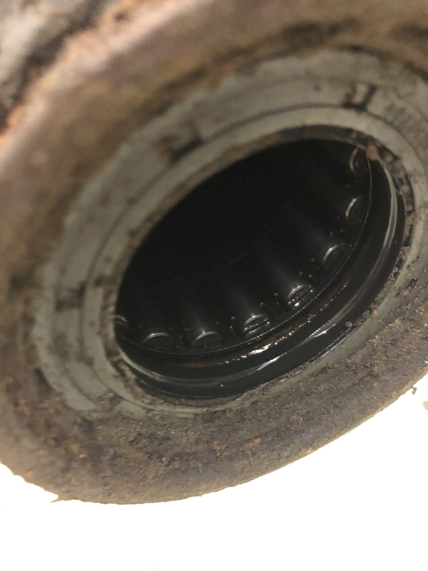

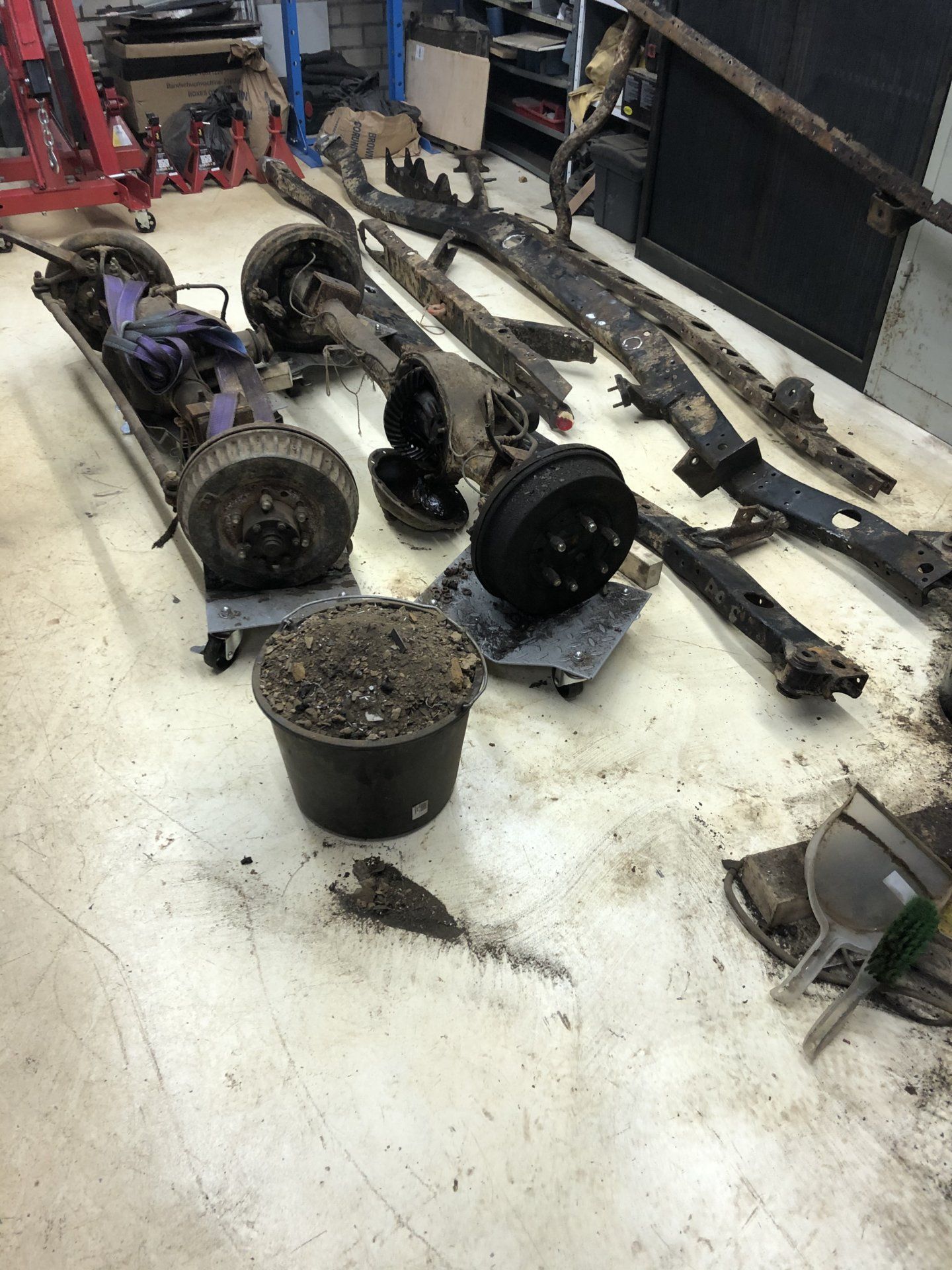

it doesn’t show in The pictures but bearings Are rusted.
Lots of dirt comming from the Axel.

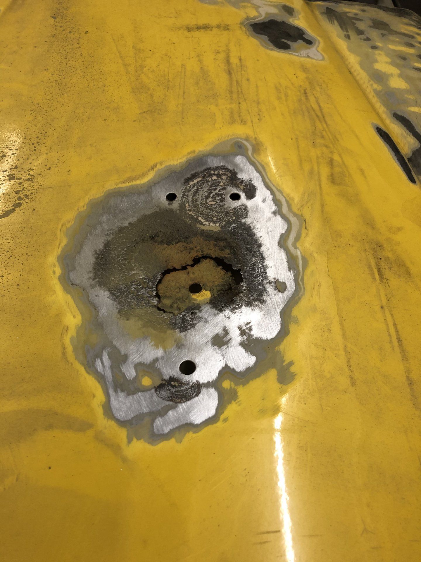

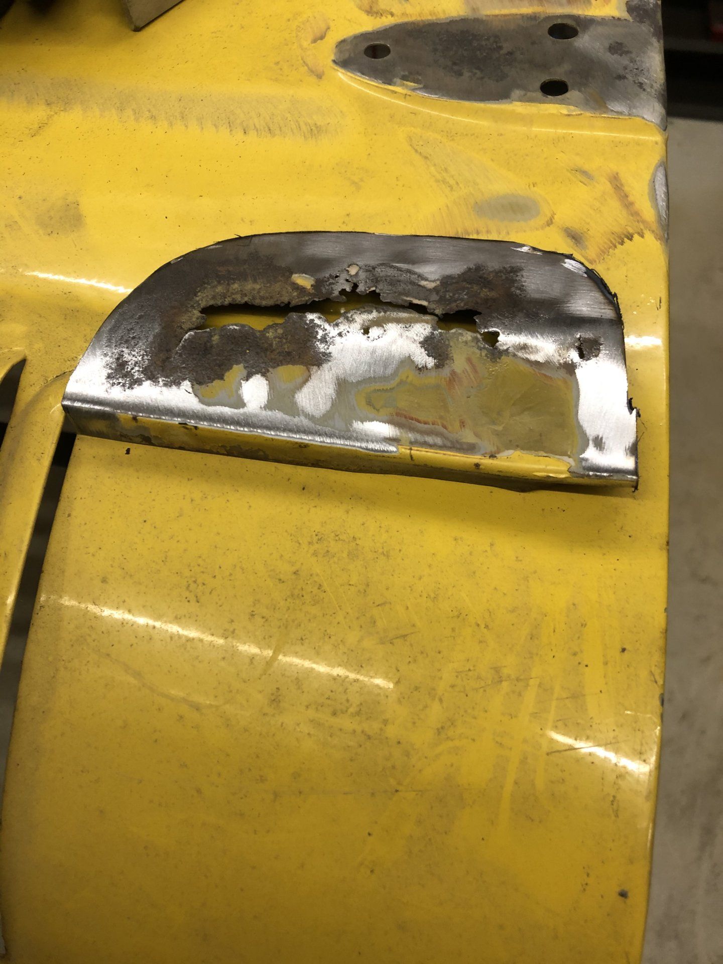

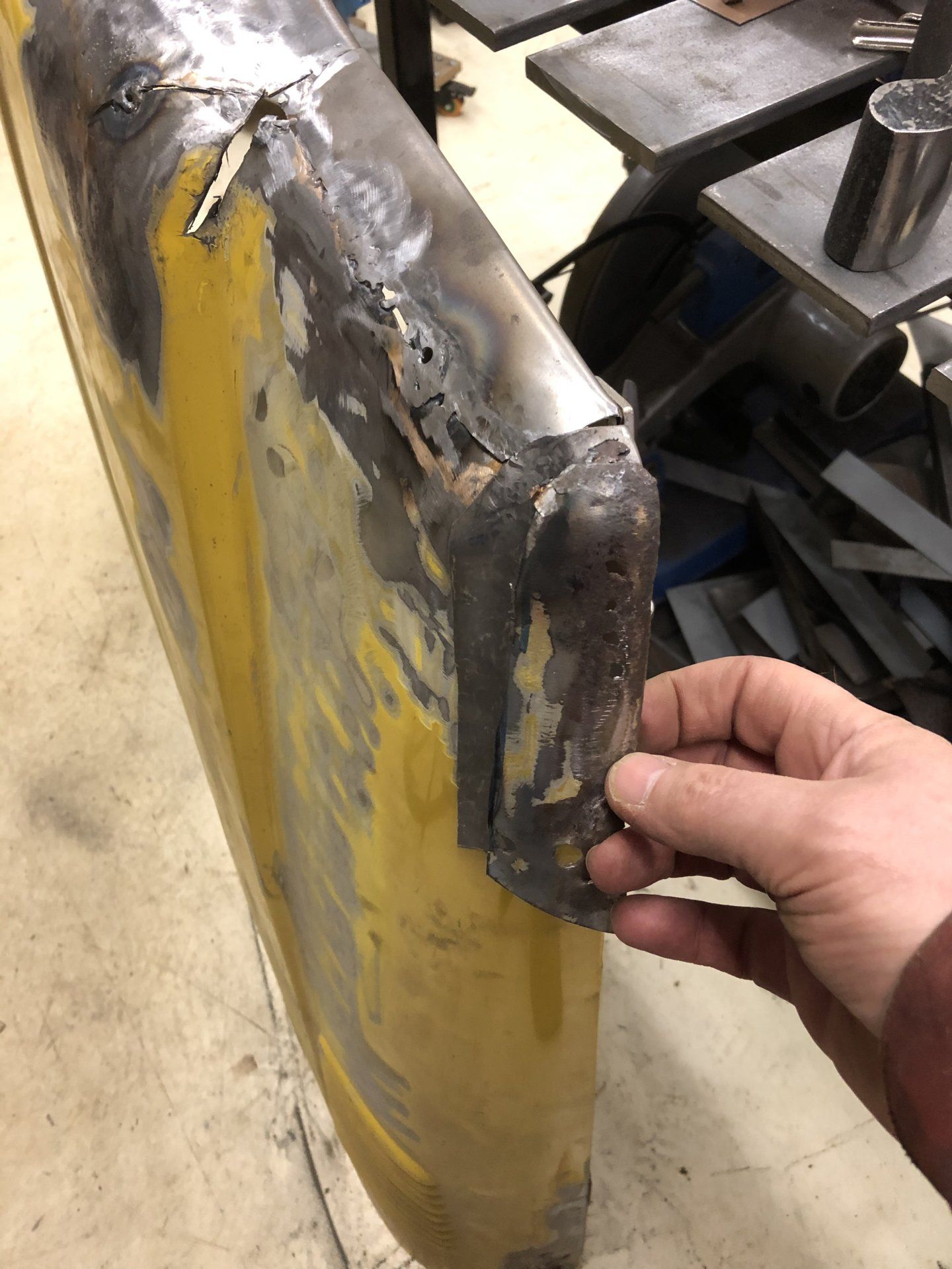

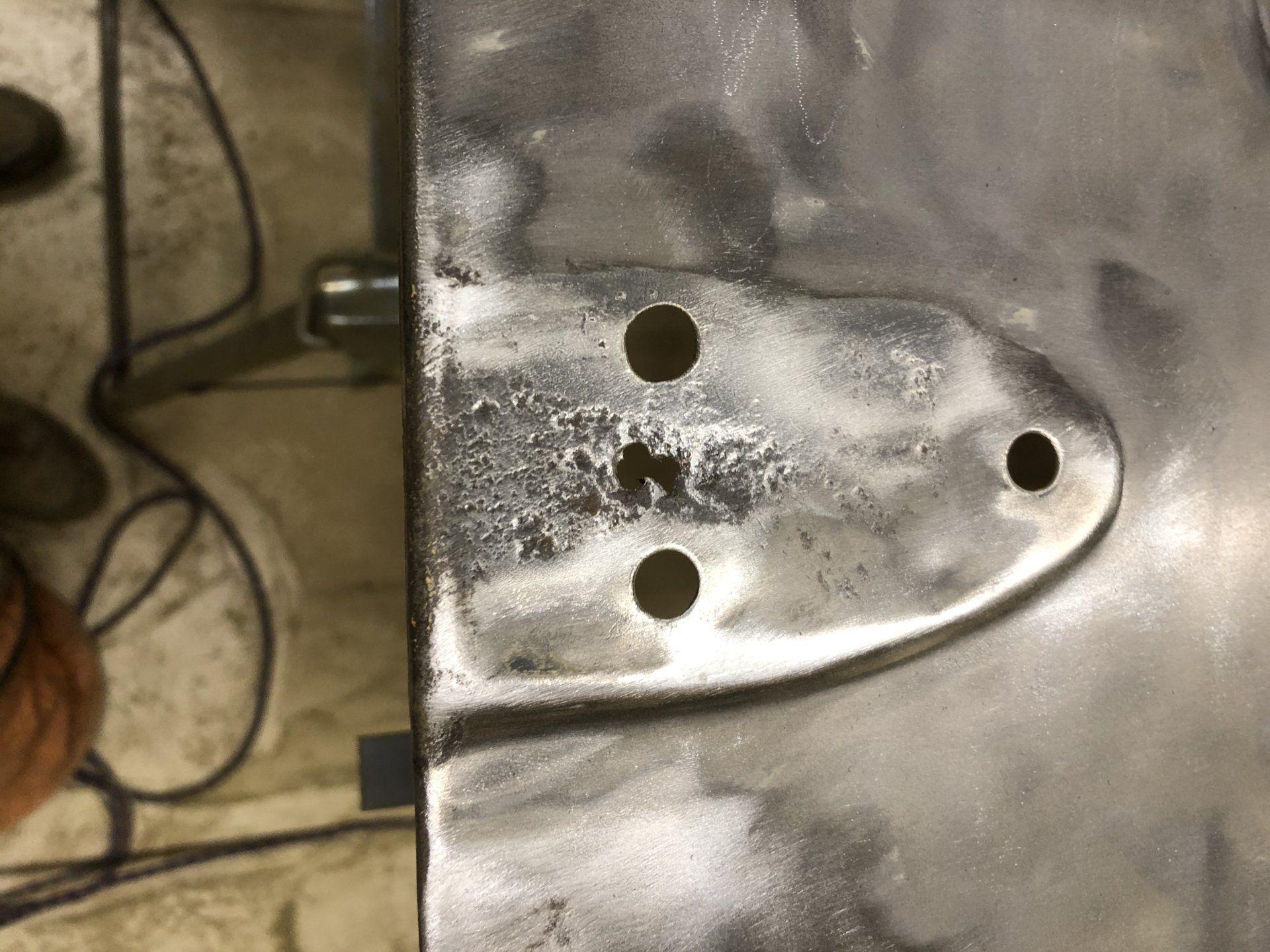

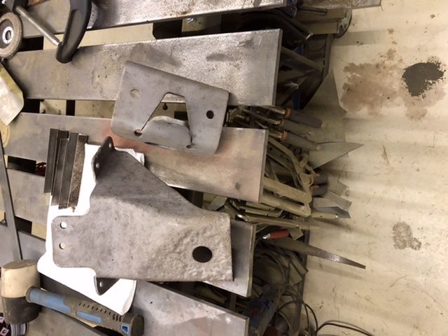

I have been working on fixing my hood.
More pictures and explanation in the hood tread in my sig.

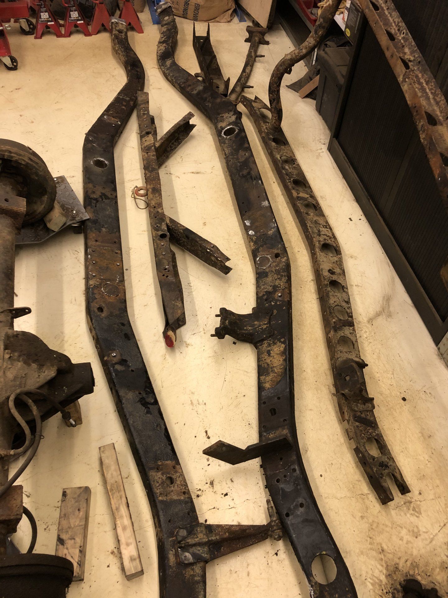

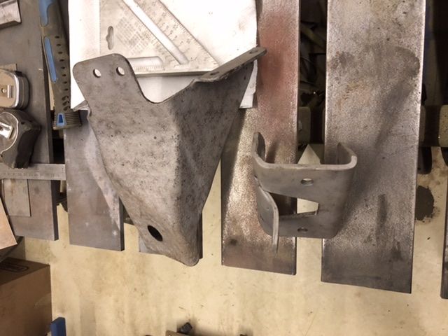

And started with cleaning up the frame attachement.
the body support might need a patch.

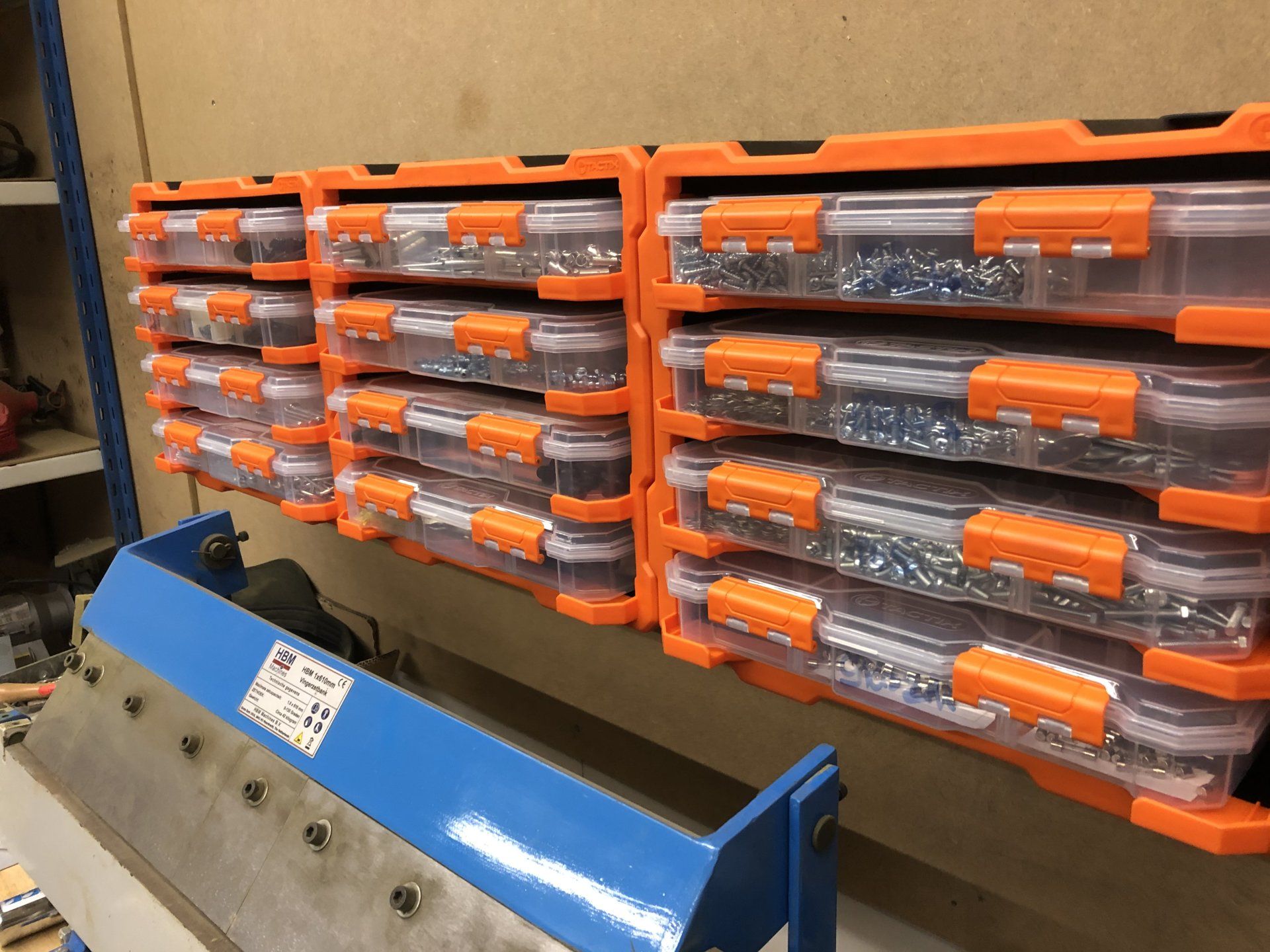

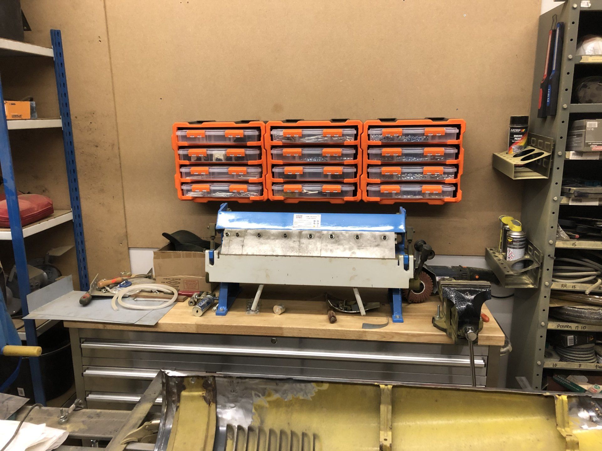

At the end of the year I always get the urge to organize a bit more.
And I still find the need for more trays.
