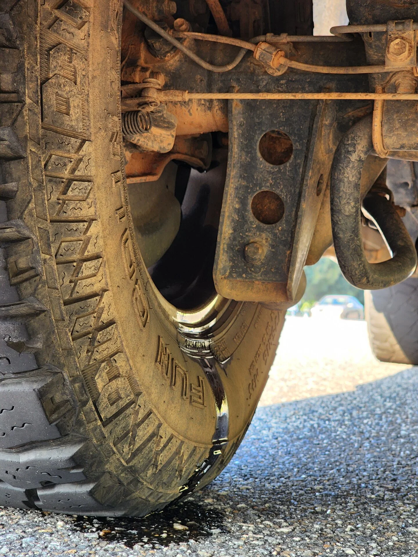

However today while driving slowly 5-10 mph (btw all this happened within 1 min). I suddenly felt as if I got hit from the back..like a thud but nothing hit me from the rear.. so I checked if my transmission was going into another gear. But nothing so I drove a little bit further.. then heard a bad grinding noise and a little bit more hesitation, felt like something is grabbing the wheel until I heard a bang and as I mentioned the grinding sound. Obviously this was not good so I stopped and checked thinking its my transmission. However, I found the rear drivers side tire leaking oil. I managed to get home without any more grinding, break grabbing/hesitation, banging or bad noises. While driving back I got my brake light on. I think I am leaking break fluid (kinda confirmed by checking the brake reservoir.
Searched Mud I think its rear axle seal leak, but wouldn't that leak differential oil? and not brake oil? I think its brake oil b/c I remember diff oil being thicker.
What do you gentlemen/Ladies think? diff oil leak? or something else altogether?

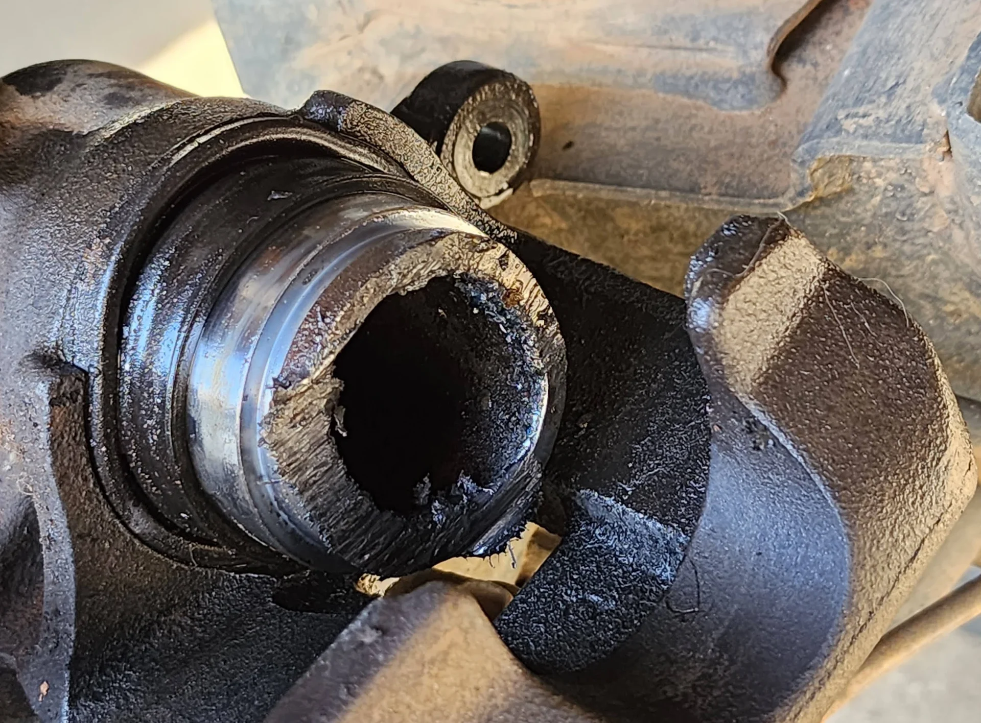

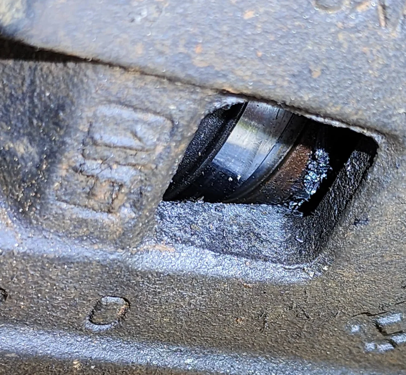

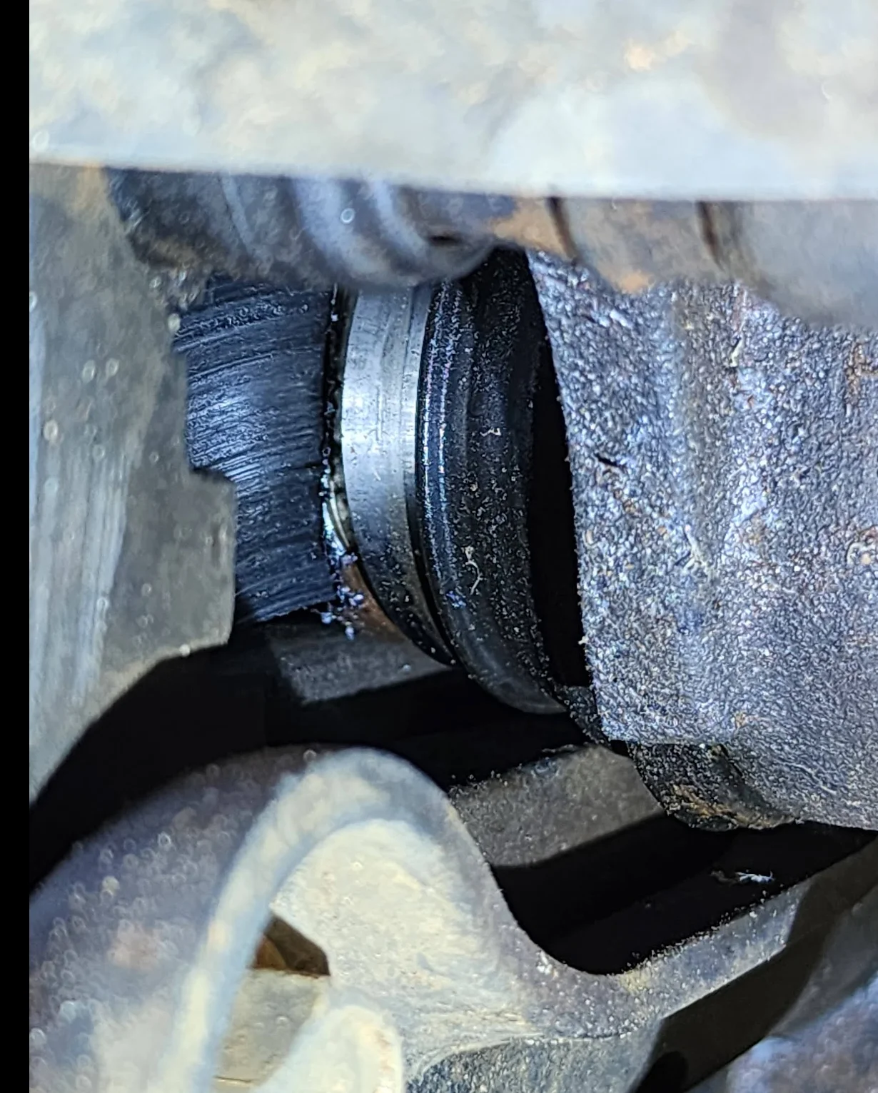

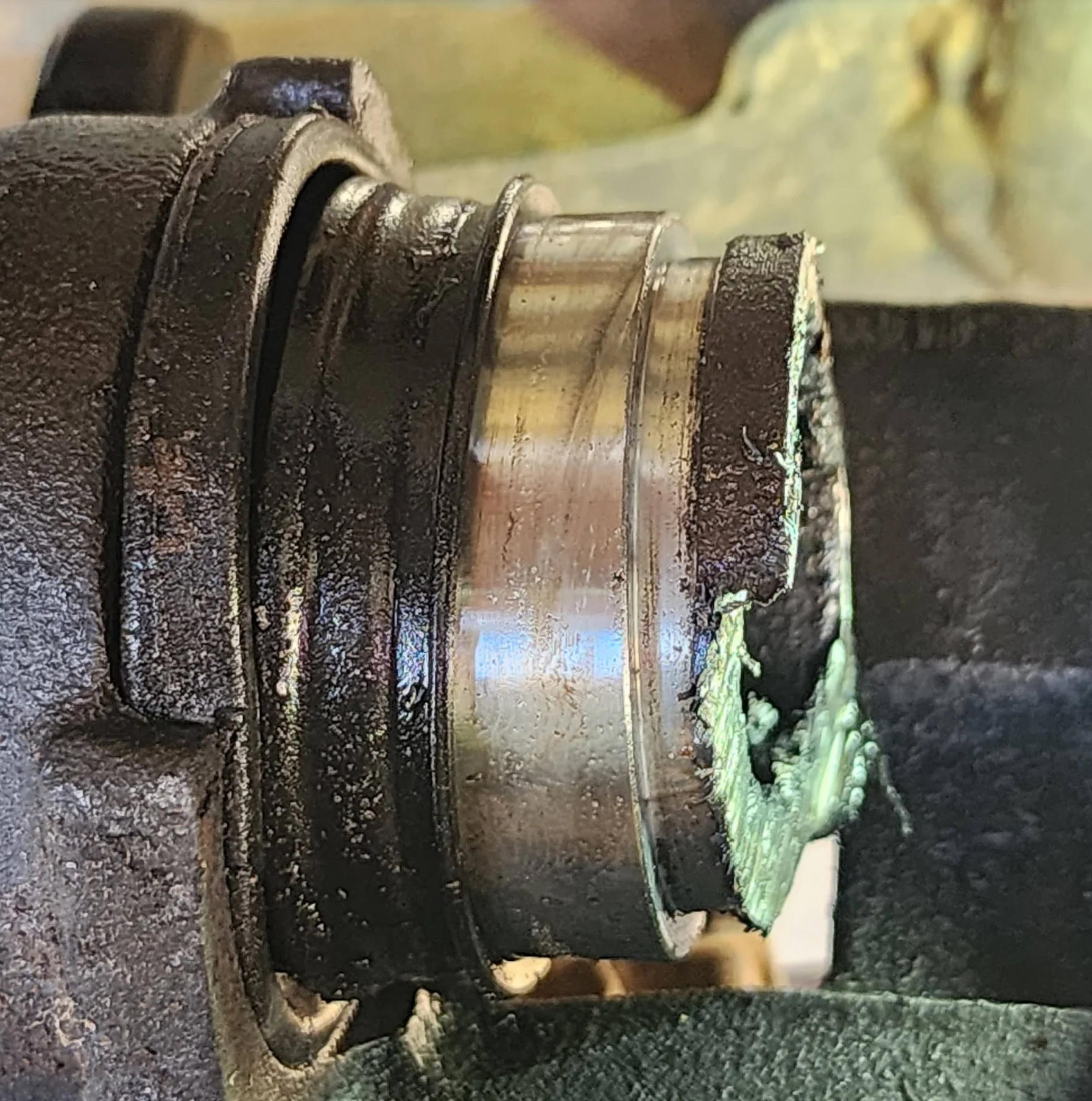

So today I took the rear wheel off. The rear oil leak looks very much like break oil. Almost clear and slightly smells like synthetic oil. I am pretty sure its brake fluid. Obviously the brake caliper was wet.
I didn't open it all b/c it was daam hot 90+ and I was dripping sweat like a wet rag. I didn't see the inner brake pad at all. Only see the rear piston
kinda messed up all grinded up as you see in the pics. I'll open it up in full in the evening when it cools down.

Yeah, that is almost what mine looked like. You’ll find the brake pad rattling around between the disc and the shield (or in my case two of them since I didn’t fix the sticky caliper the first time!). The work is pretty straight forward and easy, no more than a couple of hours once you have parts. Replace rotors and pads on both sides.

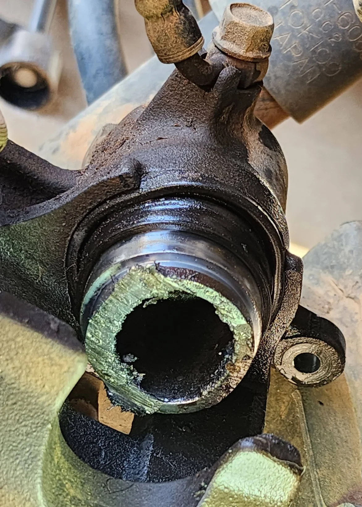

So here are the pics of the caliper piston. It is in pretty bad shape as you can see in the pic. Ooh the inner brake pad that was no where to be found was inside the drum/rotor.

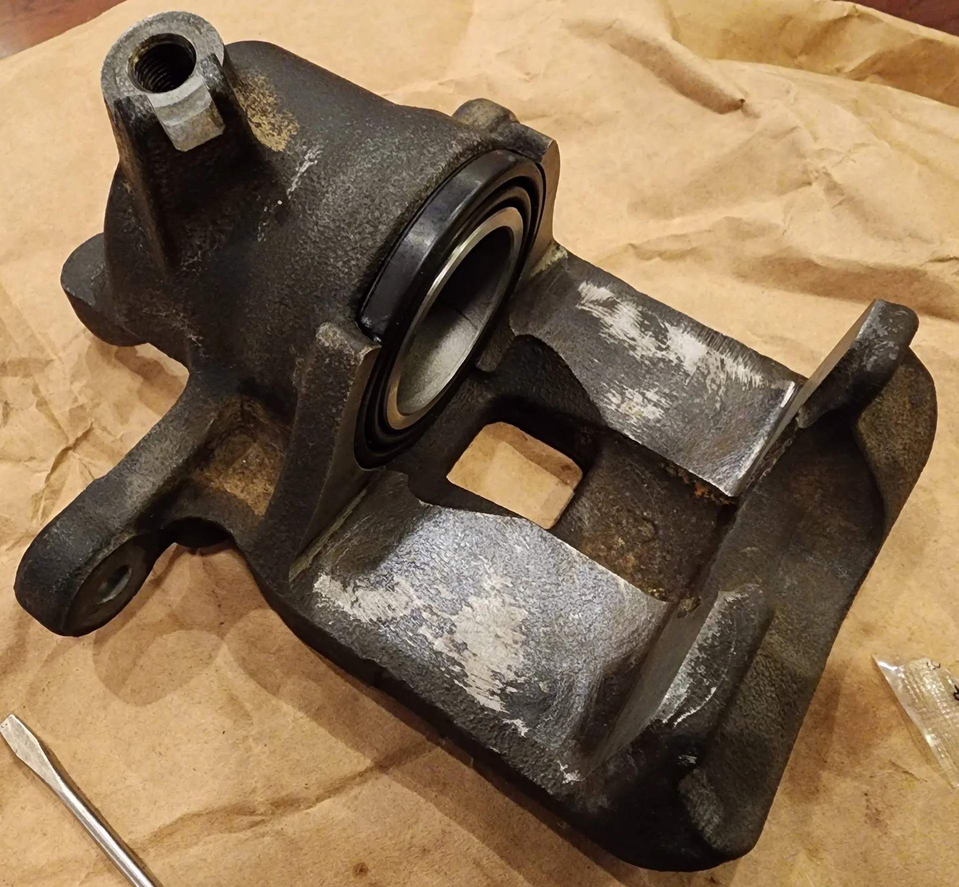

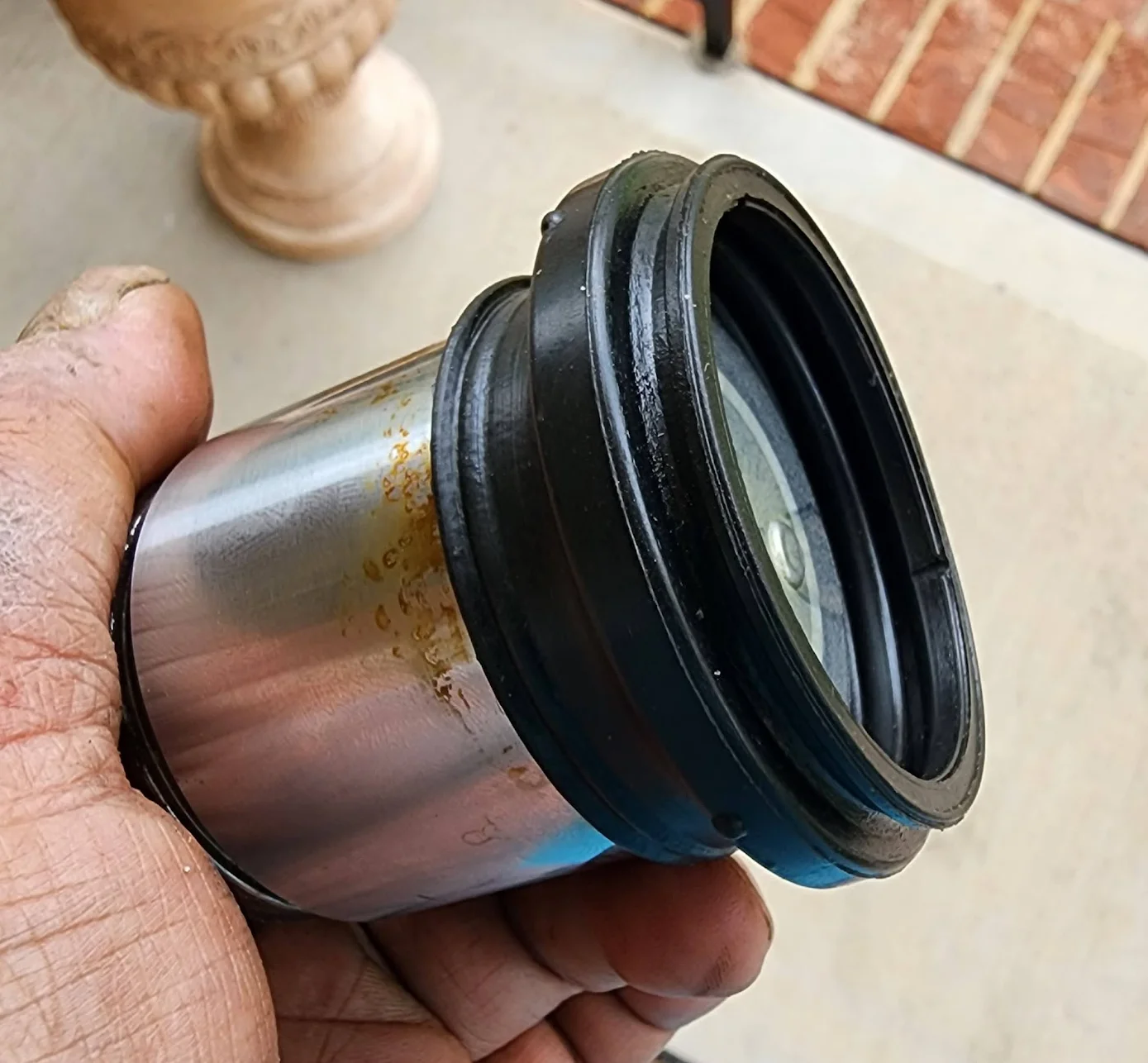

Update....on this..I took the caliper out cleaned it. Looked at the caliper cylinder. I looked in decent shape. So I got the caliper piston from Rockauto. I would have ordered OEM piston. But Its not available at least in the SE from the Toyota Dealerships..And they didn't know when they would get it in either. Which is why I went with Rockauto's solution. I could not get the OEM rubber kit either...so ordered that from Amazon
Here are the part numbers for my stuff I got
Rear Piston - Carlson 7113
Rear Caliper Rubber seal kit from Febest - 04479-60250 / 447960250 - Cylinder Kit For Toyota
I put it together and here's what I got so far. If the SE rains let up I'll install it and see if it works.
How to fit the boot -
Btw putting in the rubber boot was tricky if you haven't done it before. After looking at some videos online. I found the best way is to put the boot on the caliper is the following -
Pre-grease your components - Square rubber o-ring, piston, rubber boot ends
I assume you have put in the square rubber o-ring into the cylinder already and are using the Lithium soap base grease. I am 99% sure Silicone grease (aka dielectric grease) can be used here as well) in place of the Lithium soap grease. As long as the grease is SAFE for Rubber components I think you should be good.
Prefit (to see how the boot it sits in the caliper cylinder groove) - First just fit the boot on by itself on the caliper cylinder to see how the lower "boot lip" fits the cylinder groove. You could clearly see how the boot fits into this groove and the way it sits. Now you know how it sits in the groove, Remove it and do the next step below.
Final fit - From the top fit the boot on the piston, Then bring it all down till the end of the piston edge. Let the "lower boot lip" that is supposed to sit on the caliper cylinder groove hang over the piston bottom edge by about 1 cm or so. Fit the boot lip first and ensure it fits the groove like you see it fit in the Prefit session. You should see it fit the groove. The back part will need a little bit of pressing using a Philips screwdriver (do not puncher the boot obviously). Once its site the groove push the caliper down and it will fit perfectly. Make sure the "upper boot lip" fits into the upper piston groove as well. See pic below.. on what I mean...
Btw if you piston goes in and your boot does not fit properly then use compressed air to take the piston out again. Be careful and not have your hand to catch the piston. It comes out with some force. I used some paper to stop it.
Close up of the Caliper piston boot

Yeah the rotor was trashed obviously.
