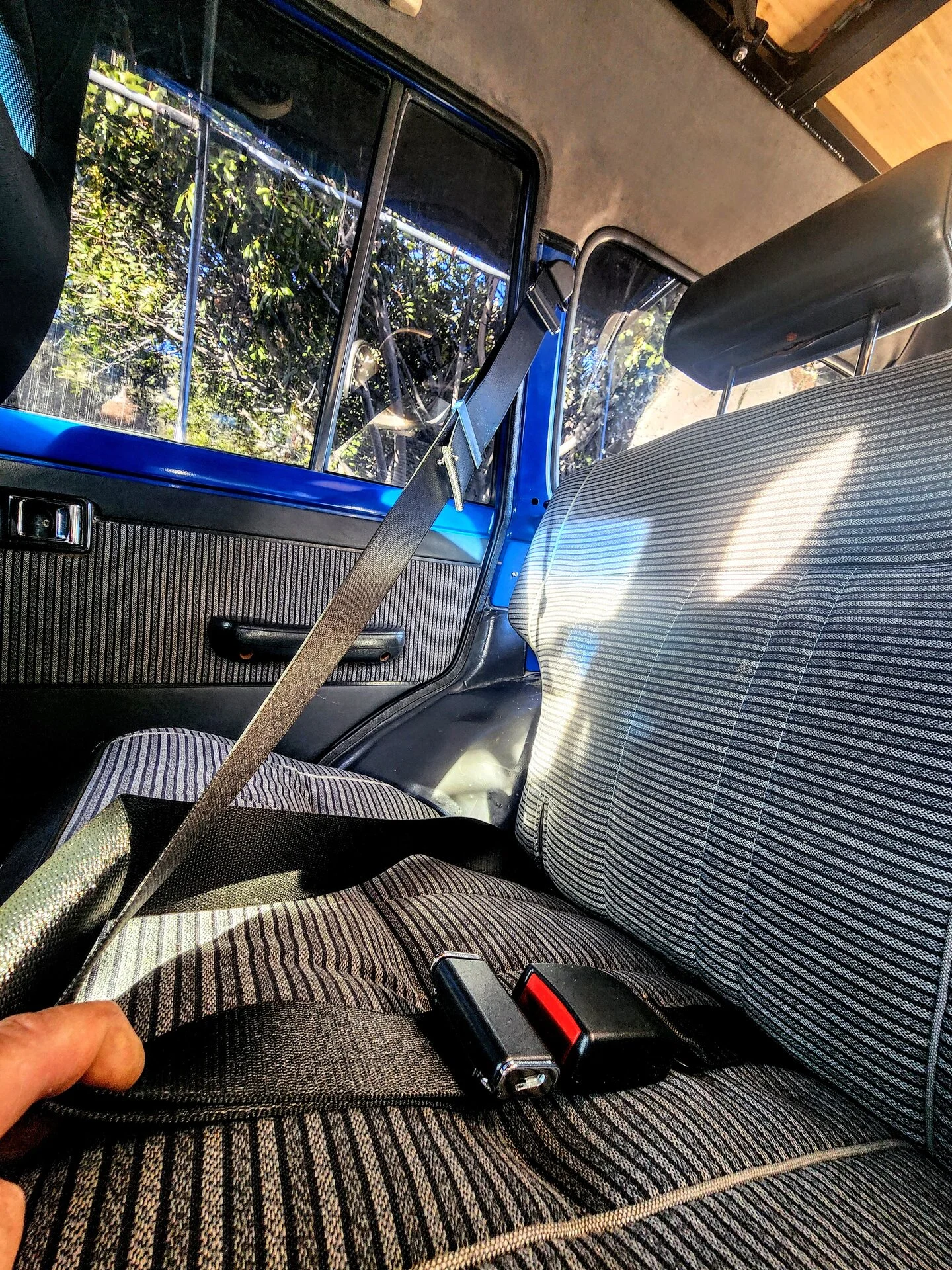

I mounted the Seatbelt Planet non-retractable shoulder belts in my 1985 FJ60. This is what I got: SKU 50359-V01
The description says "1985-87" but I'm not sure what the difference is with your earlier model. I had the threaded pillar nut and installation was super easy. All hardware was included and I remember the customer service guy at Seatbelt Planet being very helpful with some questions I had before buying.
I have the tan/brown interior and went with #34 "Brown" and it looks good. Not a perfect match but close enough. The receivers and all plastic parts look 80s enough.

I got these from seat belt planet
SKU: 50359-V02
They fit great.
Got them on black

Awesome, thank you so much! I really like the look of the non-retractable ones. I'll look into it. Legend
