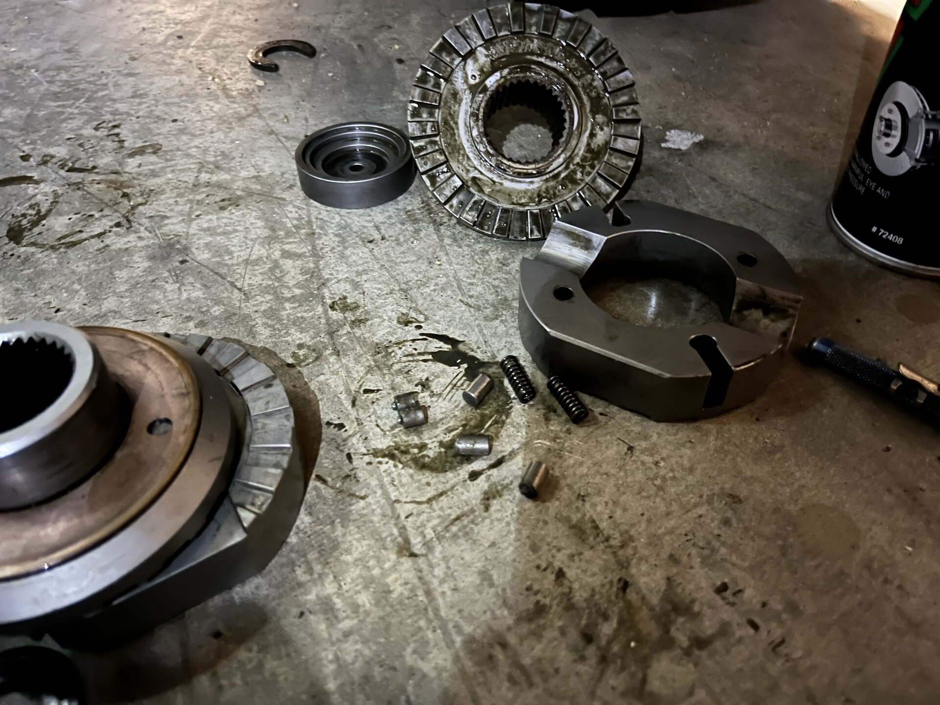

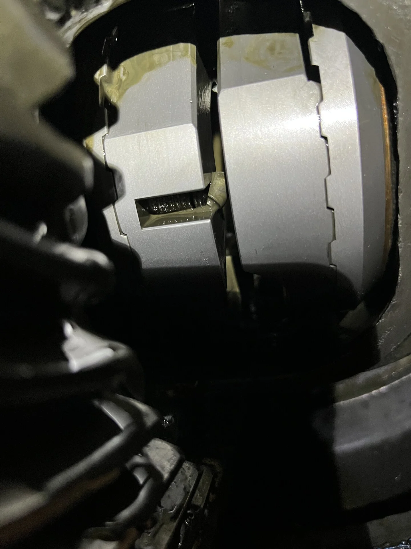

FWIW I have run two different “drop in” lockers over the years. Both an EZ locker and currently an Aussie locker. Cracked my EZ many years ago.
I have been happy with my Aussie and work the heck out of it. Same comments as above on getting used to driving characteristics, but it serves me fine. Currently running 33s, 2F, Orion, etc…. Hard to beat the price and ease of install.
I have a Detroit to go in one of these days, but have been able to get in and out of most stuff in put my truck into (southeast rocks/mud, etc…).
With that said, I sheared pins in my Aussie last weekend, but after several years of abuse. When they sheared it “spooled” and I had another full day of fun and drove an hour home. 😎
Let us know what you decide! Below pic for fun.
