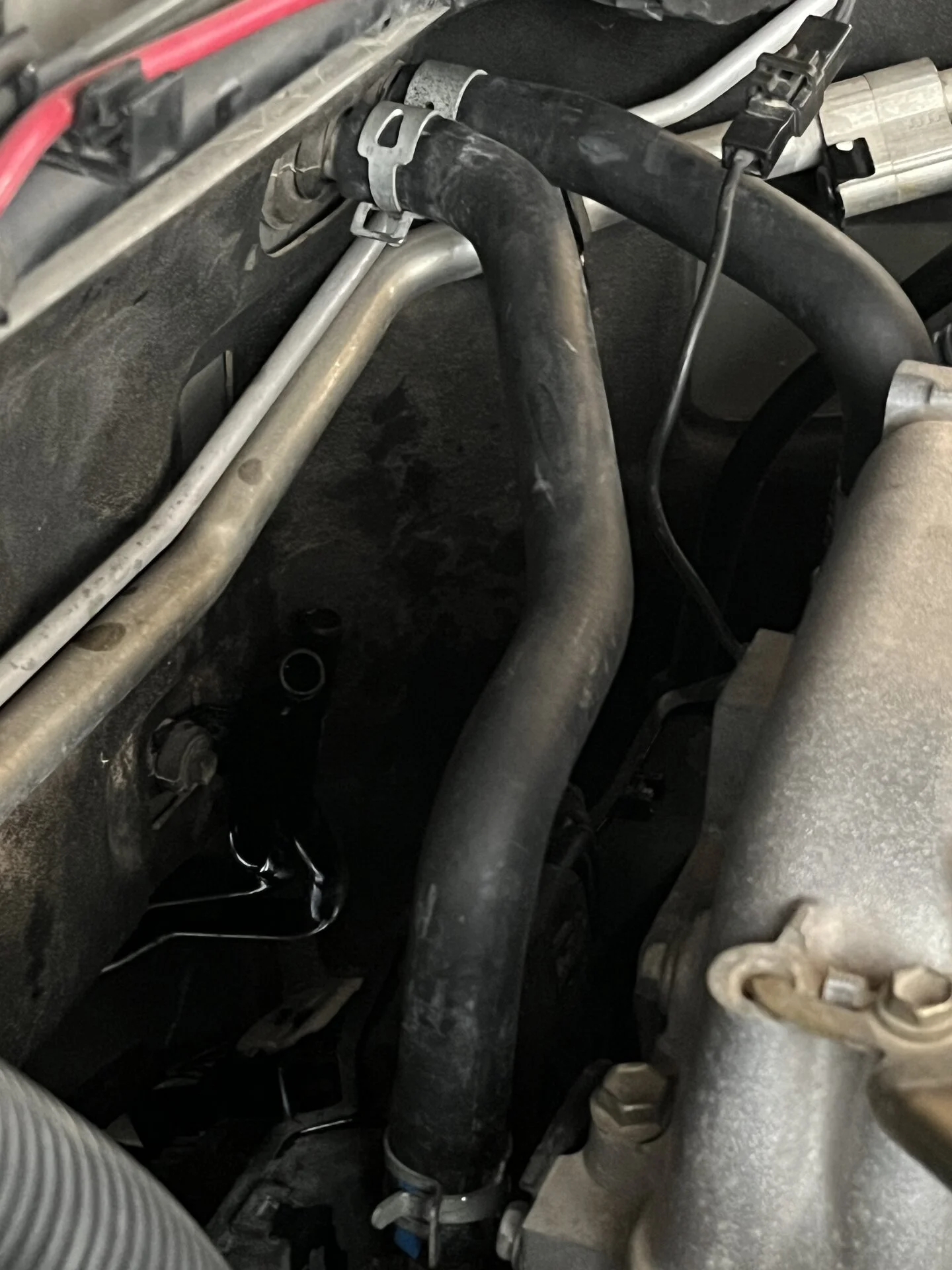

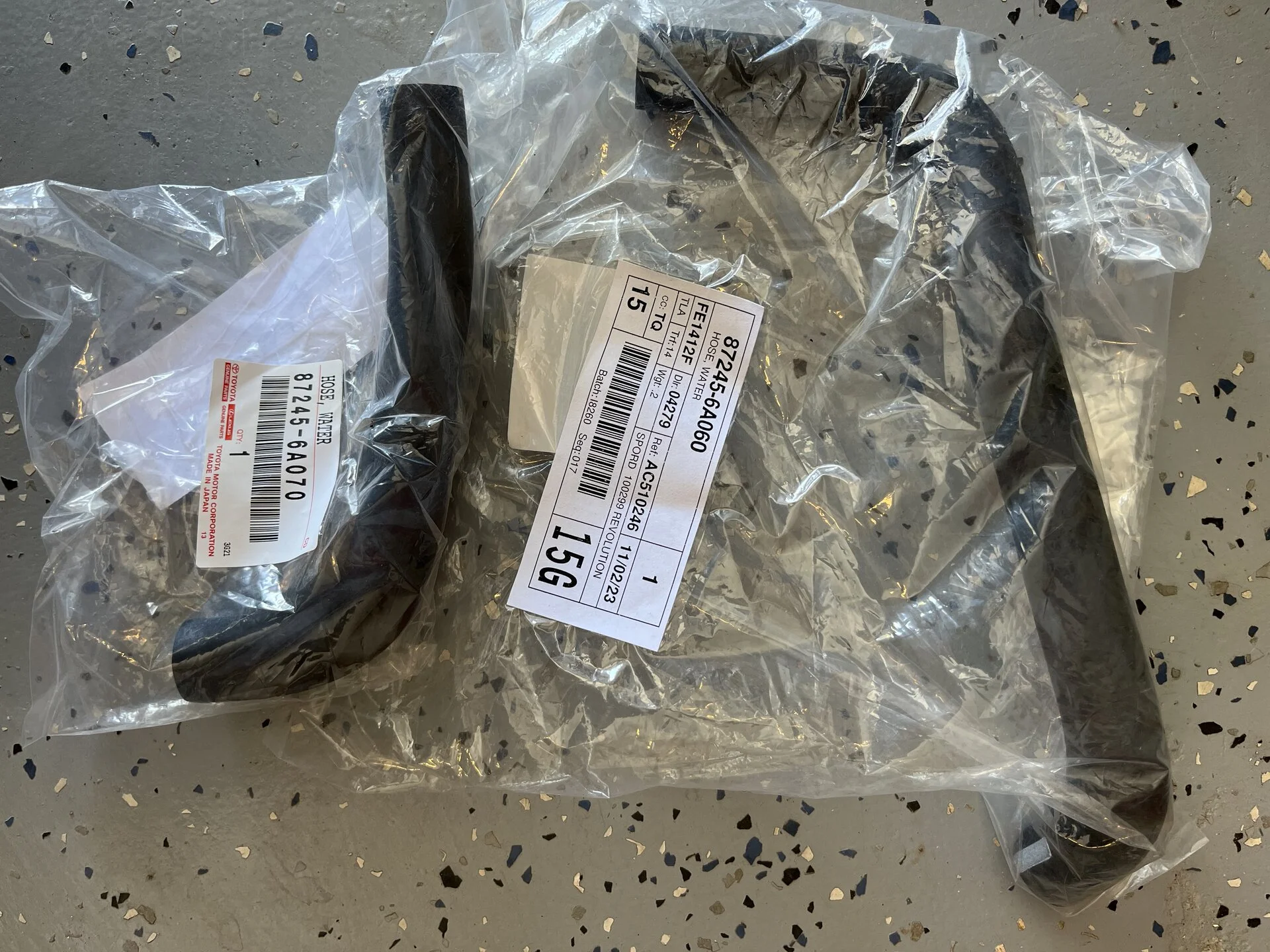

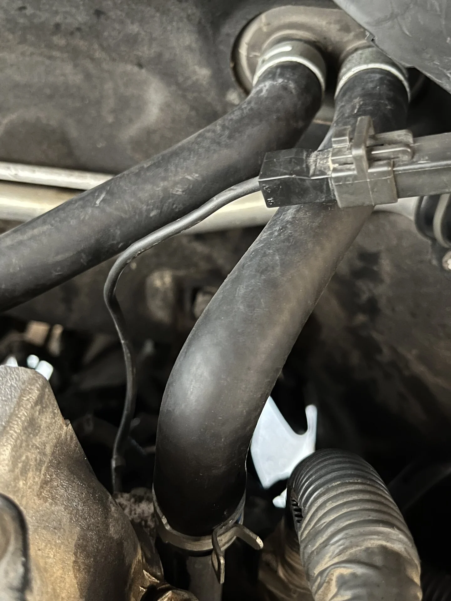

Did the T’s a year ago, but lately was questioning the rest of the system. I thought, heck I never used the rear heater in western Wa and I sure don’t now in southern NM. I ended up replacing 2 hoses and Bam, it’s done ! If you’re interested I ended up getting the hoses from Capo Valley Toyota, they beat the hell out of my local dealer. 949-373-9600, talk to Ruben for a Mud discount. Their catalog says they won’t fit my ‘98 but they are what you want. I see it as piece of mind.
A very easy job, I drained coolant then removed the hoses at the firewall. Then removed the hoses going down to the metal tubes going to the rear heater then removed the other hoses at the two engine connections. you get all the hoses (6) and the T's in two pieces that way, not that that matters. The only parts you need are the two hoses I posted above with the part numbers. Install them, install the drained coolant and you're good to go ! I'm going to install rubber caps on the tubes that go to the heater just because. Old hoses and T's are in my truck spares bin in case someone needs them for a trail fix.
