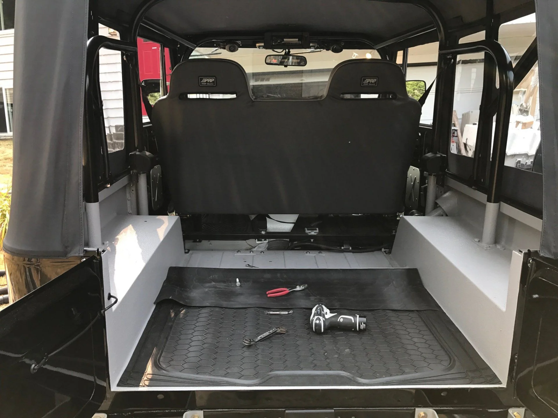

My Cruiser came with some super rusty, hacked up jump seats that I started fixing, but am abondoning at this point. The PO cut a chunck out of the back rest to fit around the roll bar, which I was going to repair but once I startied looking at what spacing the seats out from the roll bar would look like combined with the rough shape of the seats already, I've decided against this plan. After searching and reading about the jump seats, aside from the look they are not very safe or practical.
I want a rear seat option, but it has to be accessible due to my front bench seat. Thoughts?
I've never seen rear facing. This is mine:

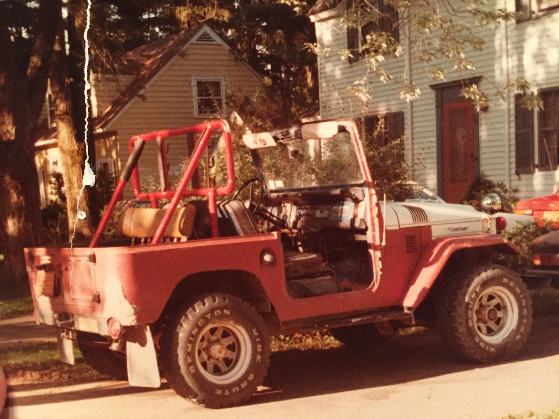

Here's my rear facing seat in a '69 in 1984. No that's not a pvc toolbar - the rig came with the rollbar, plow and the rear facing wooden kitchen seat when I bought it.
We used to pass out beers on the highway on the way to the beach to other cars and to passengers in motorcycles.

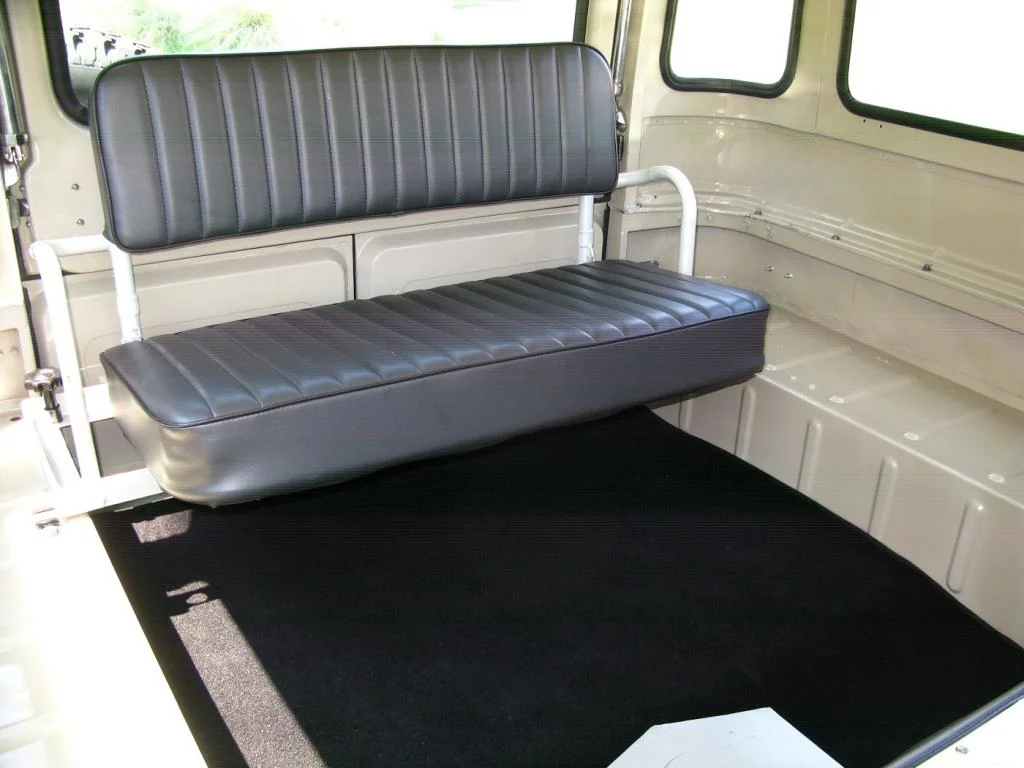

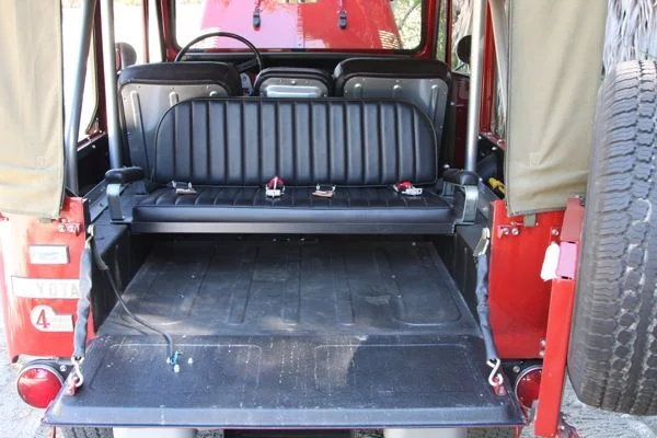

Just a thought but has anyone ever transplanted rear seats from an 80's Subaru Brat into a 40 series? A friend of mine had a bench seat in his 78 and wanted to try this but ended up finding an old Con-Fer bench instead. He did end up mounting it backwards and it worked well for kids.
The 1st is a seat I added for the kids.

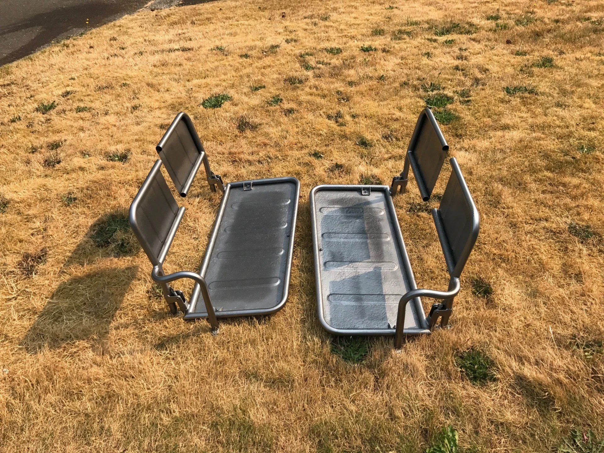

The 2nd is not mine, but was nicely made from a matched set of original jump seats. Since yours are already cut, this would be a good option, either rear or forward facing.
