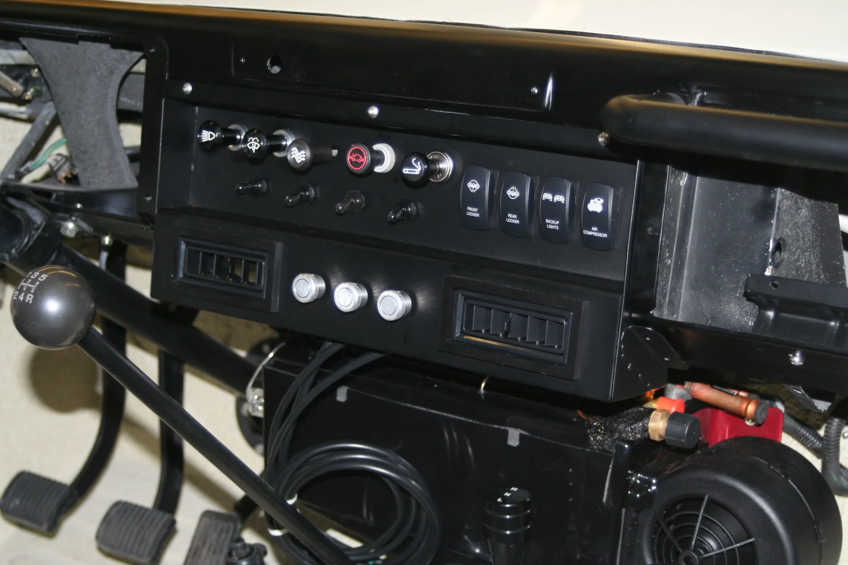

Toyota has a different way of thinking when it comes to wiring things.
If I were going to rewire a pig I would ditch the Toyota headlight switch and go with the common GM style that all the wiring kits supply, the Toyota pull knob can be made to work in a GM style switch...
Yeah, I just wanted the OEM look, didn't think to just switch the knobs. I think it was the wiper switch, not the lights that gave us a problem.

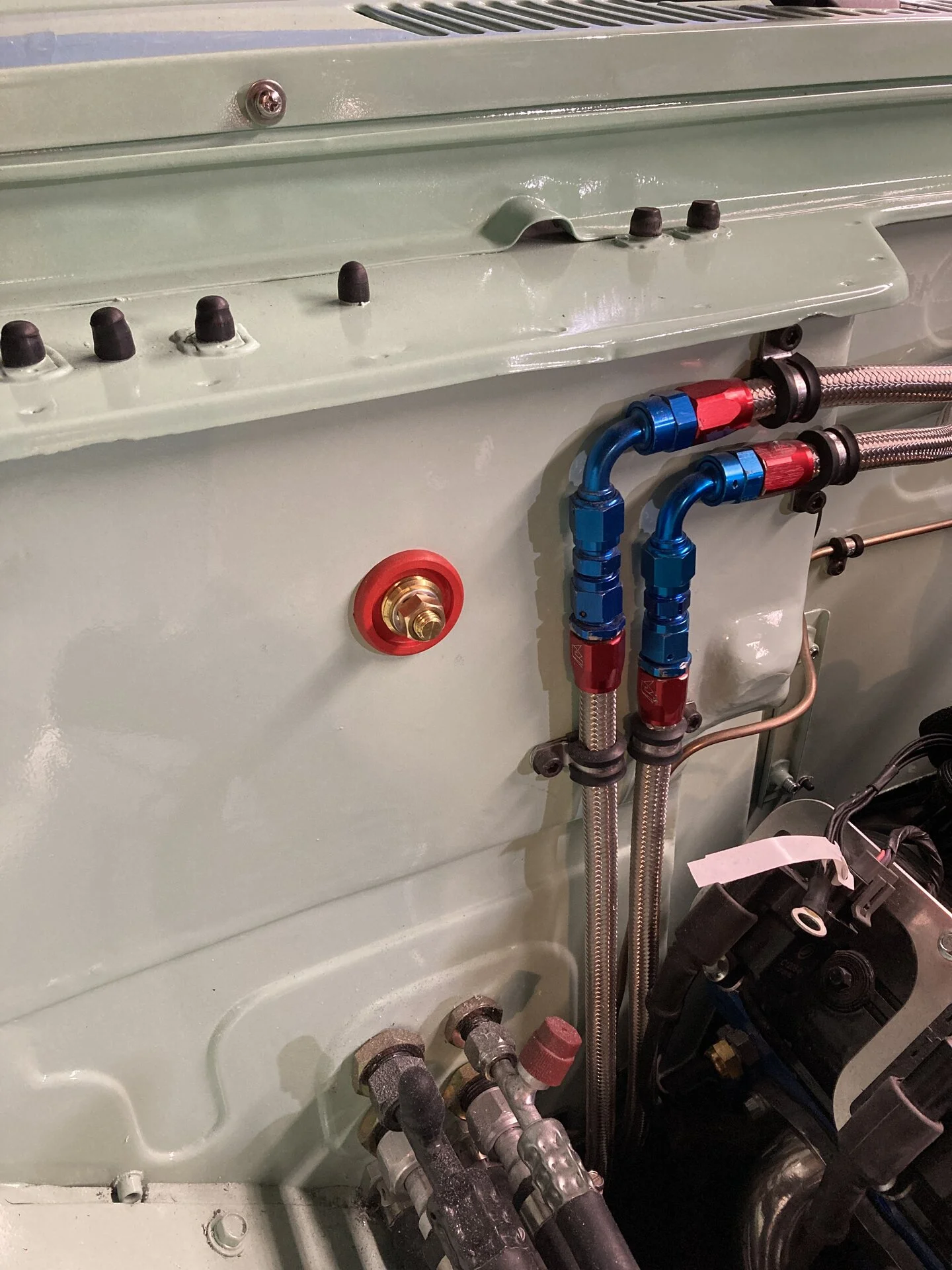

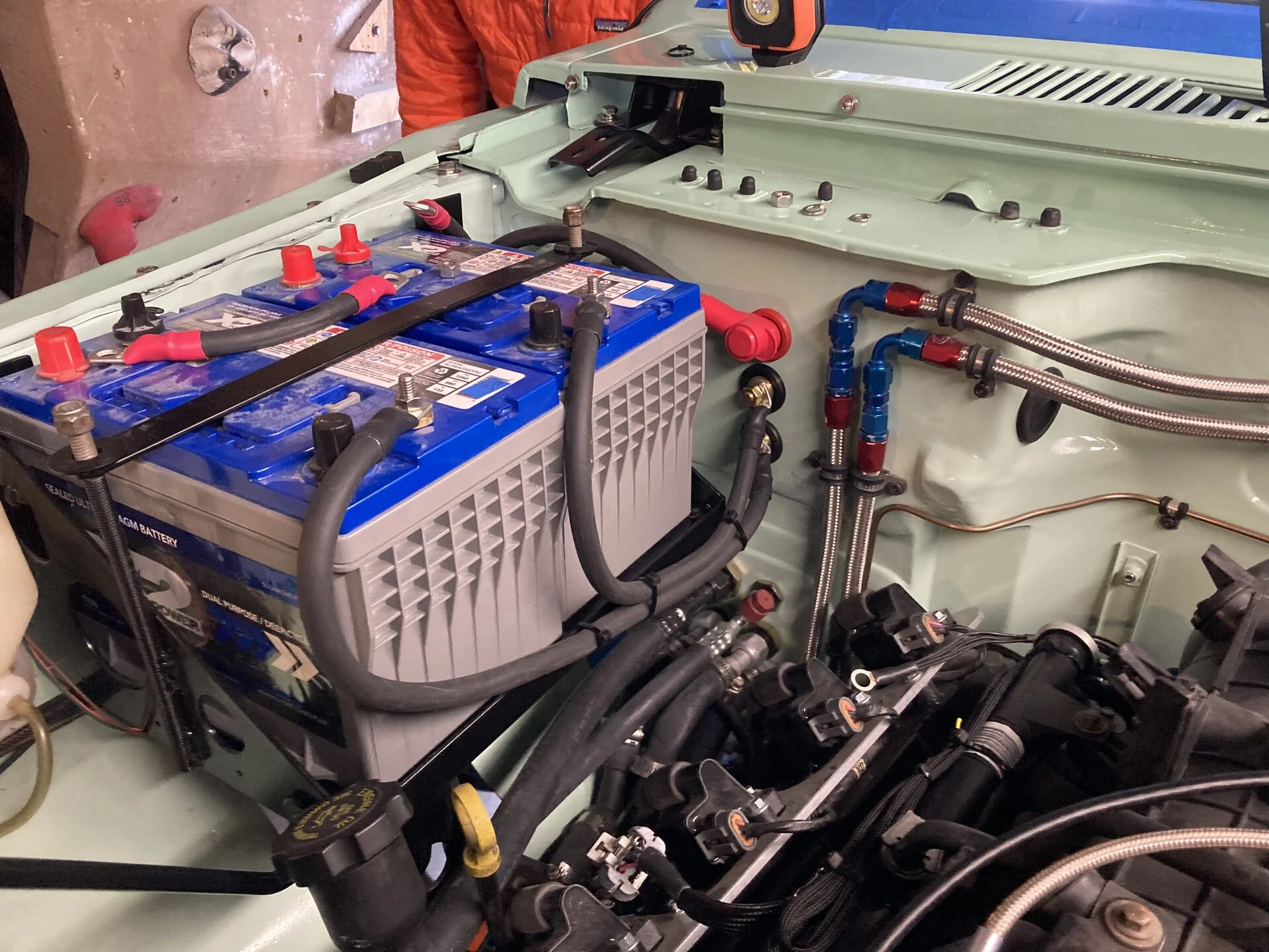

A word of caution, that little red guy is what gave me a headache for some time. The nut in the cab side loosened up and caused on and off contact making me think something was wrong with the battery charging. I now check for tightness every so often. She's looking sexy by the way! 👍

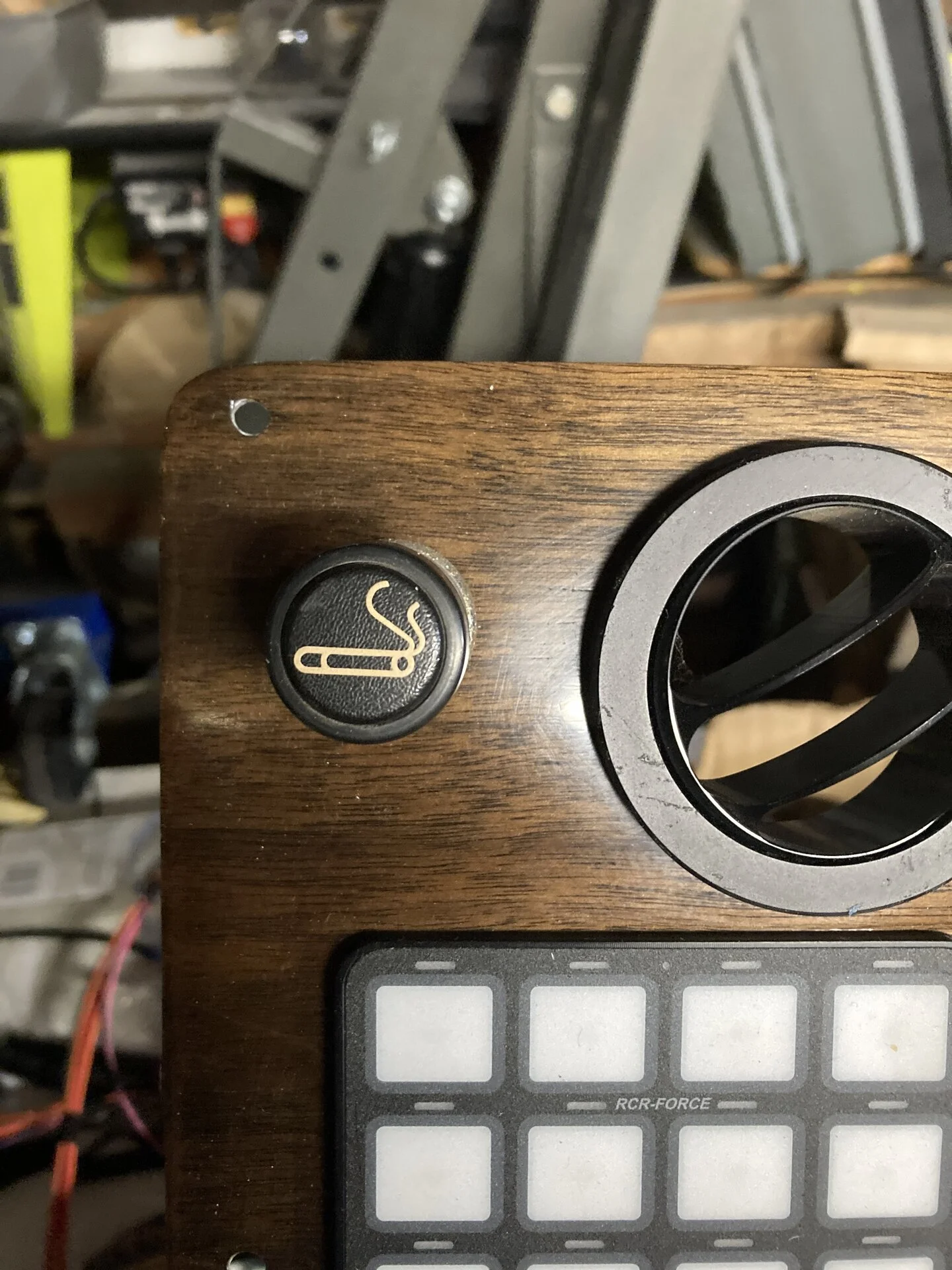

I only wish I could get the lighter switch lite!
Some Loctite FTW?
