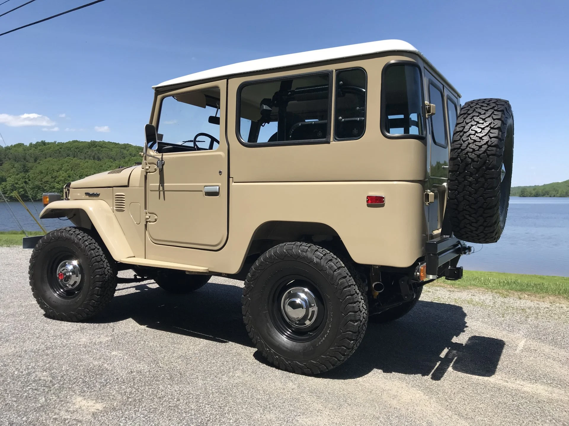

I installed one over the winter, it's been great so far. No rattles or other noises and holds the 33" with no drama. Not a great photo of the carrier, but Nolen has you covered.

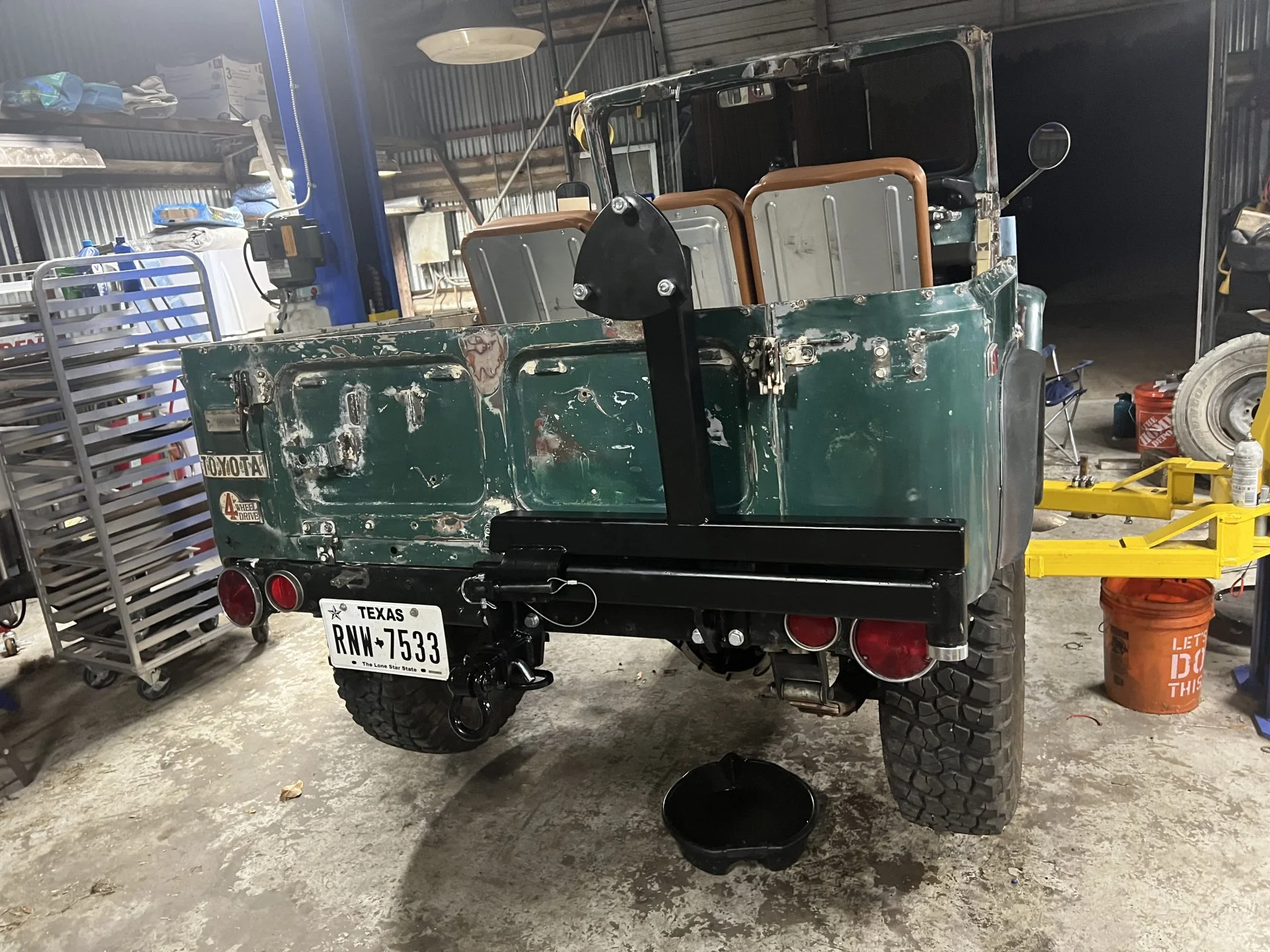

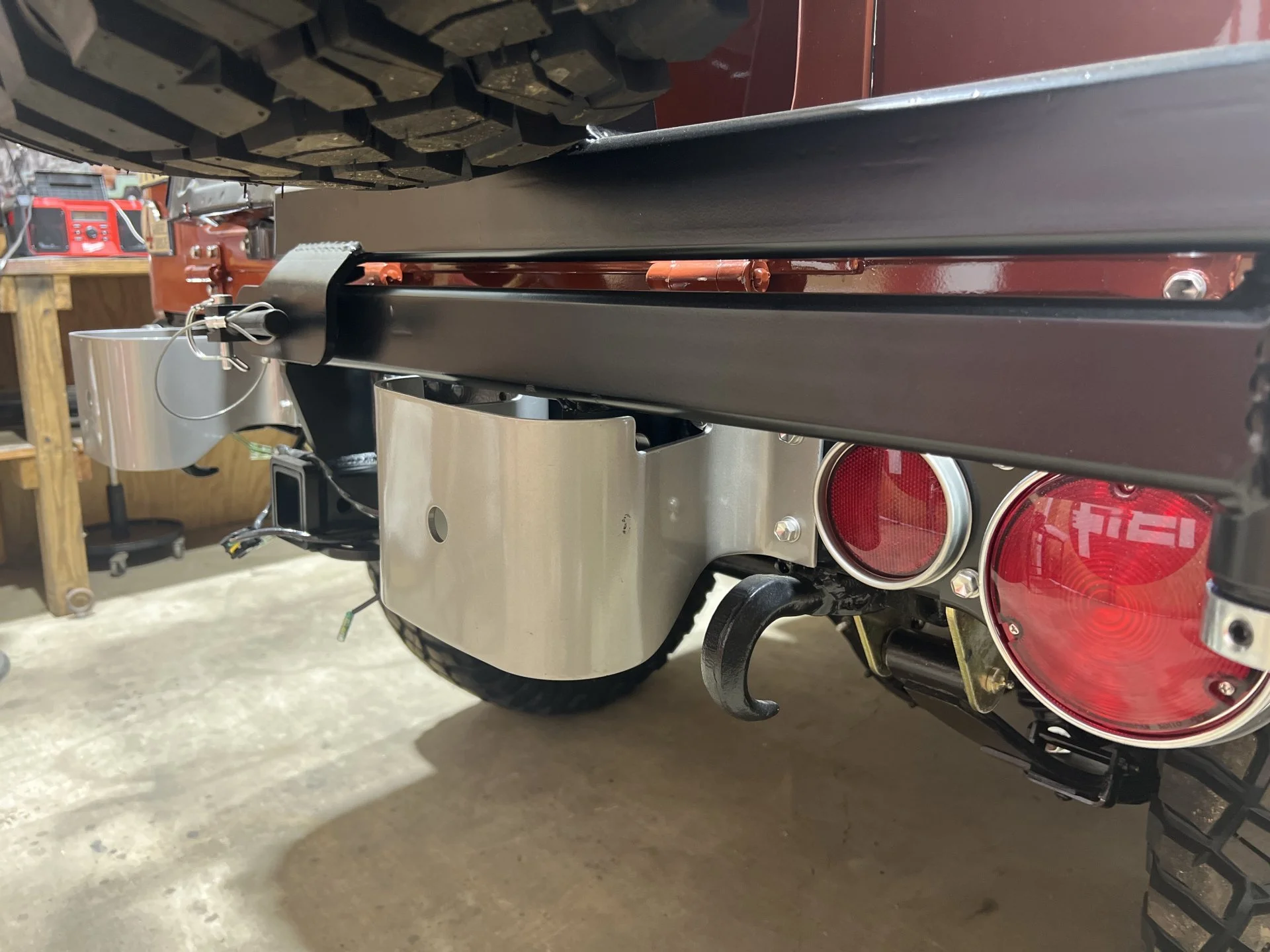

On the last one I installed I cut the passenger side bumperette to allow it to work with the 1/2 carrier.
I'm thinking I want a bolt on receiver rather than a permanently mounted one. Dave is away until next week, I'm asking him about that modification.
Does it look like that would be a viable mod given the way the thing is constructed?
Good idea! That was one of my focus points on the tire carrier was having one bumperette. To me it just wasn’t that appealing. Do you have a different picture looking at it from behind please?
That's genius. Simple trick and now you can run both bumperettes for a much better look. I think I'm stealing this.
