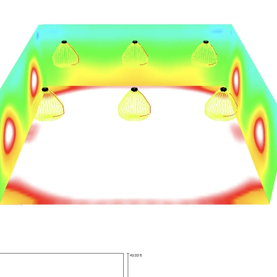

If you're going to work in the shop then you want fairly bright and even lighting distribution. I was looking for 100 foot candles at 30" above the floor as a goal. Lighting model says I should have around 110 with the fixtures and distribution that I chose and I can tell you that it is bright but not overly so. I only use the dimmer when I, for example, needed to see the laser line on the walls for running stripes. I even have very good light under a car when it's on the lift.
22k lumen fixtures are not an optimal size for 14' sidewalls. You won't get the full dispersion and with only 8 or 10 fixtures you will have considerable shadowing. You should really consider 15k or even 12k fixtures with twice as many as you are planning. You're obviously spending a lot of money on this building; I wouldn't underbudget for lighting.
If you're using the building mainly for storage then it probably doesn't matter and you can add specific task lighting as needed (e.g. over a workbench).
Again, just a friendly suggestion based on a lot of research and modeling for my shop which, again, is also 40x40 but with 16' sidewalls.
Thanks for the input, these are the recommendations from Hyperlite. Ordered 4 extra to tweak the pattern and will adjust as necessary.
