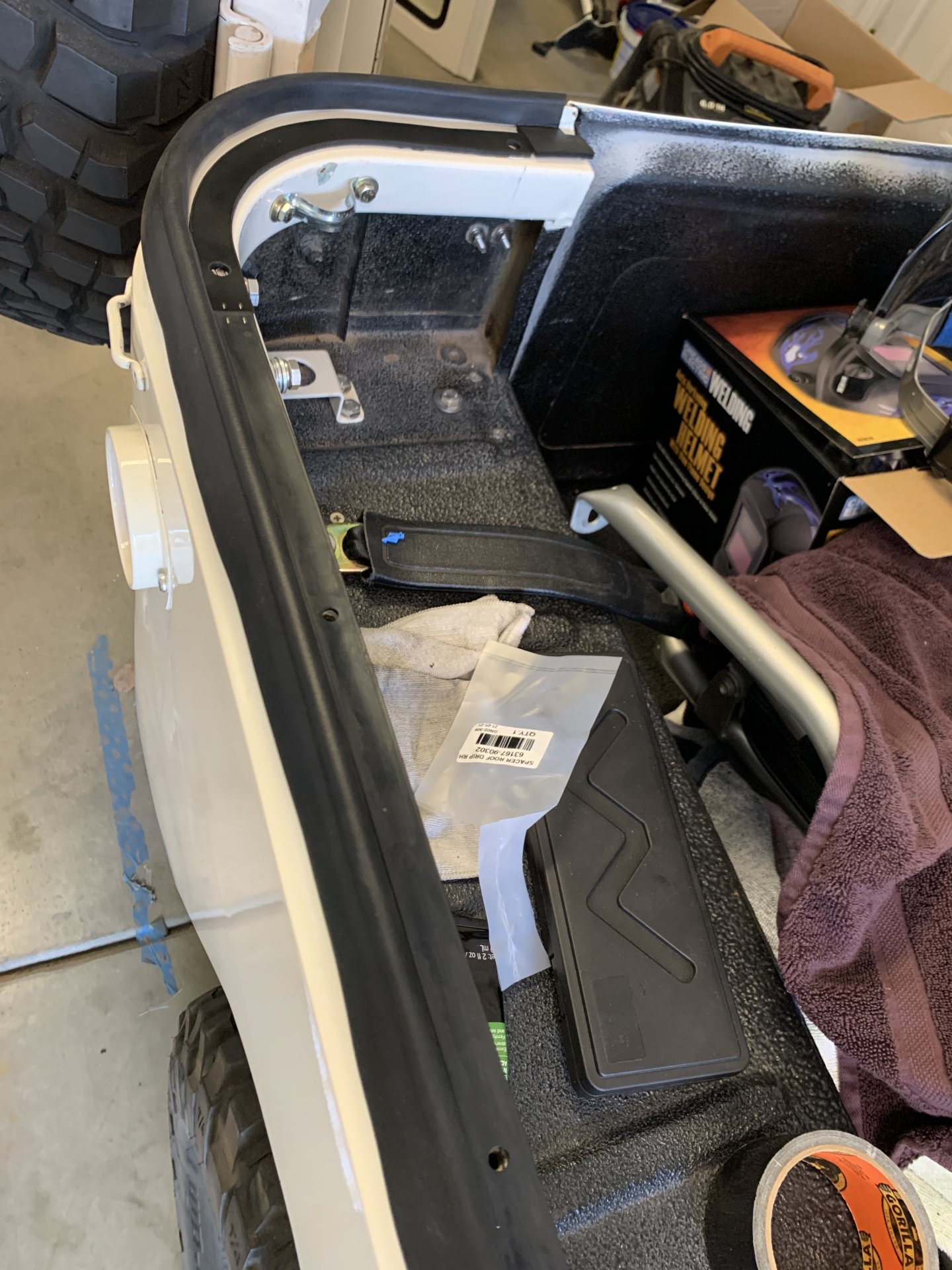

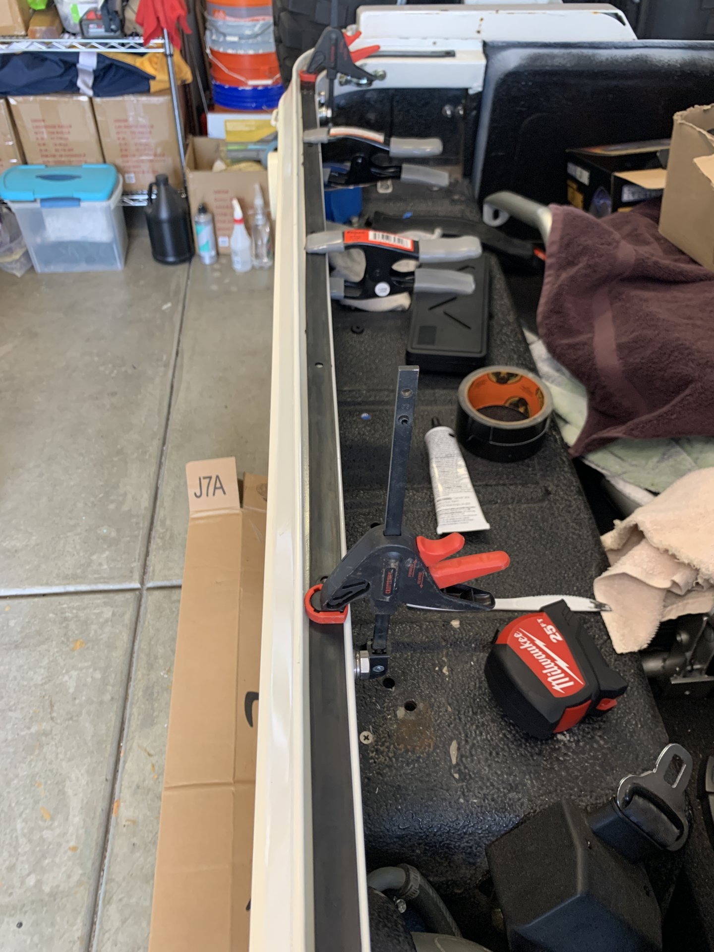

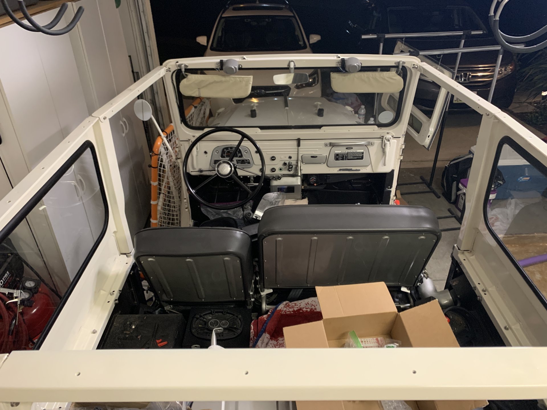

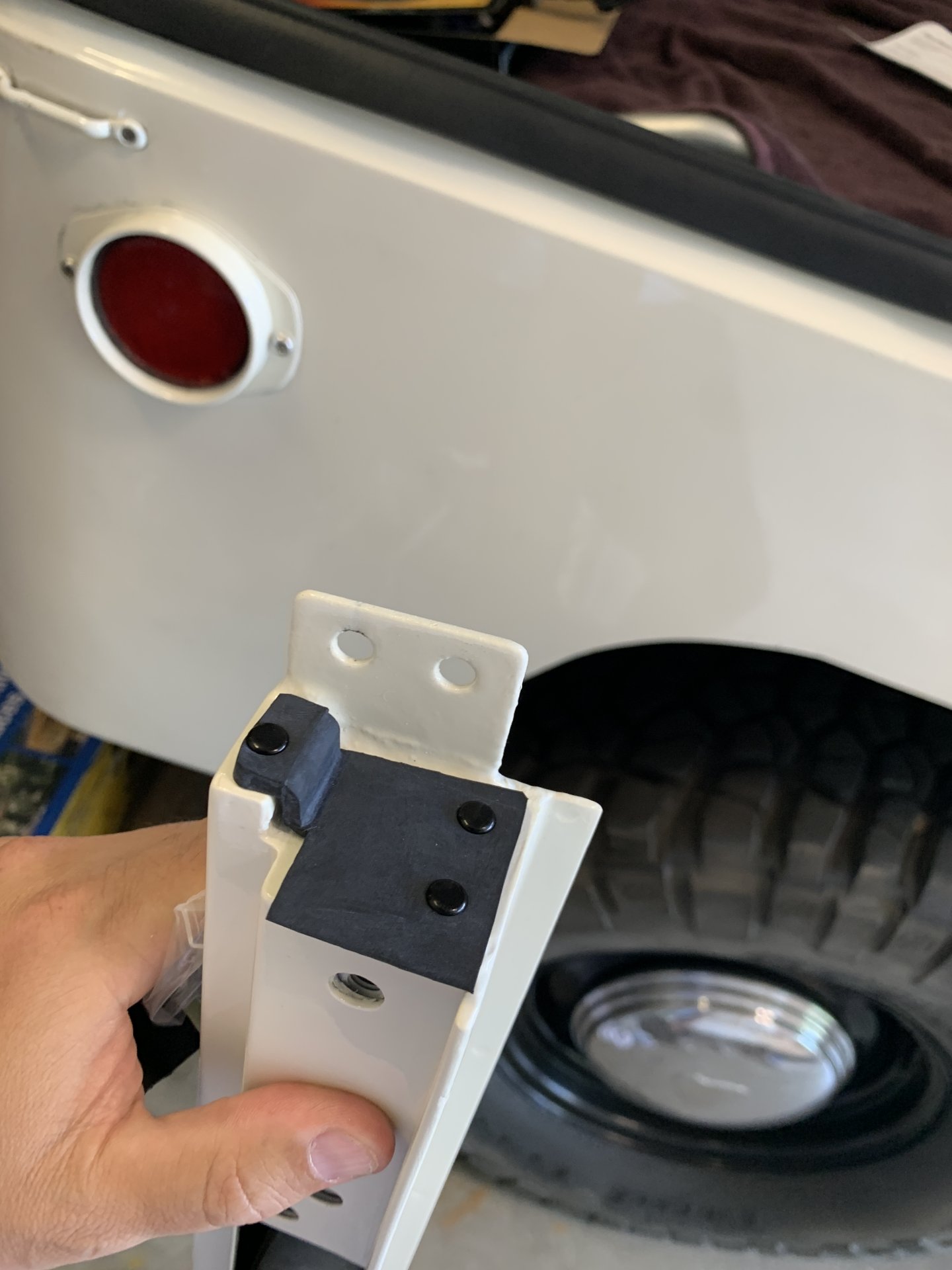

Made some good progress tonight. Got the sidewalls of the hardtop on. Before I installed it, I used all @Racer65 weatherstripping. '67 did not have any sort of rubber where the top meets the bed. However, it does in later models so I decided to add it. I also decided to use weatherstripping glue to hold down the bottom strip.
The next project is fiberglass. Wish me luck.

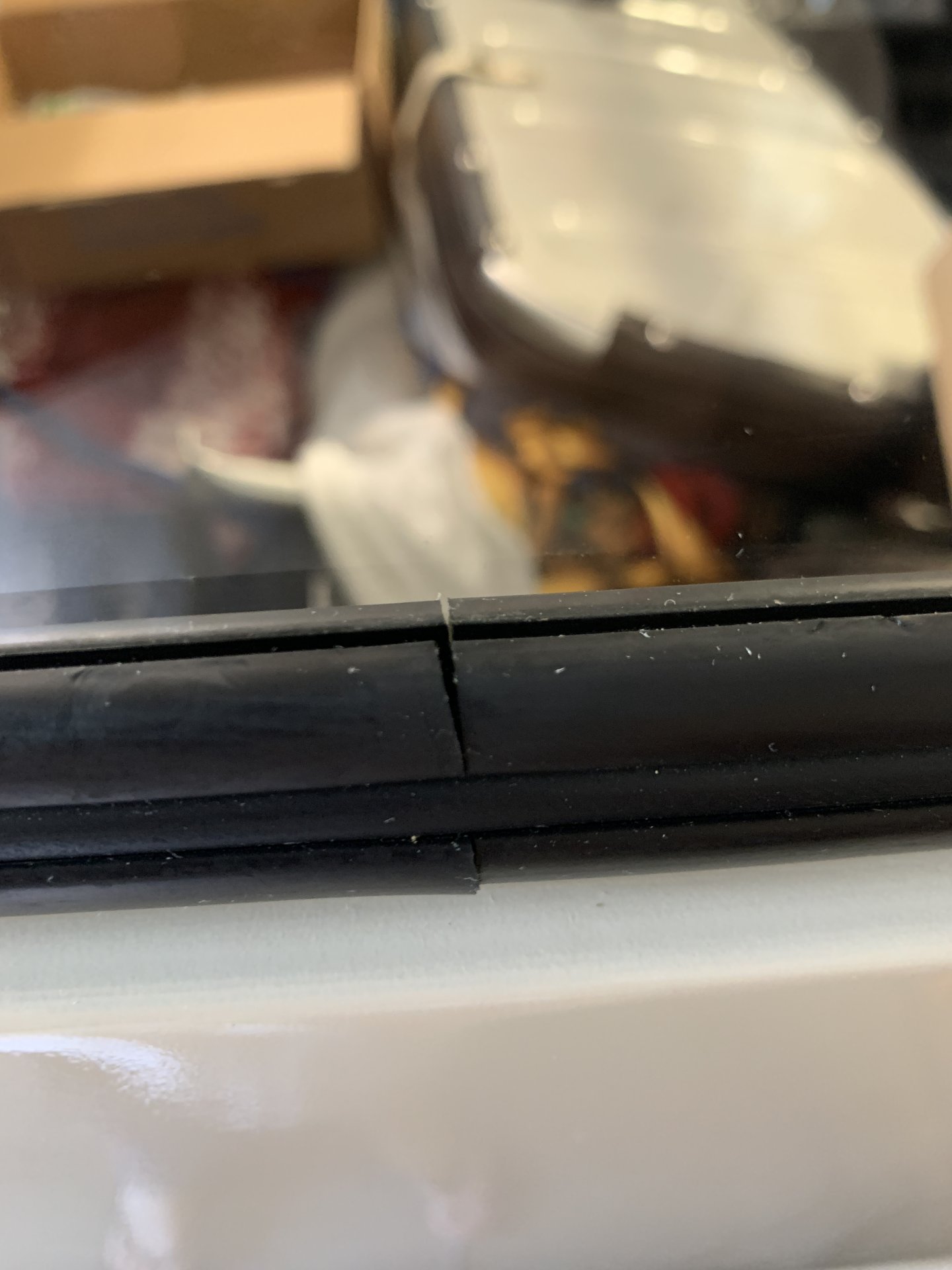

Nice progress. Been installing these kinds of windows for 30 years and was taught the joints go at the top. Water collects at the bottom and will seep through the joint, as it has more time to do so than at the top. Classic Restorer's Handbook also says top. I know many people put it on the bottom and don't have any problems. Just a rule of thumb, probably, and won't matter that much. I wouldn't change what you did, but just throwing it out there. FYI, mine was at the bottom of my 40 windshield when I got it, with a shrunken gasket and an 1/8" gap.
Looks great! I think it's a good call to add the weatherstrip, even if it's not "period correct". It's what Toyota did after thinking about it; that says something.

Question for you. Should I remove and redo the weatherstripping so the seam is at the top? Could I reuse the seal?
I also picked some of this glue up and can put it in the seam as the seam isn’t perfect.
I wouldn't change anything. Apologies to give you concerns, it most likely doesn't matter. Just how the restoration guys taught it in the 80s. I read that glue works well. The other thing, when installing, is to cut the rubber a little long so there is pressure, pushing the ends together. That way, even with shrinkage over the years, it won't pull apart.
Anyway, it probably doesn't matter because the edge of the glass is sitting outside the flange of the window frame. Any water that gets past should run outside the vehicle.
Find that interesting. My 9/64 FJ45 had weatherstripping between the cab and the top. Bought replacement from Toyota but original weatherstripping was still there. My 9/67 68 model had both pieces. Had it since 74.
