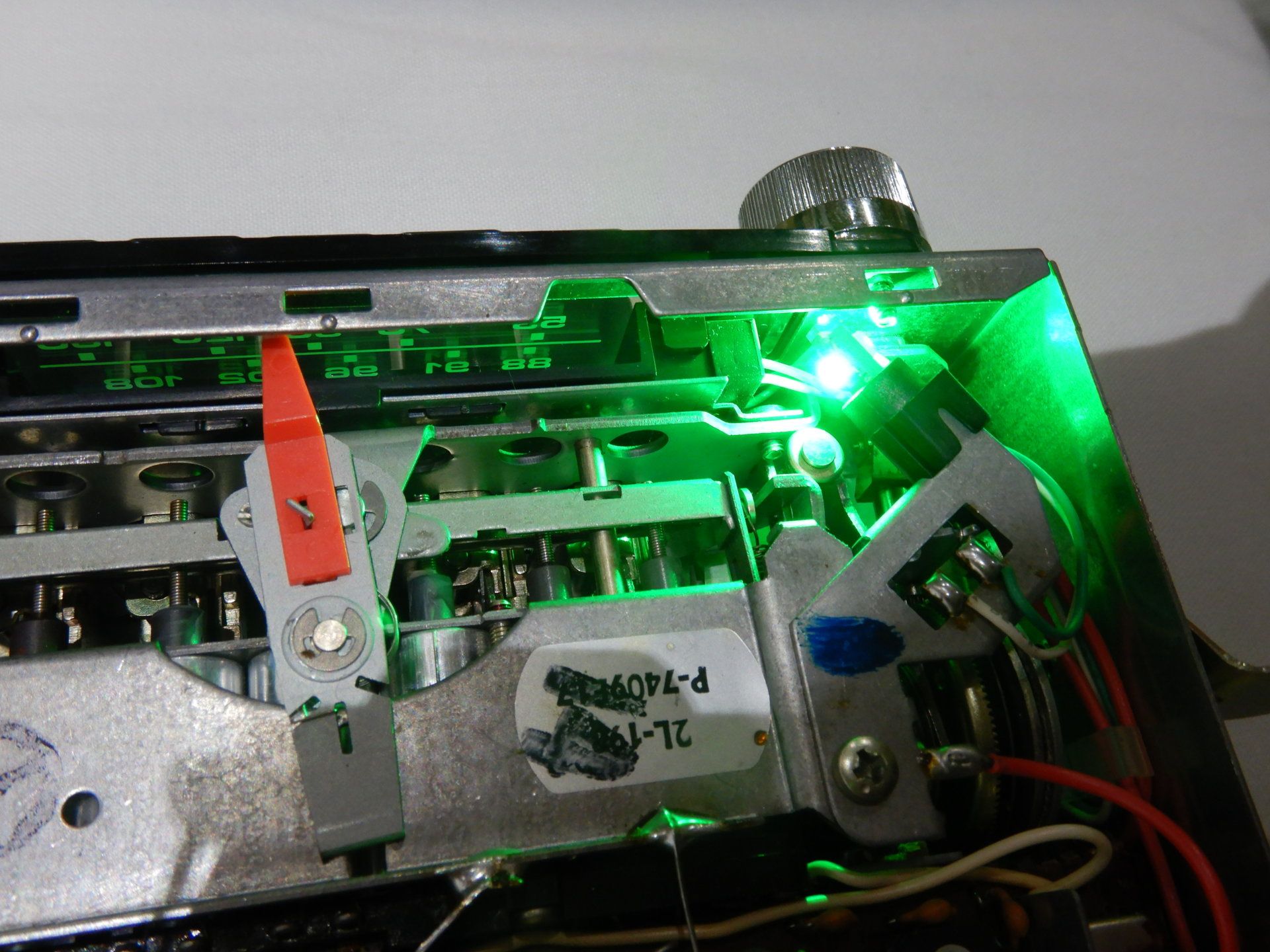

Success. Thanks! I installed a 158 bulb and it's plenty bright for my rural area. I cleaned and lightly greased the sliding surfaces inside, too.

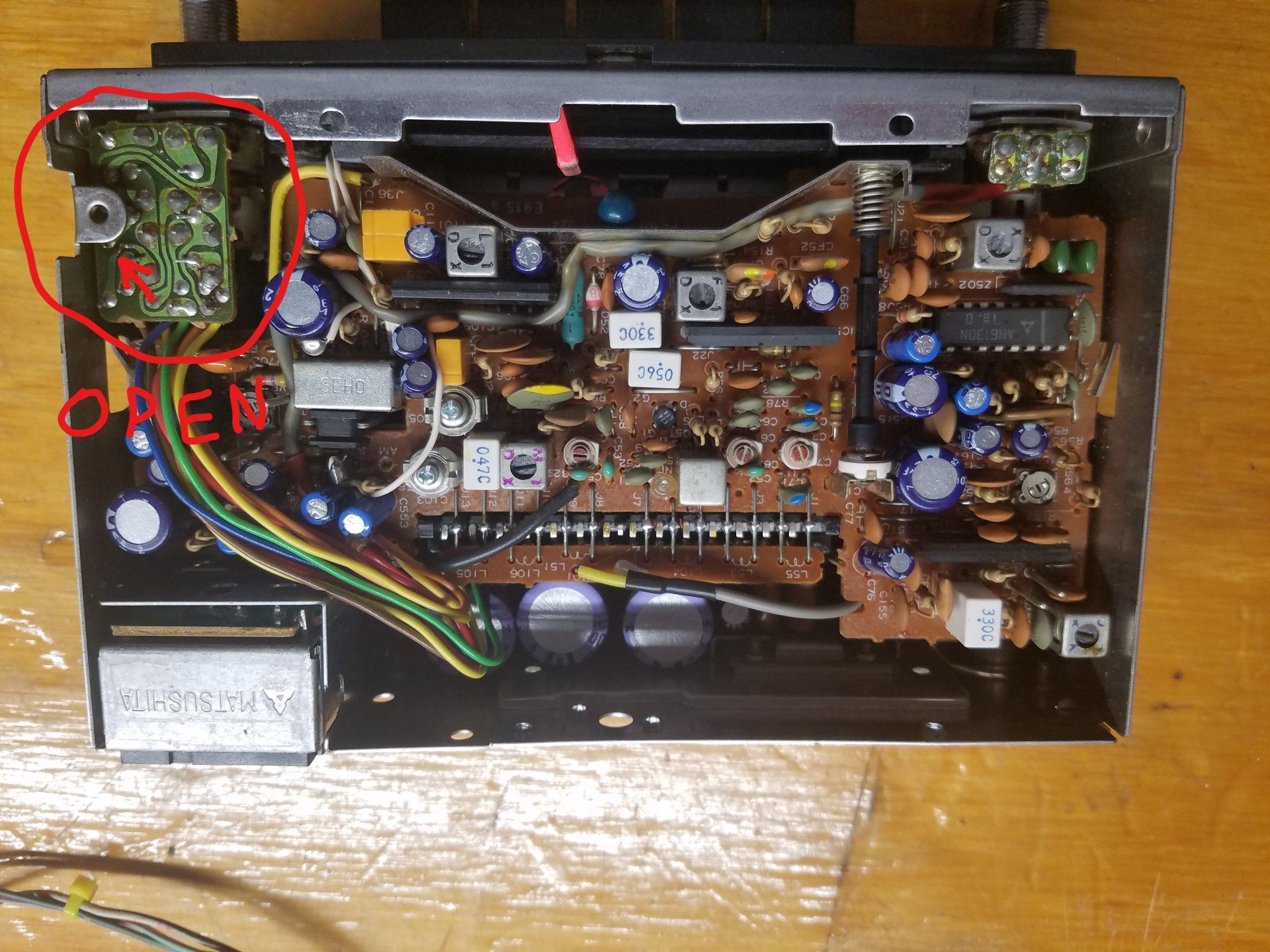

Working on this fine example of a very clean FJ60 radio. 86120-90A05, CR-6720AT. It was DOA. Found a shorted capacitor that burned open a trace on the volume/switch circuit board.

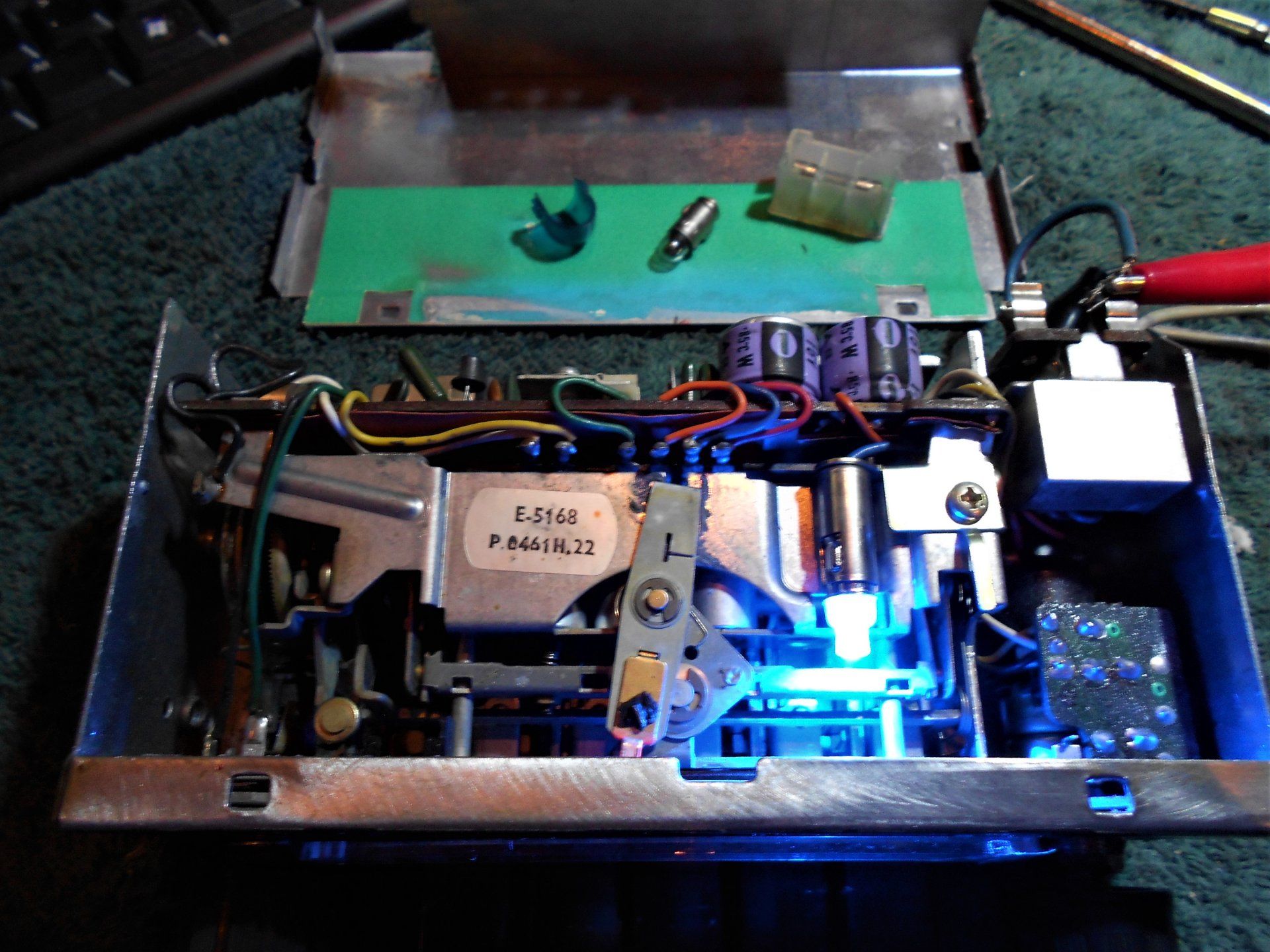

Finished up and sent home. Found a suitable replacement for this little guy, 4mm bulb with a plastic standoff. Sorry about crappy cell phone picture.
